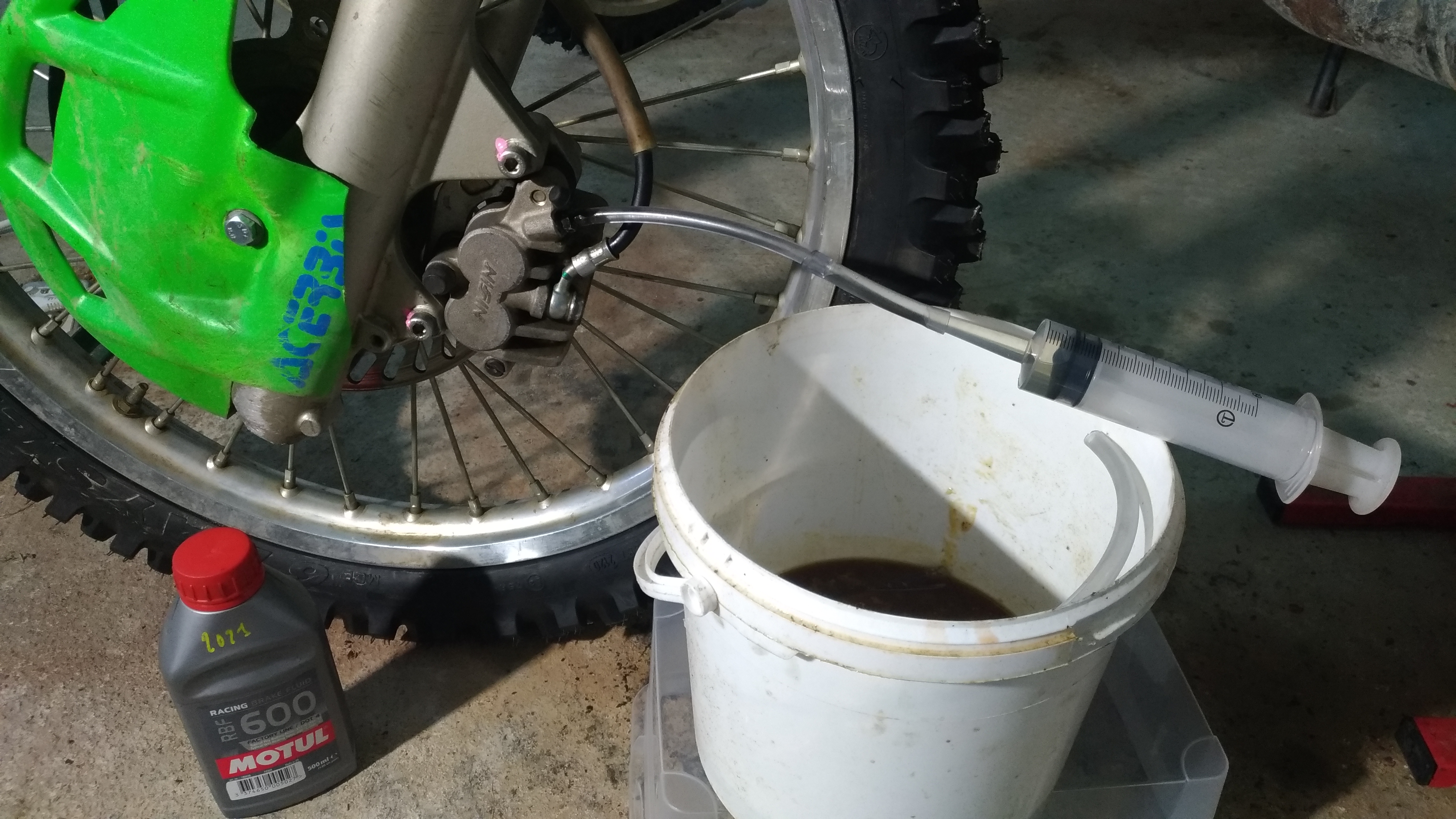

Ok, so I got a syringe and some clear tube.
Tried bleeding at the banjo, no air there. Tried applying succion with the syringe at the bleed fitting, definitely got bubbles out. I also removed the caliper bolts and tried different positions with not much results.
I'm still bleeding and bleeding and still the lever is not hard like I think it should be.
This is getting on my nerves so that's enough for this evening. I mean, how hard should the lever be? I'll take it for a test ride to see I I have some braking power.
How are you supposed to brake on a KDX? Like, blocking the wheel with one finger?
- P_20210517_204256.jpg (3.78 MiB) Viewed 5991 times
