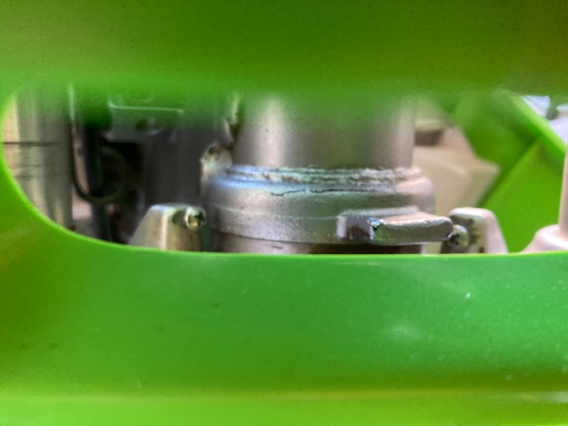

KLX Triple Clamp Stops Photo
Posted: 12:21 pm Apr 27 2021
by VTMTcowboy
I finally took a photo of my DIY triple clamp stops for a KLX fork swap. After the first couple rides I noticed that the triples were etching into the tank, so after consulting some of you guys here on the forum, this is the result. I drilled and tapped the original stops, then used blue lock-tite to hold the small screws in place. It seems to do the trick. Hopefully this helps out someone else that has or will have the same question. Take care.
Re: KLX Triple Clamp Stops Photo
Posted: 09:27 am Apr 28 2021
by Slick_Nick
I ended up welding tabs onto mine when I had KLX forks, but this is a great solution for someone without that capability!
Posted: 03:00 pm Apr 28 2021
by GATOROC
Glad you got the mod done! I did the same thing but used a flat head screw since I only needed a very small amount of clearance, and I only had to do it on one side. A simple idea/fix that I got from the forum here - one of many!
Posted: 02:04 am Apr 30 2021
by VTMTcowboy
Thanks fellas! Hopefully it'll help out the next person with the same question I had. Take care.
