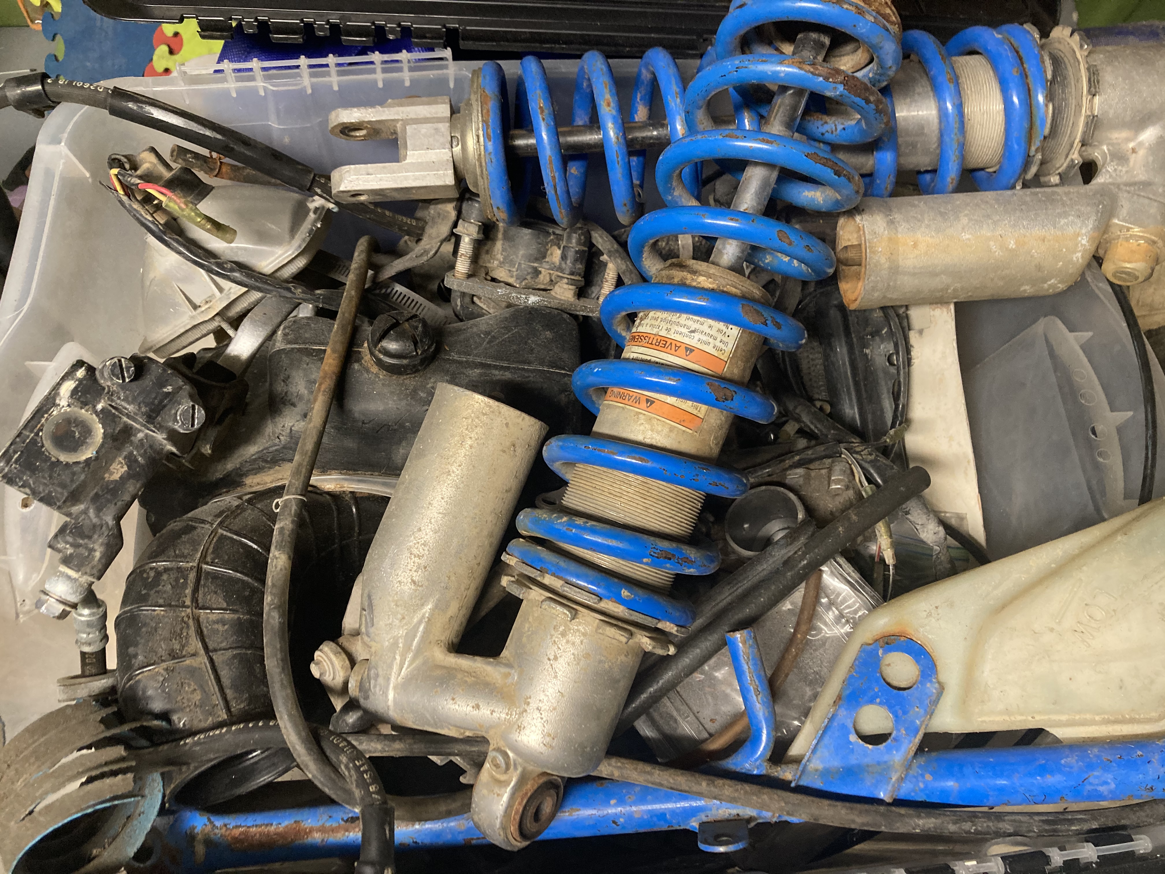

Here’s some eye candy, or maybe eye sores...

hell of a deal in my opinion!
The shock on the left looks to be the correct one, just tighten the lock nut for the spring collar.
The one on the right doesn't look to be from a 1989 - 1994, as the reservoir points up to allow for the end of the pipe to pass above it. 1989 - 1994 pipes pass below, so the reservoir is angled down to make room.

KDXGarage wrote: 10:52 pm Apr 20 2021 hell of a deal in my opinion!
Thank you! I noticed the reservoir difference between the two of them and it made me go hmm. I thought hey it’s $100 bucks why not. I usually can do most diy Maintenace, upgrades, repairs on vehicles and toys especially with the help of you tube so that makes me feel better knowing I got a good deal (and probably my wife more so).
