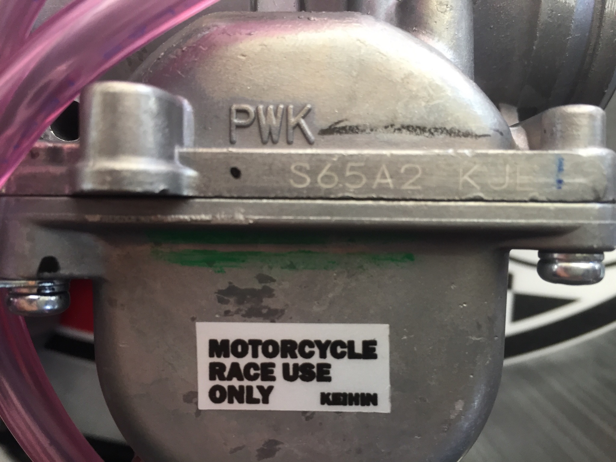

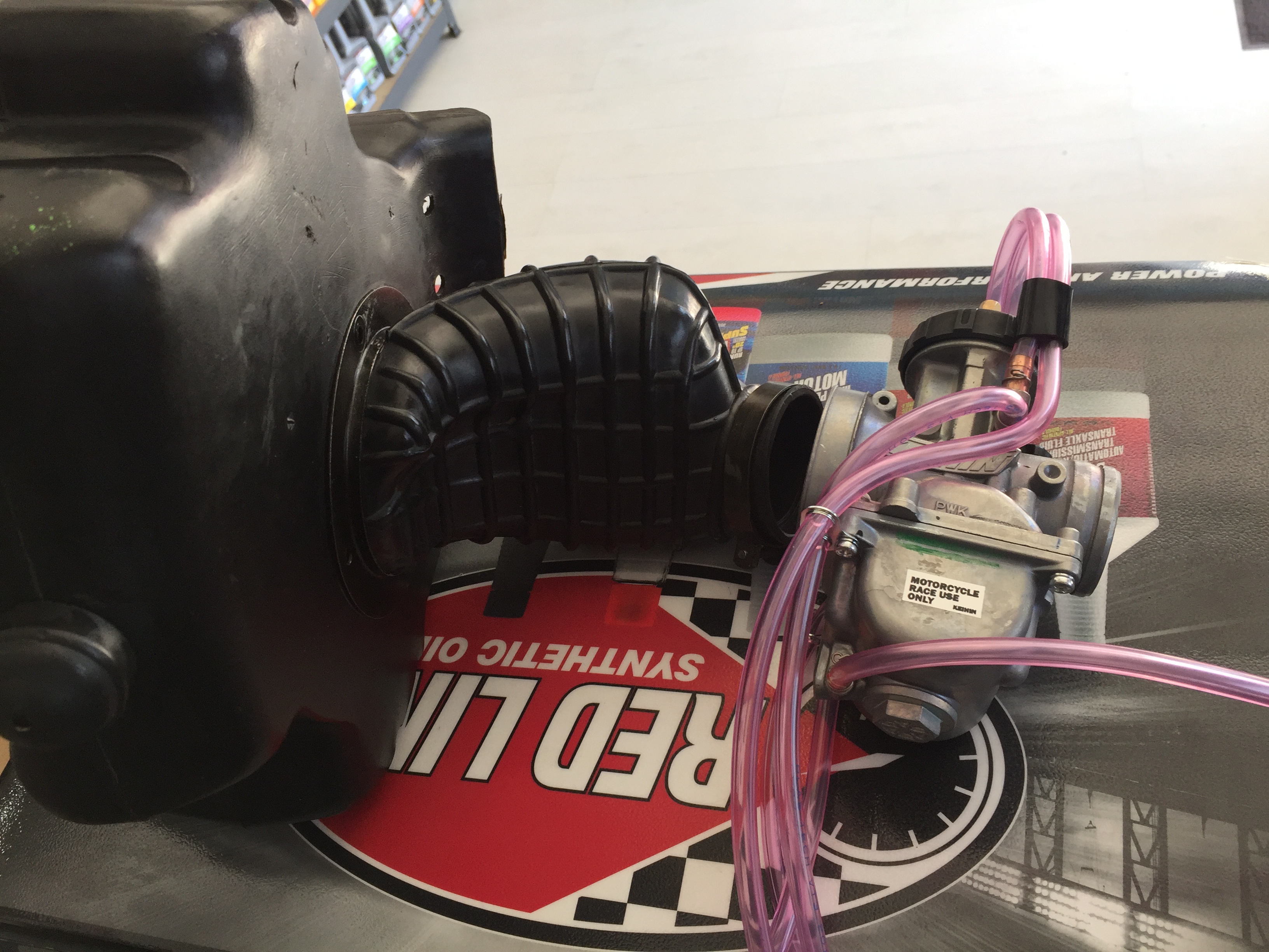

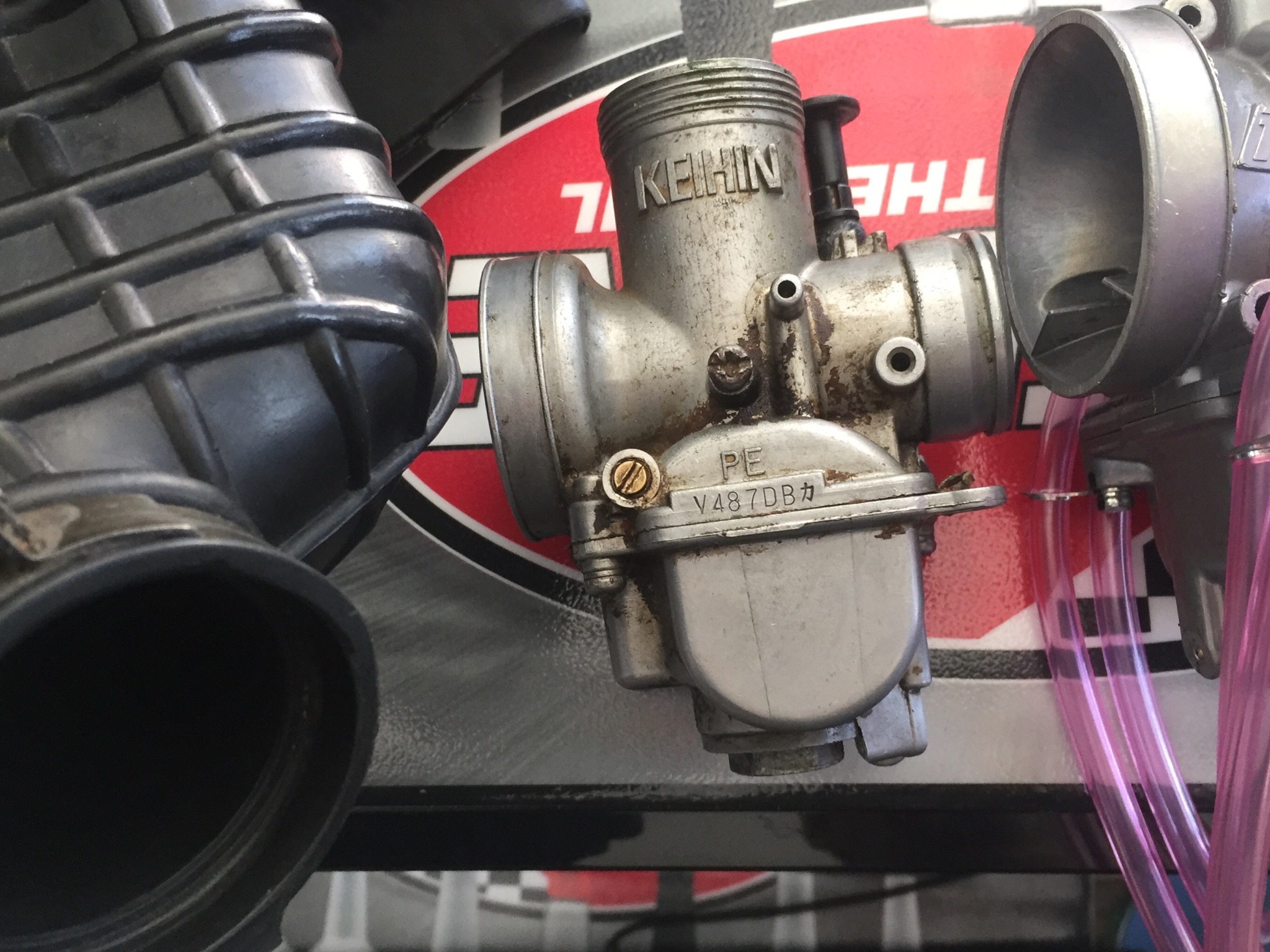

Hey guys greetings from Greece!

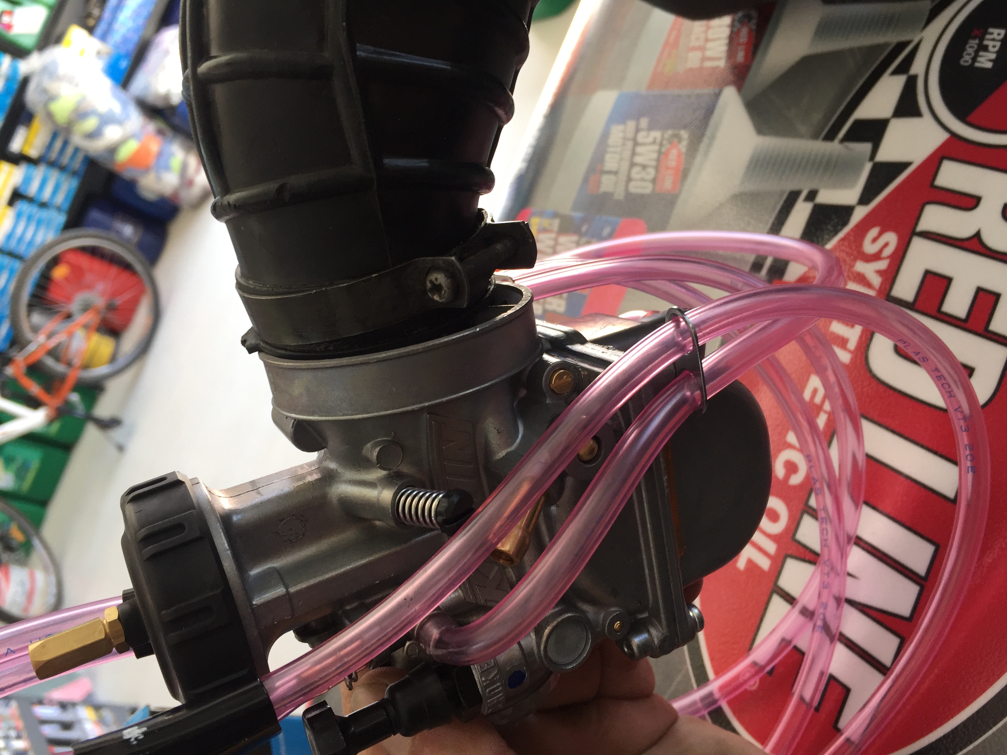

I have purchased a new PWK 35mm carb for my ‘89 KDX200-G to replace a PE Keihin carb that I found on the bike. The PWK is obviously bigger and won’t fit into the air boot and trying to put extensions is impossible due to lack of space!
Any help would be really appreciated!
Many thanks in advance!

That's a tough one, I don't know how you are gonna get that to fit.

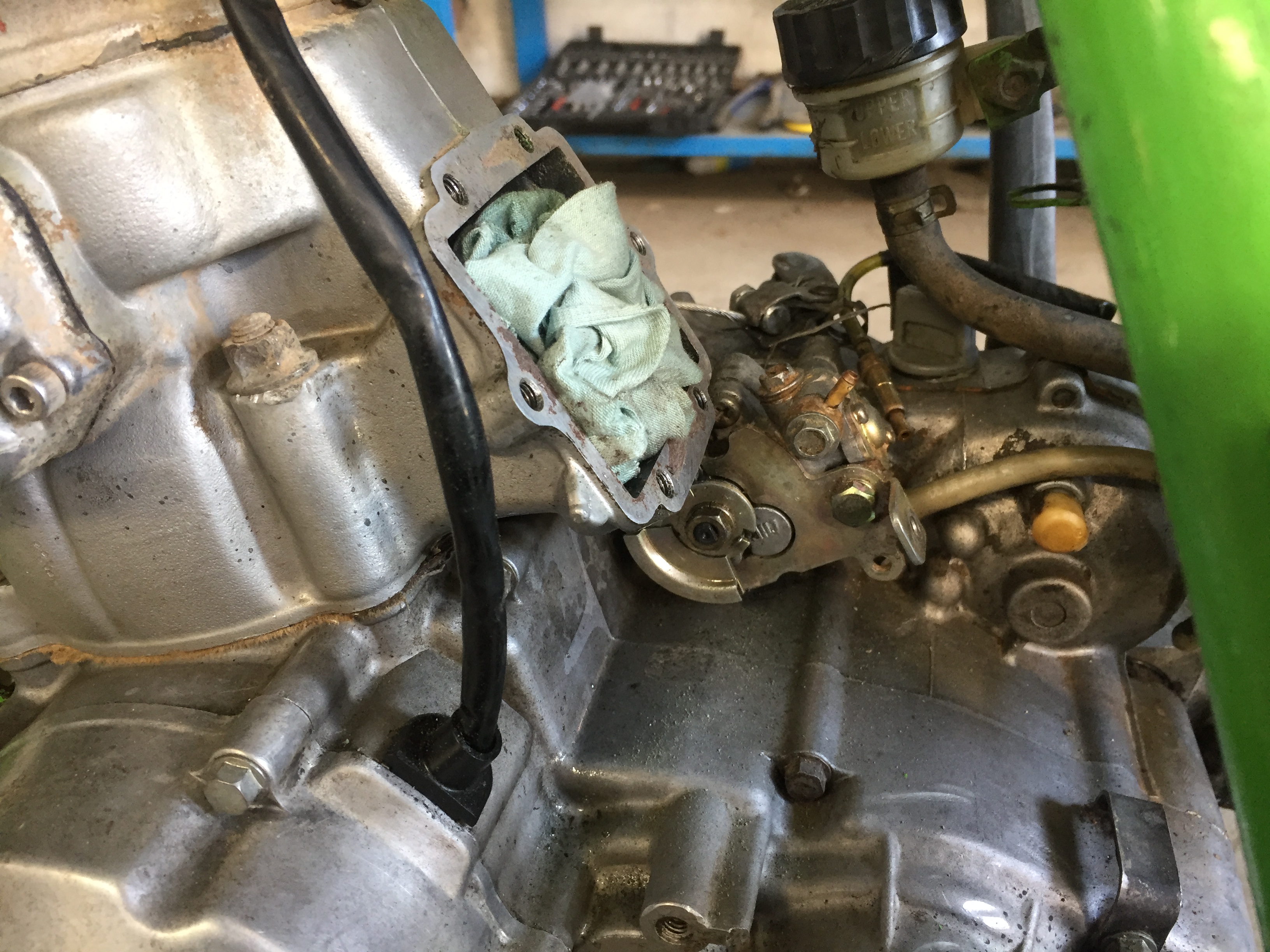

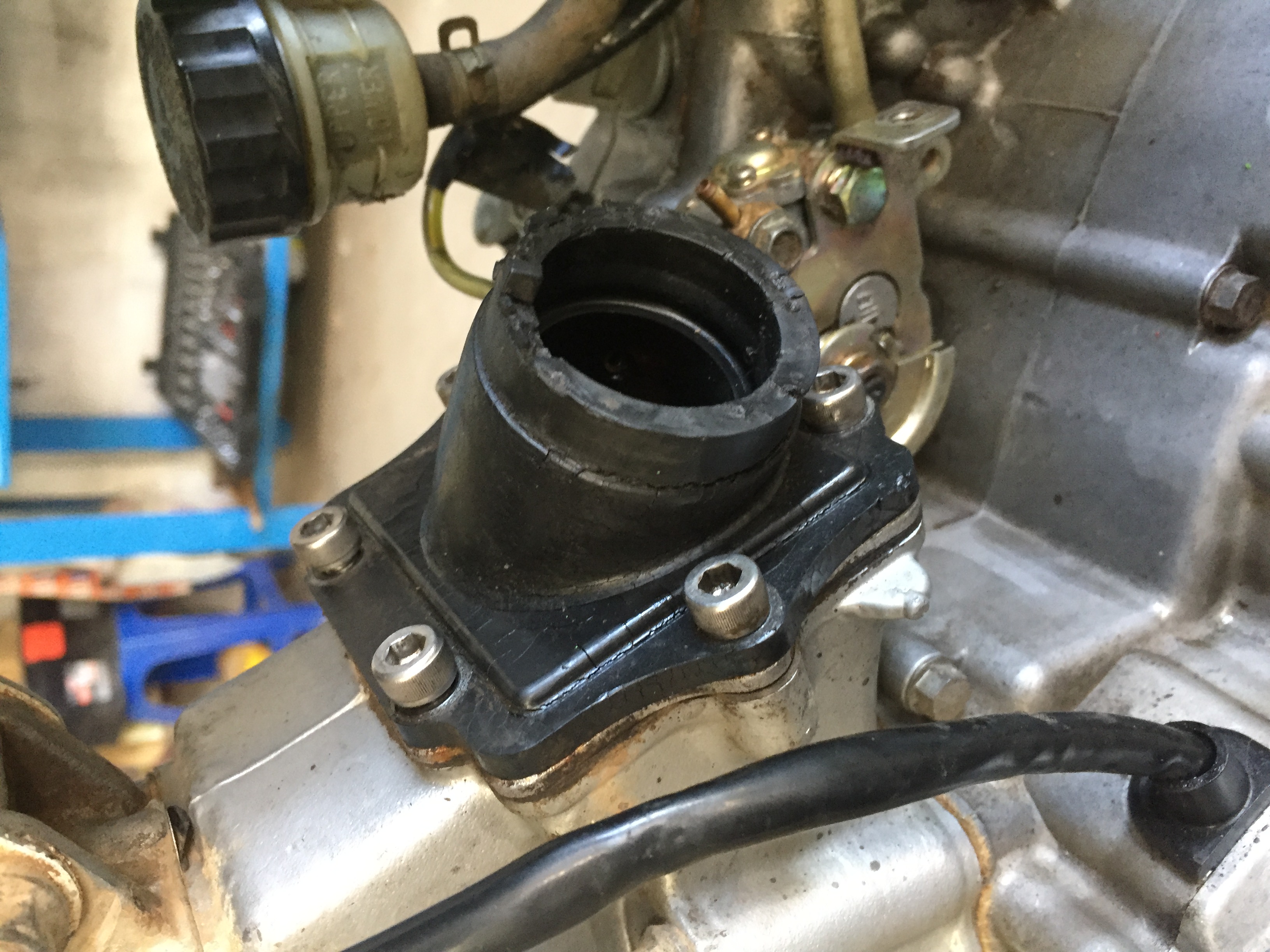

It also won’t fit to the engine side as well, into the boot in front of the reed valves....
Oh gosh I might put back the old carb for today. I desperately need to go for a ride , such a wonderful weather here guys!

Your intake boot is clearly torn so I wouldn’t go riding off into the countryside just yet. That may explain your carb problems.
What is it you’re trying to do? Is the carb that came with the bike the original carb from the factory? We didn’t get this model in the US but it appears to have an oil injection system. Are you planning to retain that?
What are you hoping to accomplish with this new carb that clearly doesn’t fit? What is wrong with the carb that was on it? How is the oil injection operated? From a vacuum port and the throttle cable linkage?
You might be better served to repair the original carb and intake boot and then go ride off into the hills.

It would probably cost you a few bucks but you need to have a local machine shop make you an adapter ring for the air box boot. Depending how you make it, epoxy the ring to either the ID or OD of the carb and the other end will fit the ID of the air box boot. This would add maybe 3/8 to 1/2” to the overall length of the assembly . For the reed cage side of the carb they will have to machine the spigot OD of the carburetor to fit. This is ok as long as the wall thickness doesn’t get to thin.
Maybe look into just rebuilding your carb.

Thanks for the reply! The previous owner had an old Keihin PE carb on the bike. KDX200 service manual states that it should be used a Keihin PWK 35mm carb. The manual is for H series of course, my bike is a KDX200-G ‘89, can’t find the specific manual but I assumed it applies for my bike as well.Goofaroo wrote: 09:13 am Apr 09 2021 Your intake boot is clearly torn so I wouldn’t go riding off into the countryside just yet. That may explain your carb problems.
I’m not trying to do something in particular other than renovate the bike and have fun as I used to do when I was younger (I’m 39 now and I used to own a KDX at 18).
After a lot of search and reading the manual I decided to purchase a new carb along with the other parts I buy to improve the bike.
In regards to the oil injection it seemed disabled to me so I didn’t touch it.
Nothing wrong with the old carb, just a 32 year old carb and I thought to buy a new one for the next 30 years (optimistic :) that’s all.

Unfortunately doesn’t fit it’s about 0.5cm smaller than the pwk35 carb even if I warm it and stretch it, it might crack.kick wrote: 11:01 am Apr 09 2021 I own an H so I can’t comment on what carb should be on there. I would think your air box boot should have enough flex for that adapter.

I have already ordered a new intake boot. I will replace it. No it was like that when I bought the bike. I am also replacing the reeds.
No I won’t stretch the air boot, I took it to a machine shop and they will build a small extension instead.

Can you get a model "E" carb to airbox boot? It looks like maybe you could cut and modify the box, then buy whatever plate mounts it to the box

Hmm, interesting. I would be looking for a (don't know if there is a difference to Greek spec) US spec manifold and air box boot from an '89-'94 KDX200. The PWK should then mount right up.

I assume you have an SR model going by the PE carb and the oil pump showing in one of your pics.
Are you running premix? If so, the afforementioned "E" model intake and airbox boots might work. If you aren't premixing then you will need to make sure you don't lose the oil feed that is in the intake boot.
