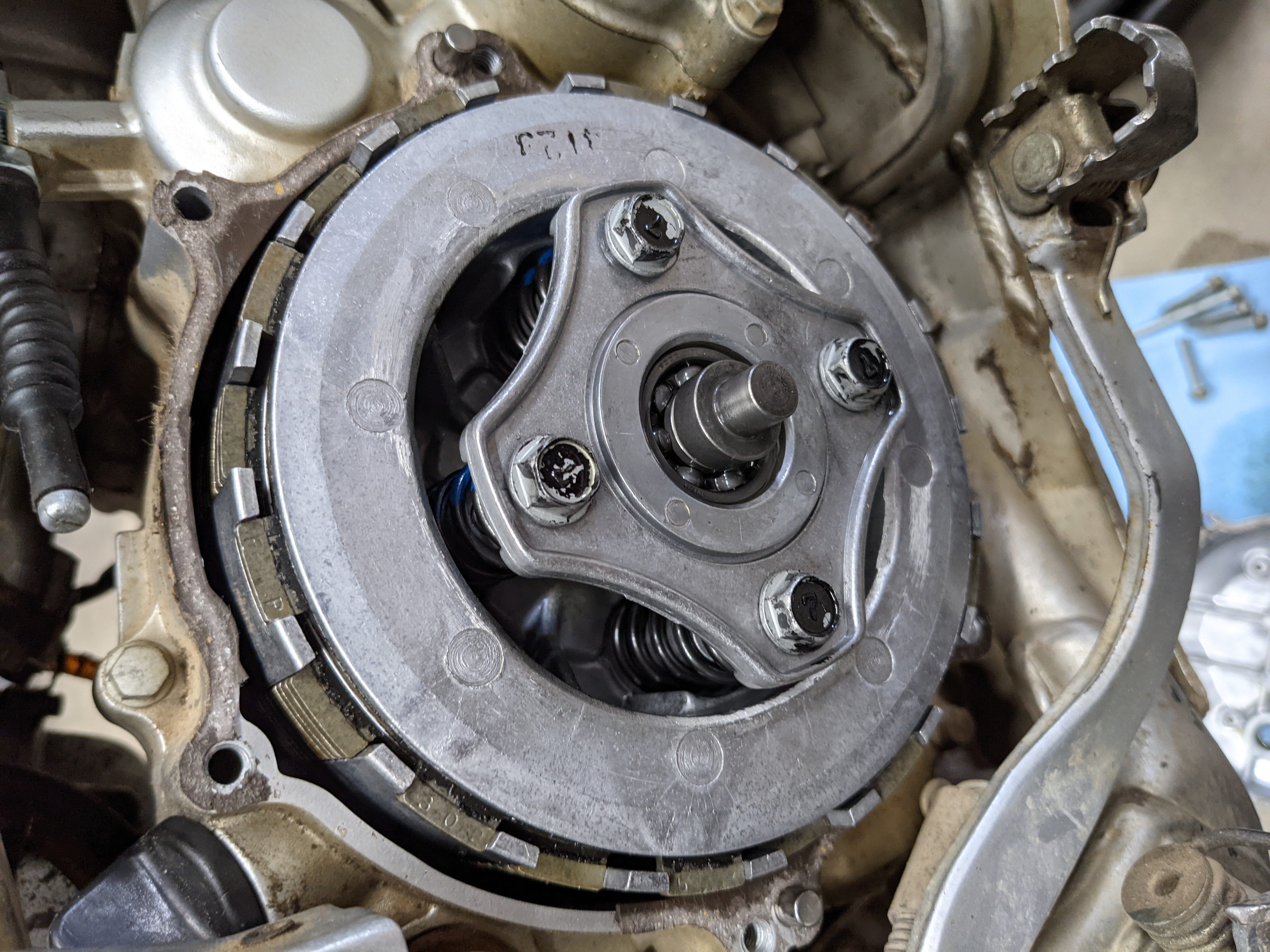

Hi guys, since I got the bike about 2.5 years ago the clutch has been hard to pull, similar to a hand grip strengthener. Not bad for fast ridding but technical stuff it's a pain. I drove other bikes that were way easier. I tried lubing the cable no change, I swapping the cable, no change. I checked the clutch cable is routed properly no kinks. Someone here said I should be able to push the clutch actuator arm by hand but I can't, not even close.
So I decided to inspect the clutch, I removed the clutch cover. The actuator arm is like new and moves smoothly. The clutch springs are at about 37mm each. My Kdx200 manual (I have a Kdx220) says 38.7mm standard and 37.2mm service limit.
Also it's happened once last year that I couldn't shift up in 3rd or 4th gear. Could be a fluke as I don't clutch when shifting up most of the time. I only let off the gas.
I haven't yet inspected the clutch basket but what are your thoughts on the cause?

Well, your clutch springs are beyond the wear limit, so that's not helping matters.. I would also inspect your frictions and steels for wear since you have it all open. Some KDX's are known to have stiff clutches, plenty of threads on here about that, just search clutch pull. You can lengthen the clutch actuating lever to get an easier pull, or go to a Magura hydraulic unit. Read this thread for an alternative lever. Your clutch basket looks pretty good from that pic, not much noticeable notching which is good.

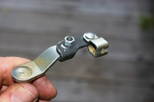

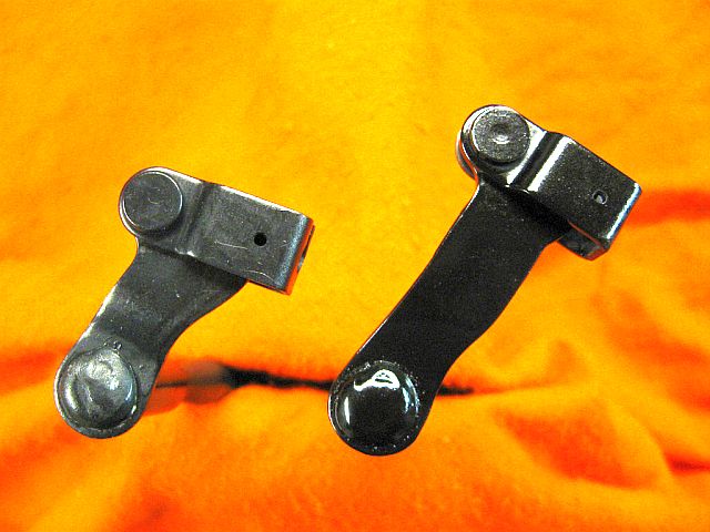

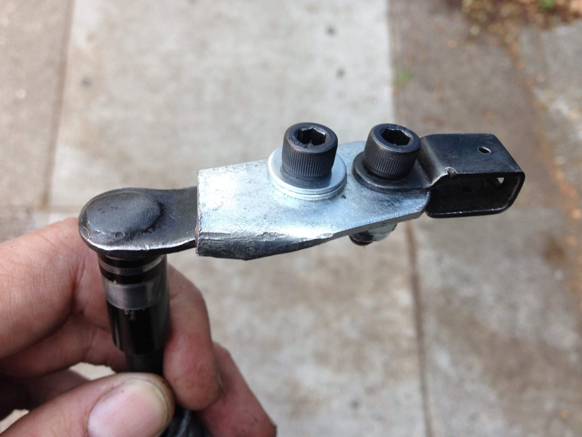

The REAL fix is to lengthen your clutch actuator arm where the cable attaches. This will give you more leverage on the springs and make the clutch easy to pull. It's not a quick easy fix but if you take the time to do it, you will be very happy. Something like a 1/2" in length can make a huge difference.

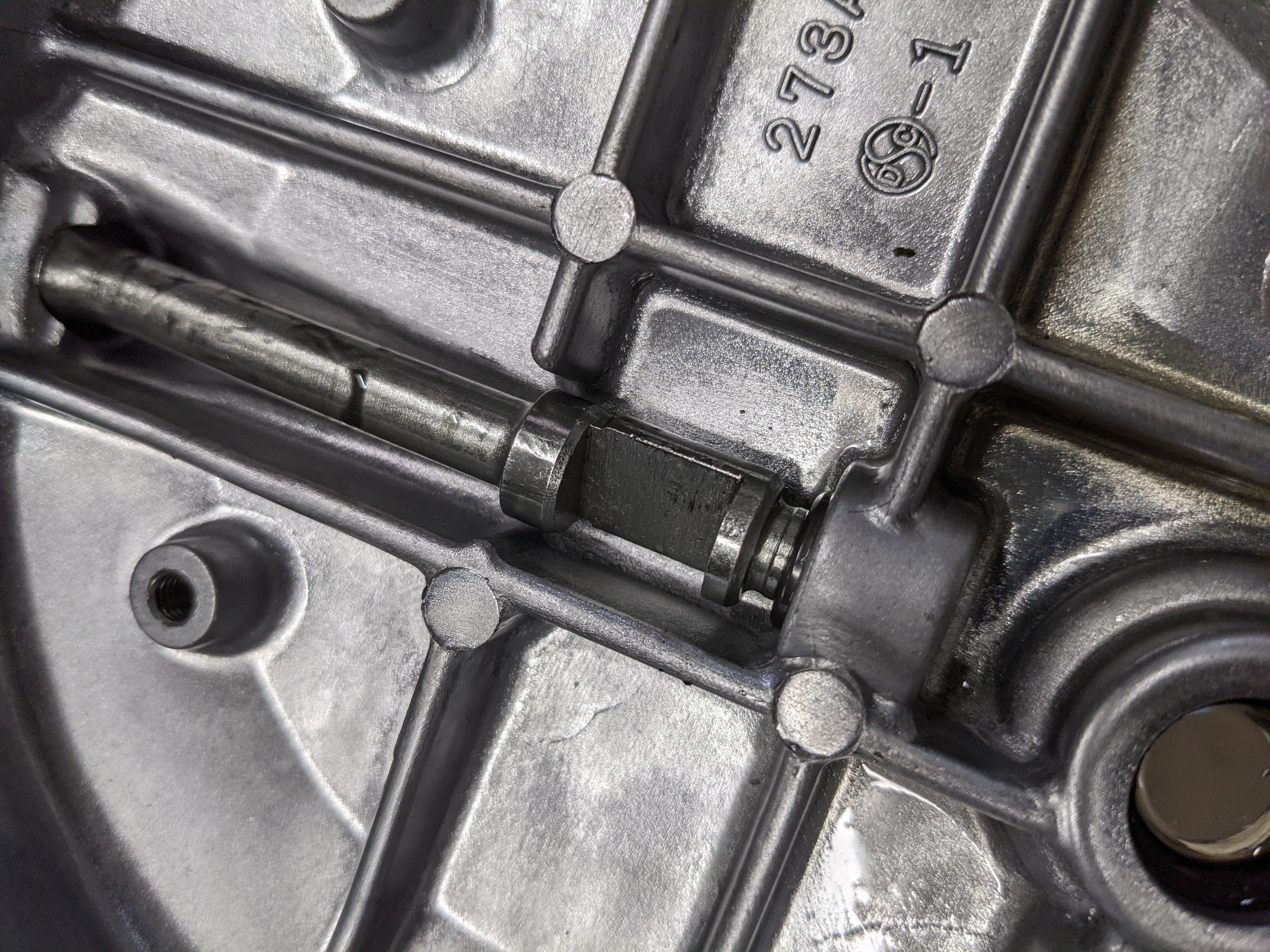

Other then that I would check to make sure your actuator arm shaft is not binding in the case when pressure is put on it. Make sure its clean in the hole and if it has the two sets of bearings in there make sure they are good by putting a good amount of sideways force on it and actuating it.
I did a quick google search to give you an idea and found these images I included them below:

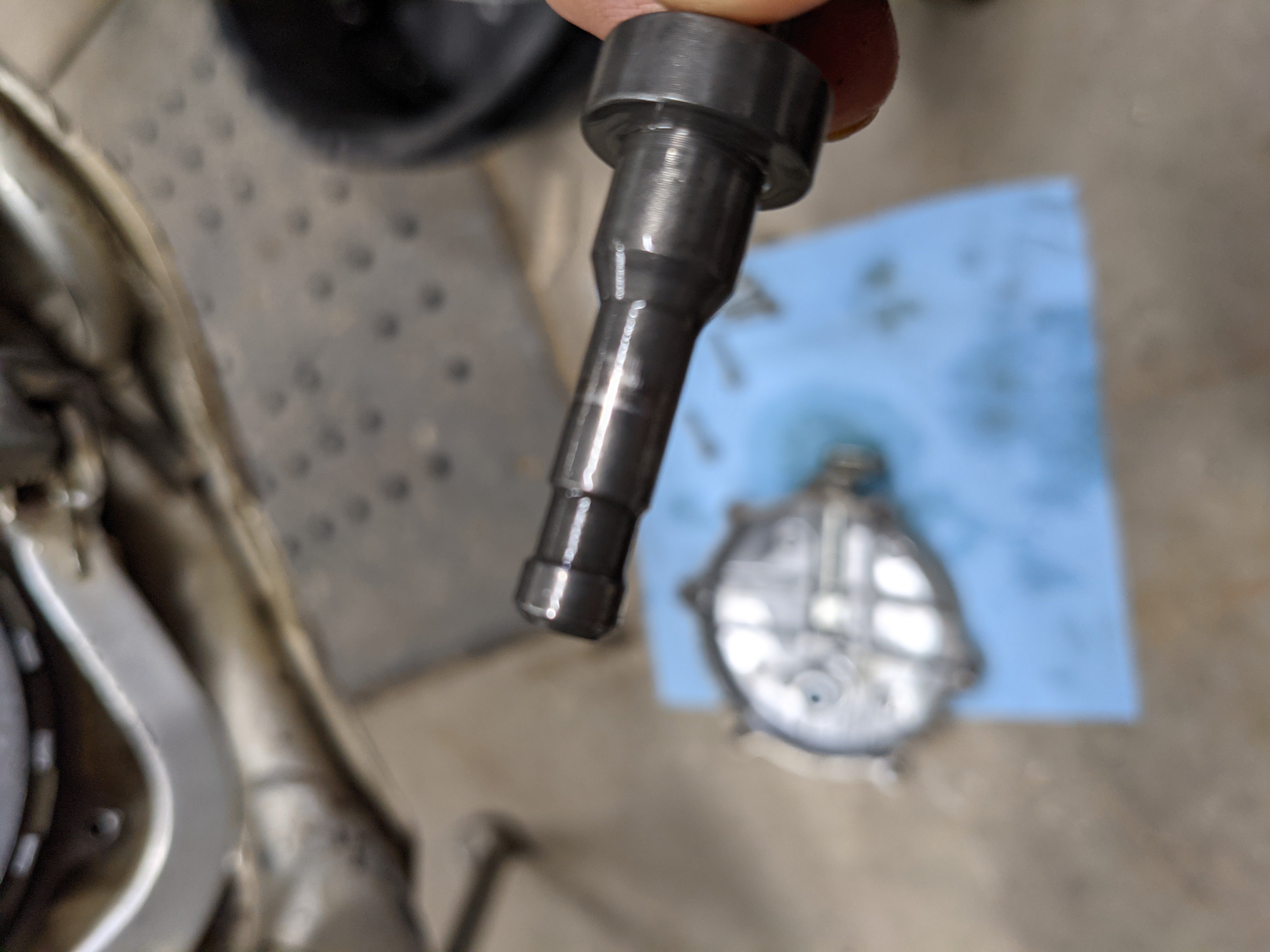

Hard to say looking at the pictures if that exact part will work, but yes that is in the right direction. You will have to check the measurements and make sure you have room down there. That particular one looks a little bulky, and looks like you would have to modify your original to make that work, if it would, with the large shaft opening. If you aren't a welder you could easily take your arm to someone and have them cut it in half and put a little 1" piece of steel and welding it up , like pic #2. For probably around the same price. I think buying something after market like that may give you more headaches then your looking for. The other option I would consider if you can't get it welded is buying an extra actuator for your bike ,if you can find one...., so you have an extra and then taking a stab at modifying it with a small bracket like pic #1 or #3 so your bike isn't out of action while your working on it. With a vice, hammer, pliers and drill I think a guy could come up with something if you take your time.

I was able to get the arm extended by 10mm just didn't get around to installing it yet. I'll let you know how it goes as soon as I can test it.
