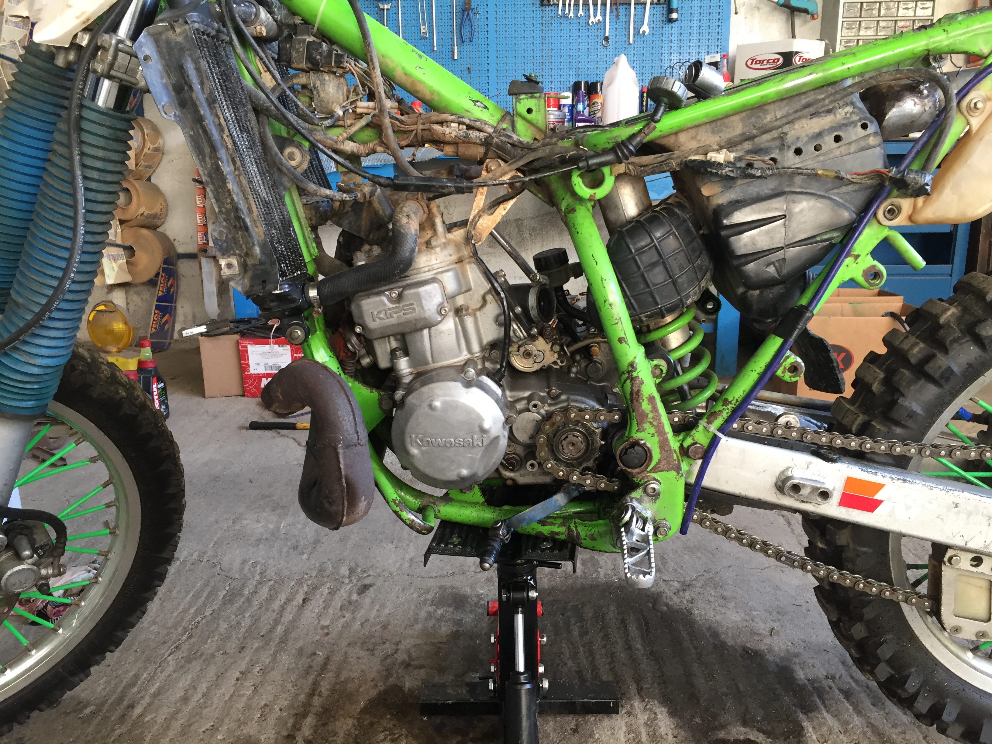

Re: Please help guys! Broken venting bolt!

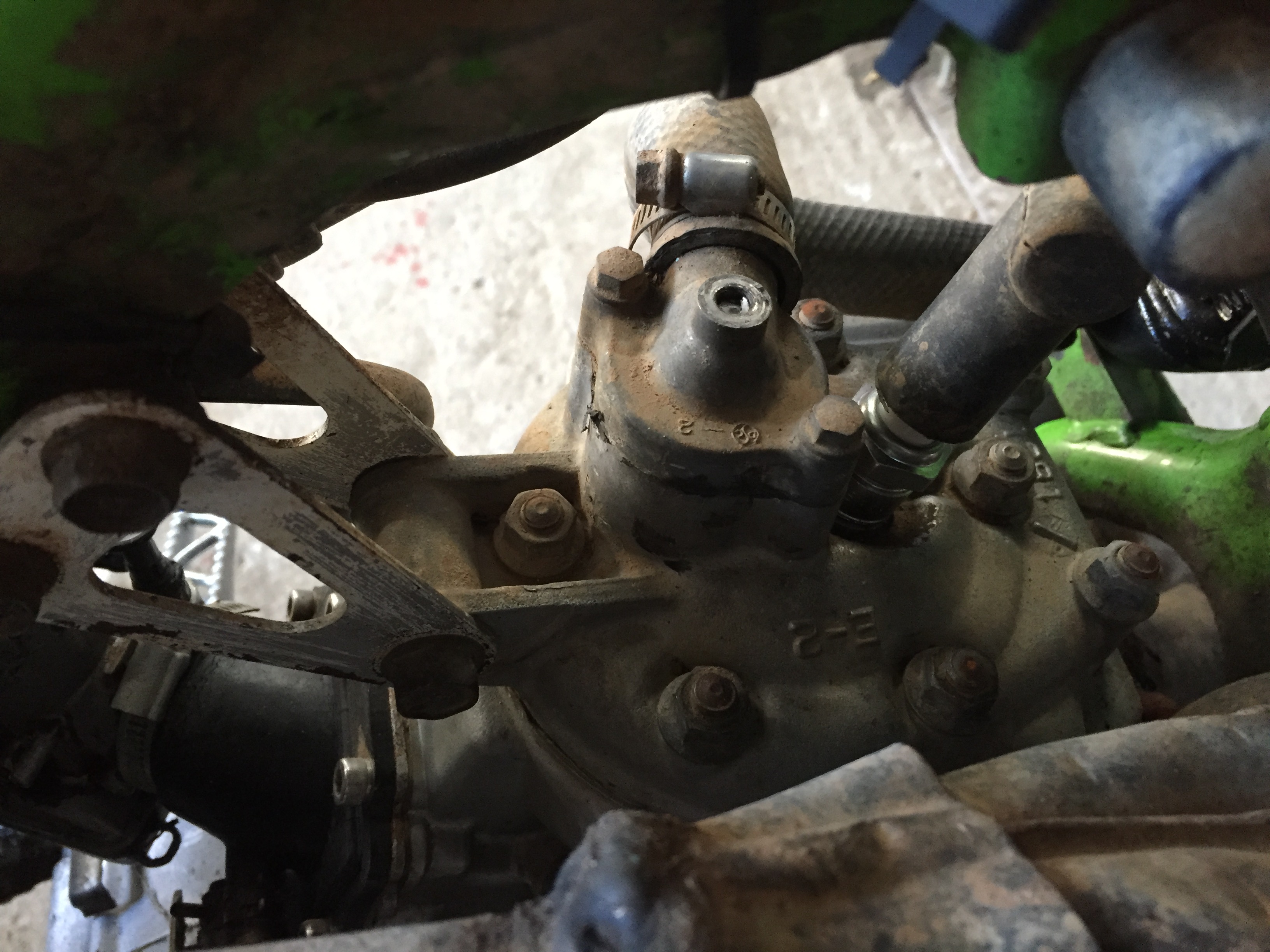

This is how it looks right now, i'll give it a go this afternoon and let you know how this works!
- IMG_5029.JPG (1.21 MiB) Viewed 3428 times
KDX200-G1 | VOLOS | GREECE
You HAVE to take the part off. If you drill through it, then you send drill shavings into the coolant, pump, radiators, etc.

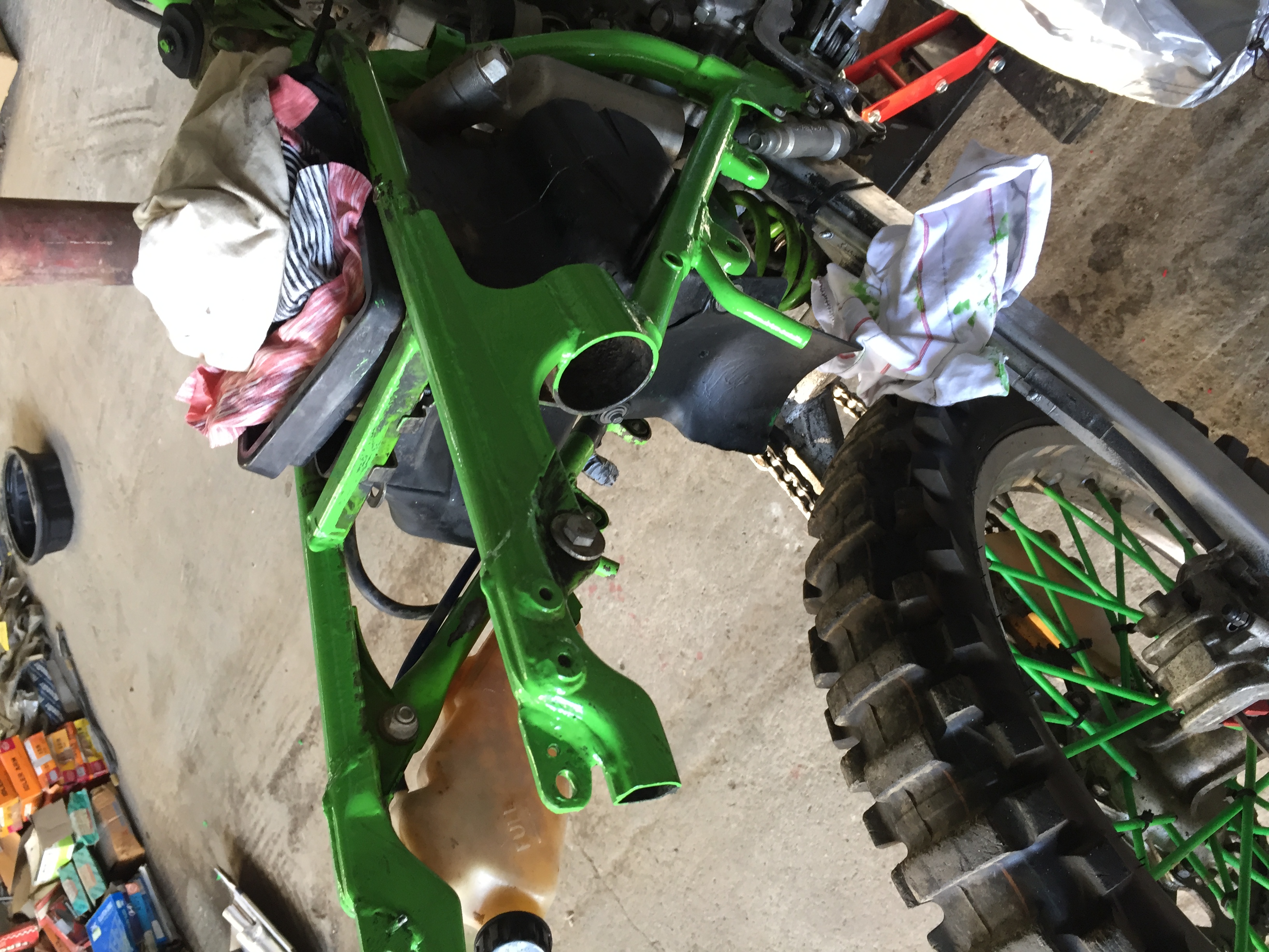

I still have a long way ahead of me.. but i really love my KDX and i will make it a beauty!

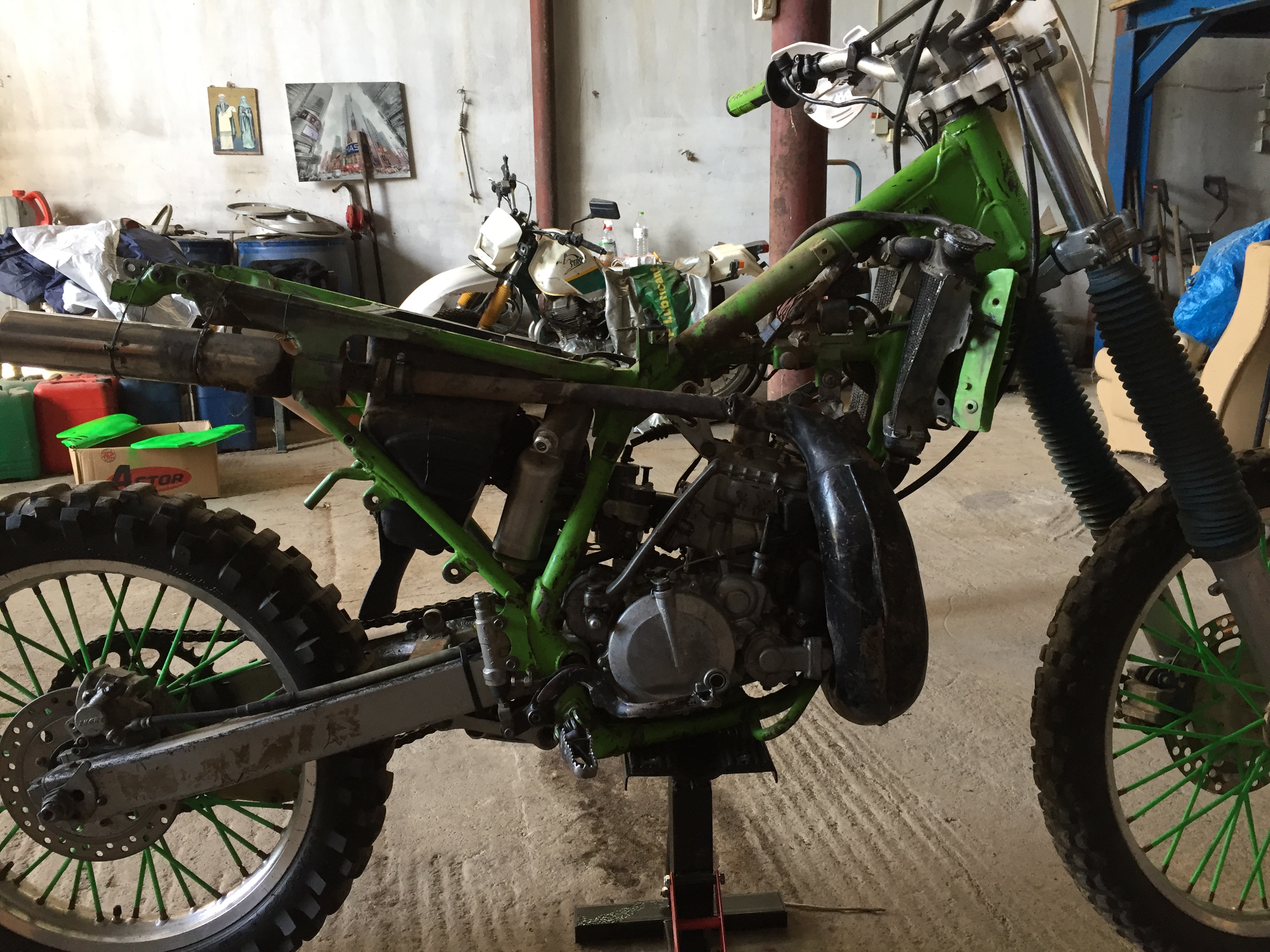

This is a 100% Japanese model and funny enough when i rang Kawasaki Greece to obtain parts codes they told me off
, cause these bikes where never sold in Greece and they told me that came from USA.. i willupdate with more photos soon

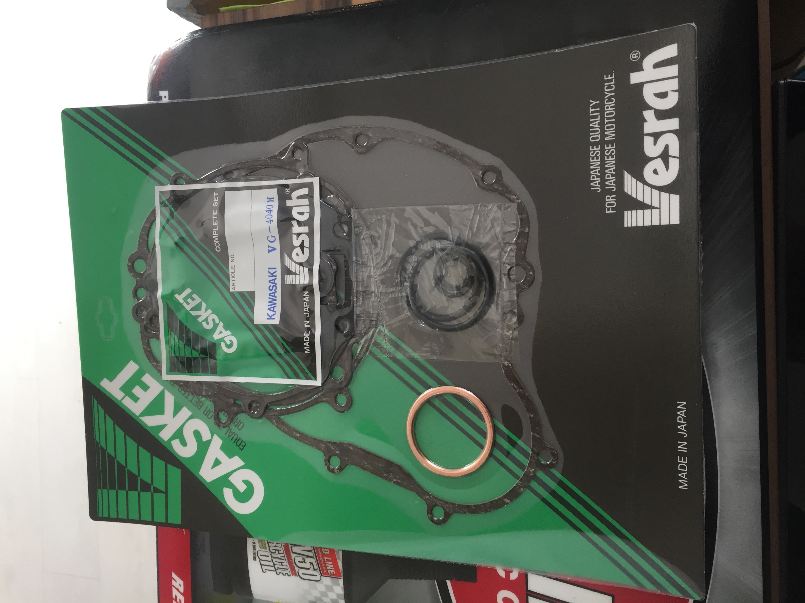

Vesrah makes good parts!
You might want to change your signature to 1989 KDX200-G1 or similar.

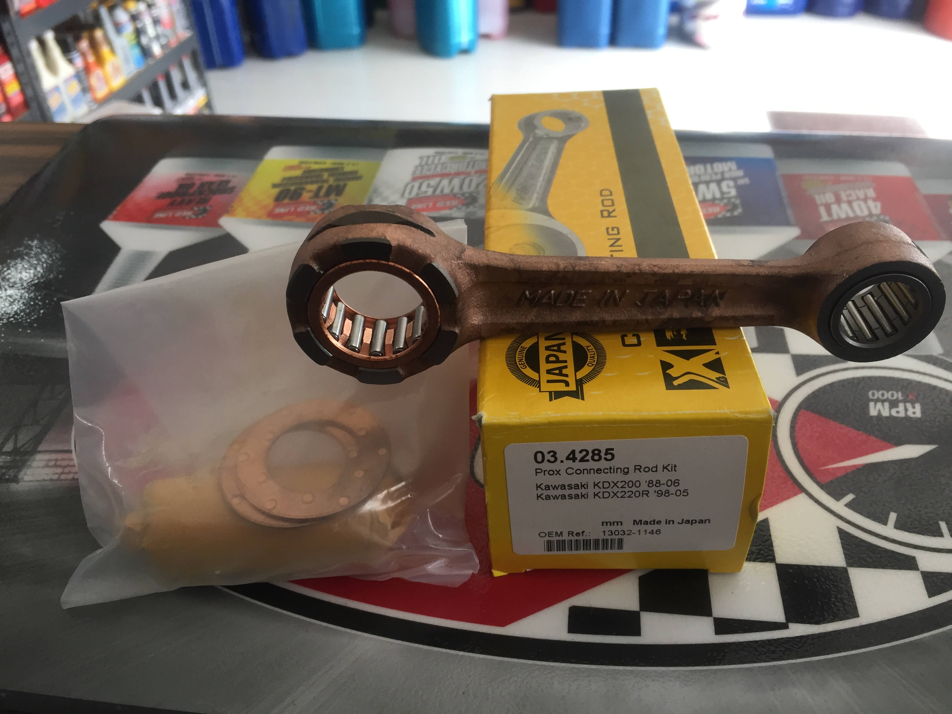

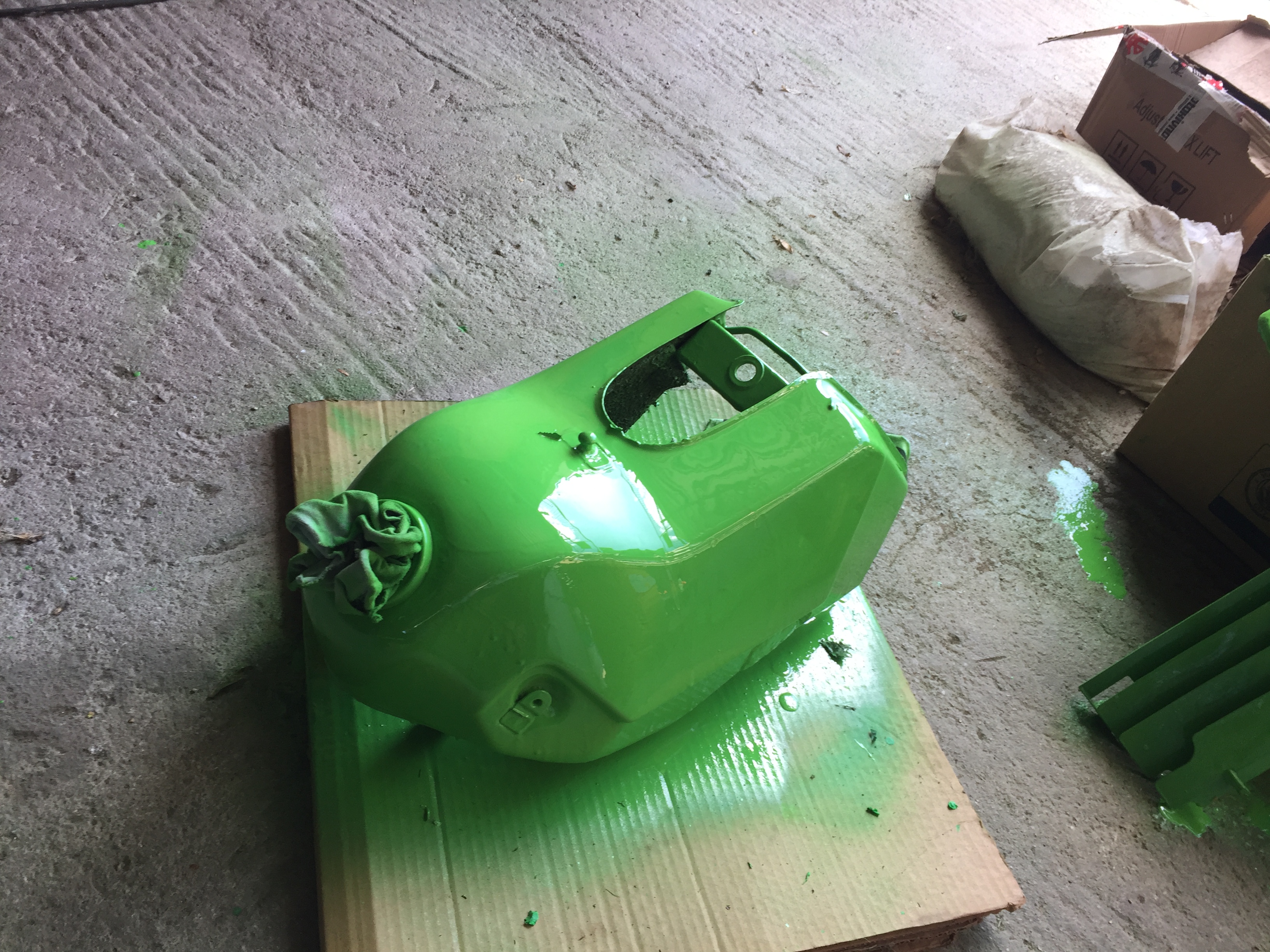

I’m waiting for lots of parts to arrive, mostly from the
USA
I will post updates soon I hope!
