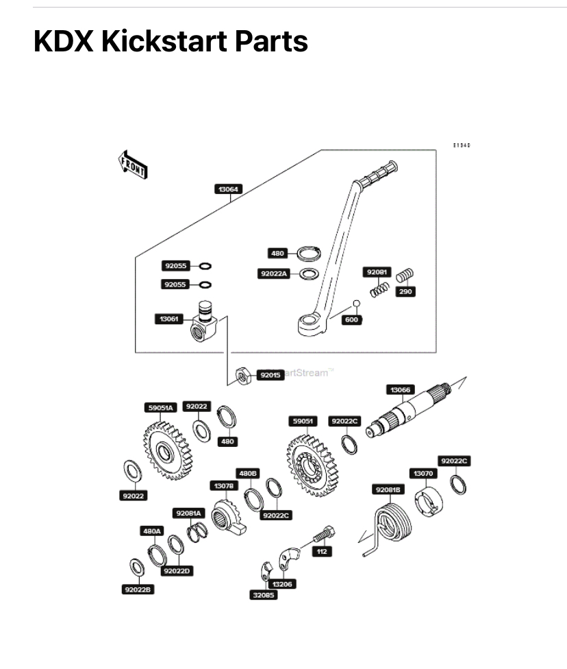

Last weekend my fine machine started the 1/2 - kick issue (Slip / slipping / catch / spring). And I think I am starting to wear out the lever boss with my mini kicks (when its cold).
Since I will be out of pocket for next 3 days, I am considering to order the parts ahead of time and throw the money at it, rather than do proper investigation first & make a hangar queen for this weekend.
If anyone has done this recently, can you please check me if these look right:
92081-1926 Kicker Spring - $12.18
13078-1063 Ratchet Gear - $65.22
59051-1224 Spur Gear - $100.35
92081-122 Ratchet Spring - $6.62
The diagram also shows another Spur Gear that i am not sure if needed to fix this or maybe is alternative to regular Spur Gear.
Is this also something I may need?
59051-1309 Spur Gear, 30T - $72.55

Revzilla Diagram:
- D61F0C4A-CABA-4ABB-A9D0-ECD55EA2AA49.jpeg (212.98 KiB) Viewed 4356 times
Re: 1/2 kick start issue - Parts Required?
Damn. I think I would try a new spring and sanding / filing the teeth before letting go of that much money.
13078 and 59051 in the diagram, not 59051A. Look at the two with the teeth to engage and slide over each other.
Yeah, check the pawls on your ratcheting gears and make sure they aren't rounded off. Usually the failure is the spring losing tension or the smaller gear teeth rounding off. You can use a file to sharpen the edges of the teeth. The only spring you need is the 92081A, the other is your return spring, so if your lever is snapping all the way back it is fine.
I bought kicker boss, spring, ratchet gear, gasket.
Kicker boss fixed it back to 90%+ good and another stellar 1/2-kick dead bike 2nd gear start, at last race.
So I will be waiting until winter or I have another reason to pull it apart to do the complete job.

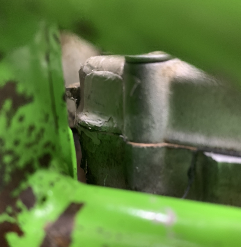

I got the kicker parts in and finally all back together.
Works good!
But I picked up a leak around the big clutch cover gasket, near the rear.
I think I will need to pull it apart and start over.
Do y’all have a favorite gasket helper goo that you like?
I used black form-a-gasket on 1 side of new gasket (like I usually do).
But am thinking maybe to try silicone on both side this time.
Any thoughts?

- Posts: 6117
You shouldn't ever use silicone on a dirt bike. If you really need a sealant then use Indian Head or similar.

- Posts: 3553
I have always run those gaskets dry and not had a problem as long as the mating surfaces are good.
- Posts: 6117
Yup, same here. If I do use anything, because I plan to be in it again many times, I only use grease and nothing else.bufftester wrote: 07:55 pm Sep 10 2021 I have always run those gaskets dry and not had a problem as long as the mating surfaces are good.

On closer inspection. It’s not likely a gasket sealing exactly.
I probably have a hairline crack in the clutch cover and would need to use a paint on sealer over the area, like the pre-existing condition.
Any idea what that white stuff bottom might be? I will keep an eye on the drip, and if gets too annoying will see if I can do something similar.
