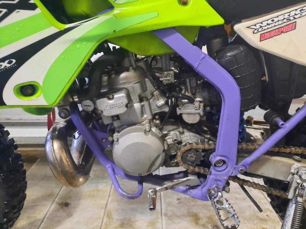

Hey guys and gals. Thanks for letting me into your group. I have a 2002 kdx 220r. Witch I love and I’m sure you all love the kdx machine. Just a quick question I’m looking for a case saver not mud bucket. Or some input to leave off. Also looking for new clutch cover other then stock. Thanks chris

Welcome to kdxrider.
Check on a front sprocket chain guard in case the chain comes off and flies forward.
(and the fuel hose clamp on the carb if you don't have one)
Hyde makes a plate, as well as Ricochet. I think they used to be called Utah Cycle Sales. Devol made (or makes plates). MSR (Malcolm Smith Racing was / is another.
If you can still get a Devol water pump guard, that might be something to consider also.
Cool frame!

Definitely want to get a chain guide and cover over that drive sprocket (cost you about 30-40$ but will save the case is you throw a chain so worth it)
Devol and Moose both make great skid plates, they'll set you back a hundred bucks, but if you do anything above easy trail riding its good insurance. Works connection makes a glide plate (a mini skid plate that doesnt provide any case coverage). Devol also makes some pretty nice radiator shrouds and a front brake disk guard.

I used 2 of the oem inner chain guides stacked together,works perfect and does'nt build up mud.

^^^^^I do the exact same thing as KDX633.

I have never heard of double stacking. A new one on me.
I know the plastic thing is a grass and mud catcher!!
