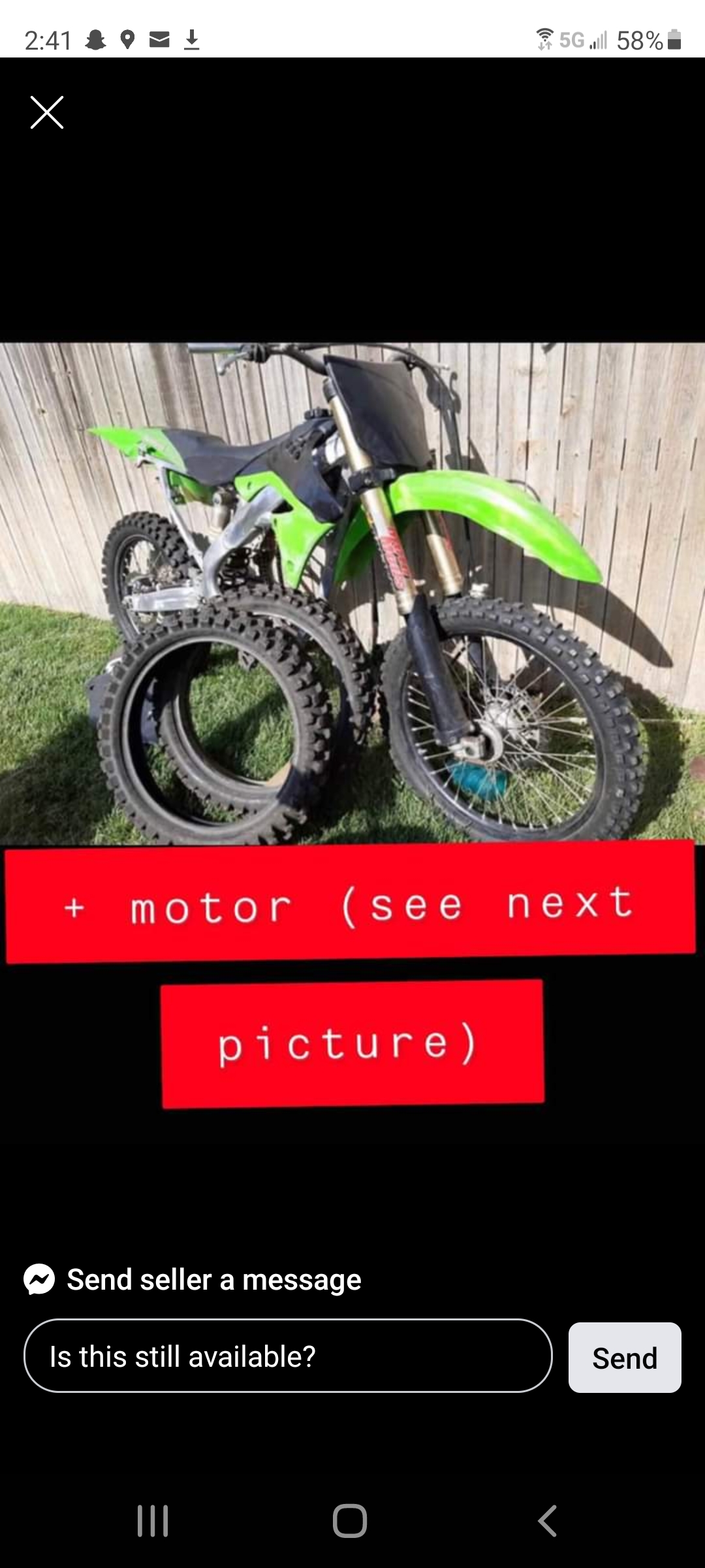

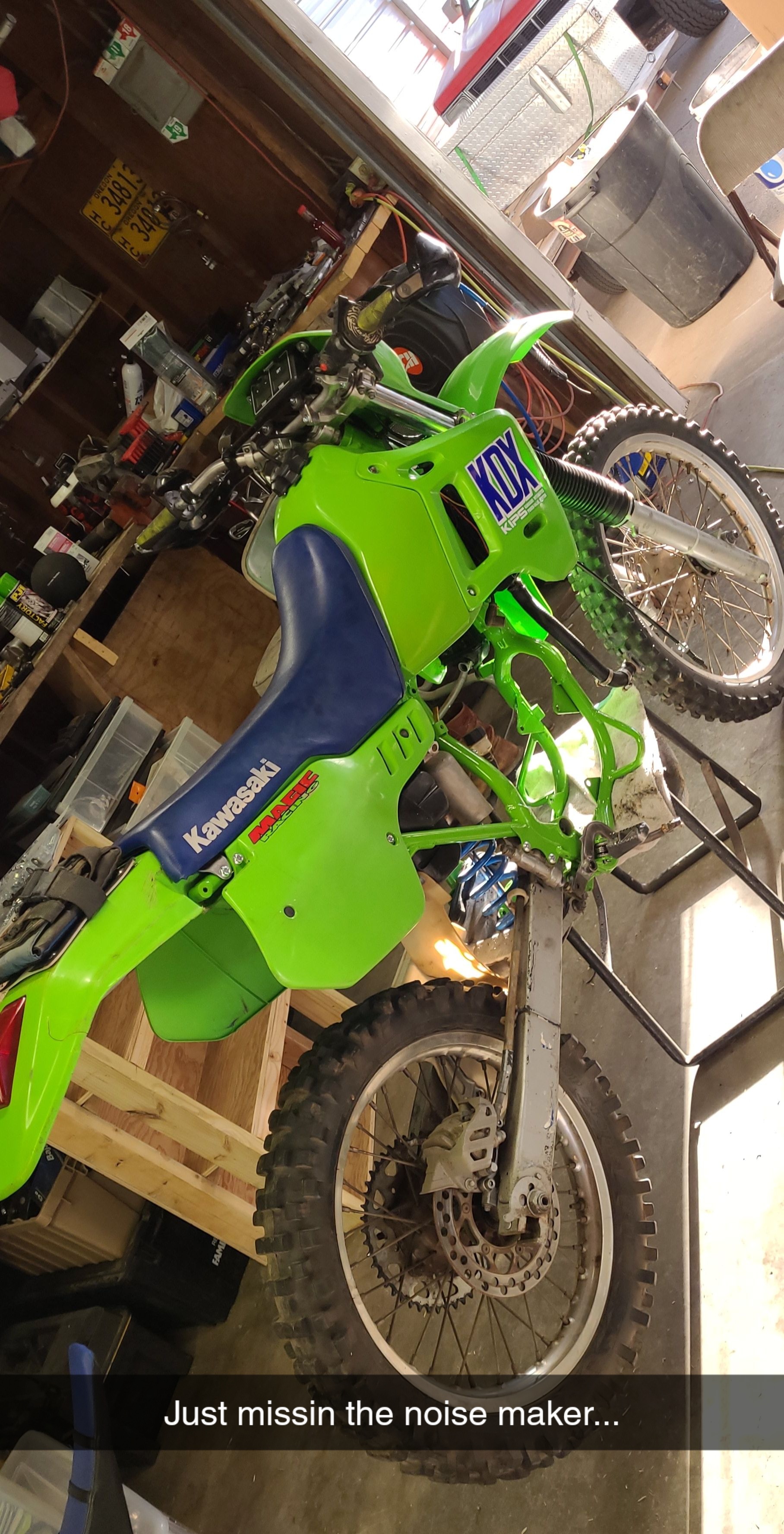

Title says it all, sorry if its been asked 1,000 time before. Trust me, I tried to find the answer on more than 1 platform and can't find a clear answer on anything other than 90's kx front end swaps. But I have a potential parts bike in the works. As title says, it's a 2014 kx450. Will my kdx stem press into the kxf clamp? Need to knurl? Need spacers? My recently acquired 89 is getting a face lift. Cylinder and crank just got back from Eric Gorr and I'd love to have a lil more modern technology between me and the rocks! Plus those inverted bronze forks look so nice on E series. Oh, and while I've got your ear, any other parts from the kx fit on the kdx? Rear shock possibly? I don't have it in my possession yet or else I'd just try it.

The answer to your specific questions are pretty much the same as someone looking to swap in 2004 or 1994 KX forks.
"Will my kdx stem press into the kxf clamp?"
Nope. It will slide in and fall right back out.
"Need to knurl?"
Yep.
"Need spacers?"
Yep, inside the upper clamp, about 0.025" shim stock will work.
You will also want to examine the area where the lower bearing goes. If you can get that cut down on a lathe, that would be great. The portion that goes through the lower KDX clamp sticks up when a shorter KX clamp is put on it.
Also, look at where the rear upper clamp bolts swing toward the front, upper portion of the fuel tank. Now imagine a MUCH larger sized clamp in that area. WHACK!! If you don't modify the steering stem stops to keep the handlebars from turning their natural amount, the backs of the upper triple clamps (and bolts??) will whack the tank.
The shock is probably way too big to fit in the area of a KDX. It's a 50 mm body with a corresponding wider spring. I think it would hit the airbox or airbox boot at some point in the travel when it compresses.
You would need the KX front brake system and front wheel.
On an "E", it is almost always a front end swap, not a front fork swap.
I have an aftermarket upper clamp on my 1994. It hit the tank until I filed it down a smidge. That is with 41 mm inner tubes. You are talking about 48 mm inner tubes with their 54 mm or so upper tubes.
