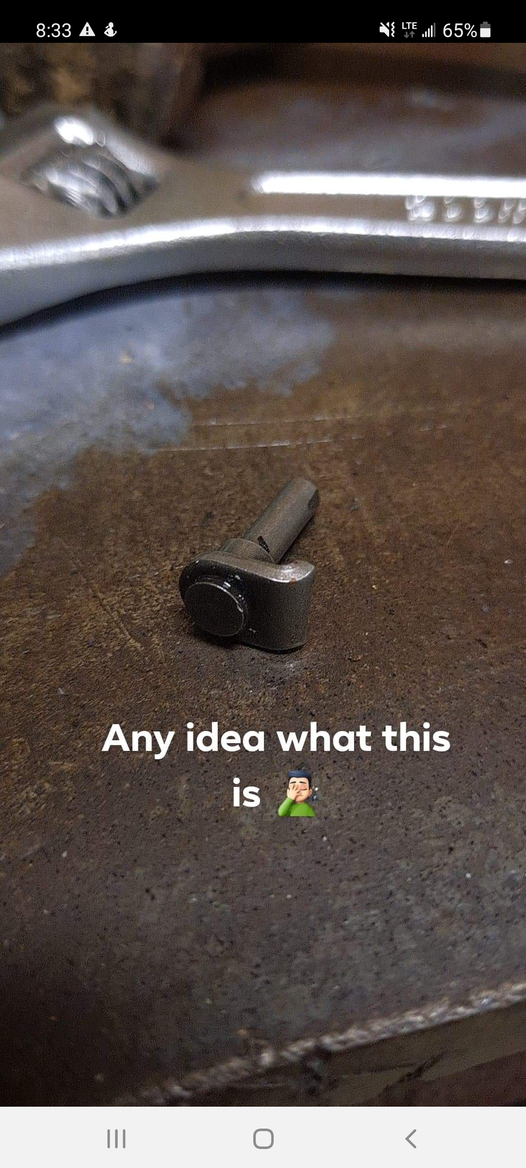

Does anyone know what this is?

Nope. Is it from a KDX? Does it look like it has part of it broken off or like it is a complete part?

Looks like the KIPS actuator pin part #13236-1260. It's a very common part to break if the KIPS shaft isn't supported properly when loosening or tightening the nut.

Thanks, that's it!

Welcome to kdxrider.net. That's the lever, as mentioned.
