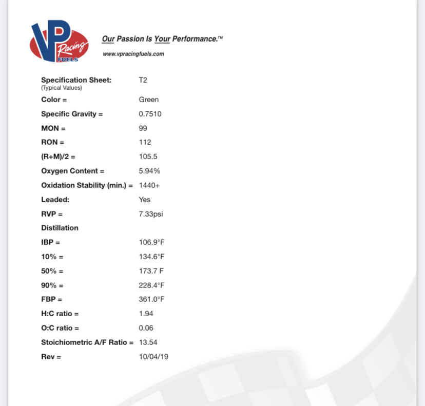

T2 40:1 is $85 for 5 gallons. I know the cost is way up there I was just inquiring about it. I know it is awesome fuel just didn’t know if that ratio was good for a 2000 KDX200

I see this particular fuel is leaded. Just might cause plug whiskering, which hasn't been seen since leaded gasoline went out of normal use.

87 octane non ethanol fuel is perfect for a KDX. Dump in some two stroke oil and ride off into the sunset.
Race fuel is designed for high strung high compression race built engines. It is formulated to run cooler and be less combustible to prevent preignition. Your KDX can’t make it burn efficiently. It’ll just dirty up your combustion chamber and pollute the environment.
Not to mention how expensive it is.
If for some reason you are compelled to use it cut it 50/50 with the lowest octane pump gas you can get. You won’t gain anything but it might satisfy your curiosity.
