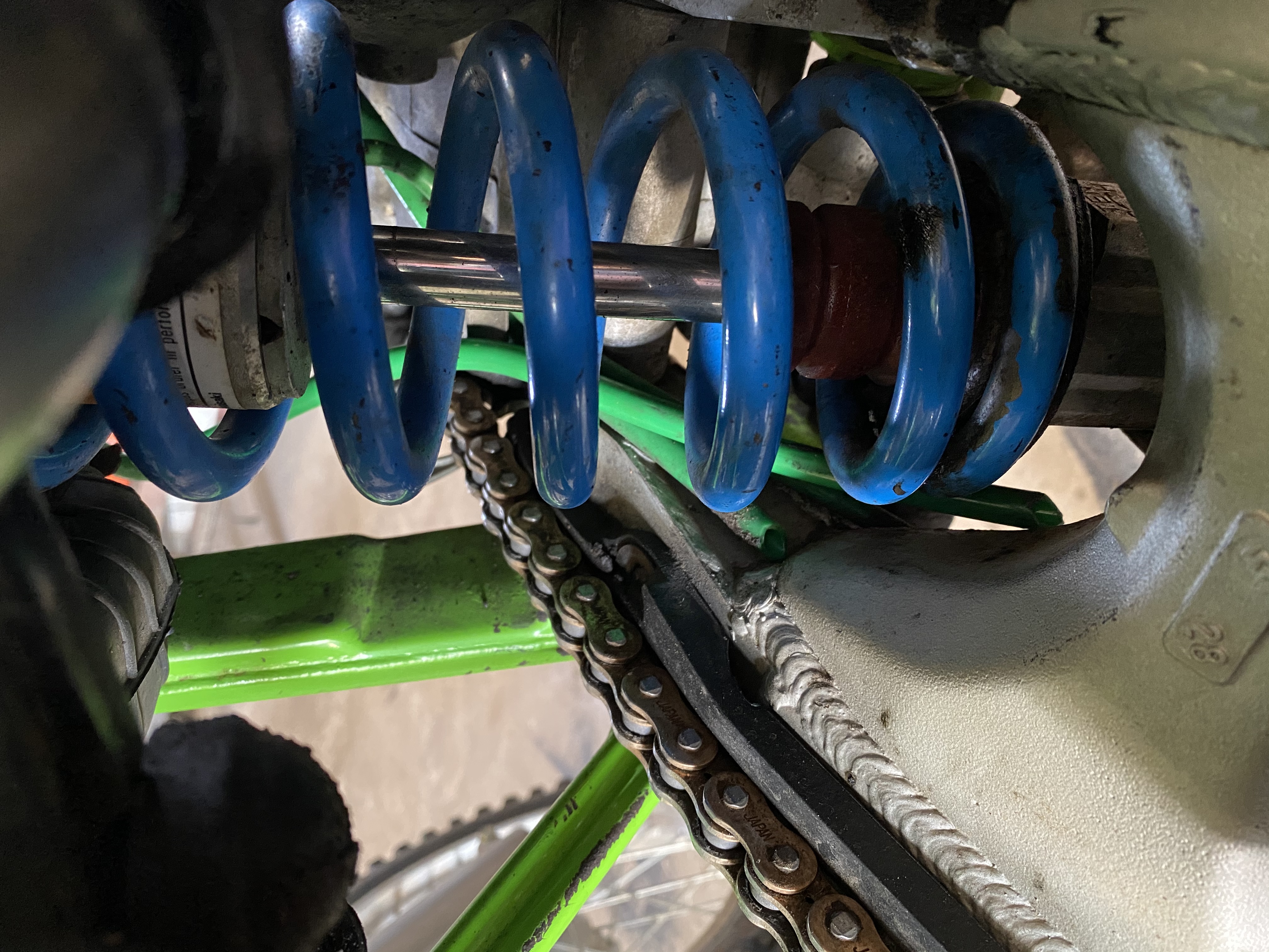

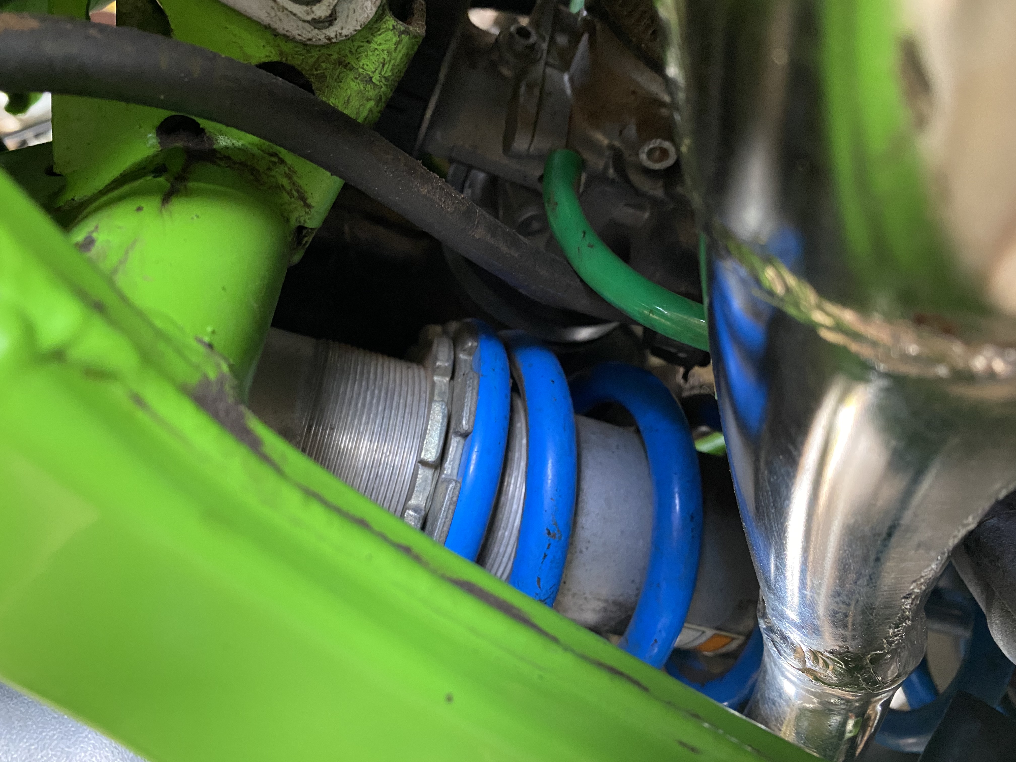

The bike height drops about 2.5” when I am sitting on it

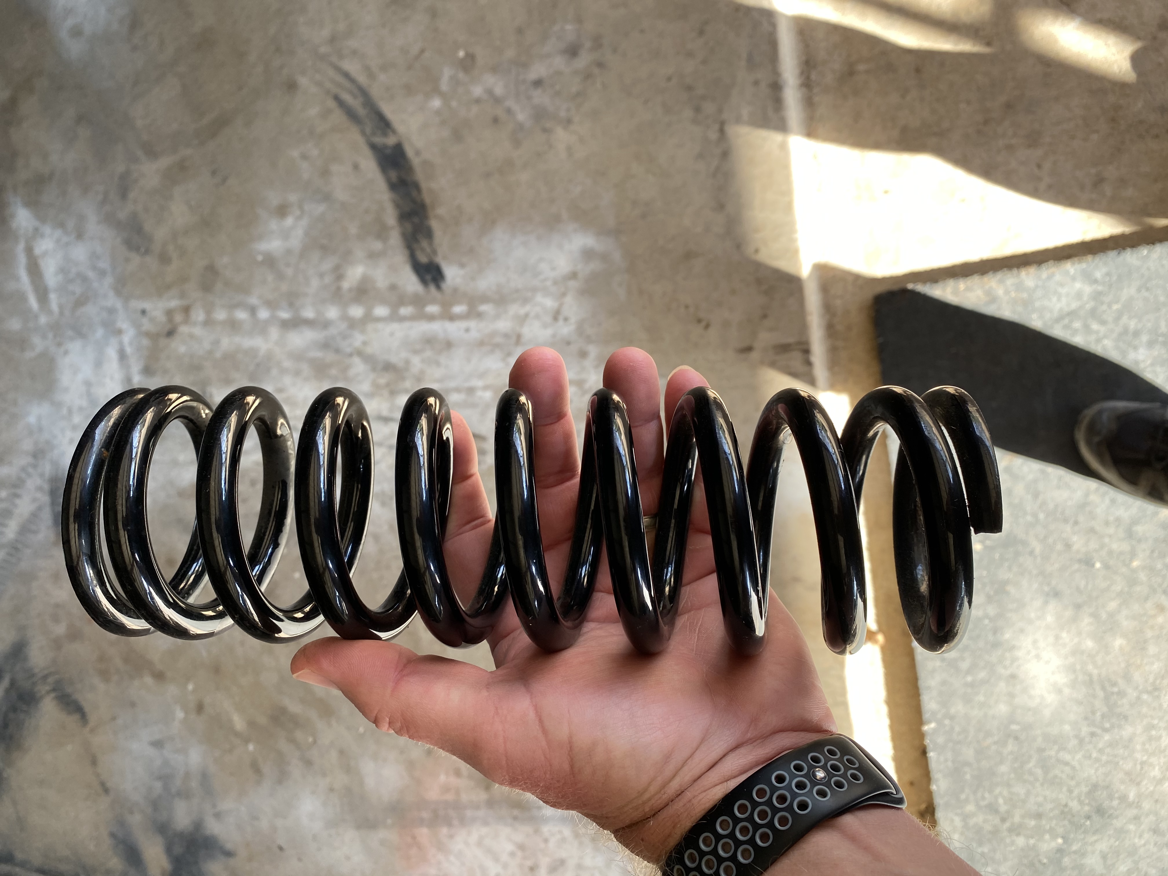

Re: Rear spring
Look up how to measure sag.
The black one looks mighty clean. Is it the exact same length as the manual says for a stock spring? Did someone paint a stock spring?
I'd measure static sag and race sag, then see where you are. Generally, if you are 225 or so in gear, then a 5.4 is about right.
175 pounds stock
200 or so 5.2
225 or so 5.4
ROUGHLY
ALWAYS... check the sag numbers. That is how to know for sure.
175 pounds stock
200 or so 5.2
225 or so 5.4
ROUGHLY

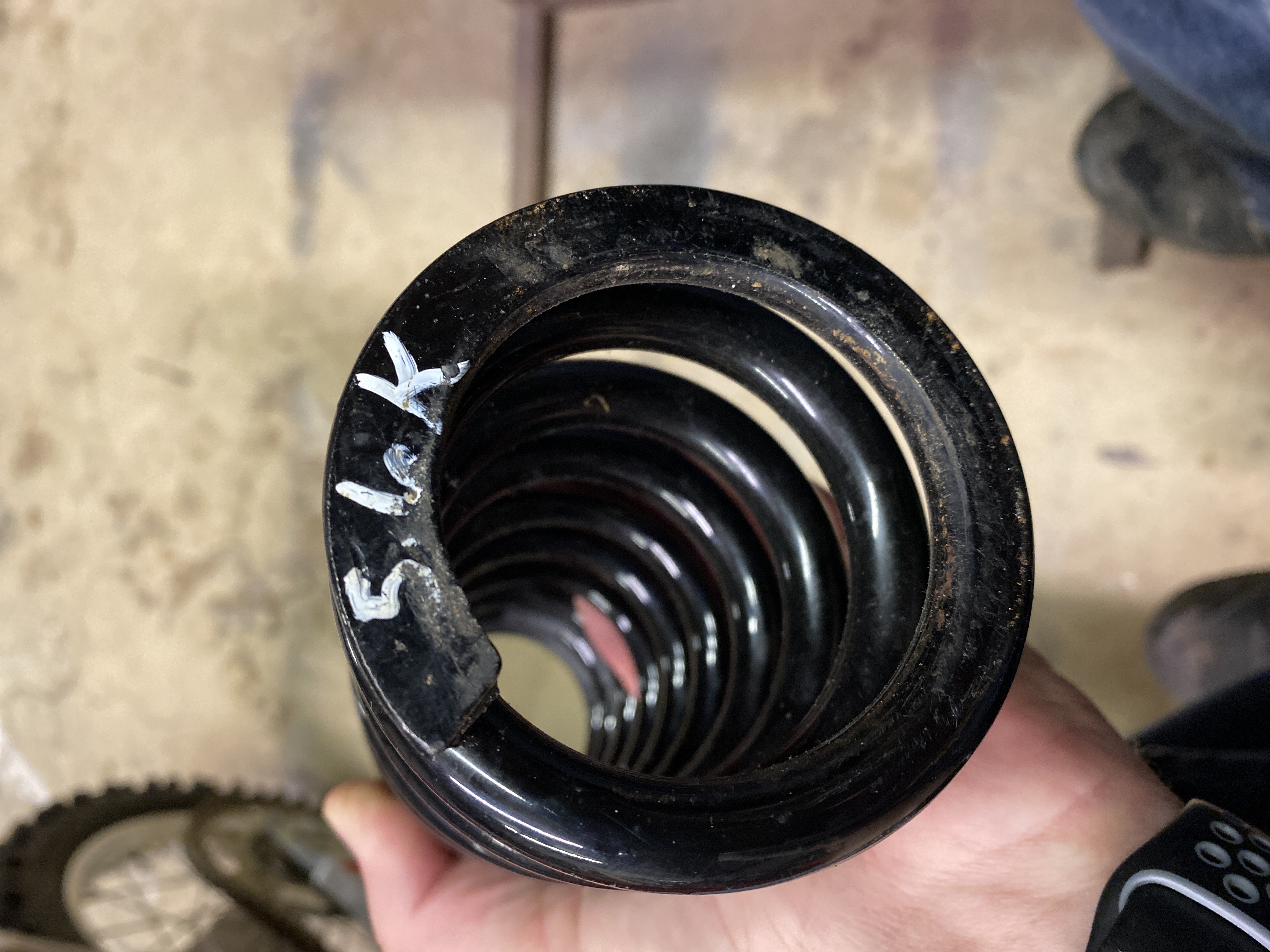

Just saw this on the bottom of the black spring
- Black

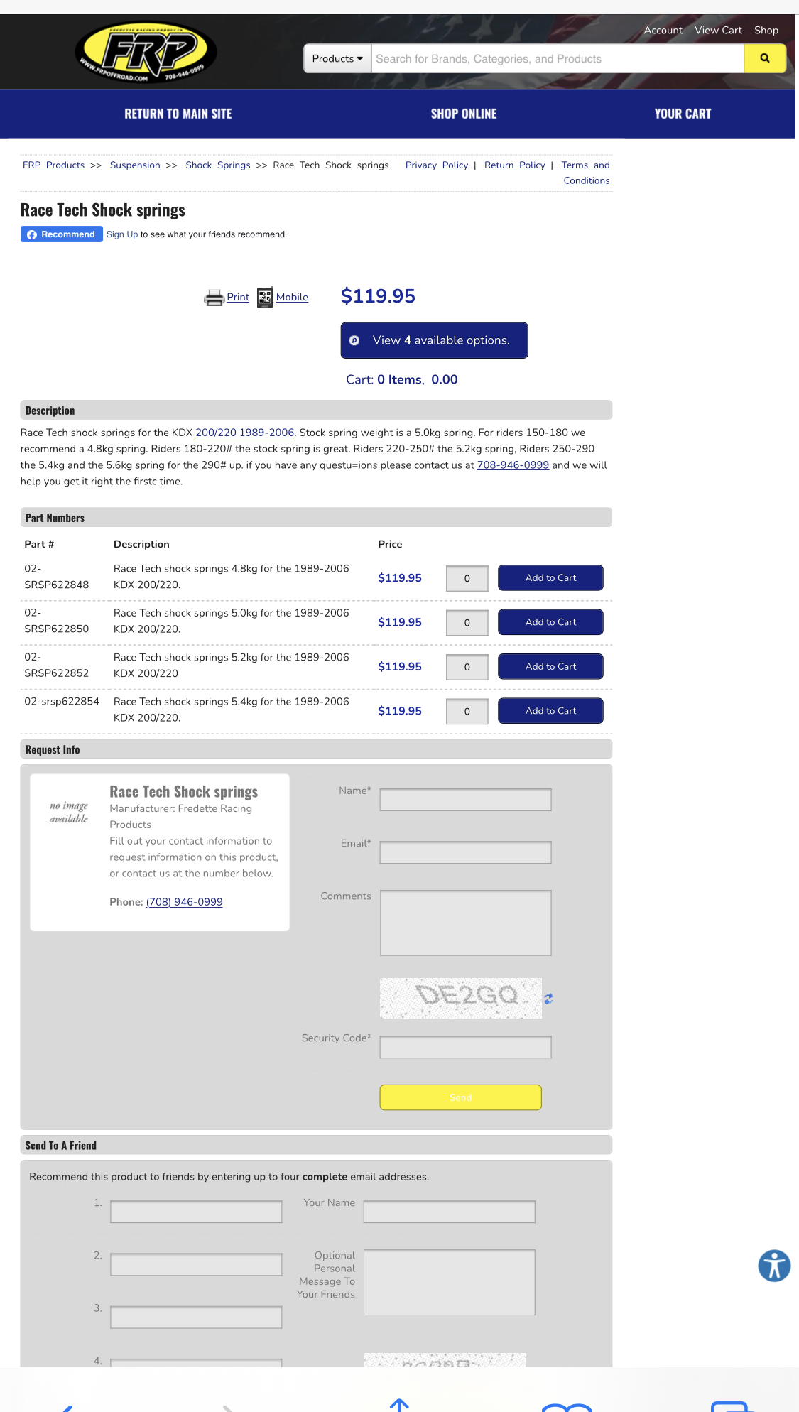

Fredette racing products (the KDX guru) actually recommends the stock spring for a 180-220lb rider. He also mentions 5.6kg for 290lbs plus rider. Honestly your front springs need more attention.

Re: Rear spring
You said you weigh 215. Is that with all your riding gear on or you in your birthday suit? Unless you ride in your birthday suit, I need to know your weight when you are fully "suited up", even if that is no helmet, cut off jean shorts, tank top and flip flops.
I am assuming you don't need a 5.6 spring (and matching fork springs).
kick, I think Mr. Fredette is off a touch on those recommendations. That's a bit wide of a range on those springs. Fork spring rate recommendations are another can of worms.
