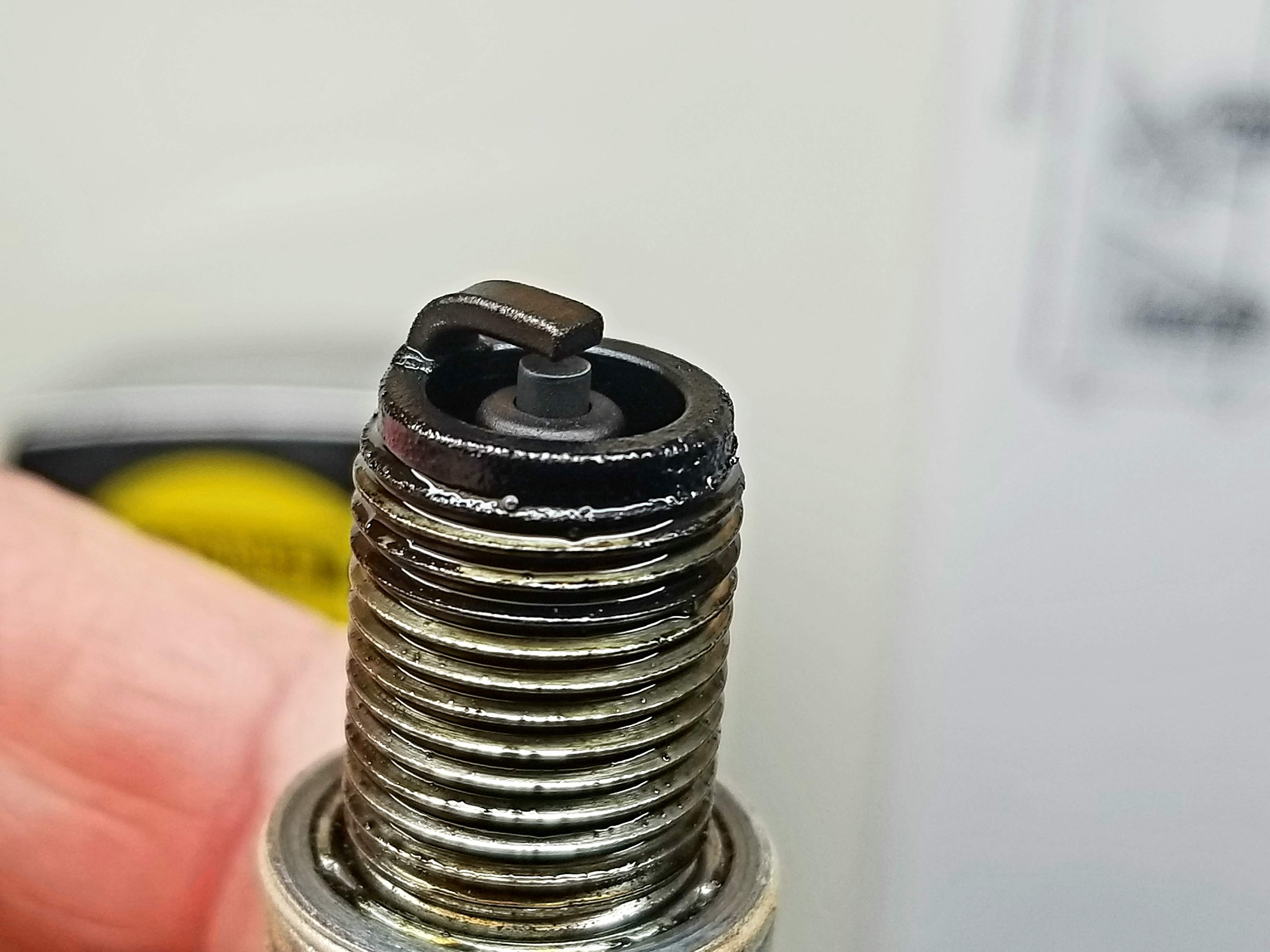

Just for reference, I'm attaching a picture of both my hotter BR7ES spark plug after about 3 hours of mixed riding, and a picture of the BR8ES after 10 hours of mixed riding. Note: Both pictures were taken with the same exact carburetor jetting. The plug on the BR7 gives me mixed signals though I would say, because the insulator looks like it's running lean to me, while the end of the threads are black with unburnt oil. Is this normal on a 2-stroke?
Here's another detail: Both plugs were burning regular 2-stroke oil, nothing fancy like synthetic or smokeless 2-stroke oil. That may be why it's so black around the end of the threads with unburnt oil. My next batch of fuel is going to be fancier, synthetic "smokeless" 2-stroke oil.
Does anyone have a favorite, cheap 2-stroke oil that leaves a minimum of black oily deposits in the cylinder? The less black gunk the less often I'll need to clean the KIPS system too ;)

Respectfully, Something sounds wrong. You say your "air screw" is seated all the way in? If it were me, I'd go back thought the jetting guide. I know all bikes are different, but something just does not sound right.

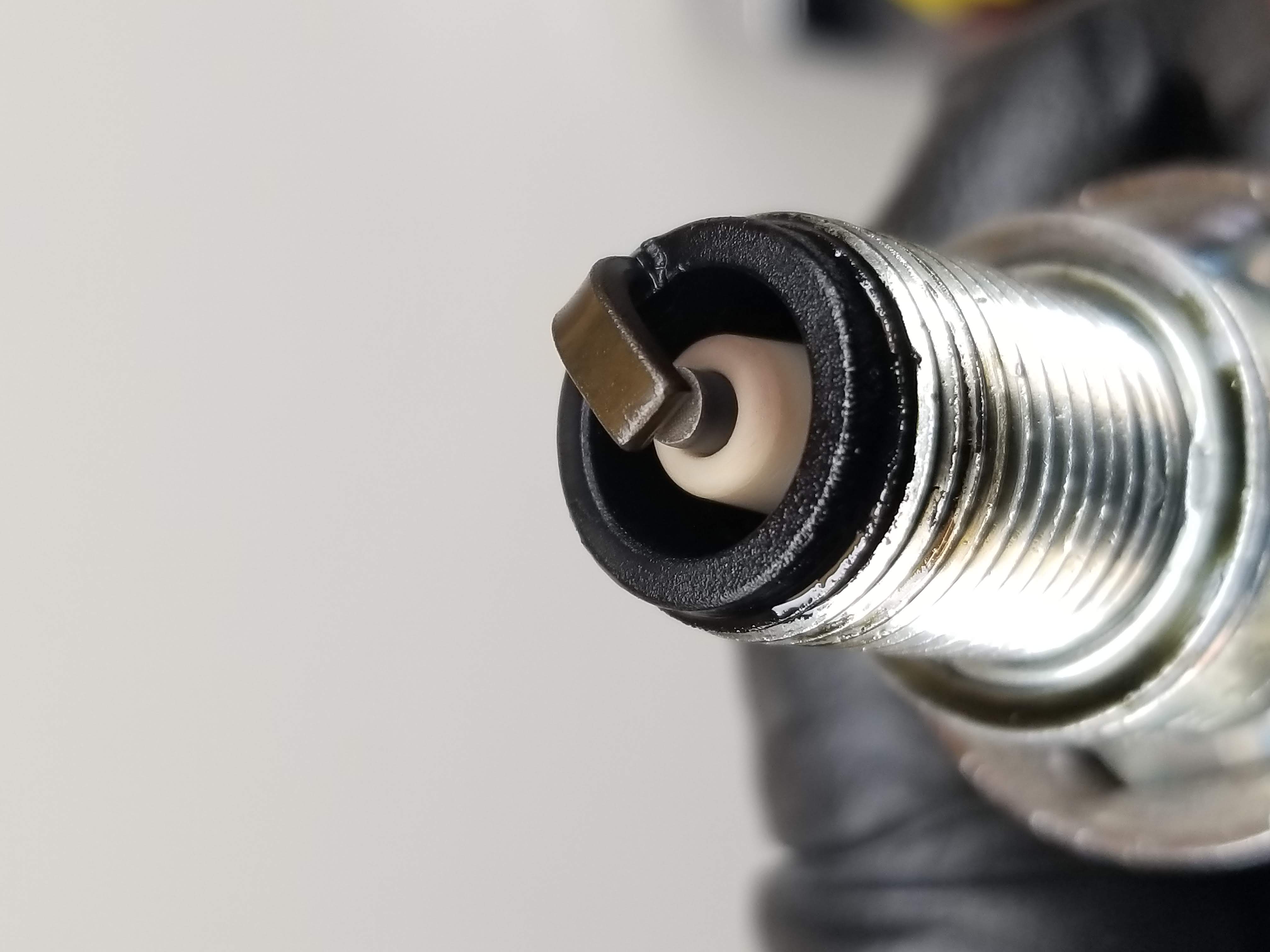

Just for reference, I'm attaching a picture of my BR7ES spark plug after about 3 hours of mixed riding. The plug gives me mixed signals though I would say, because the insulator looks like it's running lean to me, while the end of the threads are black with unburnt oil. Is this normal on a 2-stroke?
Just an FYI, bikes run really crisp and powerful running lean right up until you melt a piston. That plug shows you are on the lean side but at least it isn't pure white.

That plug is too hot!! PLEASE put an 8 in there ASAP.
PLEASE look up proper spark plug temperature pictures. Don't look at car spark plug pictures, but two-stroke dirt bike plugs. It should be a light chocolate tan.

Thank you. You're right. Actually since this picture of my spark plug was taken I went two steps richer on my pilot jet and one richer on the main jet. I'm now at a size 50 pilot jet and a 160 main jet. Now I finally feel the engine is jetted absolutely perfectly, because the "second sweet spot" for my air screw while riding is at 1.5 turns out. Now it's nothing but smooth, linear power delivery from below idle speed all the way up. ...Well there's a nice little "on the pipe" feeling that starts in the upper midrange but besides that there's no more steps in power output. No bogging, no hesitation at any throttle opening at any RPM. And just for reference in case anyone is wondering, my elevation is about 3300 feet, and average daytime high of 45 degrees F.Molly's 70 wrote: 03:14 pm Feb 22 2021 Respectfully, Something sounds wrong. You say your "air screw" is seated all the way in? If it were me, I'd go back thought the jetting guide. I know all bikes are different, but something just does not sound right.
I think I'm finally feeling the way this engine is supposed to be. It aught to be, damn it, with a brand new $380 RB-modded carburetor and a COMPLETE (upper and lower) engine rebuild by a reputable motorcycle shop here in town. Even then it took me about 15 hours of riding and fiddling to get to this state of perfect tune (I added an engine hour meter).

I'm really shocked you are that far from RB's recommended jetting. I'm at 2000ft and run a 152 main and a 38 pilot.

Thanks for looking out for me KDXgarage, but I've got to experiment at least a few more engine hours and do some more tests with this hotter spark plug. Wish me luck my friend. I choose to boldly go where few men dare to travel. And I have to fill my brain with the data that it's thirsty for, while everything is working and running properly.KDXGarage wrote: 03:54 pm Feb 22 2021 That plug is too hot!! PLEASE put an 8 in there ASAP.
Speaking of which, I did spend quite a while on the web earlier today, doing Google image searches, trying to specifically look for 2-stroke spark plug condition chart. Couldn't really find one. If you have a 2-stroke-specific plug chart image/link, I'd love to take a gander at it.

Which exact oil are you using? What gasoline?
The plug should be tan. It may change color with a new plug and different oil.

As to the 2-stroke oil I was using for pre-mix, I think it was something like Ace Hardware 2-stroke Oil. Was nice and cheap though! When writing about the new fancy oil I got, I'll make sure to mention the brand and exact name.
The gas I was using during all this testing was ethanol-free premium. I'm going to switch to regular premium fuel though pretty soon, because I don't feel like paying double the price for gas for 3% more power.
I will try to get to a nice tan on the spark plug insulator nose. Do two-strokes pretty much always have black carbon deposits on the tip of the threads, around the insulator though? Seems like all the pictures I see online pretty much look like that. Black-and-dripping though, seems bad/unnecessary no matter what.

If it were me, I'd try a bottle of this. https://www.amsoil.com/p/dominator-synt ... g-oil-tdr/ or https://www.amsoil.com/p/interceptor-sy ... e-oil-ait/ mix 50:1.
Re: Spark plug heat range question.
I think the little oil ring is pretty common, just the way things go.
The cheapest oil is not always the bestest oil.
- Posts: 6117
A good affordable oil is Lucas semi-synthetic. It can be found at a lot of auto parts stores and is right at $10 a quart. I run it at 40:1 (approved for 50:1) and my bike runs clean with a nice tan spark plug. Just a heads up, pick a ratio and stick to it. All of your jetting is affected if you change oil ratios.

I'm having the opposite affect on my plug after 5 hours. The bike runs excellent (without any lean bogs) and the porcelain is a nice tan all the way down but the top of that ring is shiny new looking. The max coolant reading after a few days of lugging a gear high in deep sand twisty trails was 189. I'm used to that ring being dark and don't know what to think.
