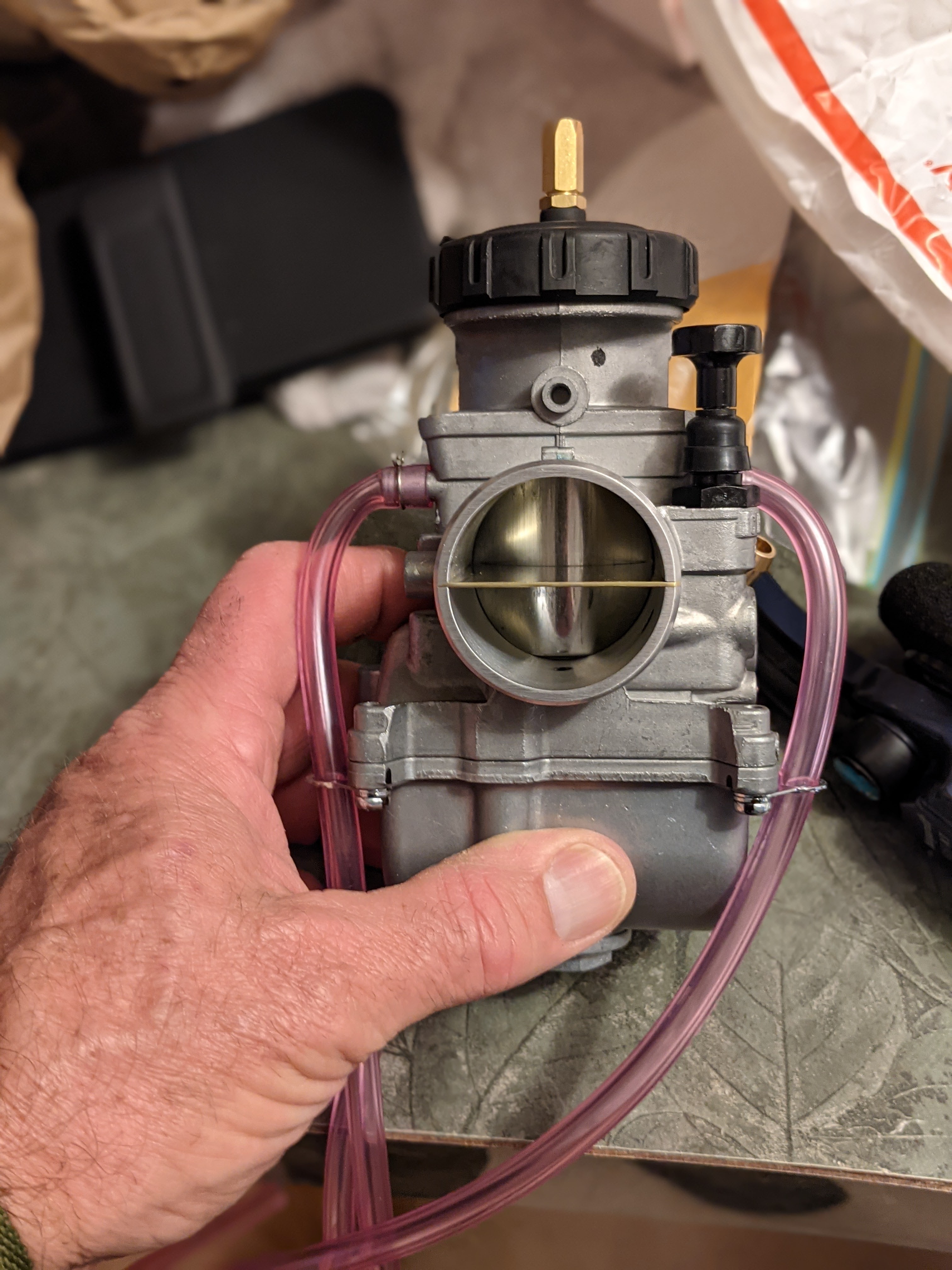

I finally decided to aquire an RB modded OEM carb. From sending an email to and getting an email from Ron Black suggesting that I move quickly as the limited number of carbs he has will go quickly was about a day.So I mailed the money order that night. It took about 10 days to hear from him initially.
Turn around time was a week, which had to include the time it >|< took the money order to get to him. Incredibly fast! Extremely well packaged. Excellent and easily comprehended instructions on dialing it in. Beautiful carb.
I'll get it on this weekend and ride. I am very excited and looking forward to a different KDX under me ( or on me when I hit the ground) and will follow up with a report.
I am posting pictures so hopefully they'll show up.

Nice, I think you'll be pleasantly surprised by its performance.

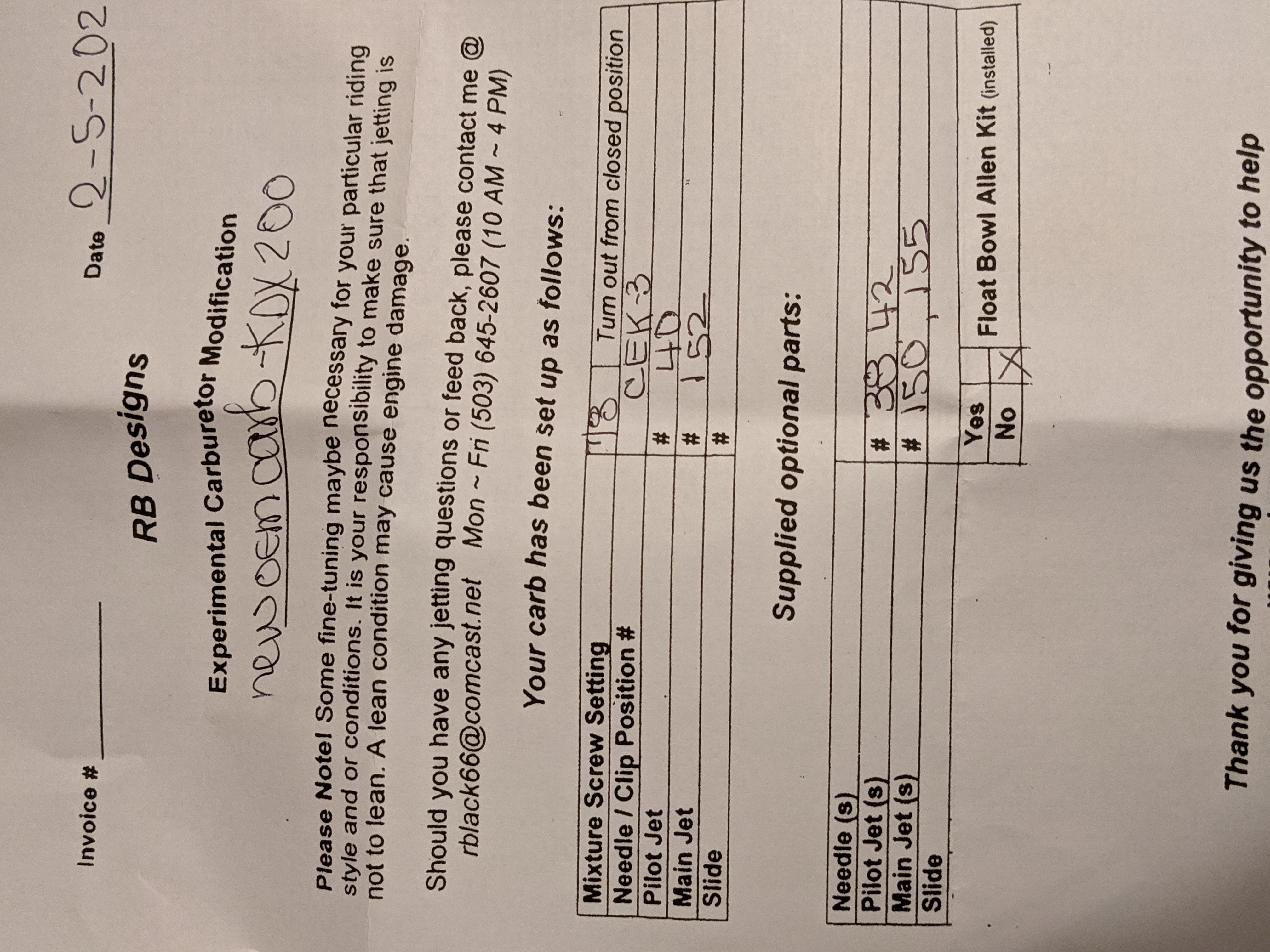

For the Goat-
These are the jets Mr. Black installed and included.

Looks like it started same as mine.
I did find a 42 was accidentally installed.
So far, I settled in at 150/38, clip 2. And she’s a screamer.
But am willing to fiddle a little more.

RB's jetting is pretty close IME. I did end up up going one size smaller on the main and pilot and my bike runs crisp with no spooge.

I got carb on and dang there is noticable difference. Started 1st kick. Pulled from 2nd gear uphill strongly. Sounds great. No where near the smoke I had before.
I'll know more after tomorrow's ride with young riders on modern bikes.Beyond expectations after my 2 mile ride this evening into dark.
