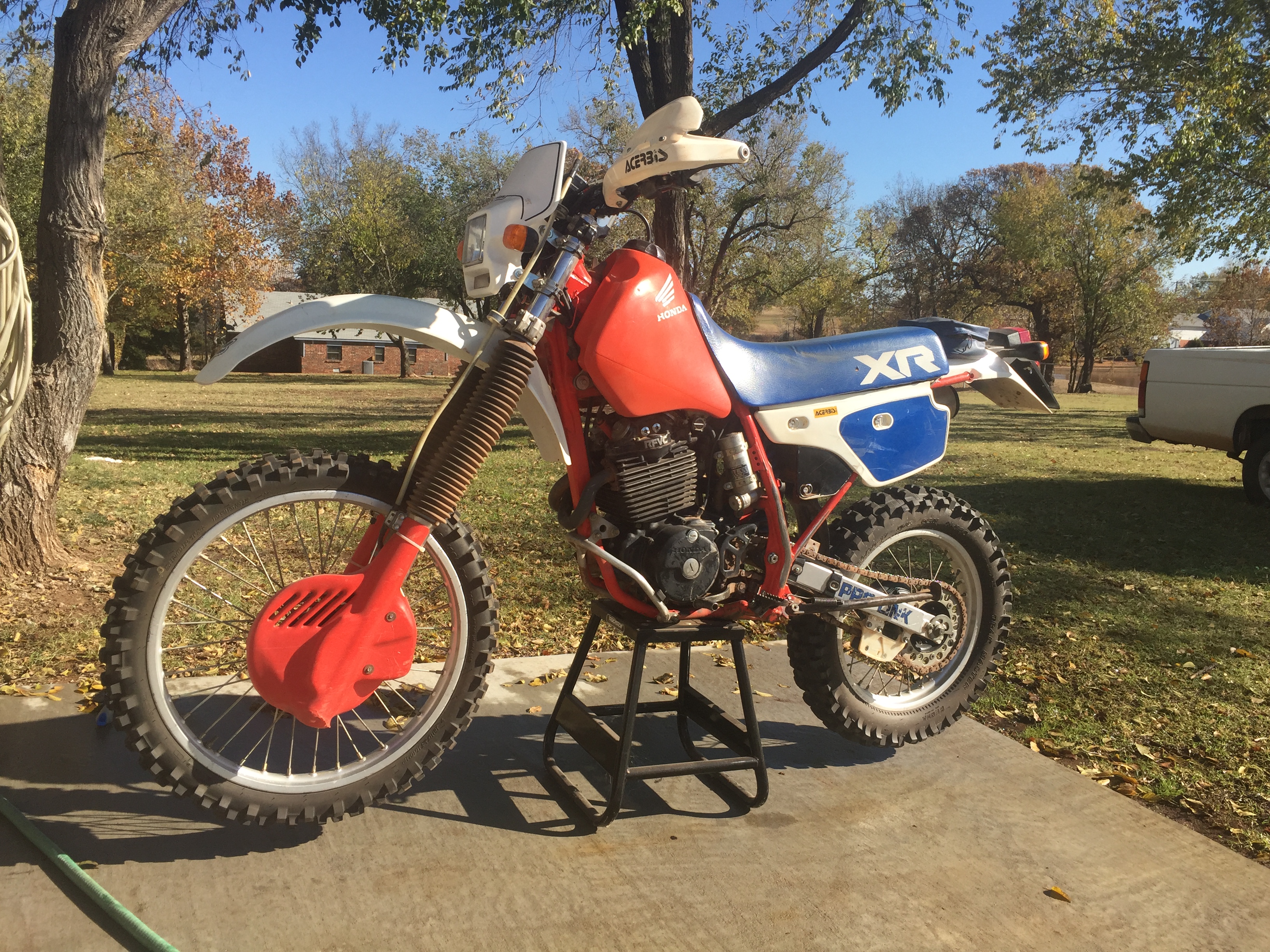

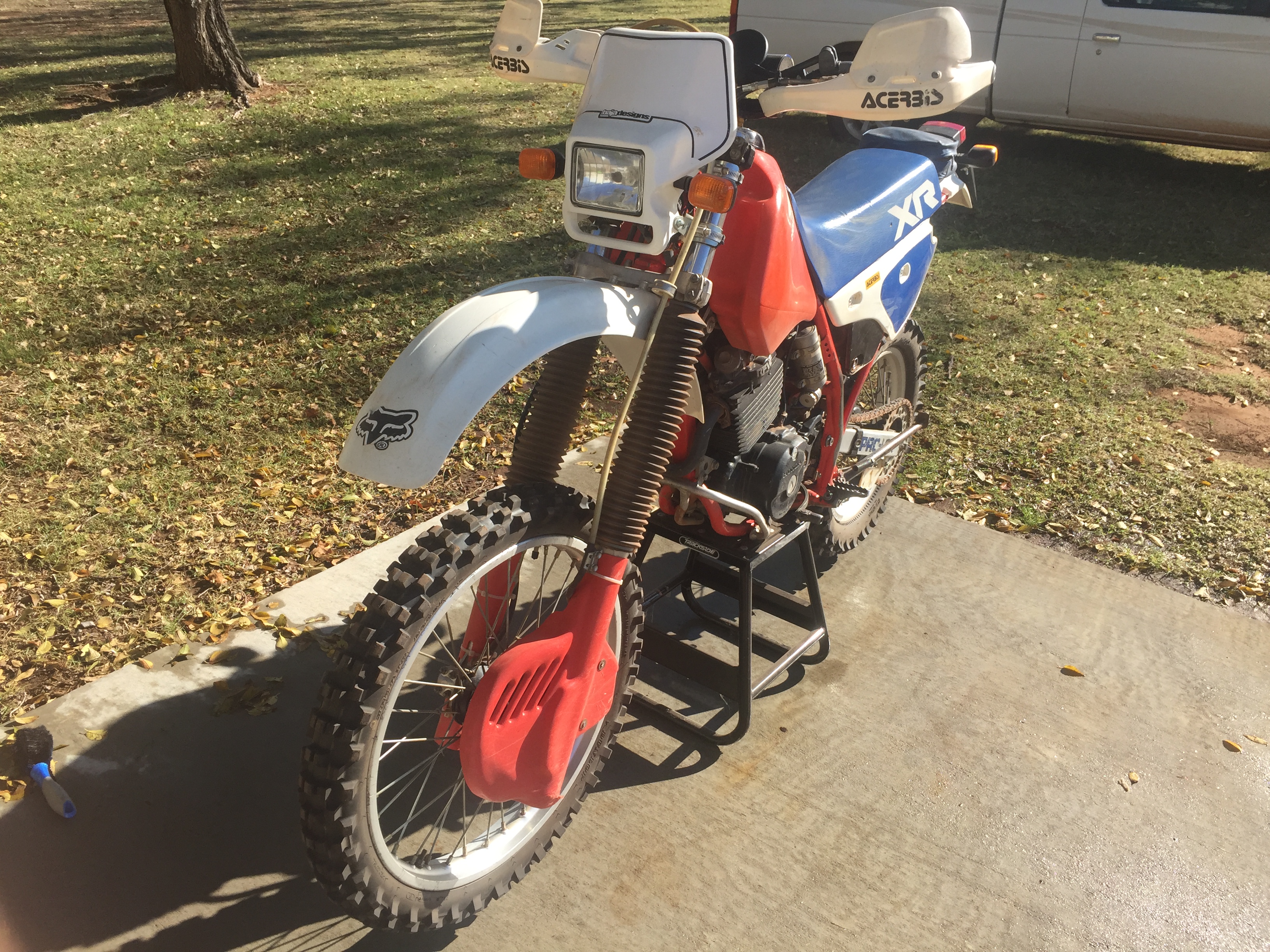

I used a Baja Designs kit. It had everything I needed. It has a battery in the headlight shell. I’ve had it on my XR for at least fifteen years. It’s been pretty reliable.
Tusk offers a less expensive kit but I don’t know if it has a battery.

Nice XR. I had a 86 Yamaha TT600 that was plated. Big bore thumpers are very capable. I rode tons of single track and sandy whooped out trails with that bike.

It’s the only bike I’ve ever owned that I can come into a sandy whoop section way faster than my skill level allows and it will never get unsettled and start swapping. Sometimes it makes me look like I know what I’m doing. lol

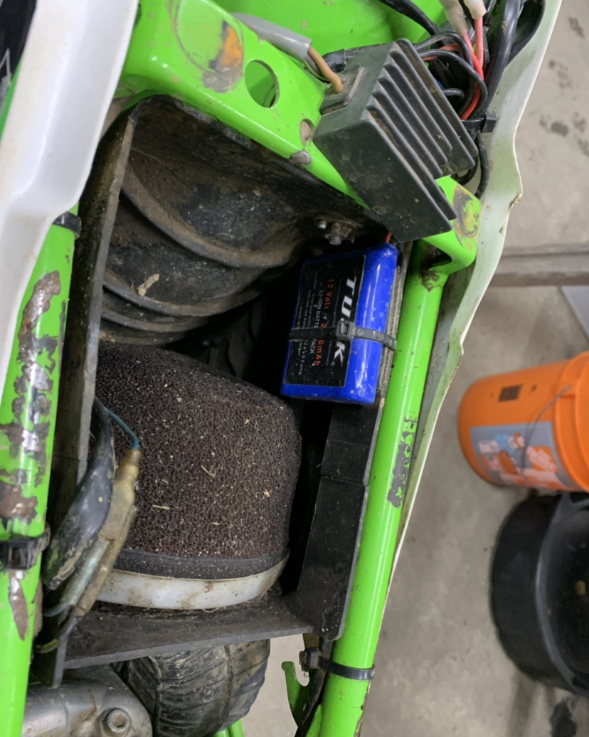

I also use the Baja designs. It has worked well. Battery is about size of card deck.
I did do a little custom wiring on headlight so that it runs off the bike like normal and then ground high or low thru the switch to make aftermarket headlight go hi & low. So battery lasts a long time.
I have ended up doing a lot more MX track riding than street riding, but it does work. I have replaced the battery 1x, but do not know how long old one was there.

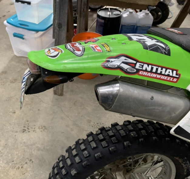

So you run the headlight off the stock KDX wiring but the tail/brake light and blinkers off the battery? I hadn't even thought of that as a way to increase effective battery life! In that case the Tusk kit would be a good choice. It doesn't come with a headlight but I like the way the blinkers, esp the rear, mount up.

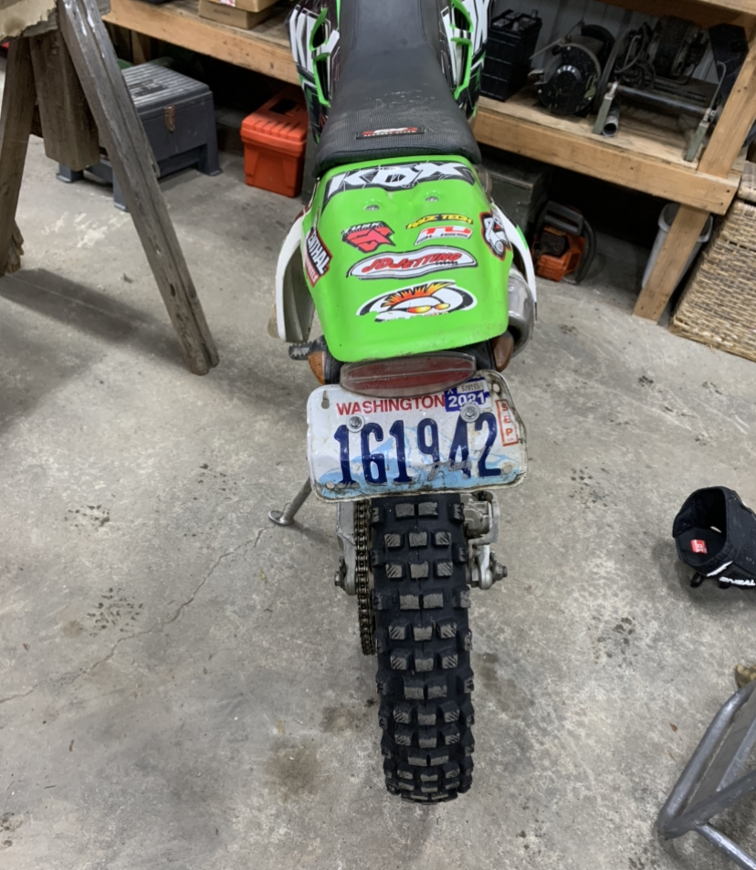

Correction: I have the Tusk kit.
Yes headlight is wired from normal bike power and then I used the Tusk switch for Hi/Lo/Off on the ground side of the headlights. Goes against my proper design philosophy. But works good.
The battery charge seems to last ages. But must admit I don’t really use it much.
Posts: 720
Joined: 03:22 pm Oct 22 2019
Location: Clinton, WA
Re: street legal light kit
Post by Goat »
I’d also give tusk thumbs up for still working. I pretty much beat the tar out of my bike, and lights keep working. I am tempted to remove the lights (at least rear) since I am always dragging back end on something and crushing the plate, to see if I’d miss them. But my tabs are still good, and it works as a fender protector.

The battery is mounted with tape on Velcro & zip.
