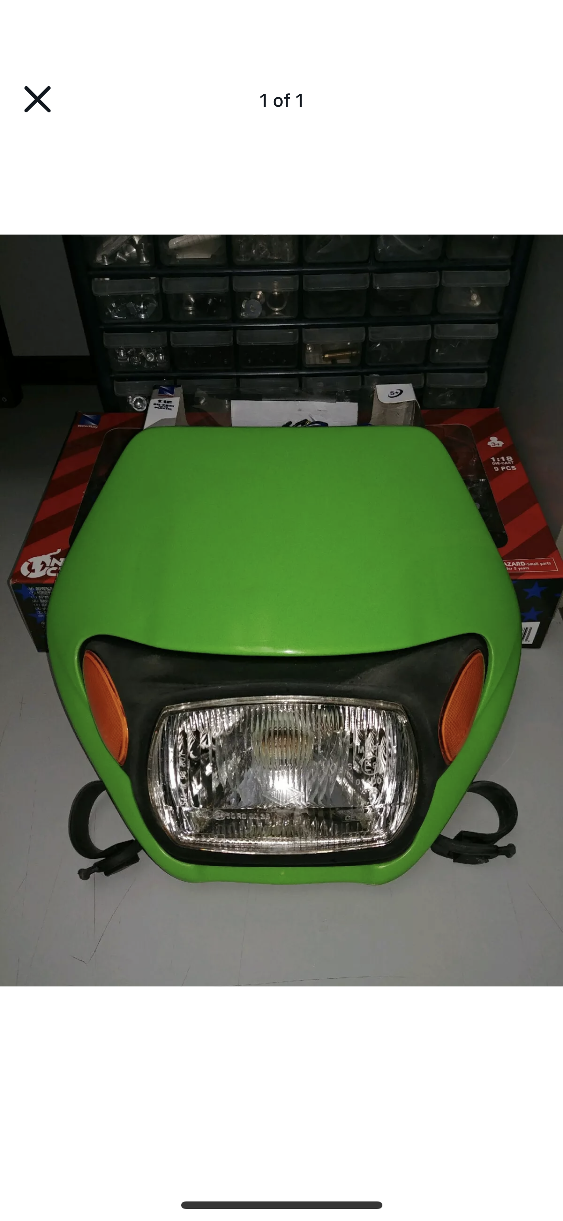

I picked up this Oregon ufo light on eBay. I got my bike plated so I may get the blinkers working eventually.

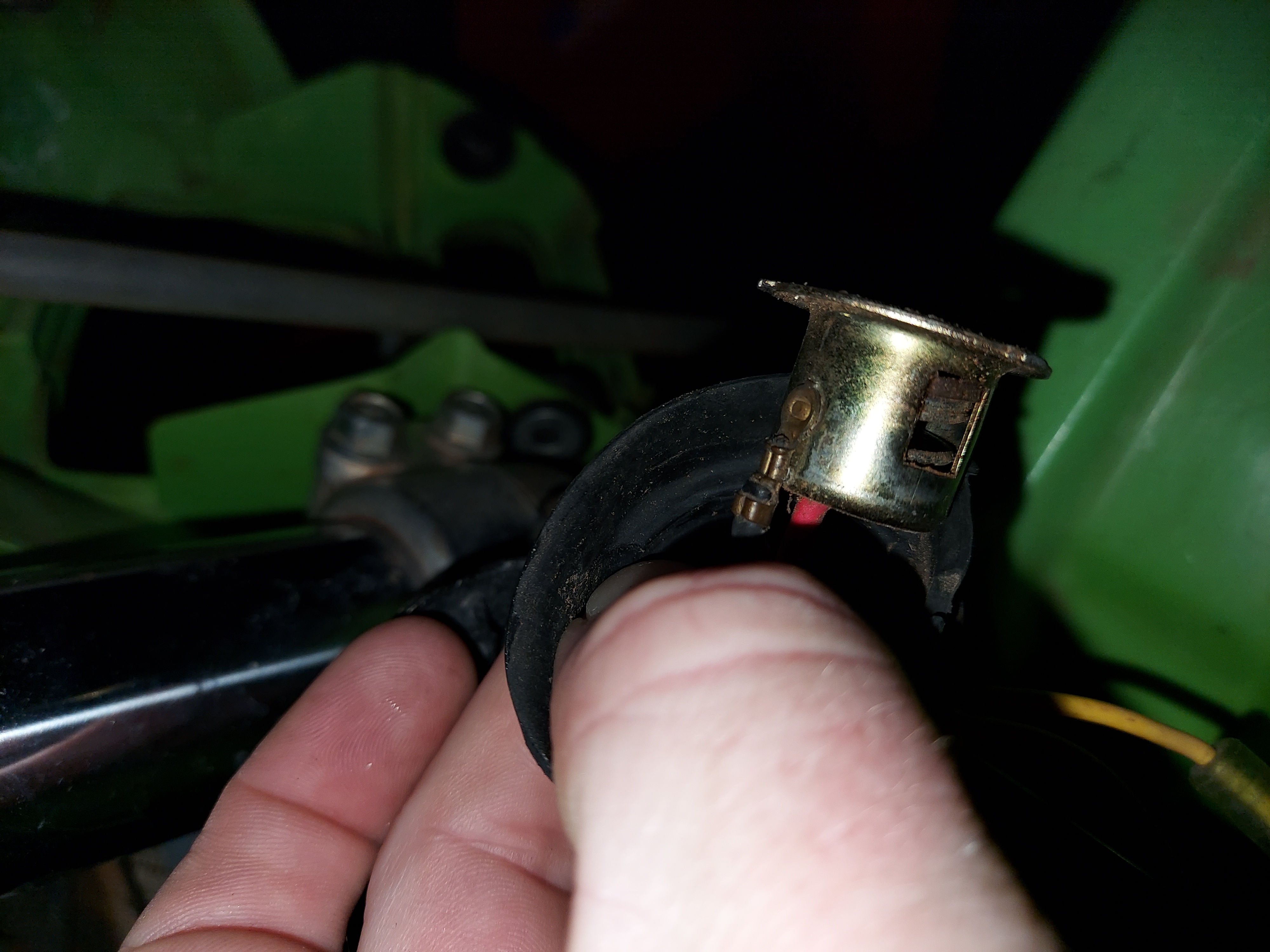

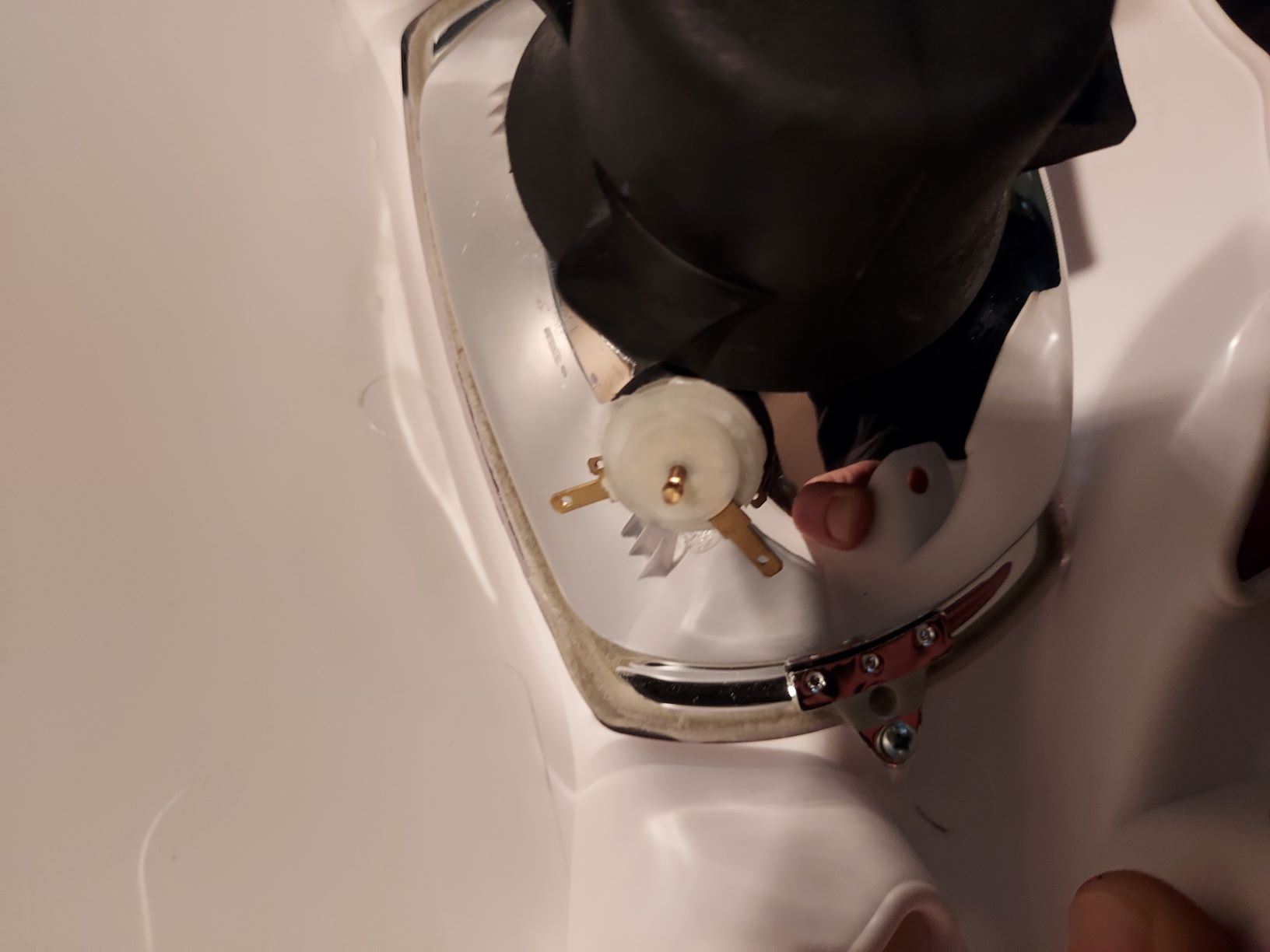

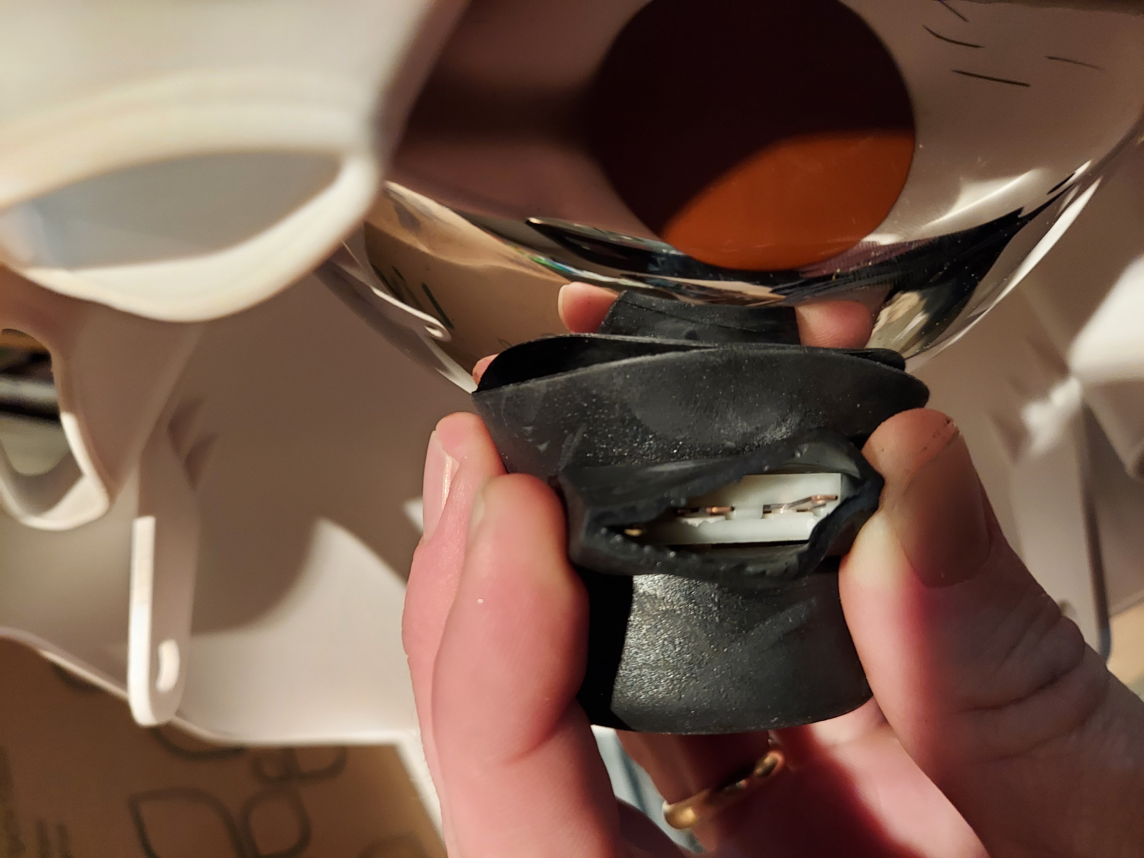

I got the Acerbis DHH in today. I realize I'm going to have to wire up some connectors. Problem is...I'm a complete doofus when it comes to wiring (or anything electrical for that matter). Any input on how I need to wire these up and what connectors to use? Do I wire both lights? I only have an on and off switch, not a high beam, low beam.

With the stock wiring and switch you can only have low or high, not both. The benefit is that you can mostly keep the OEM wiring intact, the drawback is you only get hi or lo. You would take your existing bulb socket and either cut it off or use tap splices to run the black wire to the ground terminal on the new headlight, and the red wire to either the lo or hi terminal on the new headlight. The weird white connector that is kind of on the side of the housing is a position light and you don't need it so ignore that part. The bottom pic is the headlight connection and should be three terminals. You just need to get crimp on spades that fit (Autozone, Napa, etc carry them). I have one of these DHH lights somewhere, I'll have to look at it to see if the terminals are marked or not.
If you want hi/lo/off you would need to get a 3 way switch (Trailtech and Moose make a nice combination headlight/kill switch) and wire it according to its directions

Thanks bufftester! Great info. I was wondering what the white connector was for. Glad I don't need it. I think I can figure it out now if I can find the right spades. I stopped by Napa yesterday, but all the ones they had were way too big. Go figure. Anytime I go in there, they don't have what I need.

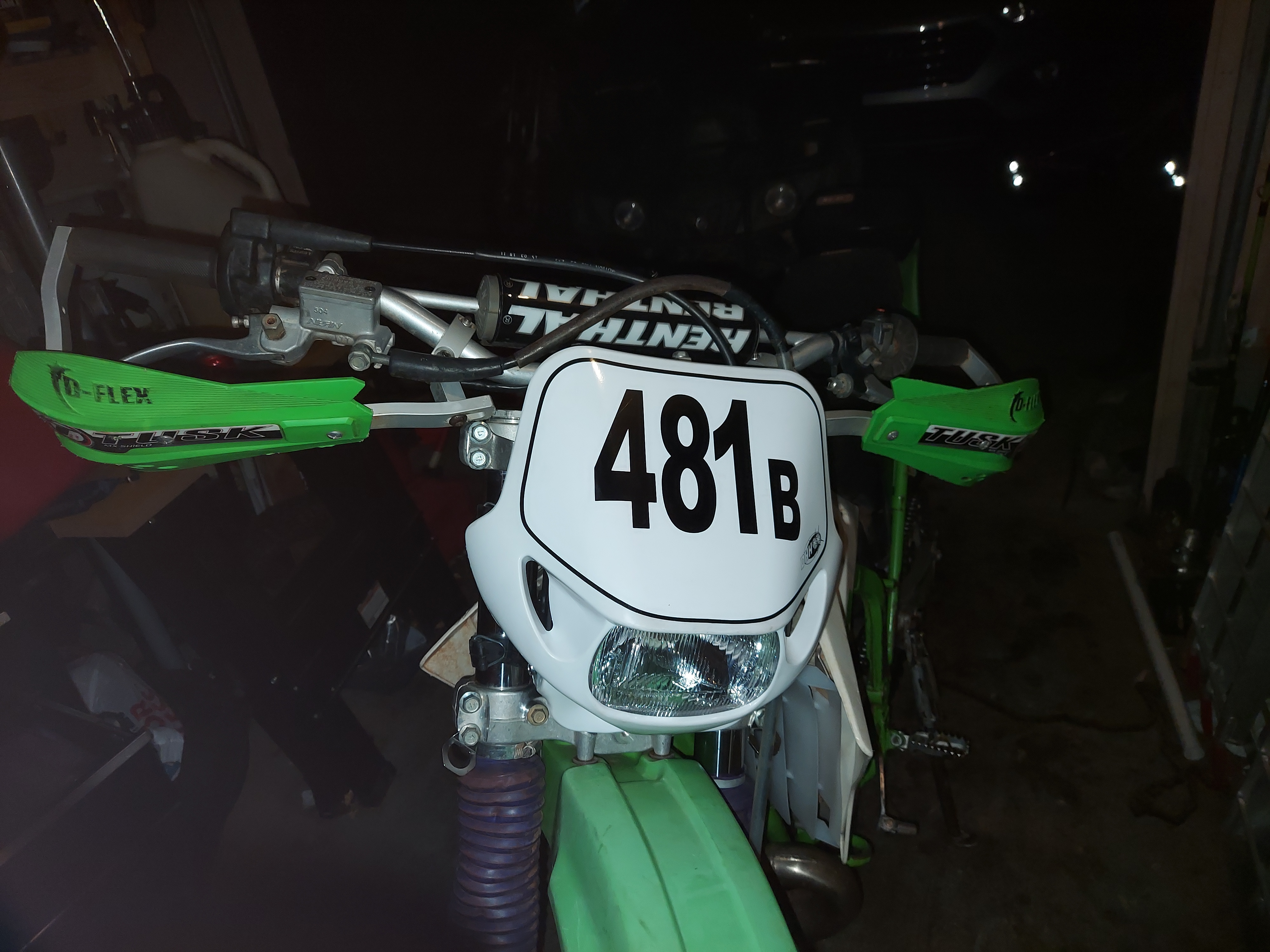

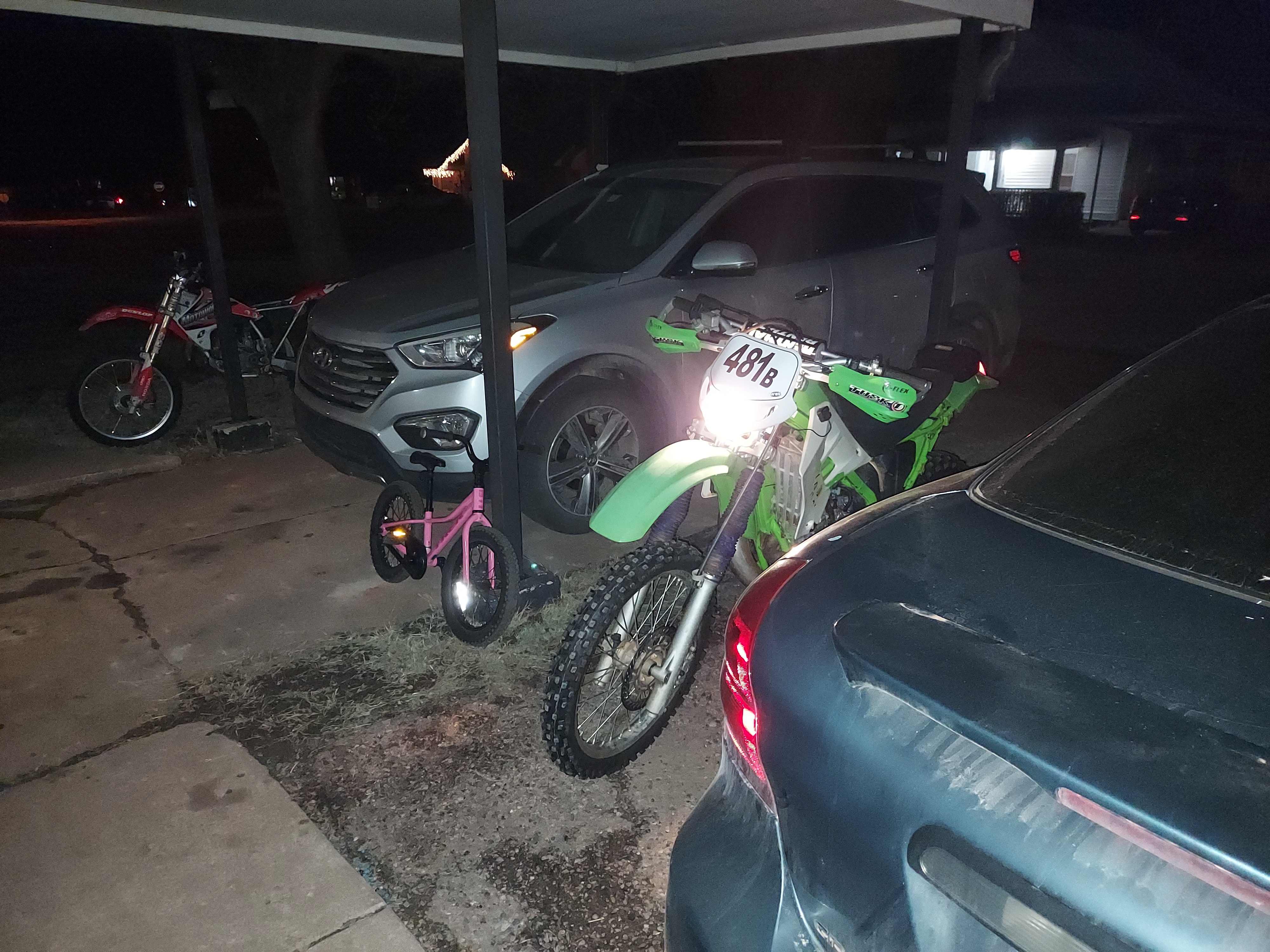

Update: Got the DHH light back from the sign shop for numbers and got it installed. Install was pretty easy once I had the right connectors.

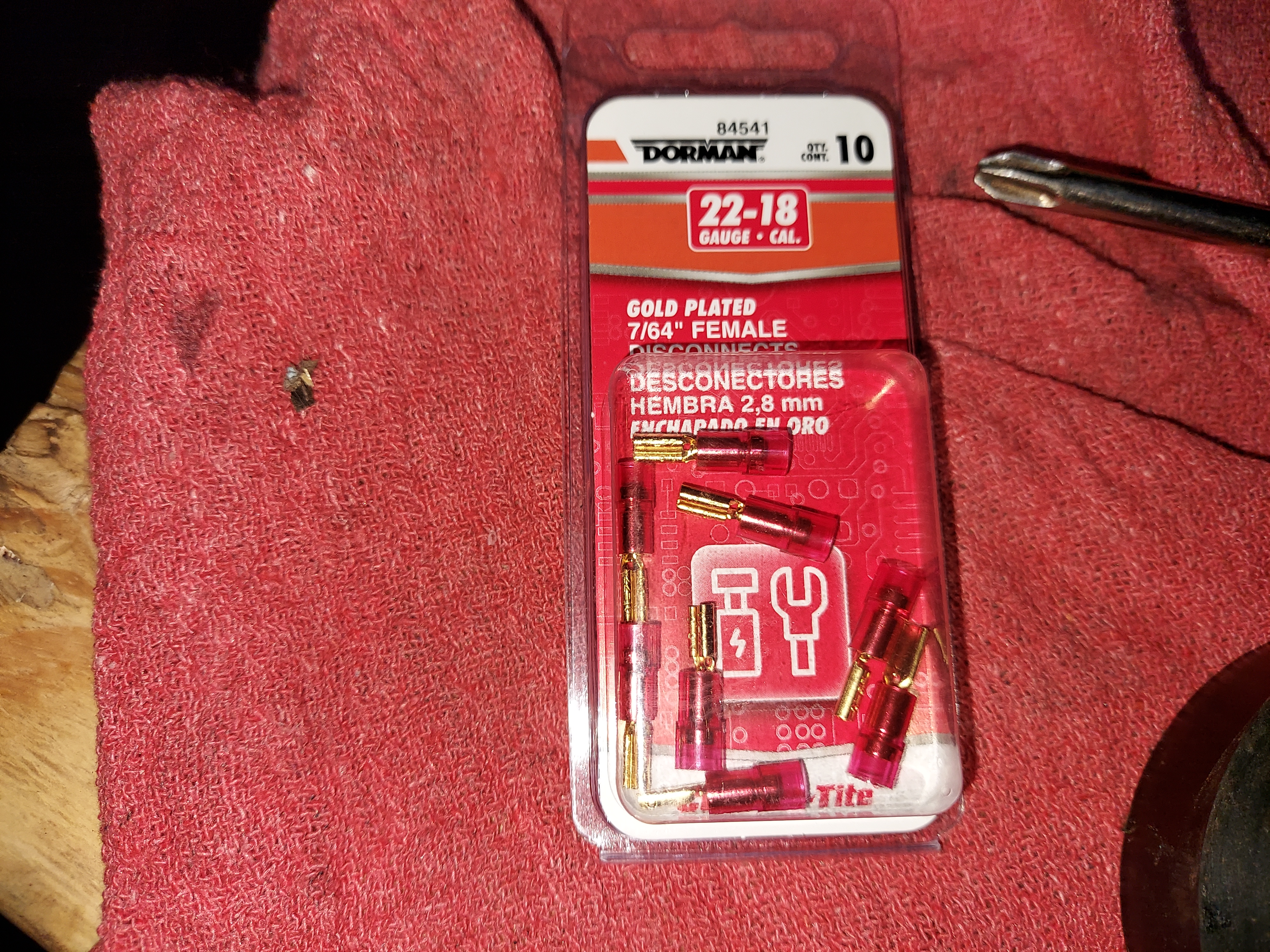

These are the connectors I used. NAPA didn't have them (go figure). However, O'Reillys had them.

Re: Headlight-OEM? UFO? Something Else?
Thanks for your insight. I'm pretty sure it's the high beam. Eventually, I want to get a switch for both, but it will work for now. I hardly use the lights anyway unless we're camping out somewhere.bufftester wrote: 10:42 pm Mar 10 2021 Glad you got it worked out and working for you! Did you go with the hi or the low beam on?
