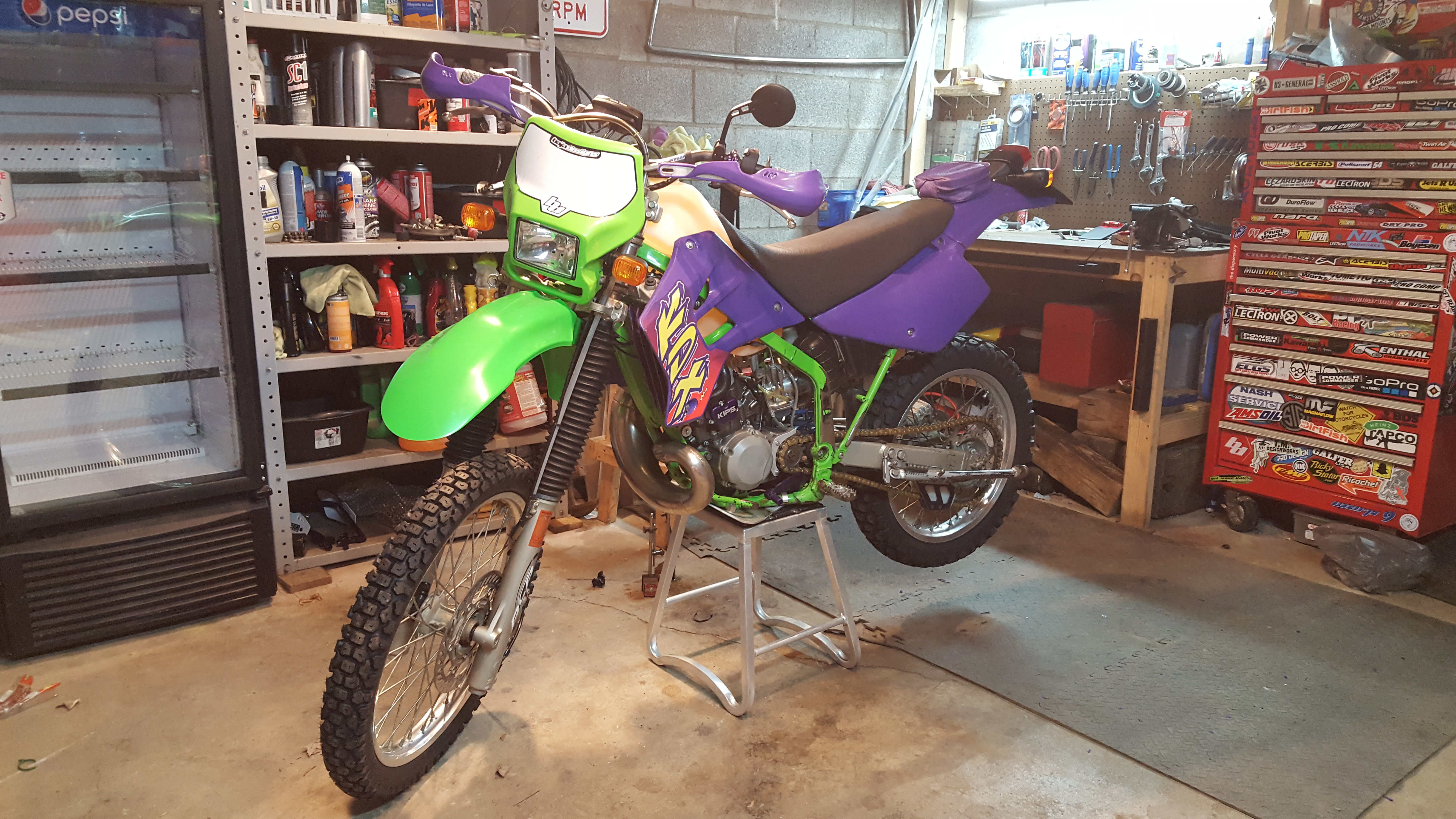

Re: KX 125/ 250 front fender?
Besides the KTM fenders that have mounting holes on the bottom and front, most MX front fenders you will find will mount up pretty easily. Either direct bolt on, or drill 2 more holes like SS109 said. Personally, I really like the 03-05 KX fenders on the KDX's.
When you start looking at the newer MX fenders, I feel like you need update the number plate/headlight to match the more modern lines...just my opinion though.
- 20190326_210042.jpg (4.5 MiB) Viewed 1362 times
You can drill a couple of holes in the side of the new front fender and move the cable guide over with two new black colored rivets. Just drill out the old ones I think.
