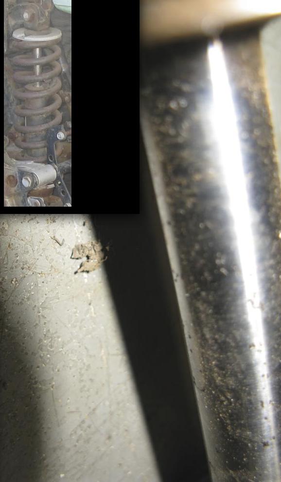

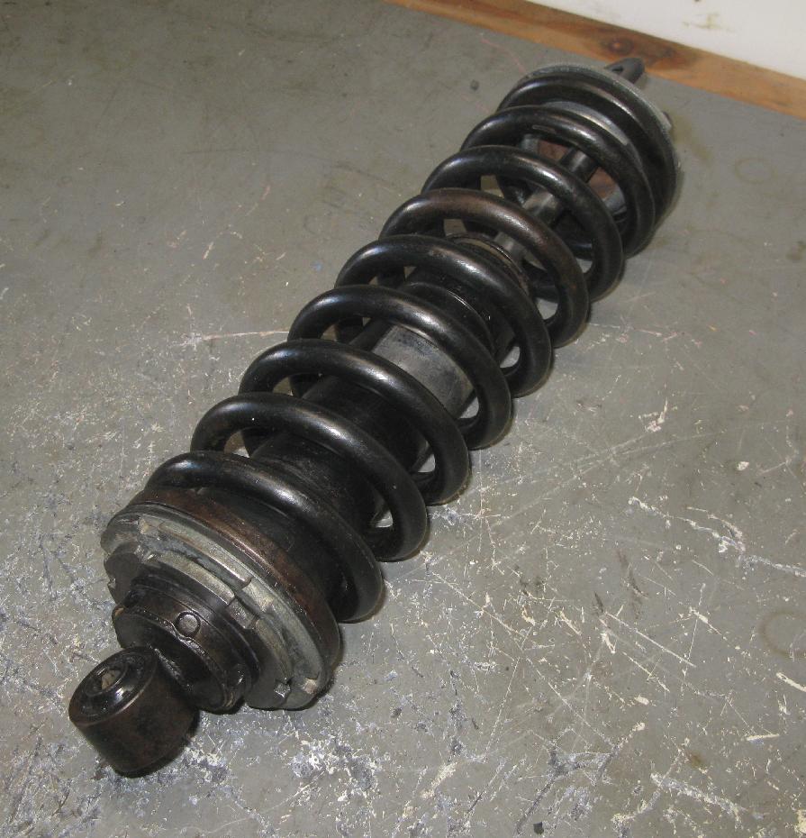

Started by removing the shock and then wondered if it would still function so I pulled the spring off:

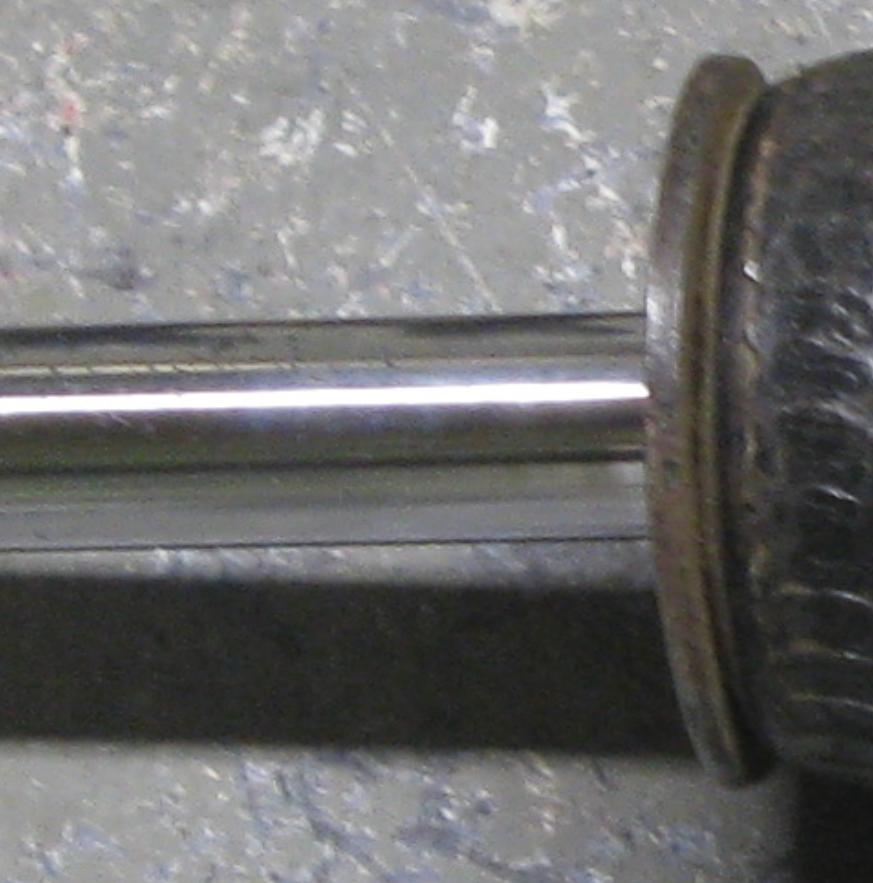

The shaft is pitted from rust :mad:

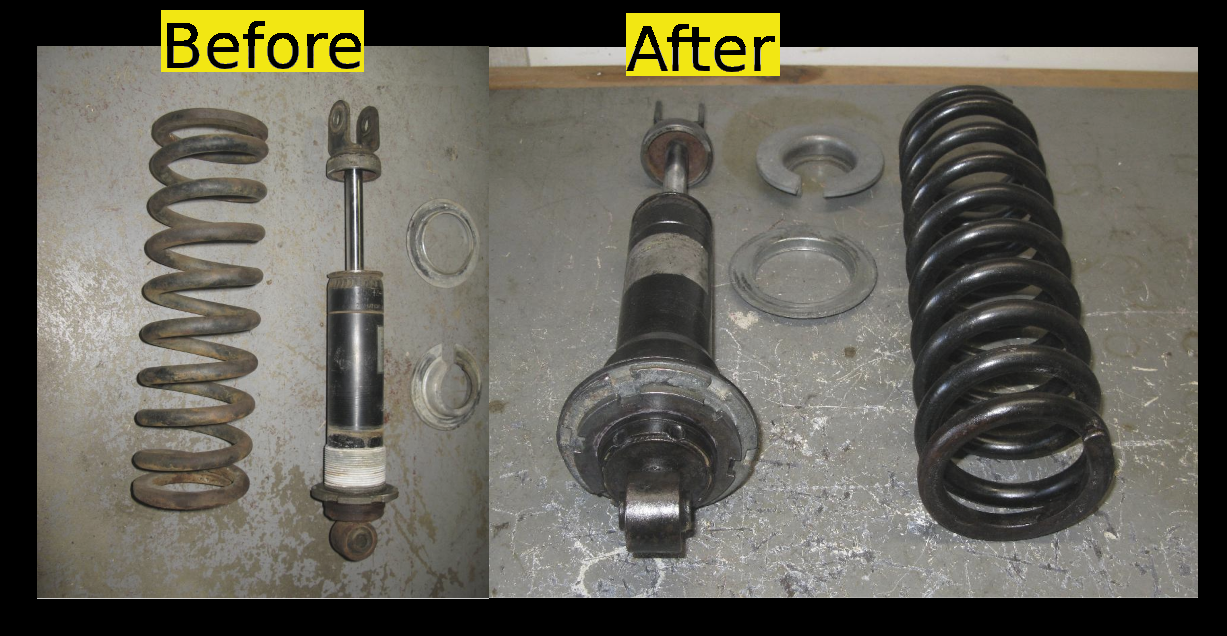

The shock on the KDX175 is crimped at the top leaving nothing to unscrew. Disassembly of the shock body might be possible but likely not worth the time and effort. Working up to 2000 grit made an improvement to the shaft, hopefully good enough - we will see. Once smooth, I was able to compress it - still has pressure!! After 40 years - amazing.
Still, it would be nice to have an update. But how? No direct replace shock is to be found as far as I can tell. That leaves a custom shock which would blow my budget so, for now, the old one will be given another chance. (If anyone knows of a close fit from another bike, please let me know!)
Cleaned up and greased the threads on the body and rings then reassembled.
Posted: 03:27 am Feb 01 2021
Good job on the shock. It is not made to be a serviceable shock. Either buy a custom new one or roll the dice on another used one off eBay.

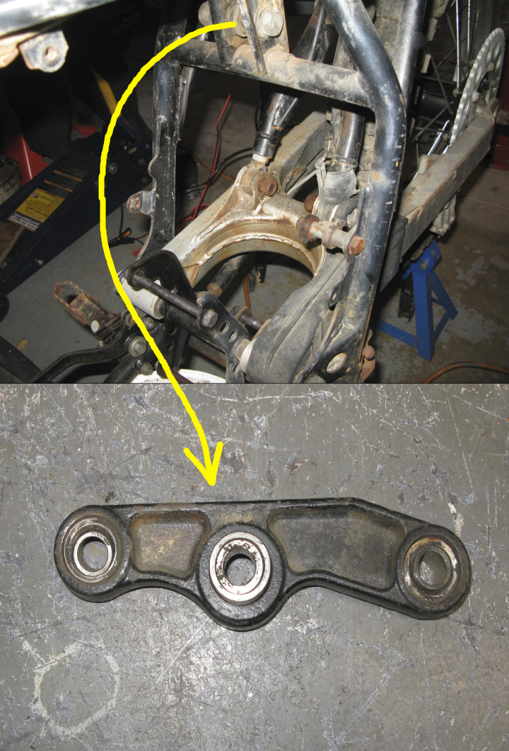

With the shock out of the way, time for the rear suspension to come off, one rusty bolt at a time. Actually they were ok, spraying with Kroil must have helped. Rocker removed and on bench:
_click any image to zoom_

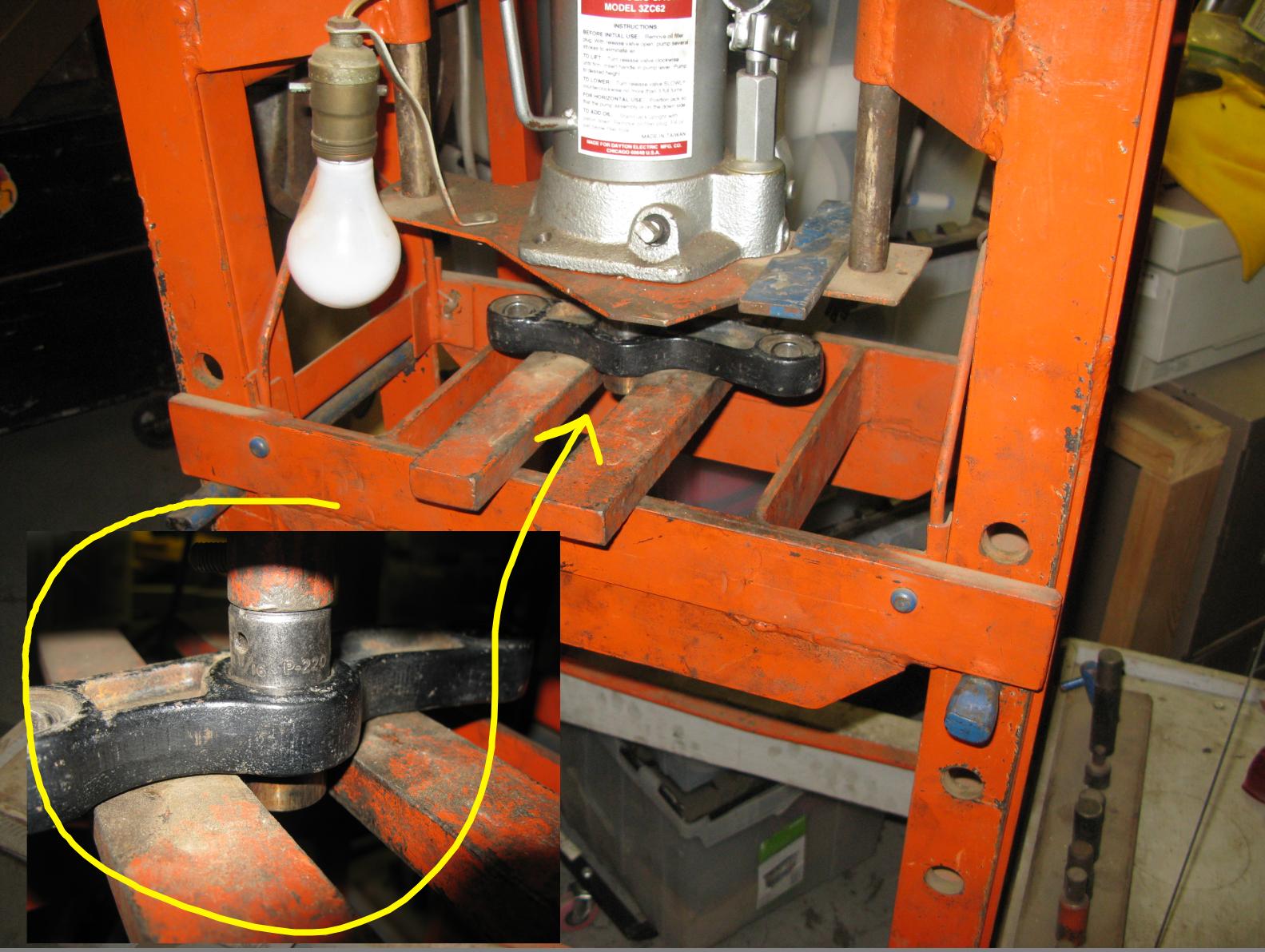

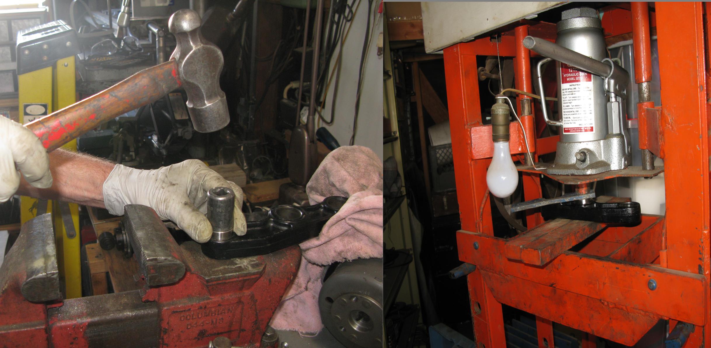

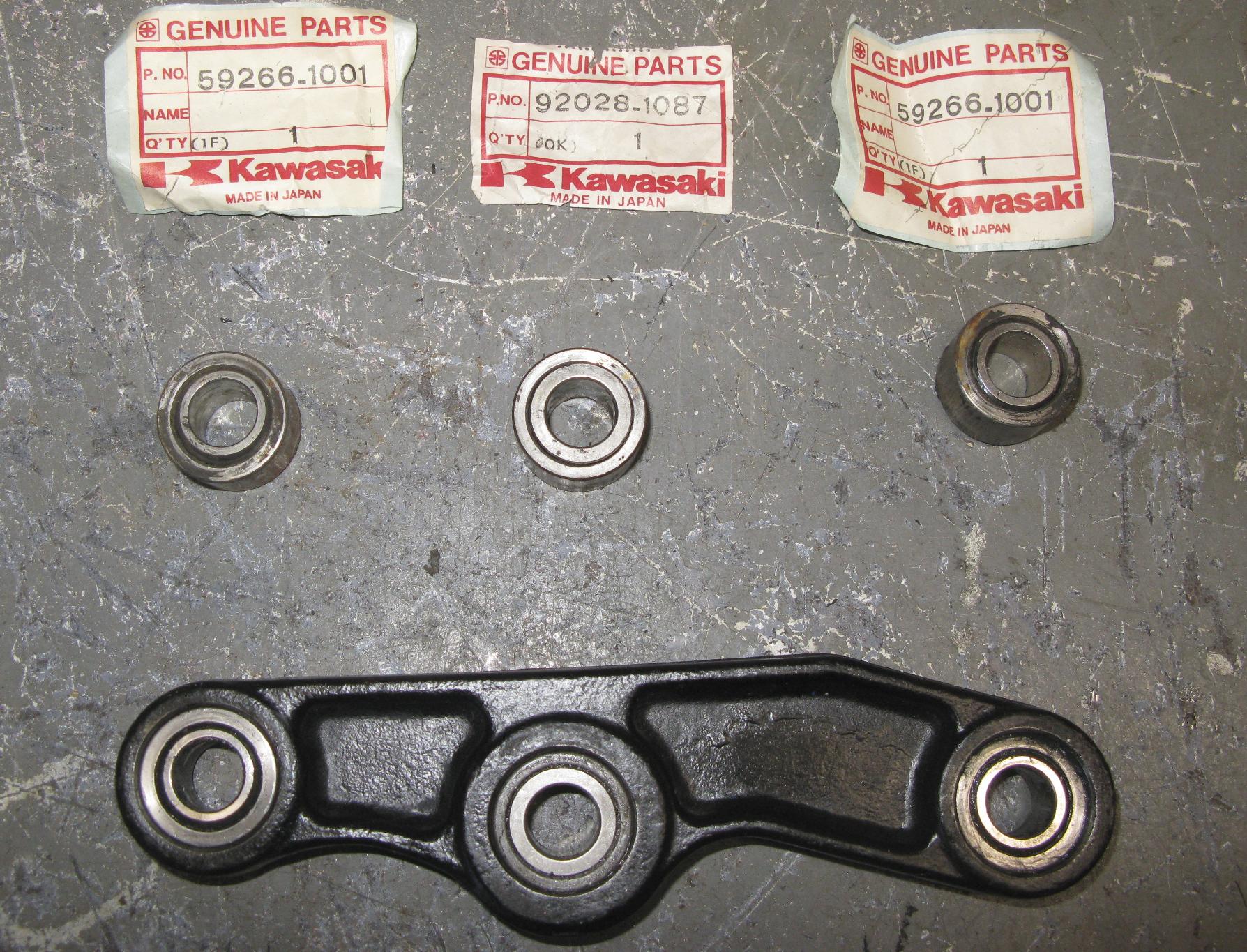

The ol' Whipple-built press from Smith River, c.1960, pushing the old bearings out:

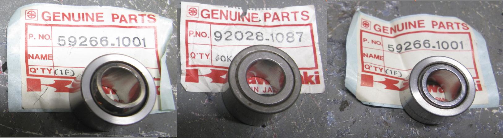

And here are the new bearings :grin: Woot!! Woot!! I managed to snag these off ebay over the last year or so in anticipation of this project. Afaik, these are unique to the kdx175. Normally I would cruise by a bearing shop in Burbank to see if there was a match but when these came up, I took the lazy way out. Probably a few more $$ but no worries on fit. (I will post a parts list with sources in a later post.)
Gotta get them started straight before pressing, much easier this way:
Rocker arm cleaned up with new bearings in place (old bearings, on top, get saved, of course)
I greased the new bearings but the ball-joints are pretty stiff. I guess this is good (no slop) and they will loosen up in use.

You must be a millionaire. Three new OEM bearings! Those things are NOT CHEAP when one can find them.
Good job on the shopping even more than the mechanical work. Seriously.

Thanks! I shop slowly but to the point - "Millionaire", haha! :rolleyes: Actually, when I lack time to work on a project (too often), I try and prep for it. In this case, I had time to wait until the right parts appeared at a price I could afford. From ebay, the two outer bearings came at $32 each shipped and the center bearing at $60 shipped. Then they sat for a few years patiently waiting for their new home. I think I have a lot of what I need but will find out what's missing as I go.

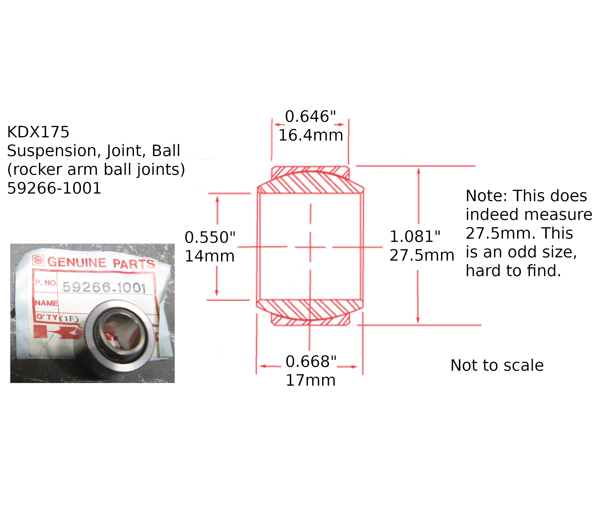

59266-1001 - 2 required - Rocker arm ball joint
    source - ebay               -  $30-$60 availability and price vary
    source - CMSNL.com          - $127 each
     https://www.cmsnl.com/kawasaki-kdx175-a1-kdx175-1980-usa-canada_model15171/joint-ball-suspension_592661001/
    source - PartNumberPros.com -  $69 each
     https://partnumberpros.com/products/kawasaki-59266-1001-suspension-ball-joint-kx-kdx?_pos=2&_sid=130a03c74&_ss=r

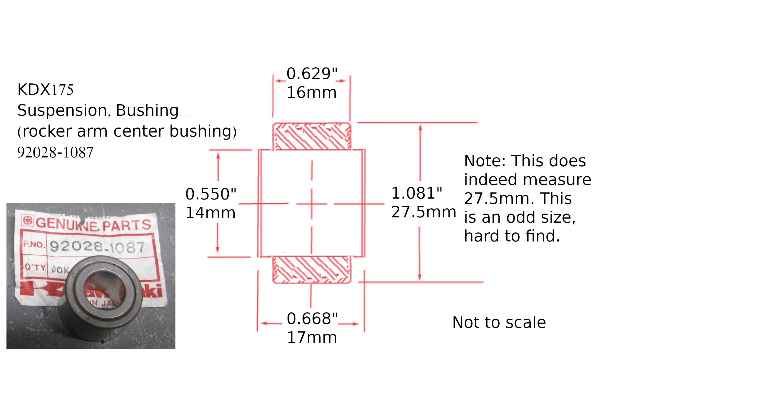

92028-1087 - 1 required - Rocker arm center bushing/sleeve bearing
    source - ebay               -  $30-$60 (availability/price vary)
    source - CMSNL.com          - $120 each
     https://www.cmsnl.com/kawasaki-kdx175-a1-kdx175-1980-usa-canada_model15171/bushing-suspension_920281087/

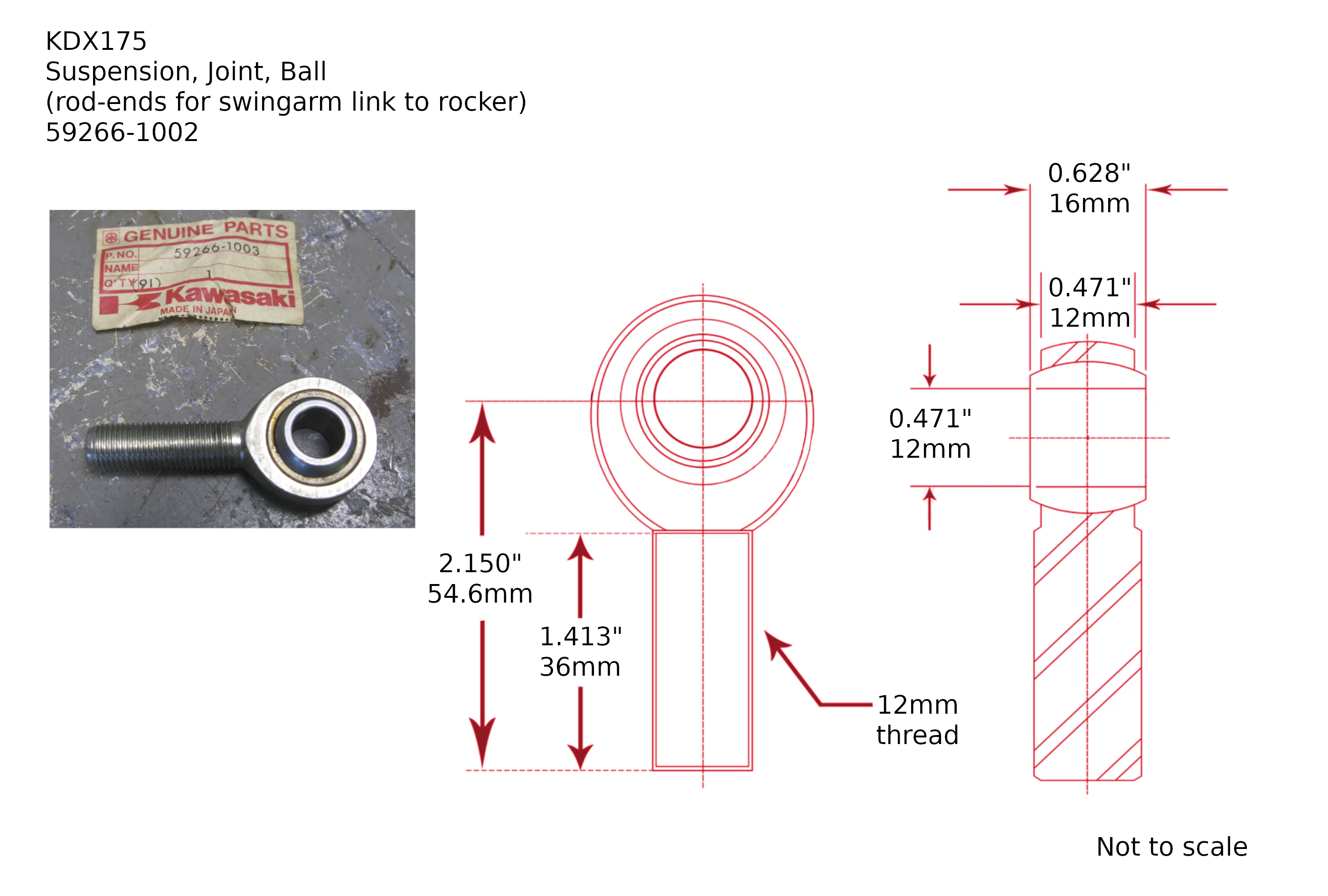

59266-1002 - 2 required - Suspension up-right rod-end
    source - CMSNL.com          - $102 each
     https://www.cmsnl.com/kawasaki-kdx175-a1-kdx175-1980-usa-canada_model15171/joint-ball-suspension_592661002/
    source - Bearing Supply #1  -  $12 each
     https://www.qualitybearingsonline.com/pos12ecl-qbl-left-hand-maintenance-free-type-with-male-thread
    source - Bearing Supply #2  -  $13 each
     https://www.vxb.com/POS12-Male-Rod-End-12mm-Right-Hand-Bearing-p/kit12360.htm

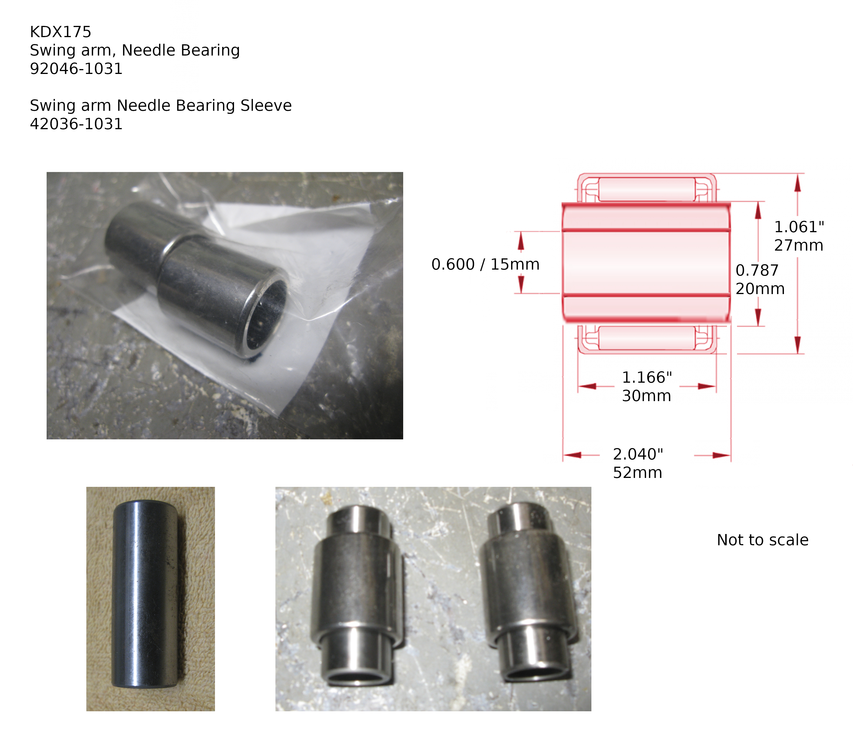

92046-1031 - 2 required - Swing arm needle bearing
    source - ebay               -  $20 (availability/price vary) search for 20x27x30mm needle bearing
    source - CMSNL.com          -  $23 each (availability varies)
     https://www.cmsnl.com/kawasaki-kdx175-a1-kdx175-1980-usa-canada_model15171/bearing-hmk2030-needl_920461031/
    source - Bearing Supply #1  -  $10 each
     https://www.vxb.com/TA2030-Needle-Roller-Bearing-20x27x30-Metric-p/kit21216.htm
42036-1031 - 2 required - Swing arm, sleeve for needle bearing
    source - ebay               -  $30 (availability/price vary)
    source - CMSNL.com          -  $37 each (availability varies)
     https://www.cmsnl.com/kawasaki-kdx175-a1-kdx175-1980-usa-canada_model15171/sleeve-swing-arm_420361031/

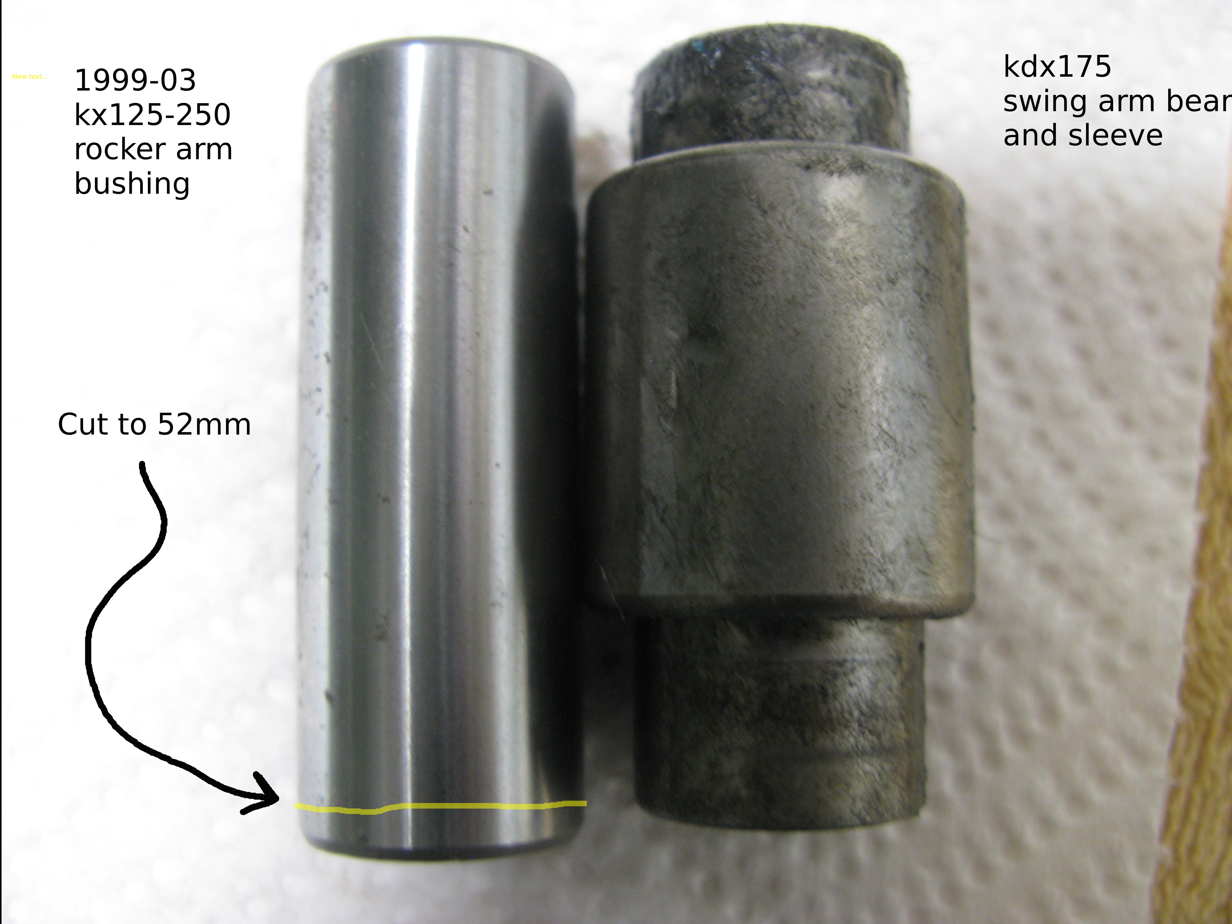

Alternative sleeve - requires cutting length to size of 52mm
42036-1031 - 2 required - Rocker arm bushing/sleeve for 1999-2003 kx125, kx250
    source - ebay               -  $20-30 (availability/price vary)
    source - CMSNL.com          -  $11 each (availability varies)
     https://www.cmsnl.com/kawasaki-kx125-l1-1999-usa-canada_model11928/sleeve_420361357/

Next, more details on the KDX175 rear suspension joints than you ever wanted to know :-) Measurements were made directly off of the parts by me and are not exact. Also, I measured in inches and converted to mm, sometimes putting down the number I already knew to be correct, e.g. I knew that the swing arm sleeve has a 20mm OD even though the measured inches converted to 19.9mm. For Bearing suppliers, sources, I looked at a fair number but many more exist. If possible, visit one in your neighborhood with your old bearing; they know a lot more than I do and may be able to get the parts. The Rocker arm ball joints and the center bushing/sleeve are just plain unusual, though, with the 27.5mm outer diameter. I did not find any matches but if all else fails, a bearing supplier may be able to get one with a 28mm OD and you could have the rocker bored to match. Same with the center bushing/sleeve. For the rod-ends, variations exist with zerk fittings and some kind of sealing or cover. Different styles of rubber rod-end covers are available on ebay too and it seems like at least one style might work although they all look bulkier than the originals. As for wheel bearings, that are commonly available so I did not include them in the list.
Id x od x width (ball width) ===> 14mm x 27.5mm x 17mm
_click to zoom images_
Id x od x width (sleeve width) ===> 14mm x 27.5mm x 17mm
Id x thread length x width (ball width) ===> 12mm x 36mm x 16mm (12mm threads)
Id x od x width (bearing width) ===> 20mm x 27mm x 30mm
Id x od x width (sleeve width) ===> 15mm x 20mm x 52mm
Alternative - REQUIRES CUTTING LENGTH TO 52mm
Id x od x width (sleeve width) ===> 15mm x 20mm x 53.8mm

The kx125 rocker sleeve is 1.8mm too long
_click image to zoom_
Cutting the kx125 rocker sleeve from 53.8mm to 52mm
The sleeves are now 52mm and ready for a little breaking of sharp edges with the grinder
The needle bearings pressed in without a fuss
