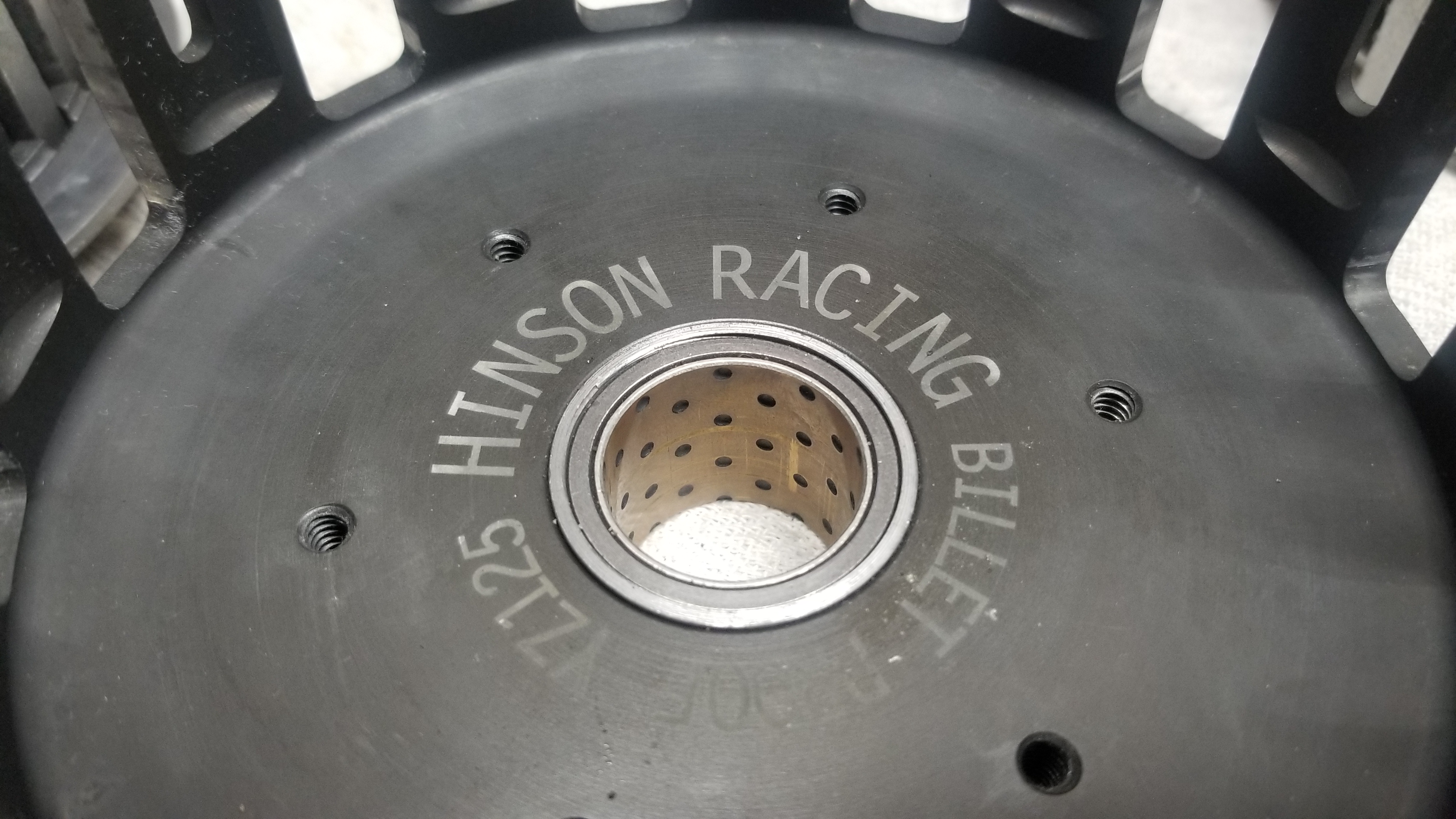

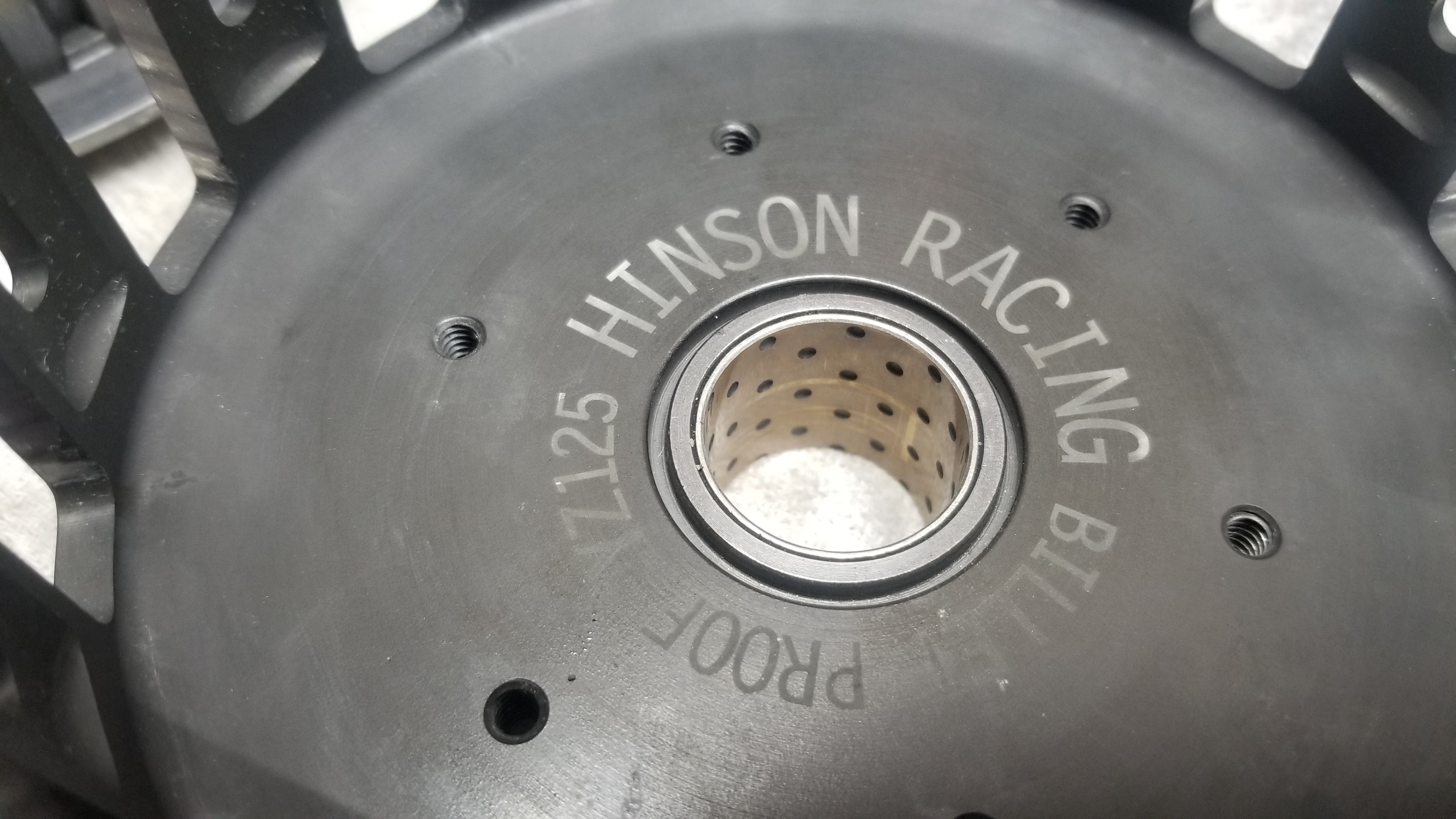

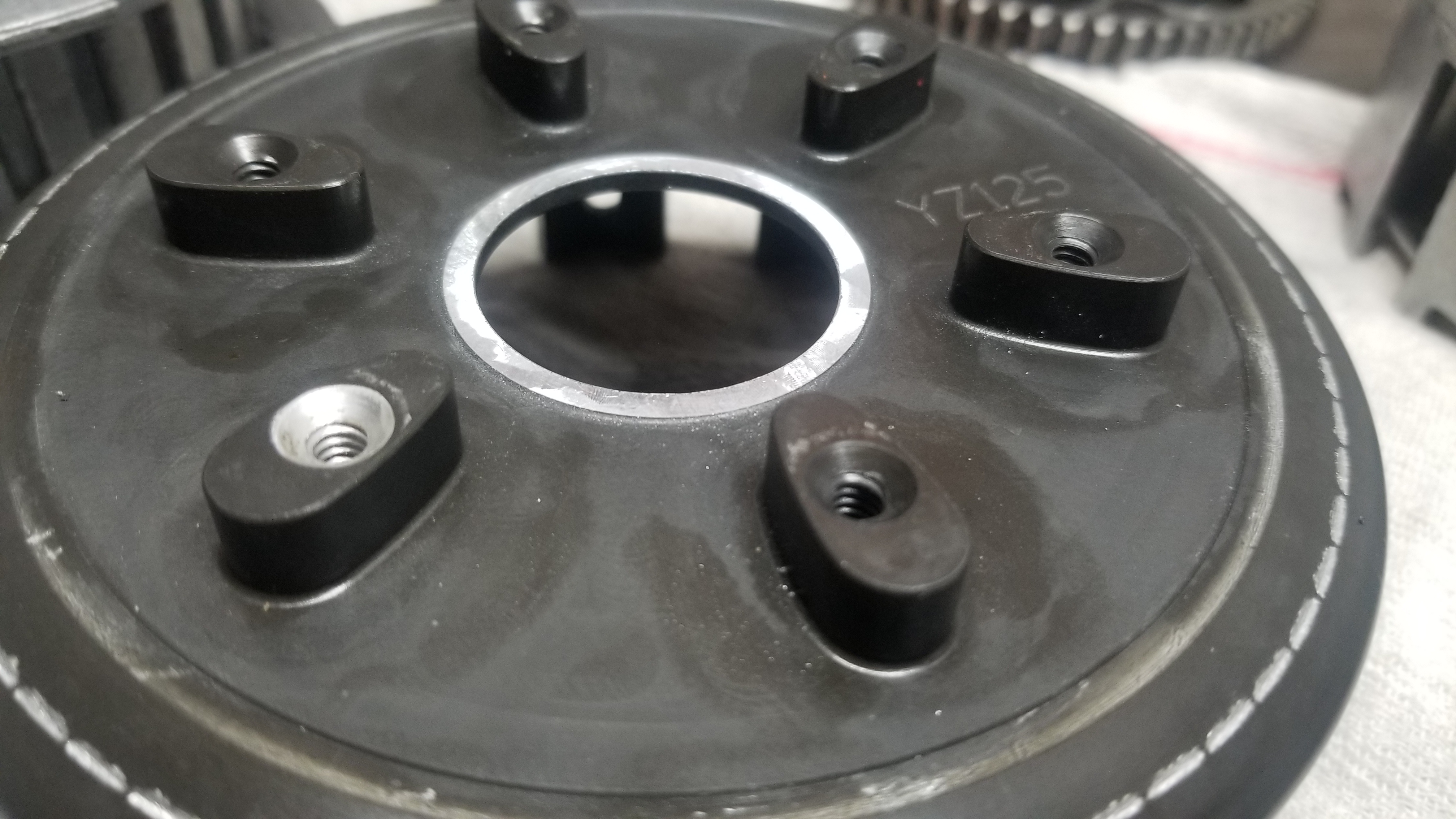

I've made it through what I consider to be the first step of the process by disassembling the gear from both the used baskets. The Hinson YZ basket was considerably more difficult as a result of the small fastener size and red loctite. The 1/8 Allen heads promptly stripped even with liberal application of heat. Ultimately heat and an impact driver with a similarly sized torques bit (t20) was how I got them removed. The KDX donor simply had the rivets drilled off and the assembly came free.
I see two obvious machining operations that need done at this point. There is a raised boss on the gear side of the YZ basket that will need to be machined down enough for the KDX gear bushing boss to reach through almost flush with the inside surface of the basket. This works out to around .070 material removed on this particular basket.
The second obstacle is the clearance between the ID of the YZ basket and the OD of the KDX gear bushing boss. A spacer ring will have to be made to fill this void ultimately keeping the basket and hub centered to one another. Both the YZ and the KDX were slip fit between the gear and basket so I don't anticipate too much trouble making a useable spacer. I may make it a press fit on the KDX gear then size it until it slip fits the the basket.

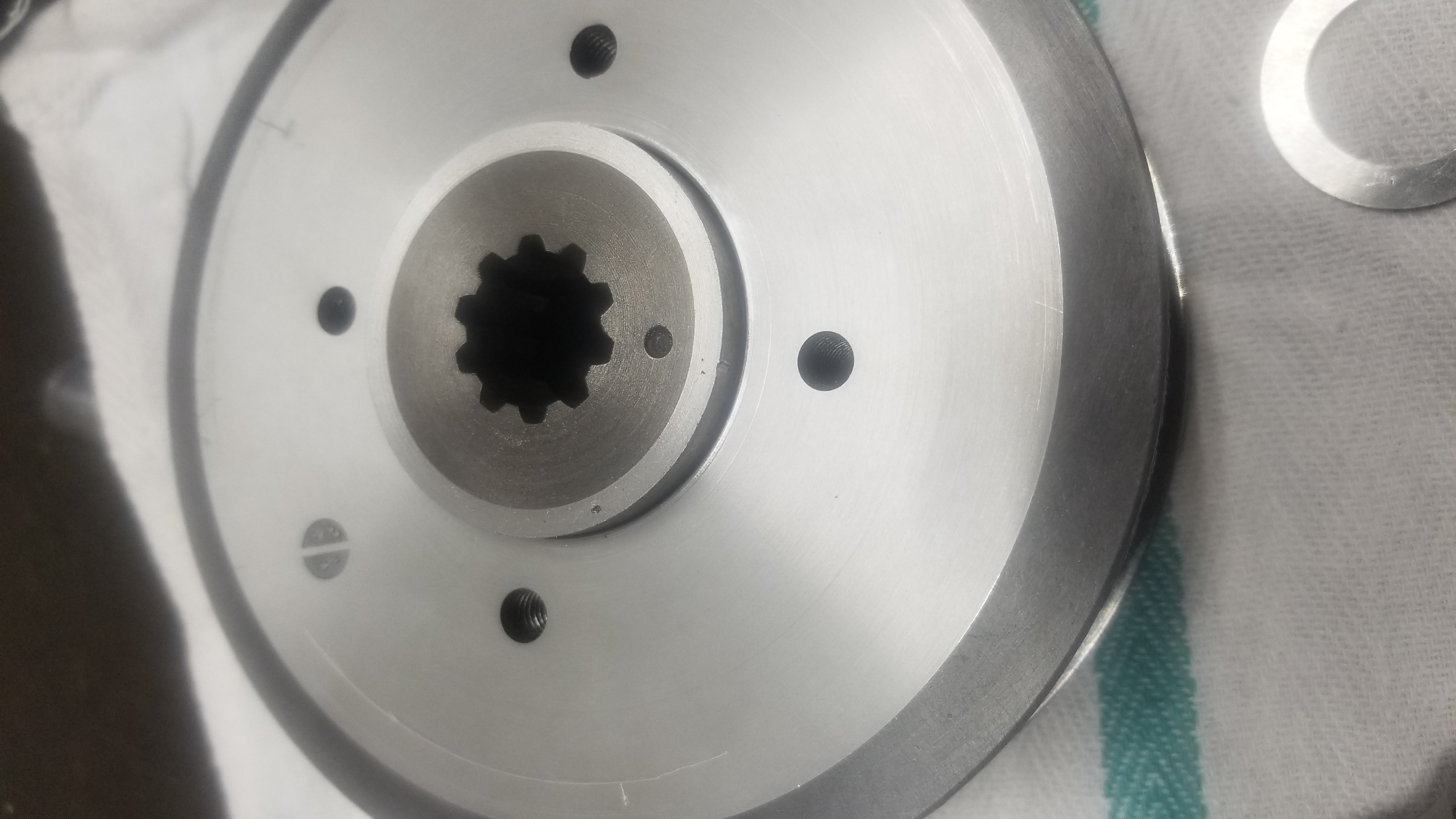

This Hinson YZ125 basket with the raised lip machined so the gear can sit flat. There is a recess in the YZ gear this fits into.

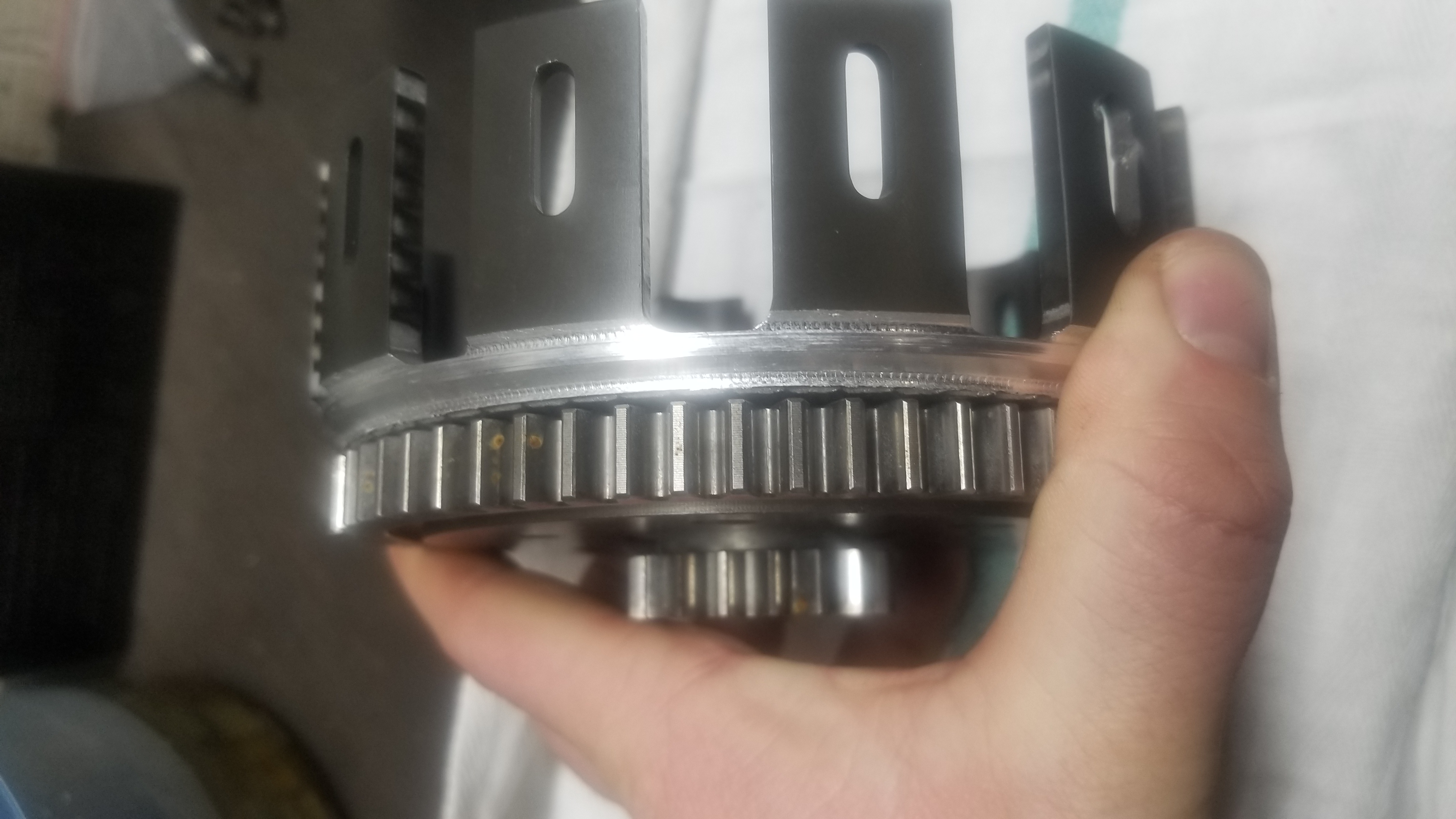

This is the space between the Hinson basket and KDX gear that must be corrected.
This shows the bushing that was made to correct the fit between the gear and basket.

That clutch basket looks good. Be sure to check your clearance between the basket and the water pump gear once it is installed. It will rub. To answer your question about the running in high gear and stomping on brakes, if it is set up properly it should bring rpms down until the rekluse releases the clutch. That is what it is designed to do. You should be able to use clutch lever as normal if you want, but when you stop without pulling in lever, the clutch should disengage like you did pull it in. Again, if it is set up properly. FYI, when you set up your "free-play", the adjustment on the cable is very sensitive. You should only have to adjust the cable 1/8 turn at a time until you get the right feel. This changes as your clutch wears. so you need to check it often. Seems like a lot of trouble, but it was always worth it to me. I really enjoyed my set up. Good nluck!!!

After waiting for new allen head screws for the clutch basket I finally got back to this project this week. Bringing the gear boss flush with the inside of the basket left the clutch pack sitting too high while using the original hardened washer between the inner clutch hub and basket sleeve. I took the thickness of the original washer down from ~ .095" to .025" and took .050" off the back of the inner clutch hub to bring the top friction disc fingers flush with the basket. I removed the boss from the clutch pressure plate in order to gain another .050" margin before there would be interference with the basket. Lastly I did an embarrassingly poor job clearancing for the water pump gear. After all of this was done and assembled together the stack height from to end of splines on the inner hub is about .135" less than the original clutch. This means the pushrod is past 90degrees of rotation before it starts acting on the pressure plate. I have an assortment of 10mm ID spacers on the way tomorrow to move the pushrod out closer to the clutch cover.
