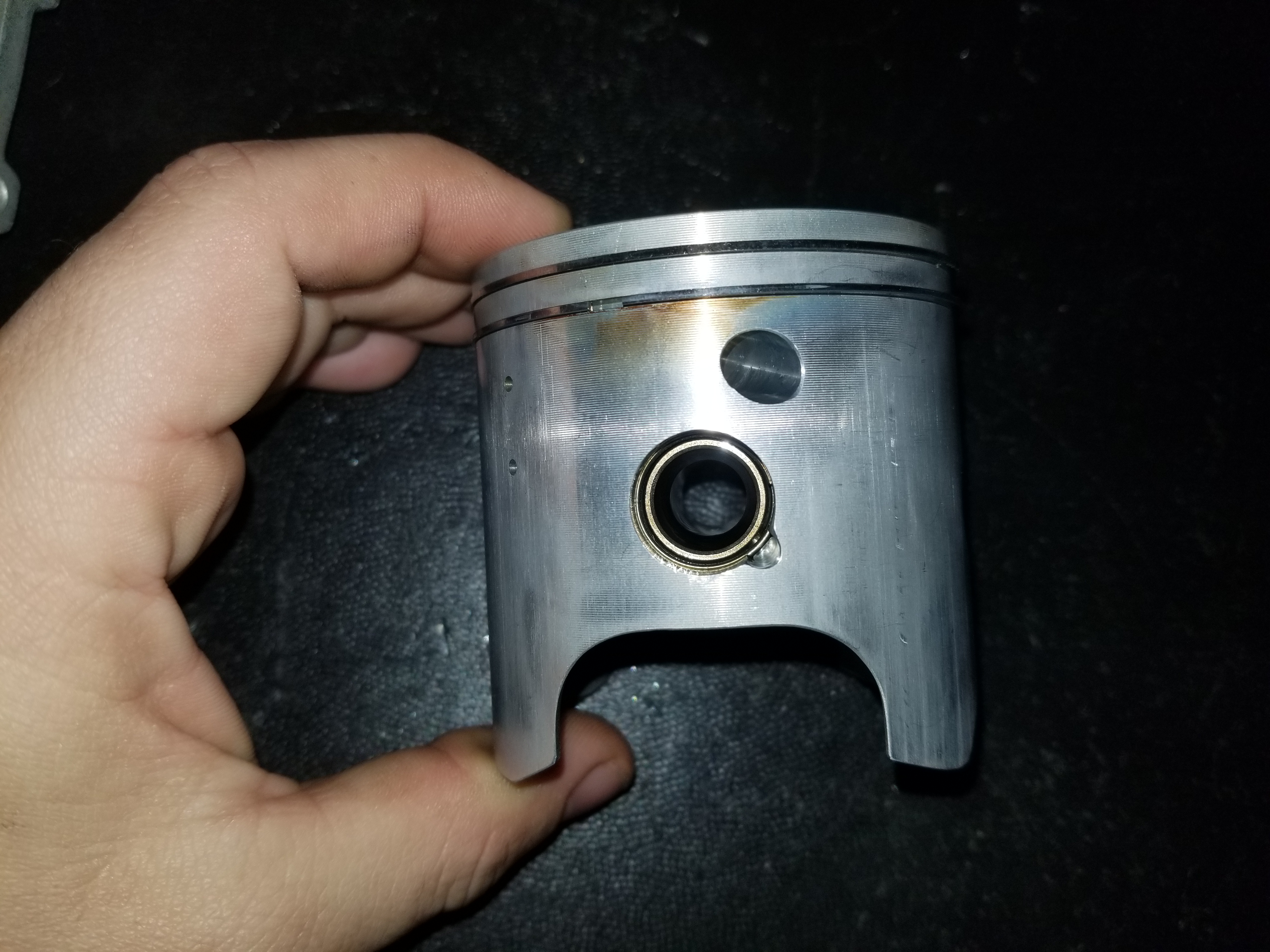

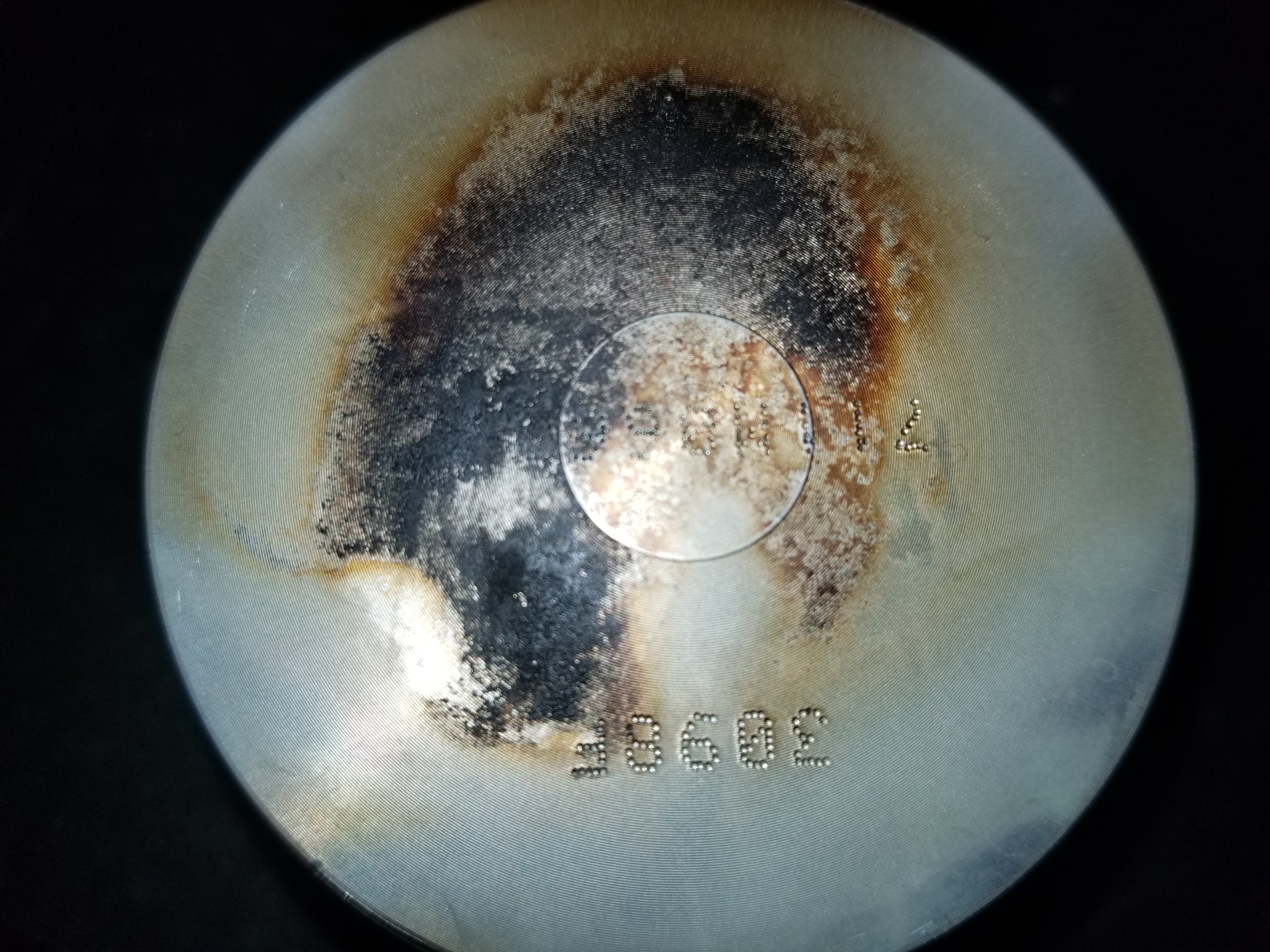

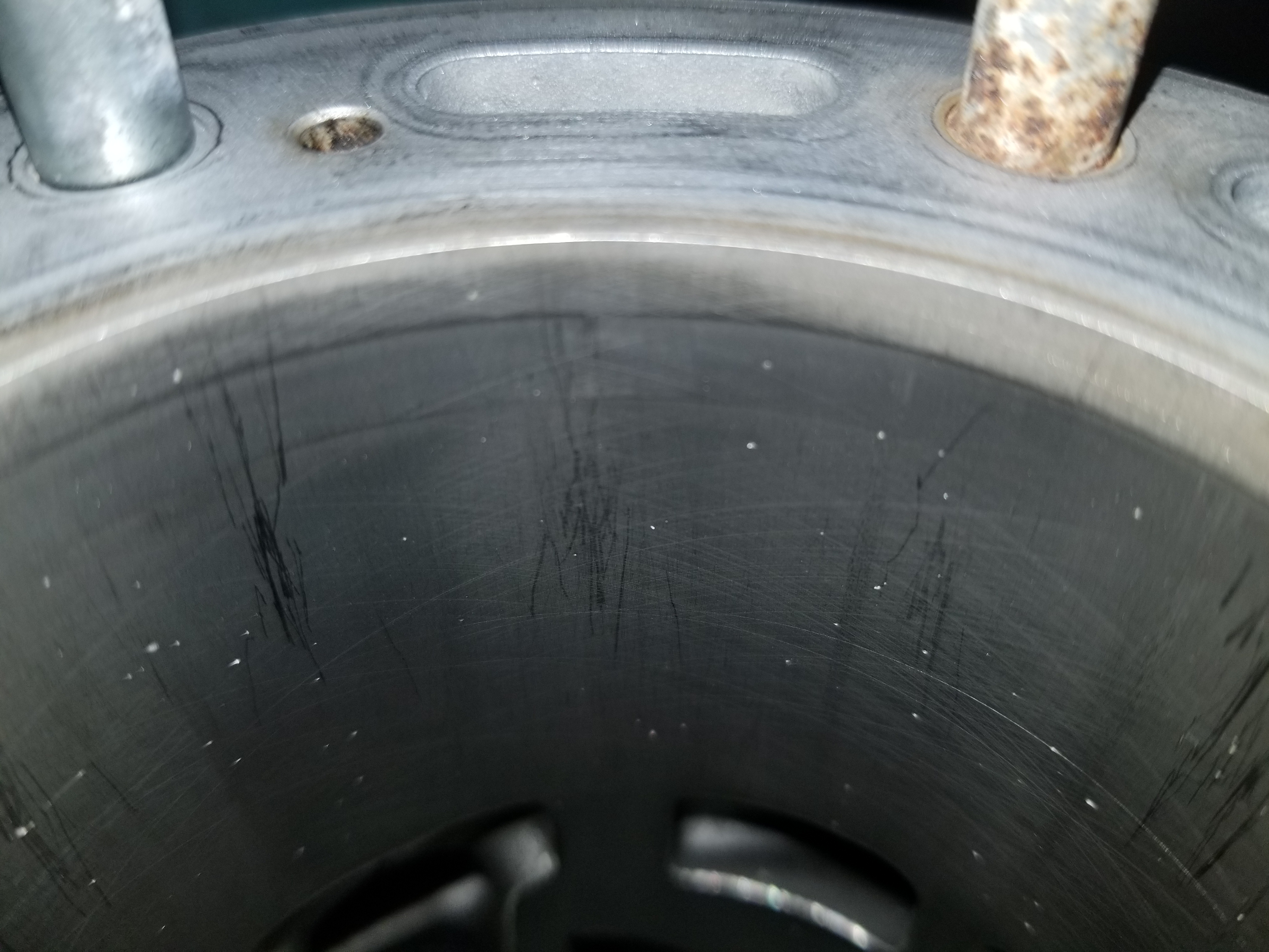

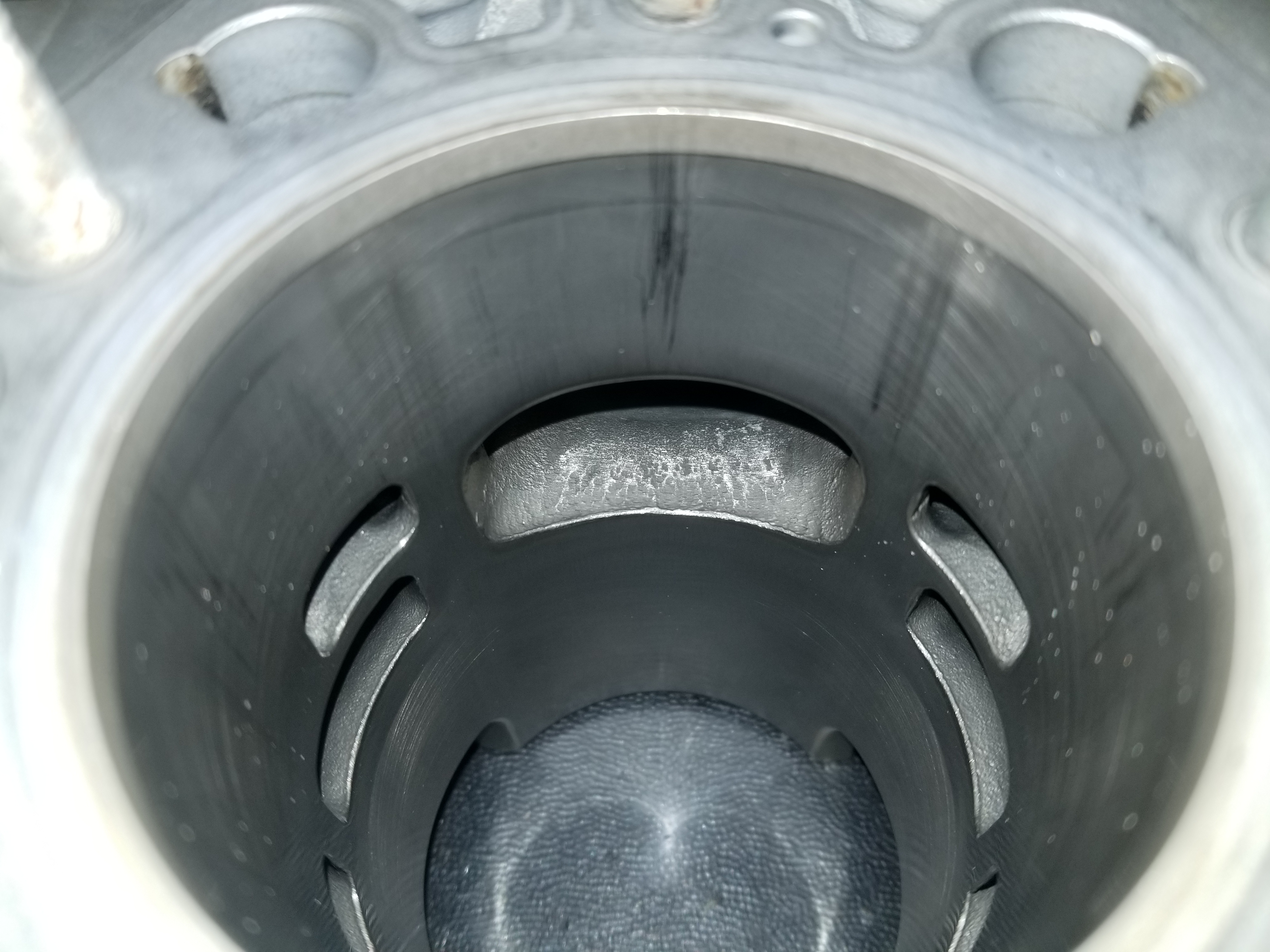

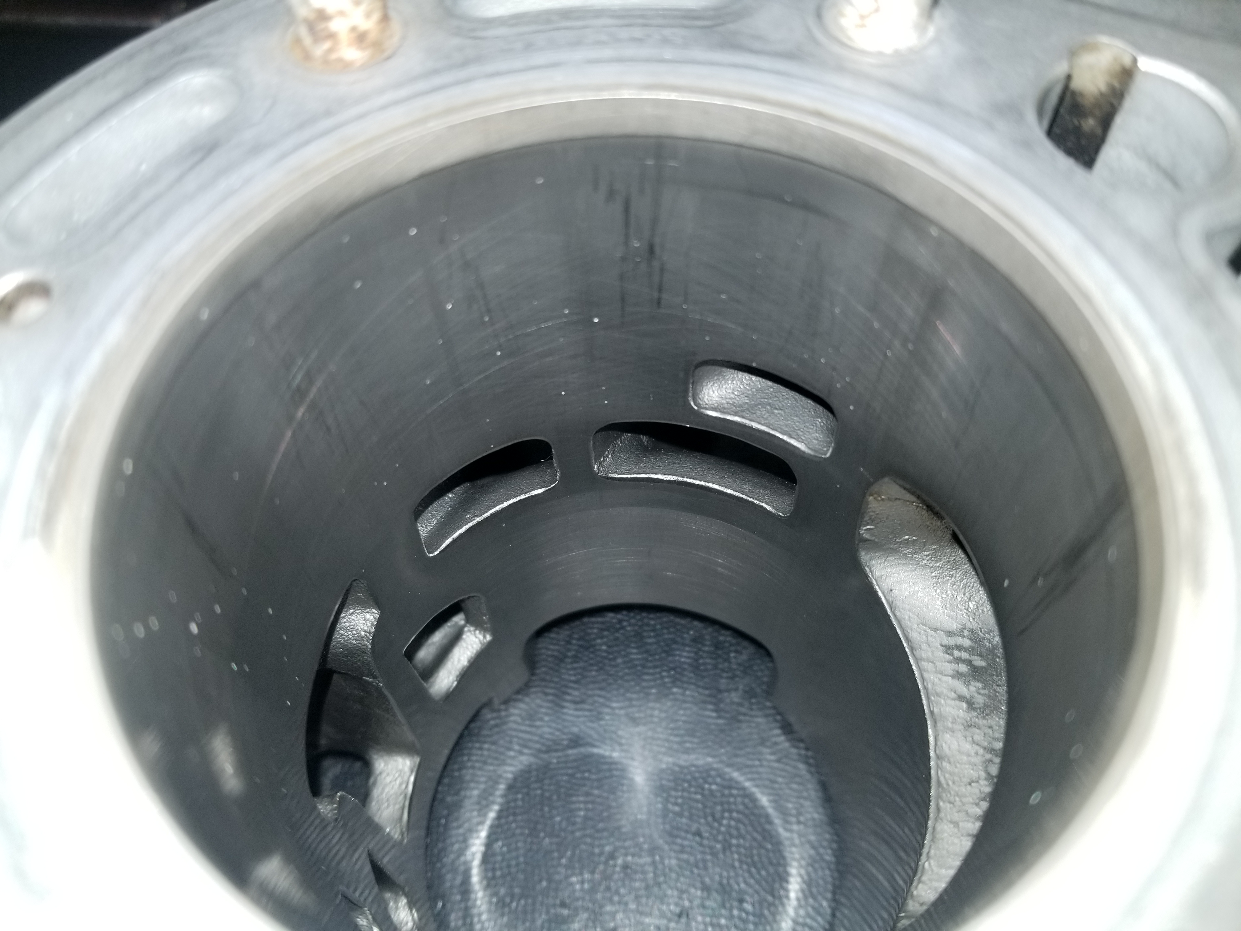

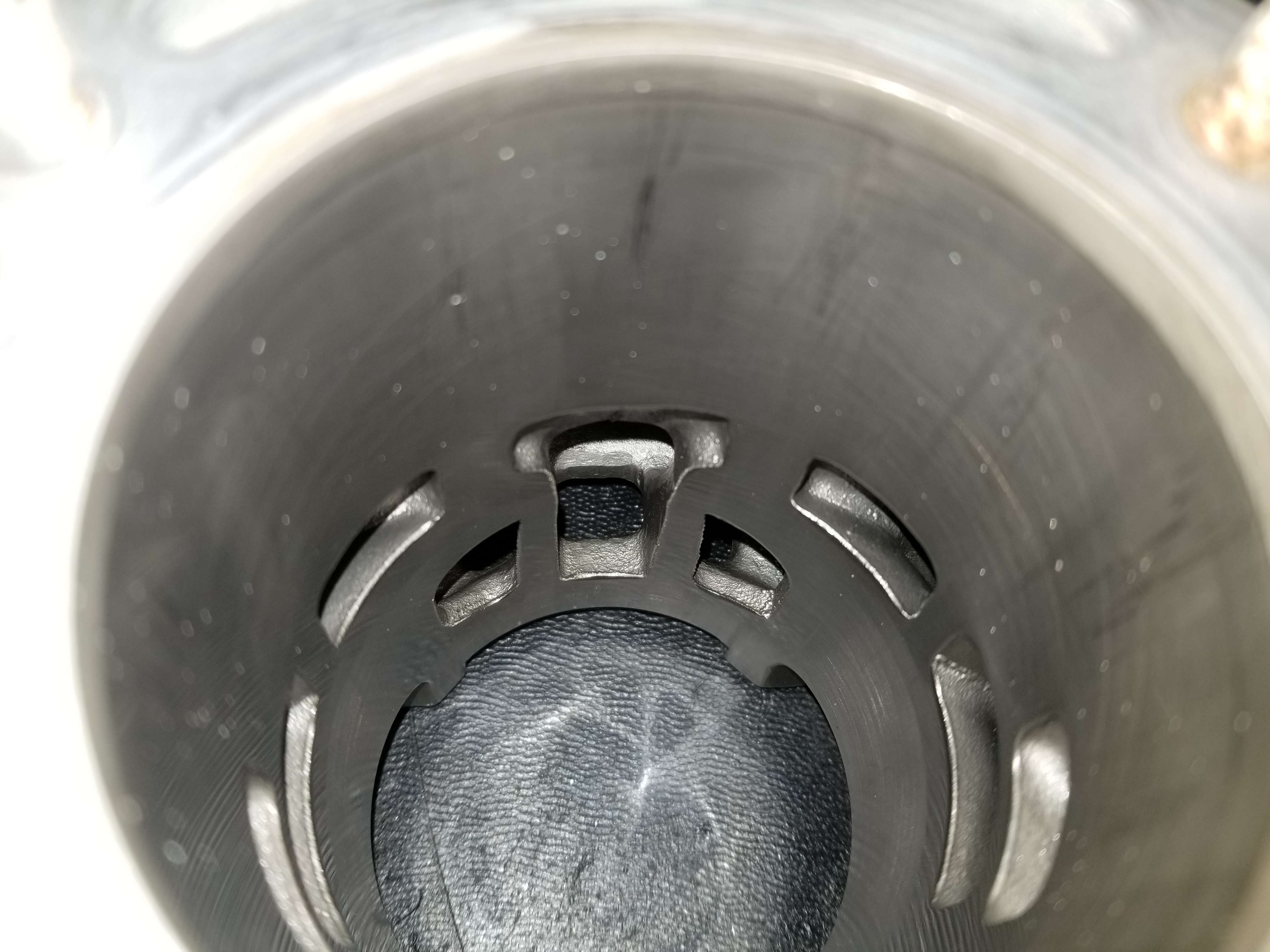

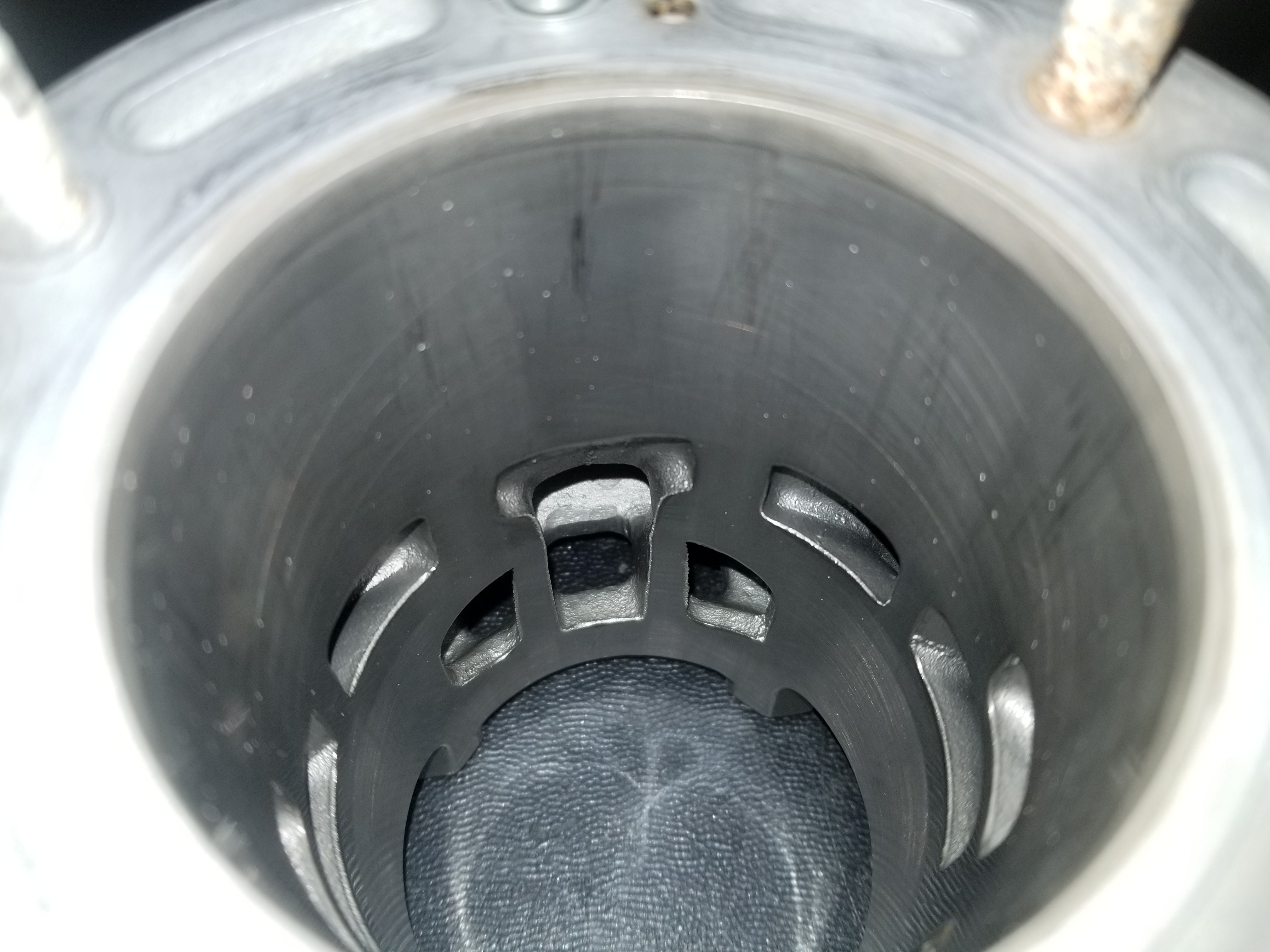

HELLO NEW TO FORUM. I HAVE A FEW QUESTIONS ABOUT A TOPEND REBUILD IM DOING. I HAVE A 04 KDX 200 THAT I HAVE OWNED FOR ABOUT 2 YEARS NOW AND IT RUNS GREAT. ONLY REBUILDING IT BECAUSE I REALLY HAVE NO IDEA OF THE MAINTENCE HISTORY ON THE BIKE AND AS A LEARNING EXPERIENCE. FIRST QUESTION IS ABOUT CYLINDER DIAMETER. I MEASURED THE CYLINDER AND IT IS MEASURING 2.5981 THIS WITH A DIAL BORE GUAGE AND TELESCOPING GUAGES AND ACCORDING TO MY SERVICE MANUAL SPEC IS 2.5994--2.6000 WHICH MAKES MY CYLINDER SMALLER THAN SPEC, HOW IS THIS POSSIBLE ON A ALMOST 20 YEAR OLD BIKE? I ALSO MEASURED THE PISTON TO 2.5924 SPEC (2.5961--2.5967) WHICH I ASSUME IS JUST SMALLER FROM NORMAL WEAR BUT CORRECT IF IM WRONG THAT MAKES MY PISTON/CYLINDER CLEARNEC .0059 (SPEC IS .0031--.0035) ALMOST DOUBLE AND THE SERVICE MANUAL SAYS IT CAN BE A LITTLE LARGER BUT DOESNT REALLY SAY BY HOW MUCH. EVEN IF I GET A NEW SMALLEST PISTON ACCORDING TO SPEC (2.5961) MY CLEARNCE WOULD STILL BE .0020 AND THE MANUAL IS VERY DIRECT IN STATING DONT GO UNDER SPEC OR PISTON COULD SIEZE IN THE BORE. SO DO I NEED TO GET A SMALLER PISTON THAN STOCK? ALSO IS THE PISTON I HAVE STOCK OR AFTERMARKET? THANKYOU FOR HELP.

Did you run a hone inside the cylinder? I hope not and that is just afternarket plating with porosity showing.
Did you clean the piston top?
Don't take this the wrong way, but I assume you measured the cylinder in the wrong location.
What are the vertical scratches??

That's a standard (66.00mm) Wiseco piston (p/n 711M0600) As KDXG said, remeasure in the correct locations
For piston, 16 mm up from the bottom of the piston skirt 90° from the piston pin hole and you should be >65.8. Yours is at 2.5924 which is 65.84 (or basically at the wear limit)

Regardless, if those are pores showing in the coating the cylinder needs to be replated. If you didn't hone it then likely the PO did which is a big no no for these engines.
IIWM I'd replate the cylinder and replace the piston (and send it to the replates so they can match it).

It’s a bit of a puzzle you’ve presented. Like KDXGarage said it is most likely a replated cylinder.
If the ring gap is reasonably good and the bike was running well you could just clean everything and run it until it starts slapping. It might run for quite a while. Did you happen to check the compression before you took it apart?
The other option would be to send it off for a bore and replate. You’ll get it back to factory spec and end up with a new forged piston. It all depends on how much you want to spend as to what you do.
This does seem odd though. A reputable plating service would have most likely not have undersized the bore.

Oops. I didn’t see bufftesters reply before I posted. He’s right. It should probably be replated but I have certainly run some cylinders that looked worse. lol
Re: TOPEND REBUILD QUESTIONS
I am assuming it was replated. Porosity can show up during this time. It is not an issue.
Get an OEM or Cyclepedia service manual.
I am curious as to how the angled scratches got there.
If it is not severely gouged, there is no need for boring it to a larger size. It's not a Camaro.

I DID NOT HONE THE CYLINDER I DID CLEAN IT WITH TYPE F AND SCOTCHBRITE . I KNOW I MEASURED IN THE RIGHT LOCATIONS BUT MAYBE I DIDNT MEASURE IT CORRECTLY OR MY MICROMETERS AND DIAL BORE GUAGE ARE NOT THE BEST OF QUALLITY. SO TODAY I TOOK MY CYLINDER TO A BUDDY WHO WORKS IN A MACHINE SHOP WITH OUT TELLING HIM THE MEASURMENTS I GOT AND THEN COMPARED AND HE GOT THE EXACT SAME MEASURMENTS DOWN TO 10000 TH . MEASURMENTS ARE ACURATE. SOME OF YOU THINK IT GOT REPLATED TO THE WRONG SIZE AND THATS THE ONLY THING I THINK CAN BE ALSO.
IF I DO JUST GET ANOTHER WIESCO AND RUN IT. WILL THE CLEARENCE BE OK OR WILL I HAVE TO RUN A SMALLER PISTON? WHAT IS THE EXACT DIMENSIONS OF A NEW WIESCO PISTON? ALSO THE VERTICAL MARKS ARE FROM TELESCOPING GUAGE AND MY BUDDY ASSURES ME THAT IS JUST MARKS NOT SCRATCHES . ONE LAST QUESTION WITH THE CLEARENCE THAT BIKE HAD WOULD IT OF AFFECTED THE COMPRESSION BEING SO BIG? ALSO TO THE FIRST COMMENT I AGREE WITH STATEMENT ABOUT PISTON BUT MY CYLINDER MEASURMENT IS NOT TO THE WEAR LIMIT IS SMALLER THAN STOCK.I POSTED MORE PICS OF PORES JUST TO SEE IF YOU GUYS REALLY REALLY THINK ITS TO BAD TO RUN.THANKS AGAIN.

I would just deburr the piston and run it again. How was it running when you took it apart? Any piston slap? It’s hard to tell by the picture but it doesn’t look too bad to me. I would guess that this bike ran just fine. Clean up the piston and combustion chamber. If the gap is okay in the rings you could reuse them but it would be best if you installed them in the original orientation.
