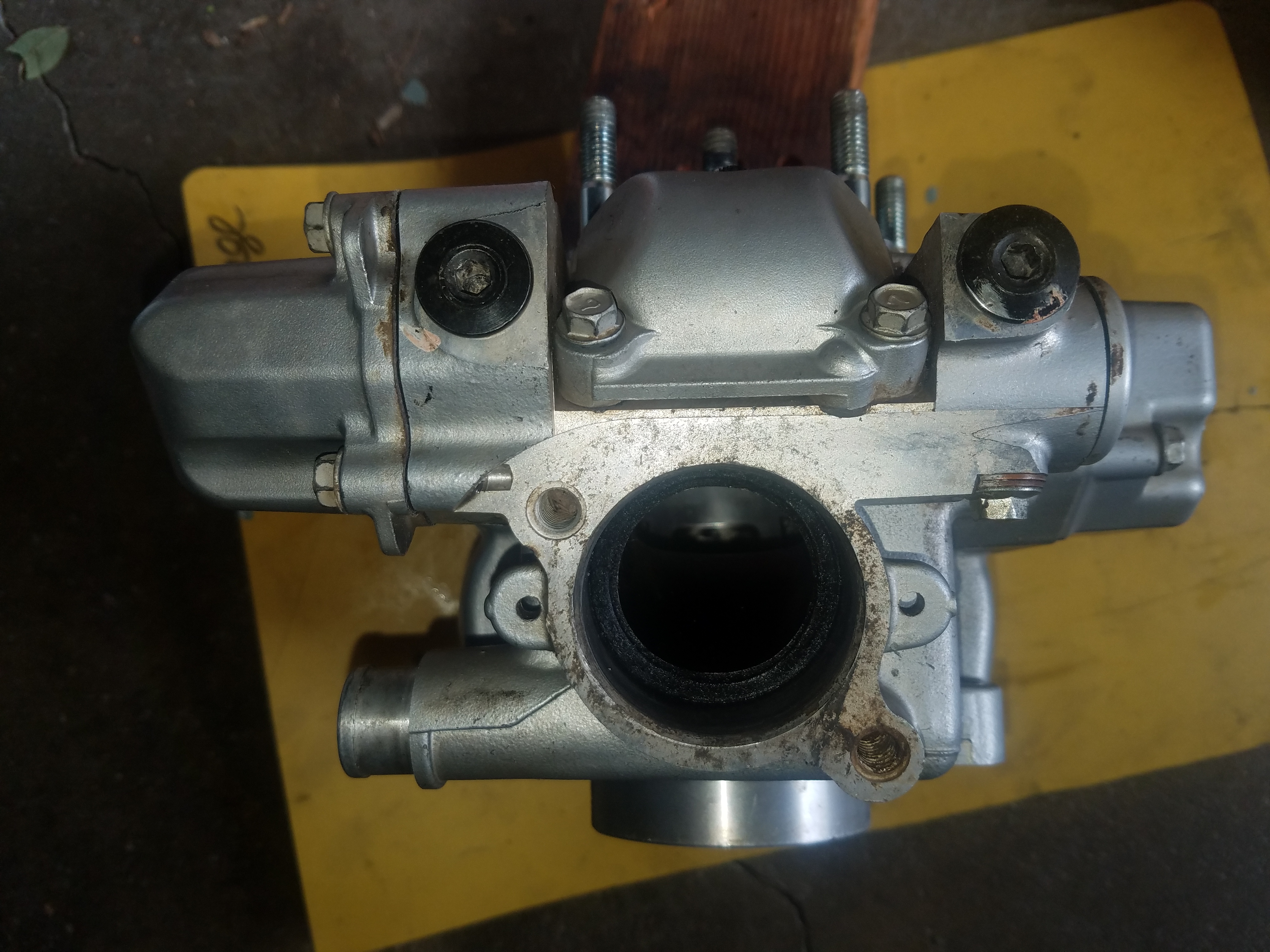

Two_stroke_brit,
Does this photo help? Do you see what you were asking about in this photo?
- 20201228_140330.jpg (3.39 MiB) Viewed 2953 times
Re: picture needed of kips valve assembly
Is that your cylinder?
It looks like a non-USA cylinder with the pipe mounting flange unbolted.
