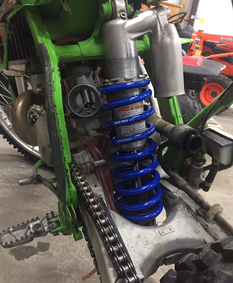

I also should add that all these past months my shock compression has been set a 1 (2 if you count first click).
With all that experimenting on fork settings, you’d think a guy might at least check where the rear was set. But, not me !
Anyway, the new spring is really pretty too.
- 63848038-13C6-4E56-875A-A11BC059202F.jpeg (748.62 KiB) Viewed 4988 times

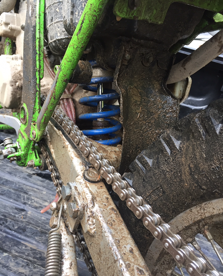

And even better with some appropriate coating:
- Goat
- Posts: 720
- Location: Clinton, WA
Re: 5.2 Spring - Holy Weaponry, Batman
Pic
- 50ED3186-AE53-4369-B48F-55000A9A84B5.jpeg (937.77 KiB) Viewed 4978 times
Good job.
What is your current weight in full riding gear?
Sorry to bump and old thread, but Goat, did you need any kind of adapter collar or washers? It doesn't look like you did.
I'm 6'4" and about your weight and am trying to keep the back wheel on the ground. Not sure if I should just order a spring or splurge on sending it to a proper tech... Did you do anything else to the shock besides the spring swap?
- Goat
- Posts: 720
I just swapped the spring with what came in the box. It may have had a new washer in there. Can’t recall for sure, but for sure no extra parts were purchased.
…. At the success rate of my diet plan 5.4 may have been better move for me.
I will recommend lubing threads excessively when you adjust the collar. I did mine dry and clean and maybe goobered my shock threads a little.
