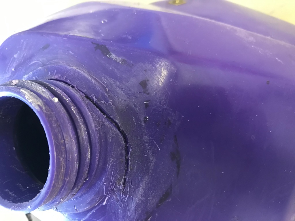

My 99 220 had a cracked filler neck, pretty bad, about 1/2 way around. Used and new tanks are more than i wanted to spend unless it couldn't be fixed. So I gave it a shot.

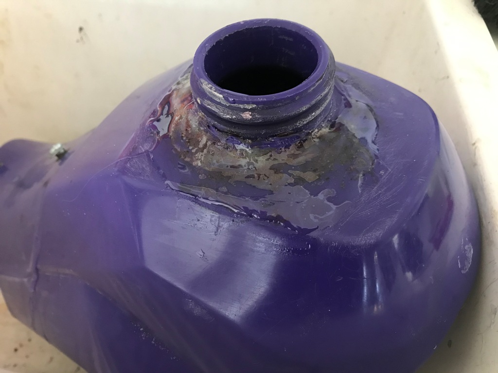

What i found the gas tanks are made of High-density polyethylene (HDPE). I bought a cheap harbor freight plastic welder, basicly and soldering iron with a flat triangle tip. I bought (HDPE) welding strips.
I got the PE plastic strips and welded the tank, seems to stick, time will tell. I covered with plastic epoxy to make it look better. I ran my finger inside the tank and felt where the weld oozed through.
I know....its ugly.
I pressurized the tank, checked for soap bubbles and the pressure held until i released, about 15min.
Plastic Weld Cracked Tank Filler Neck.

It may be ugly but, if it works, who cares! Your bike is rideable! Good job!
Re: Plastic Weld Cracked Tank Filler Neck.
If it holds, it holds! Good job.

Yep, time will tell. Worse case scenario, I’ll buy another tank.
