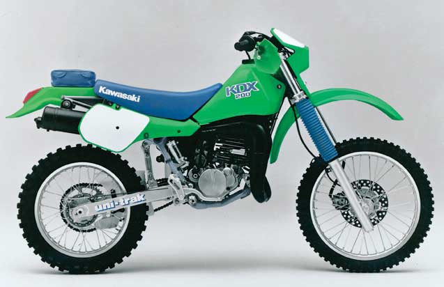

How slightly newer??
Got a pic?

It's an 86. I cut the tabs off and rewelded to fit my 84..
What is the purpose of being able to remove the exhaust tip if you cant pack it?

Re: Stock Silencer Packing
Like this
- kdx2001988color_edited-1.jpg (30.23 KiB) Viewed 2789 times
NOT repackable. It is a baffle for sound reduction. Pointing the exhaust and sound down (besides the internal portion) helps out.
