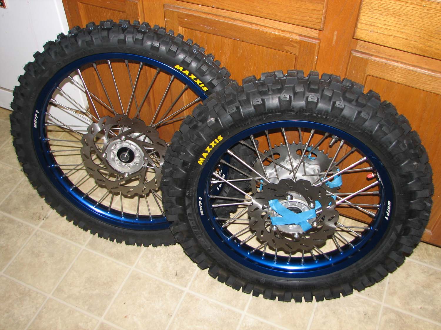

Here's a pic of my Warp9 rims mounted to a '90 KDX rear hub and a '96 KX125 front hub. I built these for mt '90 white/blue KDX in my signature. Now these same rims are on my '98 KDX 220 with offset adjustment.

Those look amazing man
