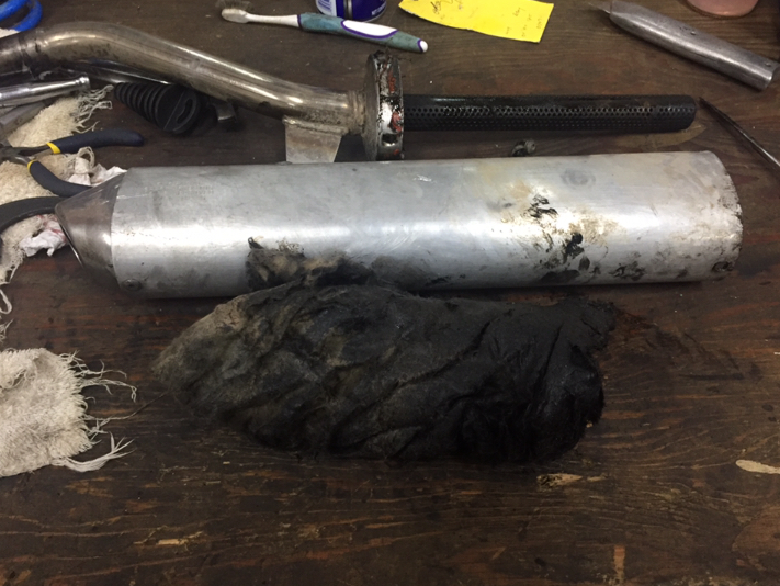

Re: Extra Spooge - theory
I finally repacked my silencer. Seems I should have invested in $10 wash plug, some time ago.

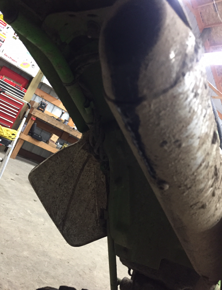

So anyway. I have done 3 things:
1. Straight rubber hose for tank vent cap.
2. New plug
3. Repack Silencer.
My spooge is back to normal flow, or maybe a
little less than normal.
Would y’all please let me know if this looks normal to you?
This pic is spooge after normal day. About 6 hours in the woods so est 3-4 hours of hard riding, between 200 and 1800 ft elevation. Bike running great, by seat of the pant eval.
That is too much.
Take the pipe off and clean it out. Lean it out a little.

Too much drool for me, but I'm curious what premix you are running - or rather, what is your premix's flash point? When I switched to Yamalube 2S (very low FP), my spooge production mostly ceased. Never spits or drools - minimal smoke and runs great. I am running the OEM pipe, and recently rebuilt my stock carb using stock jets, etc. I am running the BR8EIX plug.
My theory is the KDX when run on trails, more completely burns a premix oil with the lower FP. However, if you aren't running in the woods but are running MX or a lot of WOT - the higher FP premixes would burn more completely and may be preferred (as would the higher octane to avoid detonation).
If you are running higher than ROM 90 octane fuel, this also delays the combustion and lowers the temps which burns even less oil and sends more spooge out the exhaust. My bike runs on the 90, non-ethanol and mostly in the woods - so a lot of 1/8 to 1/2 throttle with some WOT here and there. I think a lot of folks make a mistake of running the high-end/high dollar brand premix along with higher than factory recommended octane fuels thinking they are doing extra diligence for the longevity of their motor, when in reality a lower flash point pre-mix combined with 90 octane runs better and produces less smoke and spooge.
If you are running higher compression like my son's KTM 144SX, it makes sense - but not on a lightly modified KDX trail bike.
Keep in mind, the service manuals are written with the severe service user in mind. The service intervals and other recommendations always lean toward overkill to protect against failure.

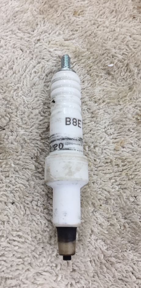

PS. The bike runs like a raped ape. And has never fouled a plug. This is picture of plug after 24 mi enduro race (3 laps / 45 min ea).
Note this is my avg plug. Not a WOT plug chop.
I might try a different needle. Try to do some test runs where you can limit the throttle range.
For example, my 1994 was a bit rich from 1/8 - 1/4 throttle, so I changed to a thicker needle as suggested by Jeff Fredette. It helped it out.
