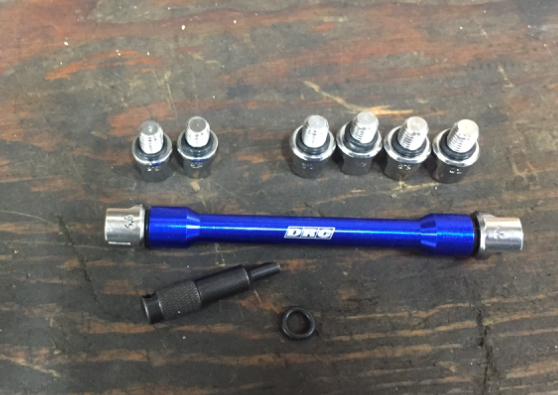

Re: Spoke Wrench?
Lucked out. My buddy had the DRC kit.

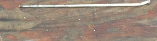

Re: Spoke Wrench?
So now I know I need a 6.0 to fix the one I twisted off! Duh.

Re: Spoke Wrench?
I did the 2 days of soaking them with WD40, and surprisingly got them all to turn. 3 of them on back, I needed to hold with vise grip. Even the one I broke snugged up pretty good before I pushed my luck hoping to find the “ting”. Should have known better.
