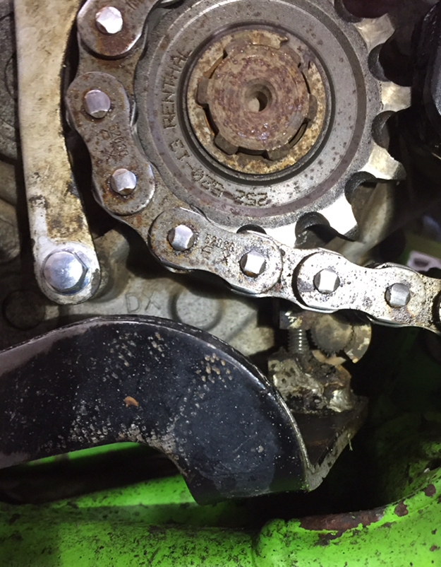

While servicing and inspecting the mounting interface between my shift lever and the motor the other day I noticed that the end of the lever has a bend in it. Does that look right. When viewed from above it appears the folding tip is forward of perpendicular from the direction of the bike's travel. Any thoughts? Sorry - I just thought of asking this question and don't have a better picture. Thanks for your input!

yep, it's bent
non-OEM fuel hose's non-OEM clamp is off too
and that front sprocket makes me want to see a straight-on picture :-)
Also, since you are racing, look into running "just" the metal guard on the front sprocket and not the plastic one. They can be a grass and mud catcher.

Yeah I was in the middle of pulling my carb when I took that shot so I knew about the fitting. Actually about to install a blue Tygon fuel hose too. That guard DOES collect a lot of grass and debris! Does anyone have a picture of the alternative you suggest or another superior chain guard that will fit?KDXGarage wrote: 01:16 pm Oct 08 2020 yep, it's bent ... non-OEM fuel hose's non-OEM clamp is off too .... and that front sprocket makes me want to see a straight-on picture :-)
I'll torch that bend and tap her into line - thanks for the verification!!!

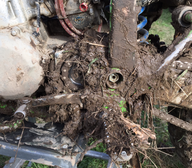

So I took the plastic 'grass catcher' off and used shorter bolts to keep the steel guard in place - I like it much better. Rode all evening in the woods and fields, got home, NO GRASS! I also bent the the shifter back into alignment (yes I took it off first!). Mucho bettero.MoonStomper wrote: 07:58 am Oct 12 2020Yeah I was in the middle of pulling my carb when I took that shot so I knew about the fitting. Actually about to install a blue Tygon fuel hose too. That guard DOES collect a lot of grass and debris! Does anyone have a picture of the alternative you suggest or another superior chain guard that will fit?KDXGarage wrote: 01:16 pm Oct 08 2020 yep, it's bent ... non-OEM fuel hose's non-OEM clamp is off too .... and that front sprocket makes me want to see a straight-on picture :-)

I need to try that too. I can just tape the plastic piece to the x-bar, so 2 benefits!

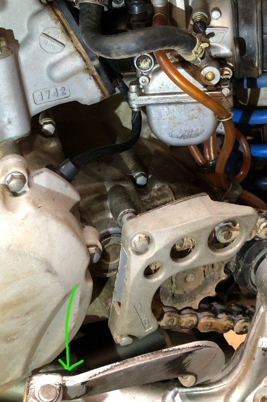

I went to do the high tech chain cover mod, and found a loose shifter. When I went to snug it down, I found why it was loose. Of course the was at 10pm, day before a race.

Removing the plastic cover would be more useful if I could avoid dumping it in the mud pit on left side. But it did help some.

I think the shifter breaking there is fairly common. I had mine welded but it didn’t hold. Only solution I found was a new lever.

I welded it, and it made it thru the race. But I don’t trust it, so will be shopping for another and keep this for spare.
