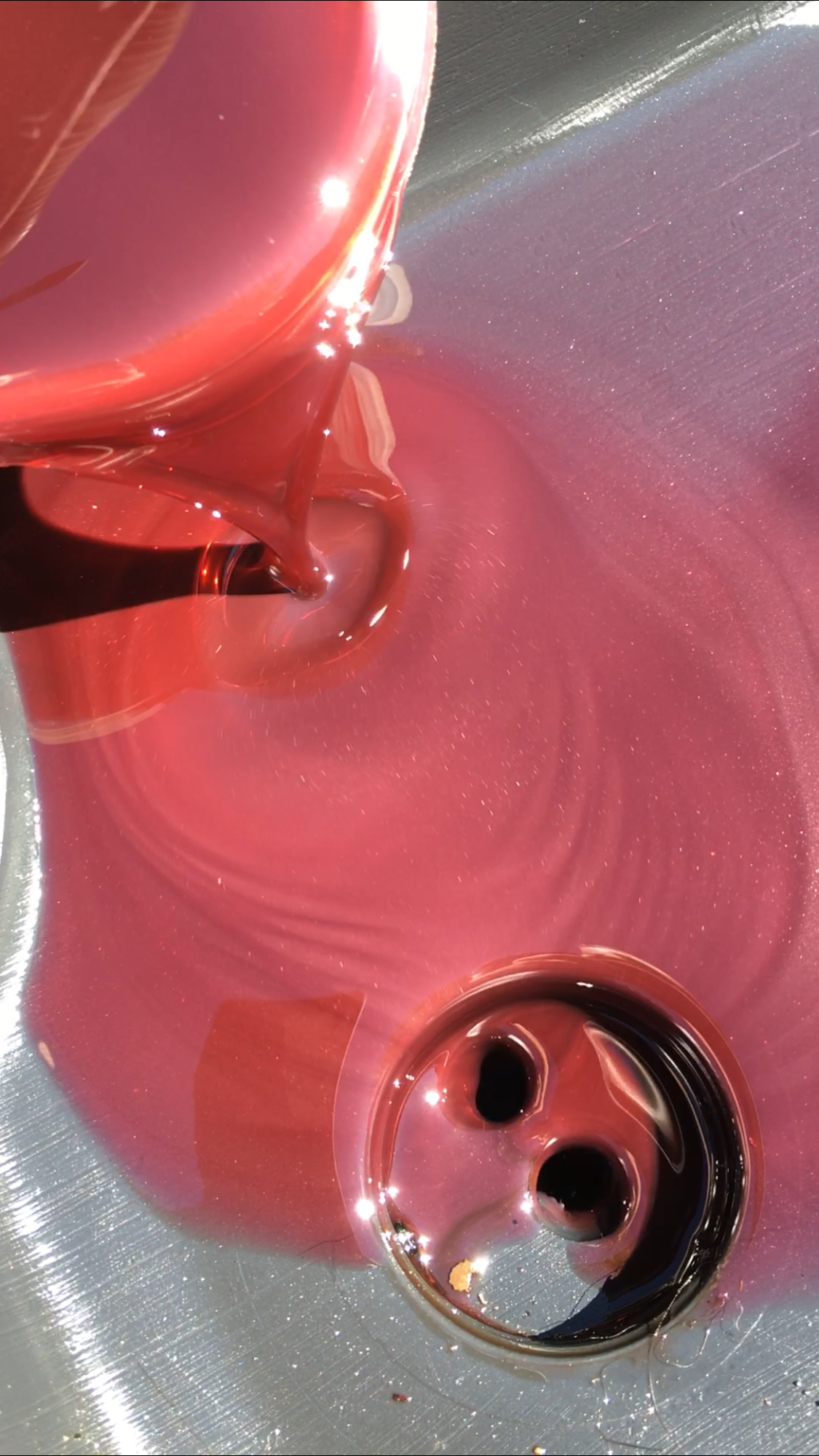

Took it out for the first real ride since the rebuild. Bike ran great, seems to be the perfect bike for my riding style. But Lots of aluminum flake in oil (ATF) changed it twice in 2 hours run time and it doesn’t seem to be getting better. Prob going to pull the clutch basket out and have a look around. Replace and upgrade parts if needed. And will use some 10w-40 Rotella next to see how that works out.
