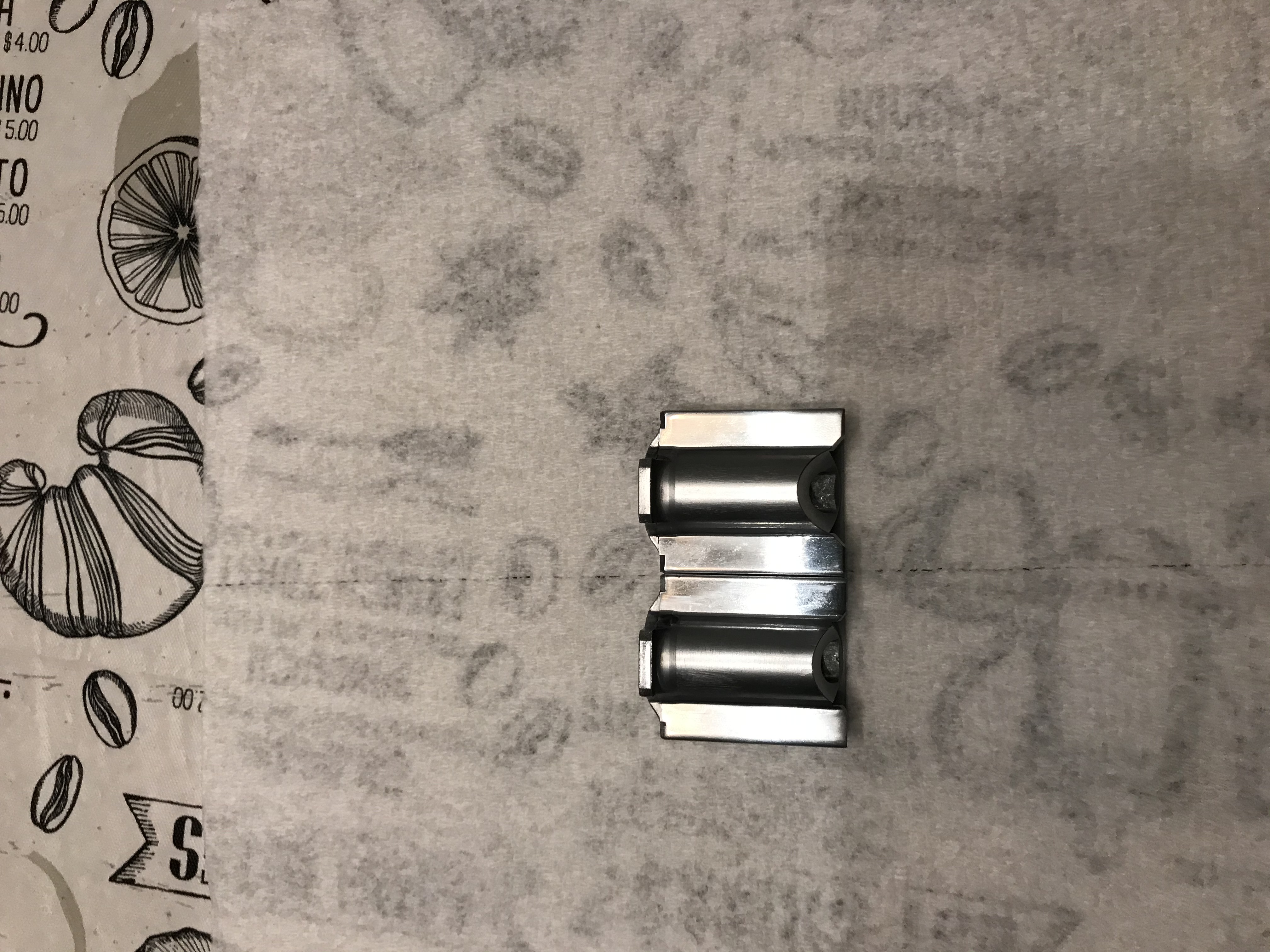

As many of us have complained about loosing too much low end with the bigger carb mod I decided to take this head on and figure something out and this is what i figured out so far. The culprit that#$$%^&** #5 slide. We have had to go to very lean needle setting to compensate for the Ton of extra fuel poured in by the severely high vacuum of the number 5 slide. Its no secret that when a 2 stroke is jetted too lean they just dont pull like when givin a slightly richer setting. In an earlier post i said that the 7 slide was a huge bog dog I was wrong i just didnt take it to the next level and re administer more fuel back into it. This is a total reprogramming of the carburetor And you must throw all concepts of what you know and have learned from jetting with the 5 slide as the carburetor is now metering the fuel in a completely new and way more controlled fashion than before. The first thing you will notice when starting the bike is the idle will be way to high even thought you never moved the adjuster now the idle is controlled by the pilot jet Gone is that pesky 1/4 throttle wishwashiness we all hated.Idle quality is much better now. The midrange is now controlled in a much higher fashion you can now richen it quite a bit and its spot on thats exactly where our power went to lean of needle position. and the main will be the same. If this is a computer you just killed a very nasty virus and in stall a new operating system. I rode the bike for hours at the woods and could find little fault with this new set up. There no genius in this new setting as my both my YZ and the 13 ktm carburetor came with #7 slides in them so i knew the answer had to be there and is is Here are the new settings With the 7 slide yes they are wayyyy different that is a good thing as it addresses exactly what we were complaining about. This at sea level
7 slide
Stock needle in the 4th position
42 pilot
155 main
If those blingy reed cages cost 150 this is worth 250 but the slide only cost 60 bucks shipped on ebay you will need the slide for the PWK 33-35 carburetor
here is a picture of the two slides and the difference the left is stock the right is 7 Be careful not to go way lean on the pilot jet as before as on high speed decels the fuel comes from the pilot all that extra fuel is gone ENJOY
7 slide
42 pilot
155 main

Good write up and completely agree, I tried forever tuning with the number 5 slide, I ground it to a 6, it improved, then to a 7, it improved again, I stopped at 7.5
The slide, pilot jet and straight diameter of the needle are all. Interlinked at low rpm

It's not that difficult at all, lots of info on the Internet about how to cut them, the numbers reference millimetres so it's just a matter of scribing a line and cutting, I used a stone then finished off with a filebikeman2502001 wrote: 05:30 pm Aug 23 2020 you must be a miracle worker if you can grind one of these slides correctly we used to do it in the old days but this one looks much too difficult for me I just bought the correct one

I now am very curious that this might be at the core of the RB carb as it might very well the smoking gun, If any one has the Rb carb if you dont mind the next time you have your carb off would you mind measuring the slide cutaway its in millimetres It might say 5 on it but it might not be a true 5

It's a seven, I also have the rb carbbikeman2502001 wrote: 05:54 am Aug 24 2020 I now am very curious that this might be at the core of the RB carb as it might very well the smoking gun, If any one has the Rb carb if you dont mind the next time you have your carb off would you mind measuring the slide cutaway its in millimetres It might say 5 on it but it might not be a true 5

Hmm. My airstriker 35 came with a 4.5 slide - it looks like there's some performance left on the table with the jump up to a 7. I would be keen on trying to grind this - I have my old PWK33 slide to practice on!
