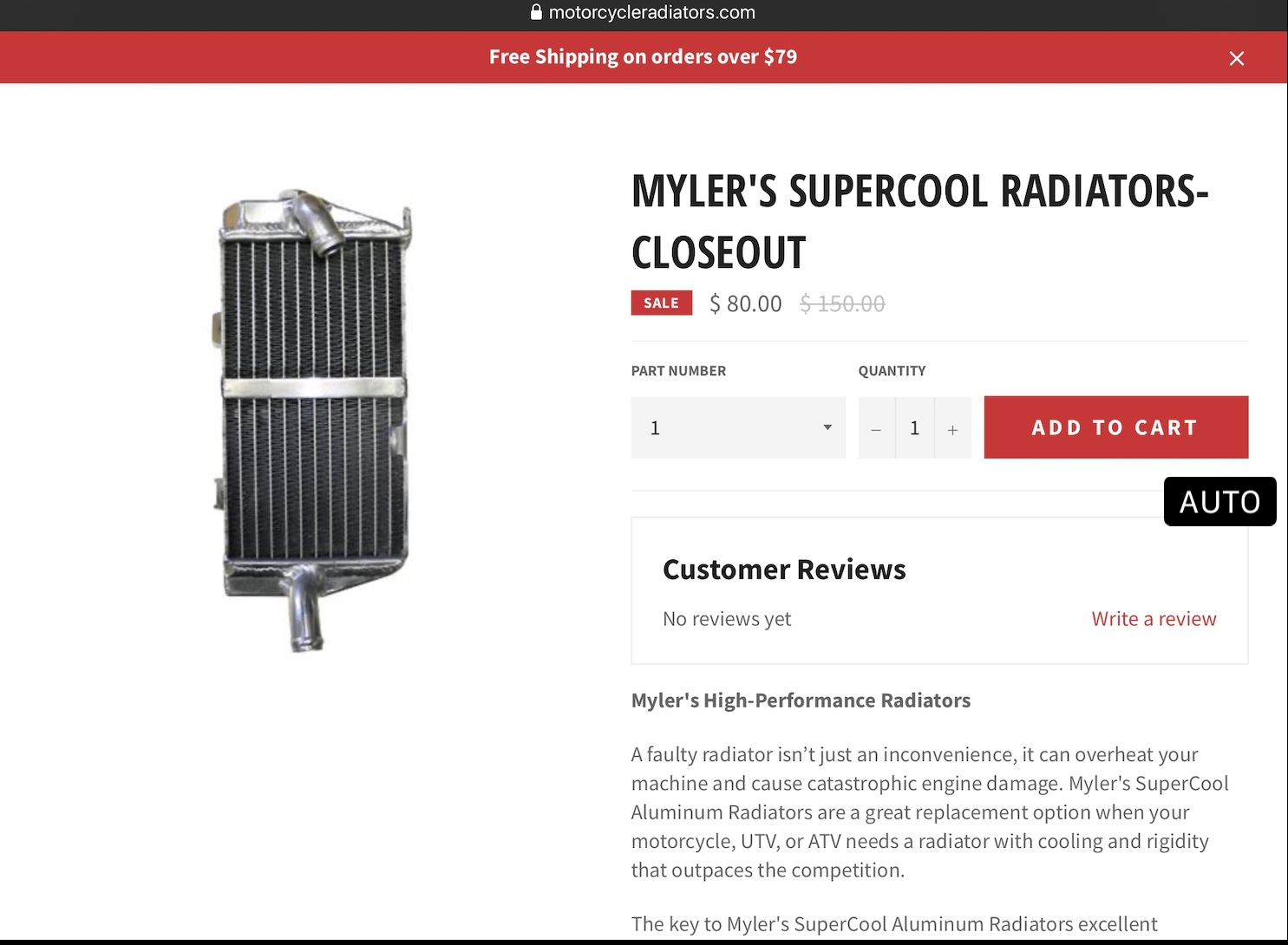

Re: Chinese radiators
These guys are in the usa but Mylers motorcycleradiators dot com can rebuild your factory radiators and reinforce them to better than new. They pressure check their work, they also have a kdx200 95-06 cap side radiator for sale currently in their close out section right now. They specialize in aluminum radiators. The website has pics of the work they do, rather than buy a Chinese radiator with fewer veins check into the repair section on the site. I have oversized Mylers radiators on my Honda and have no issues boiling over.
Restore rather than replace

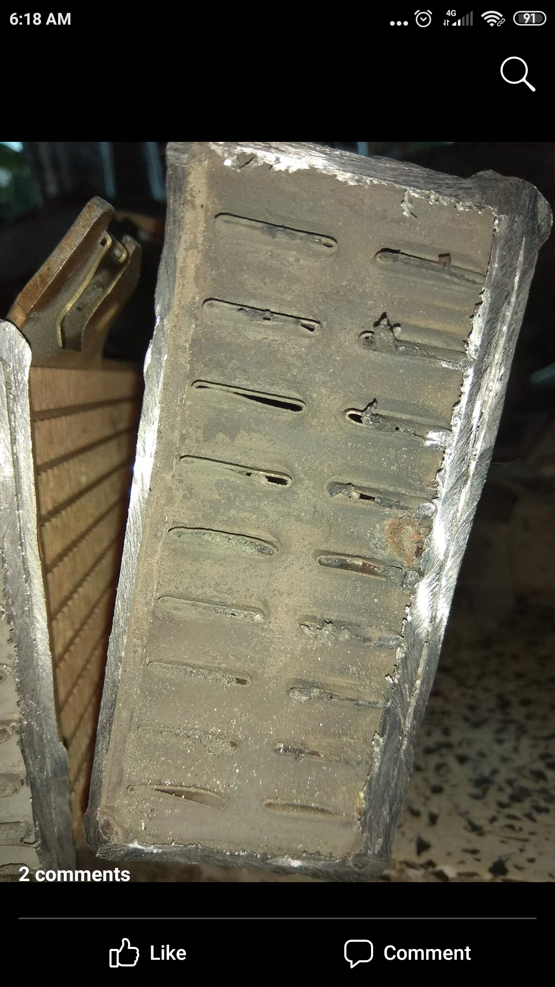

Cheers guys, good info, as was mentioned I run the hacksaw blade through and even though I cleared the ends I might have missed dirt on the inside, could corrosion and a thin layer of dirt on the inside reduce cooling efficiency, when I tig welded them back together I spent a bit of time filling up with water, shaking them about and emptying them but nothing came out, I flushed the whole system, I've never heard of flow checking, I will Google that or if anybody can give me some pointers. Included a photo of how bad they were when first blocked, I did have a crack on the carb which I found with a leak down test but sealed that up with rtv silicone. I know I sound like an old washer woman whining about issues but this bike has been nothing but 2 years of problems, and mechanics in Thailand are inept at the best of times so I have to do what I can in an apartment with minimum tooling.
- Screenshot_2020-08-16-06-18-26-485_com.facebook.katana.jpg (931.47 KiB) Viewed 3992 times
WOW! THAT'S CLOGGED!
- Posts: 86
- Joined: 10:10 pm Feb 28 2020
Yeah that's bad.. seen some early bikes look like that, usually from filling with hard water (NOT distilled) or some sort of electrolysis problem, like not having a good ground or a loose one, or wacky headlight wiring.
If I was you I would bite the bullet and try to buy some OEM radiatorss off eBay. Each side is $99 for a good one and that will get you good in the radiator department. Then if its still overheating, you can track it down, shouldn't be too hard.
As for now, If I was you I would fill the cooling system up with 50/50 vinegar / water , run the bike for like 10 minutes or until it gets warm and then flush the system out. Im guessing a ton of crap comes out. Let us know!
make sure you flush it really good afterwards, then fill it up, get it warm, and flush it once more

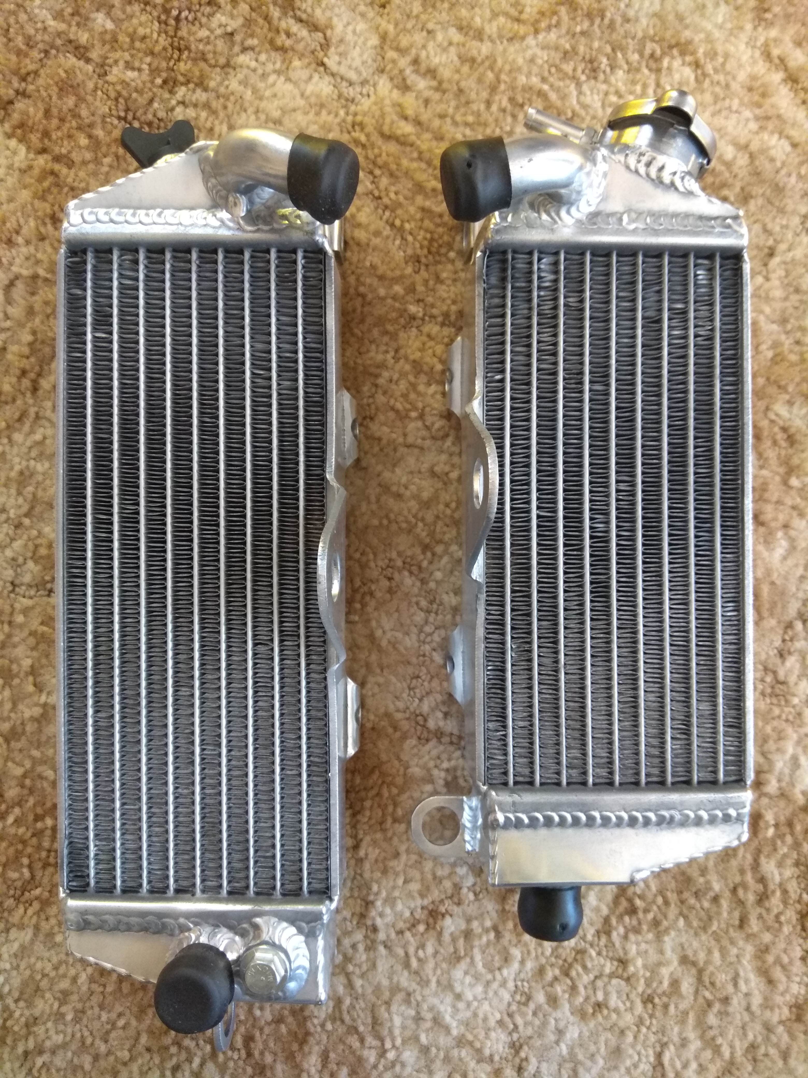

Radiators arrived today, 120 Australian dollars delivered. The radiator cores are one large core rather than 2 small cores as in my previous photo.
