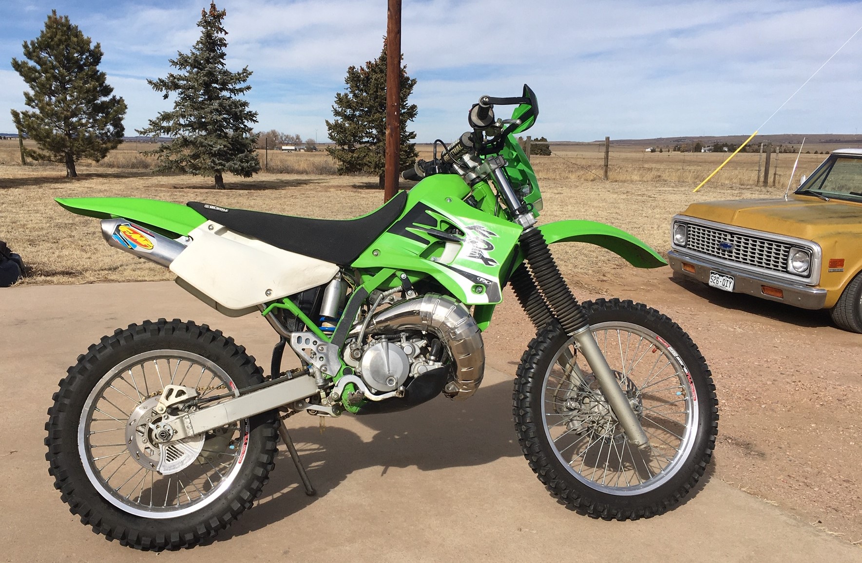

Picked up a hybrid KDX220/200 this week from a farm on the far eastern plains of Colorado - stunk up my garage like a honey wagon from all the field rippin' it did in it's previous life. I say hybrid because if you check the VIN it's a 2000 KDX220 (and the engine case serial number agrees). But the top end is stamped as 0.198ℓ - and the head seems to match the KDX200 microfiche parts number as well. I believe this bike suffered a 220 top end failure and it was rebuilt as a 200. One downside is that it still has the 220's PWK33 - not for long though...
I'm planning on basically doing a nearly complete tear-down and rebuild so that it will better serve as a mountain ready dirtbike for the central rockies of Colorado (5,000 to 13,000 ft, 40* to 90* Fahrenheit and plenty of rocks!).
I've done a good bit of research on this site and here's my current build list (Everything is purchased and on it's way):

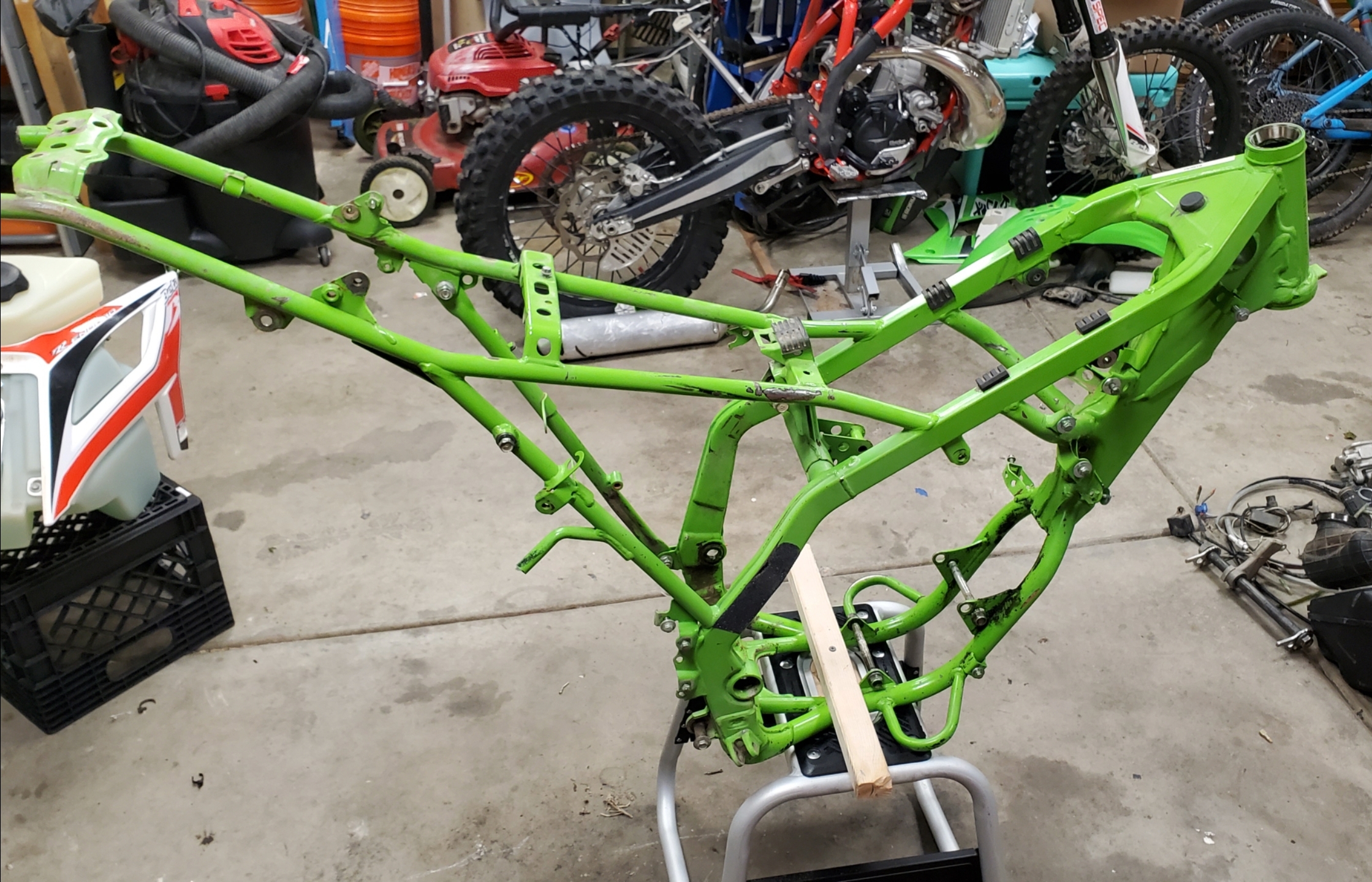

Tear down complete. Dropping the rear shock off to get rebuilt tomorrow then I certainly have my work cut out for me!
With the engine out now I'm going over it a little more. I'll do a high-level inspection of the KIPS and PV parts in general. Also noticed the ignition cover is plastic? Do most replace this with the boyeson magnesium cover or is it not as bad as it would seem (i.e. weak against impacts).

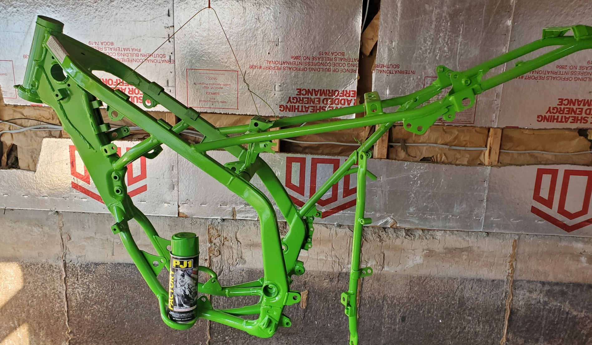

Some painting was done - swingarm to follow! My (ambitious) goal is to have it back together this weekend.
For those that haven't used it - the PJ1 frame paint is a dead ringer. Effortless to apply (the head does take some force to depress actually haha) and it really makes the frame look new again.

LOOKS GREAT!!
I am so glad they started making it again after about ten years without! I once had a guy in Canada mail me his helmet visor to paint so it would match his helmet he painted a stripe on. When he tried to find it locally, he couldn't get any.

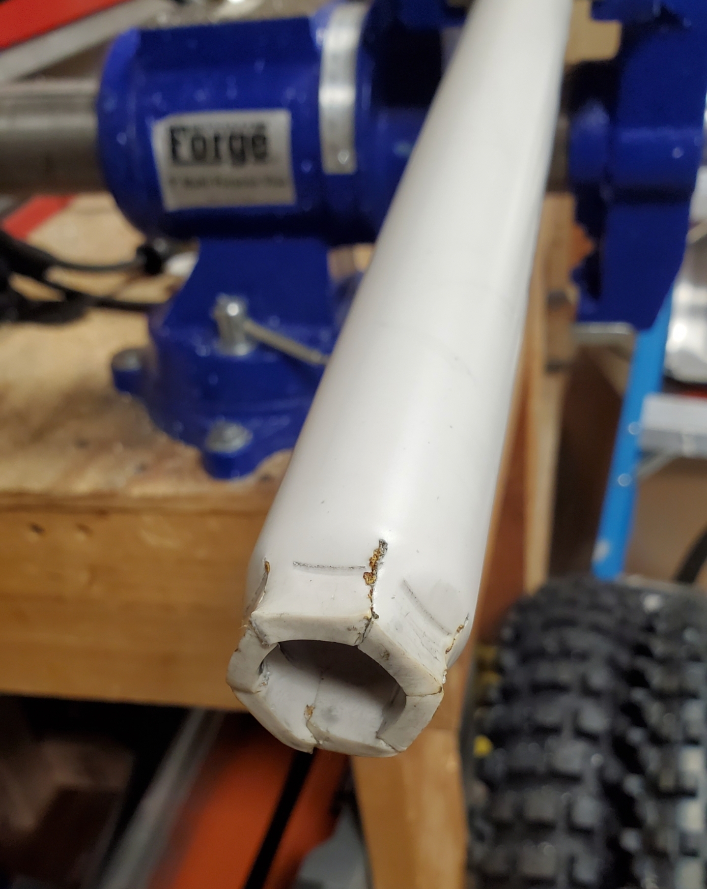

On the topic of base valve - I came up with this clever holder rig to disassemble my forks.
Basically 1" pvc with 6x cuts, heat gun it then jammed it into a 1-1/16" socket (basically 27mm). Worked perfect!

HA HA! Nice! I was wondering what material that was. Good job.

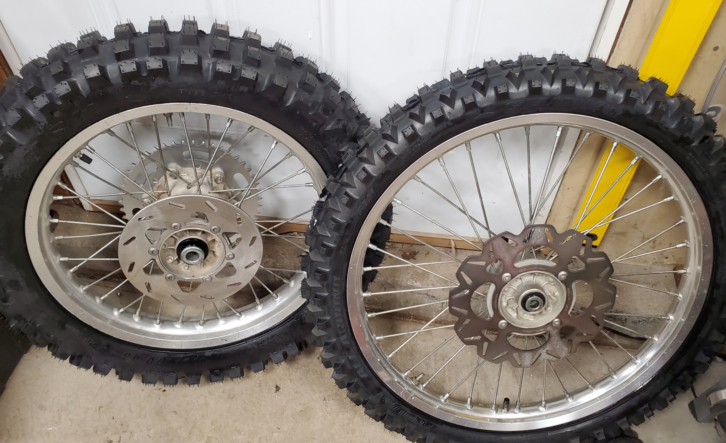

New wheel bearings, tires and tubes, front solid disk and rear sprocket installed tonight. Even scuffed up the rear oem rotor to help it bed in better if that's a thing.
On the front wheel I removed the plastic worm gear inside the odo dealy. Im not going to reinstall the OE odo so I figured that would be only beneficial, i.e. less mechanical drag. I replaced the large seal and packed the odo deal with a nice layer of grease then put it back together.
It shouldn't cause an issue not having that worm gear should it? I plan on doing the plug mod up at the cable connection to seal that off as well.
