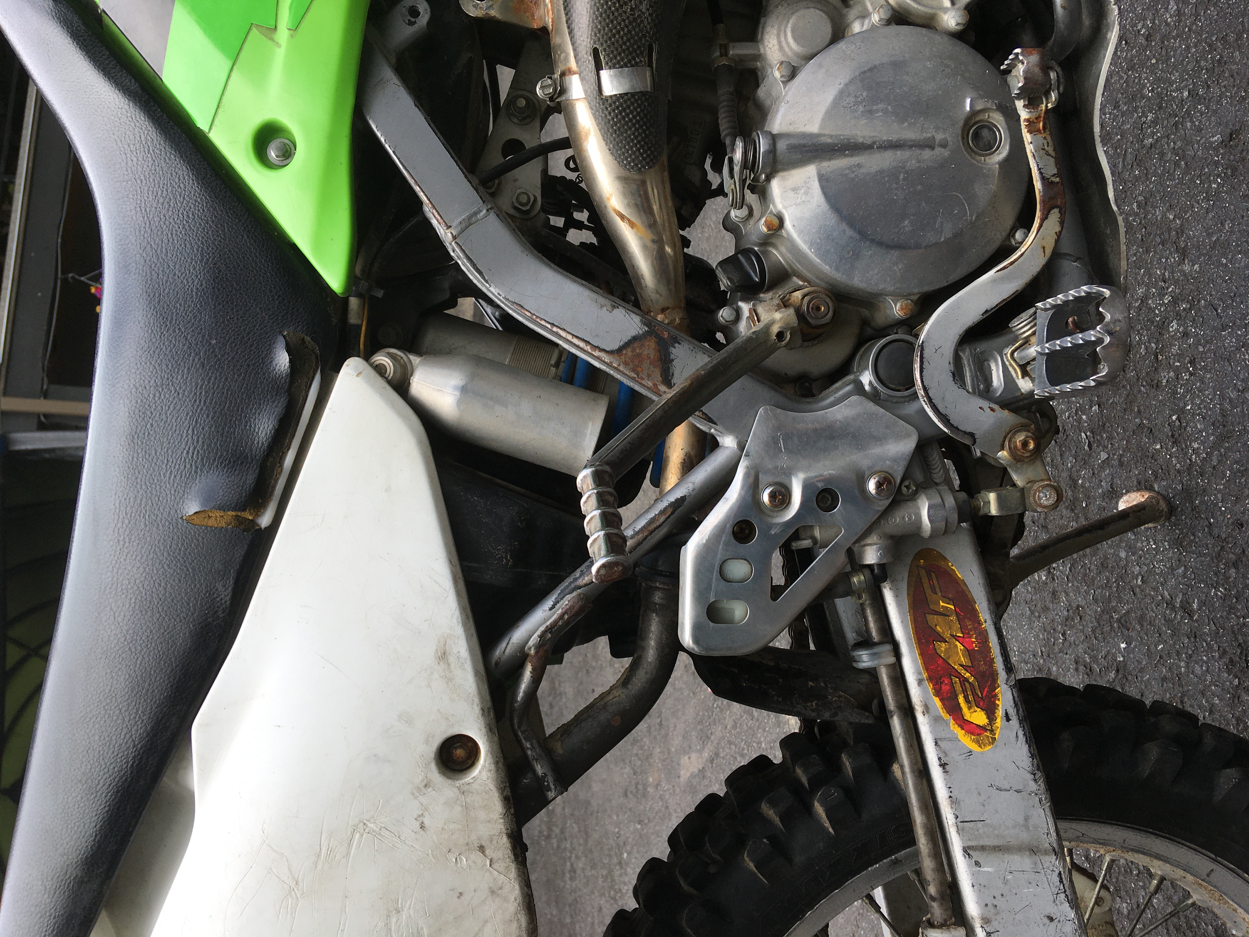

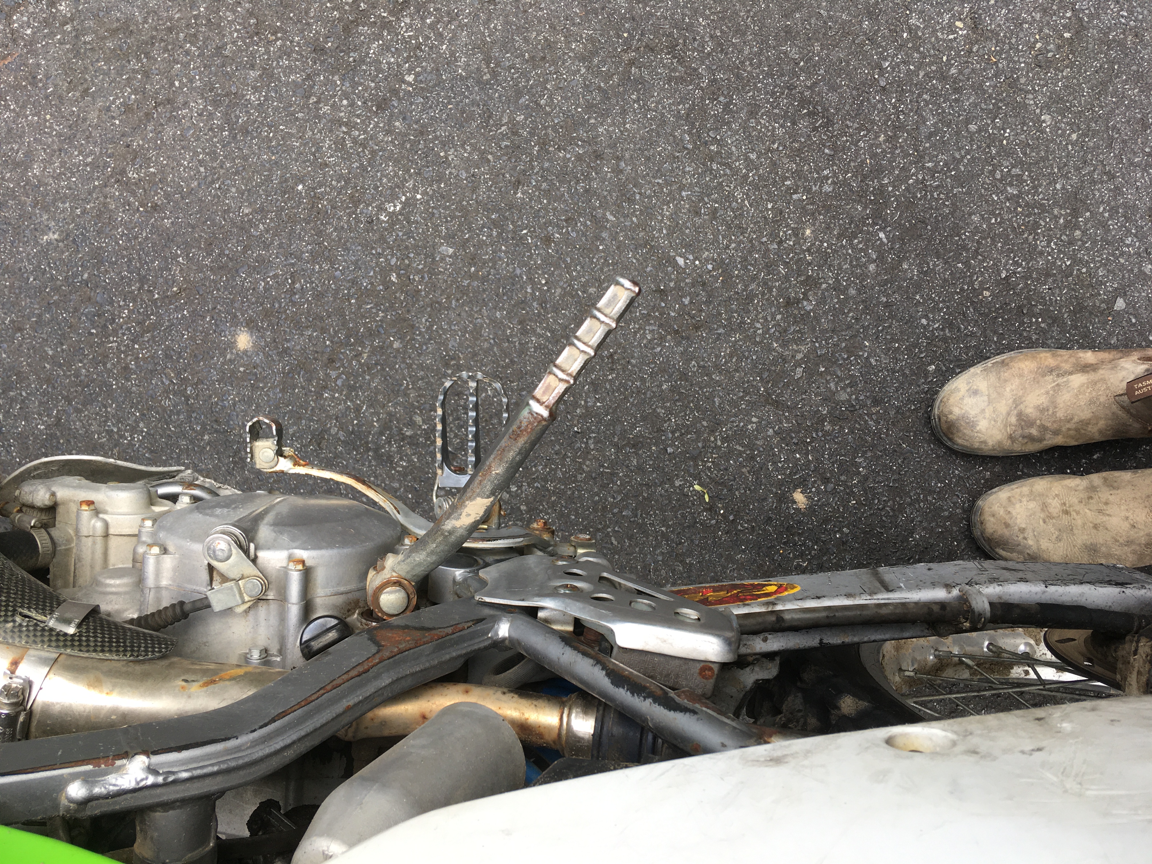

Here are the pics of the Kicker. As you can see, its bent way backwards, and isn't perpendicular to the bike. Also, the bike isn't kicking over...Anyone know what's wrong?KDXGarage wrote: 10:47 pm Jun 26 2020 The kickstart lever or kickstart knuckle being damaged is a separate problem. Maybe post a pic? Sounds like time to try to get someone to weld on it, and file it back to proper shape.

There is a portion of the kickstater that keeps it from flopping backwards. Look at some pics online to see someone else's that is not damaged.
A portion of yours is broke off.

Yup, Im aware. Need to order a new one. kicker still isn't catching properly tho, so I'm thinking it may be the spring.

Maybe he could weld the broken piece back on?
Re: Kick starter won't engage until past half way?
He could, but this is a perfect opportunity (excuse) to switch over to the KX125 kicker which, IMO, is a better set up anyway.
There's like a glob / knob portion of the kickstarter that gets worn off / broken off over time. It's not just his particular bike. I have seen it on different models and brands.
It's kind of like a door stop of sorts.
