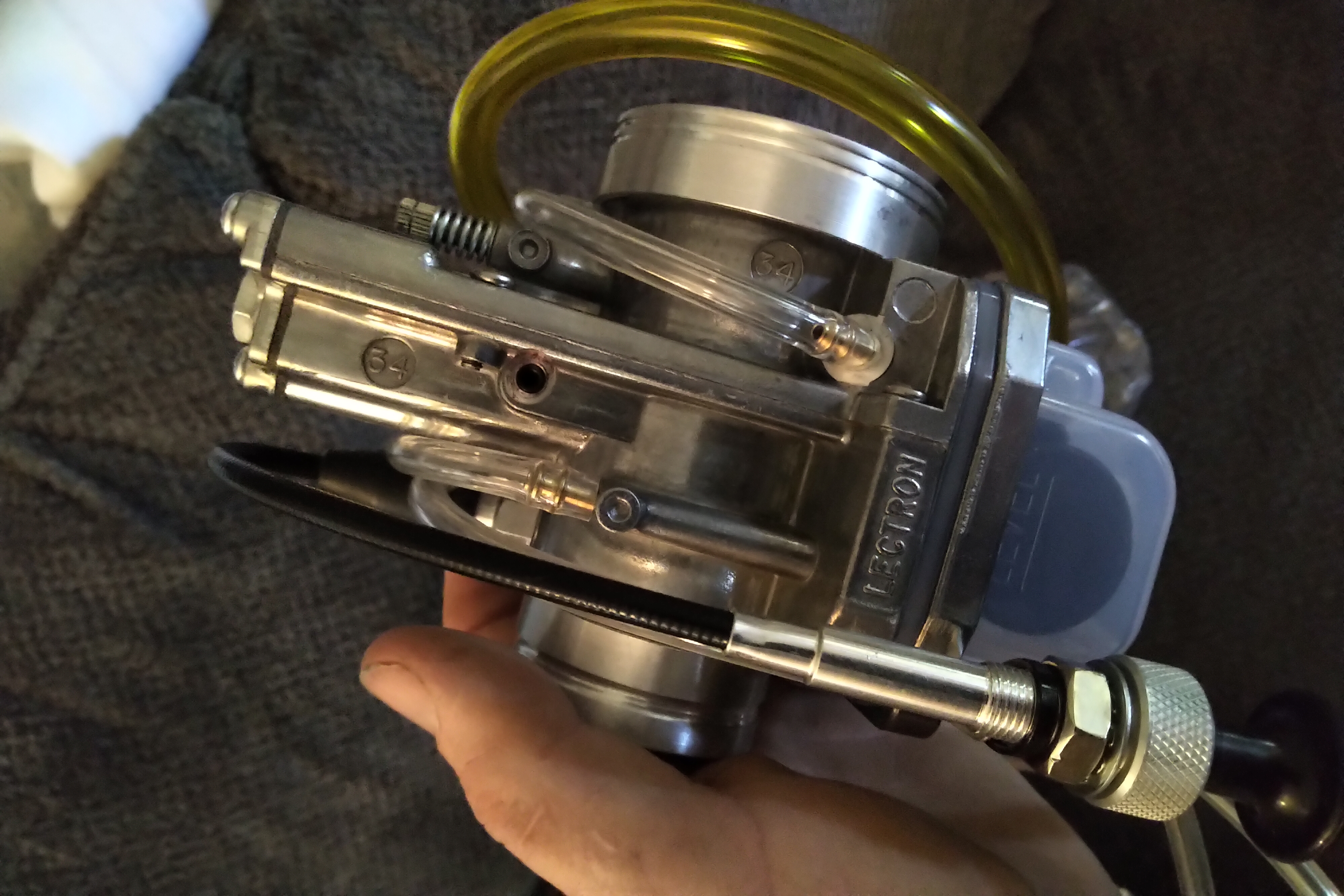

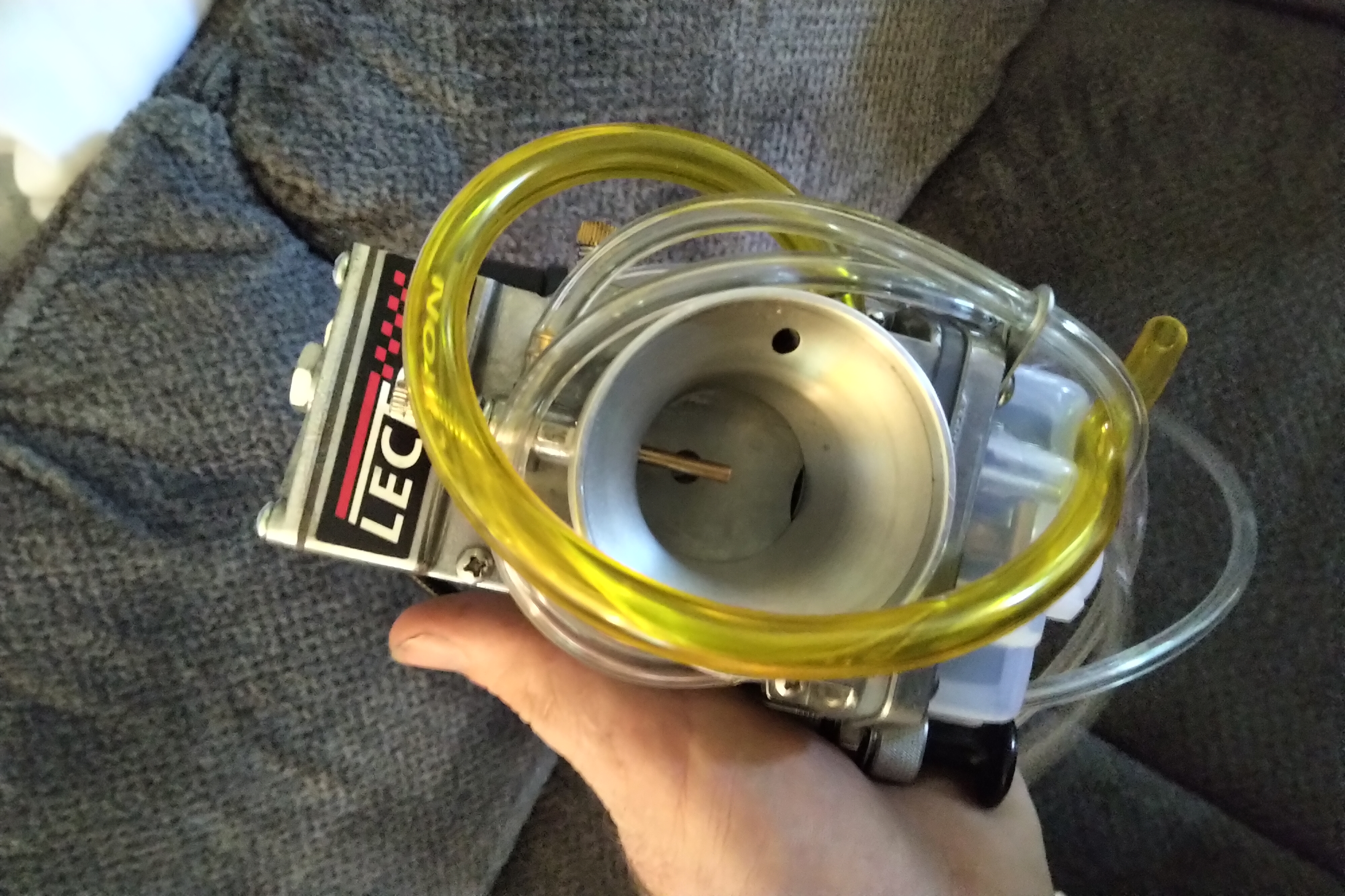

Here's the 2nd go around for the Lectron. The first was backwards. Covid put a slow-mo on it but she finally arrived today. Will let y'all know how she runs.
- IMG_20200724_1705526.jpg (3.14 MiB) Viewed 6259 times
- IMG_20200724_1705460.jpg (3.33 MiB) Viewed 6259 times

Cool. Congratulations.

Curious to see how the air cooled motor likes the Lectron. 34mm?
