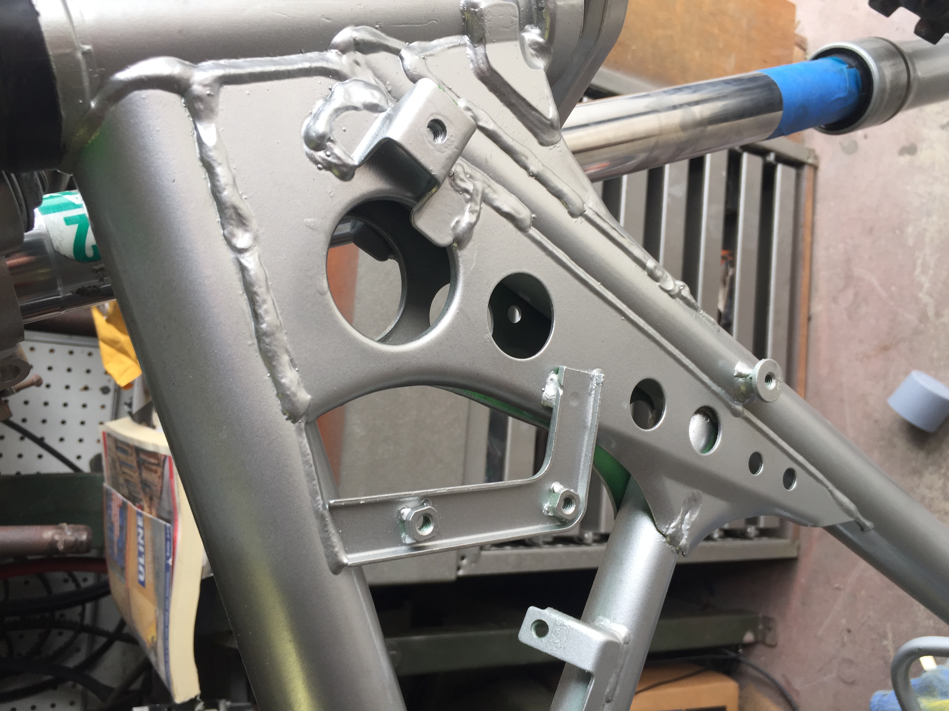

Fast forward to 2020 and I've got the engine reassembled and waiting for some minor adjustments to the crankshaft before I start full re-assmebly. Completely redid all the bearings, seals, gaskets, and added a Wiseco Piston . I soda blasted the engine myself and it came out OK so I'll most likely throw some engine paint on the case and the cylinder and possibly the head.
The paint job is rattle can Duplicolor Hyundai Silver. The Duplicolor products are WAY better than other brands that I've tried and fairly cheap from Pep boys. I upgraded most of the hardware to new components or polished existing stuff that was too expensive to replace.

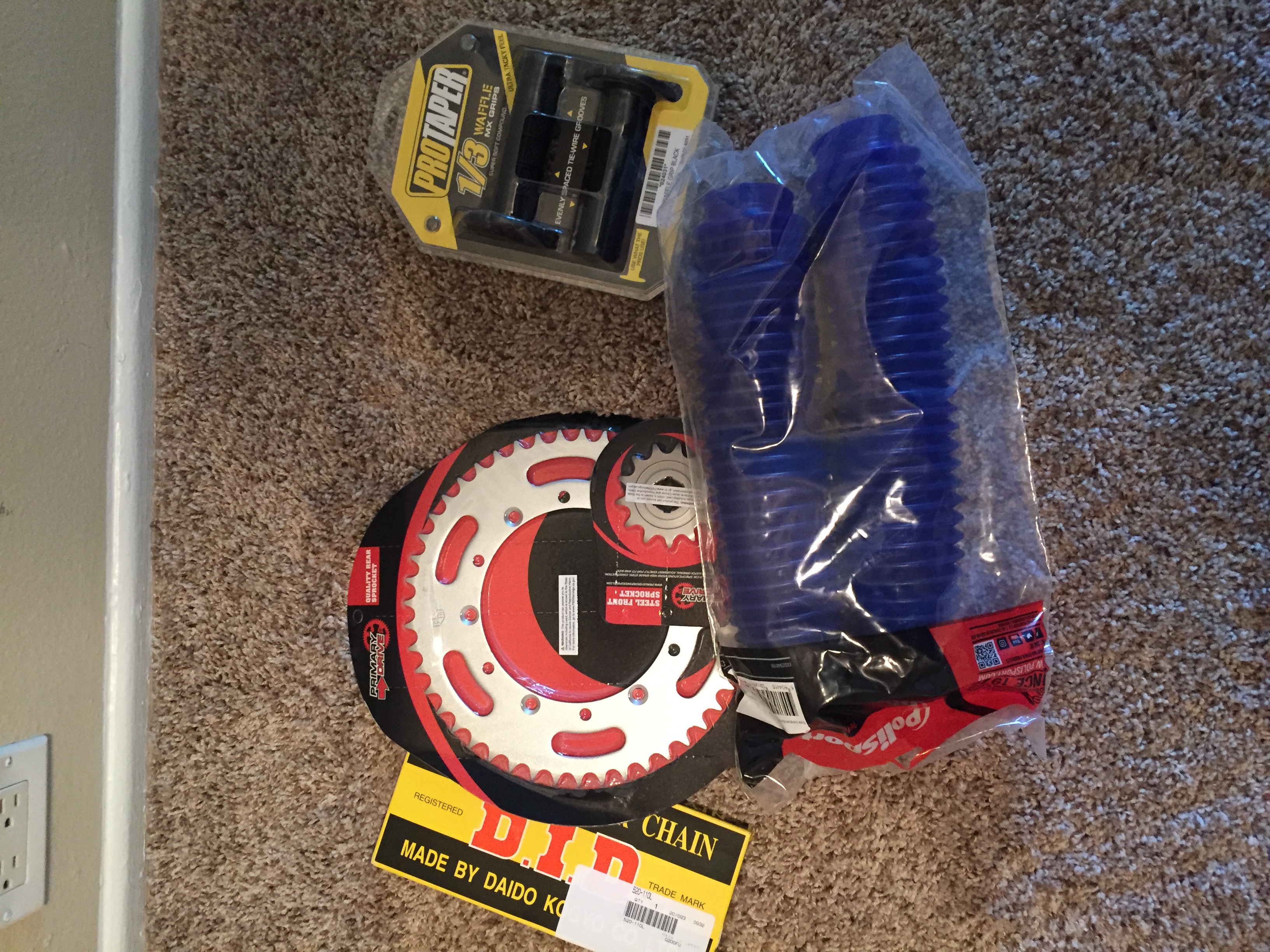

Currently ordered new sprockets, chain, grips, throttle cable, new front rim, tires, decals, and paint for the plastics.

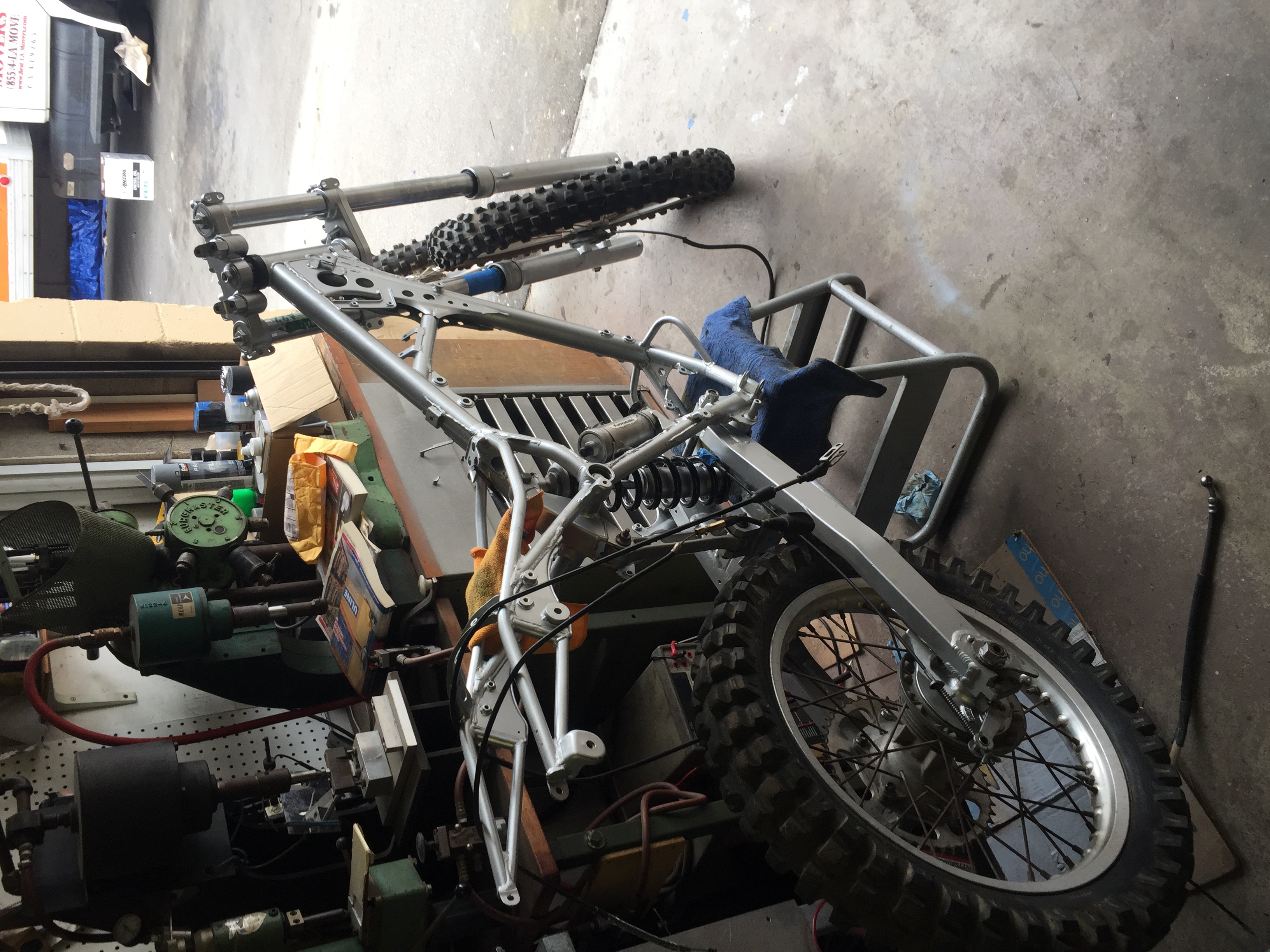

- Rear shot of it now
- IMG-5410.JPG (2.31 MiB) Viewed 8815 times
- Reassembling the cases
- IMG-4635.JPG (2.18 MiB) Viewed 8815 times

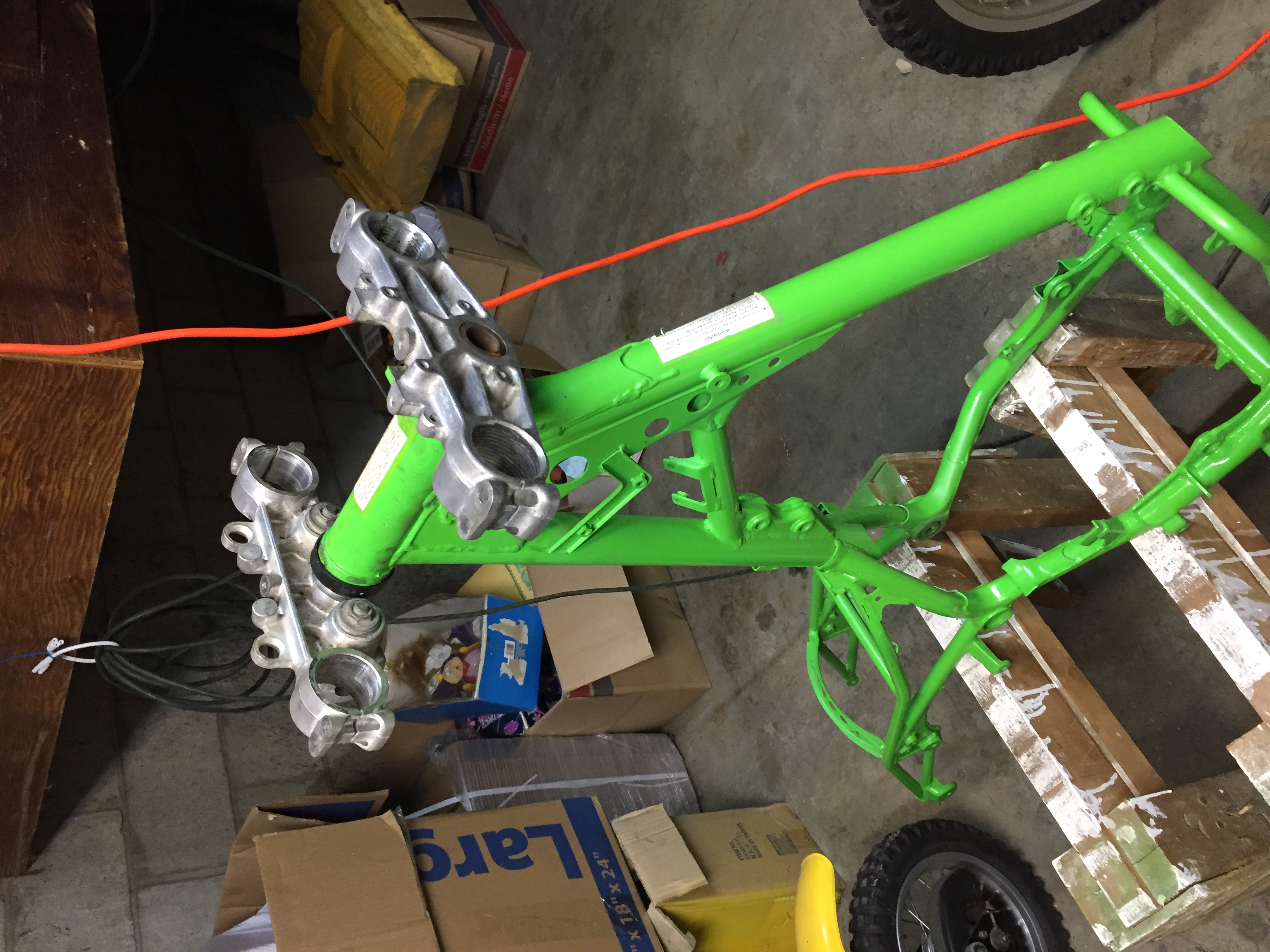

- Original attempt at painting the frame with Engine Enamel Green
- IMG-3547.JPG (2.05 MiB) Viewed 8815 times
- Color of the Frame
- IMG-5417.JPG (1.87 MiB) Viewed 8815 times
- Front view of the roller
- IMG-5422.JPG (2.48 MiB) Viewed 8815 times

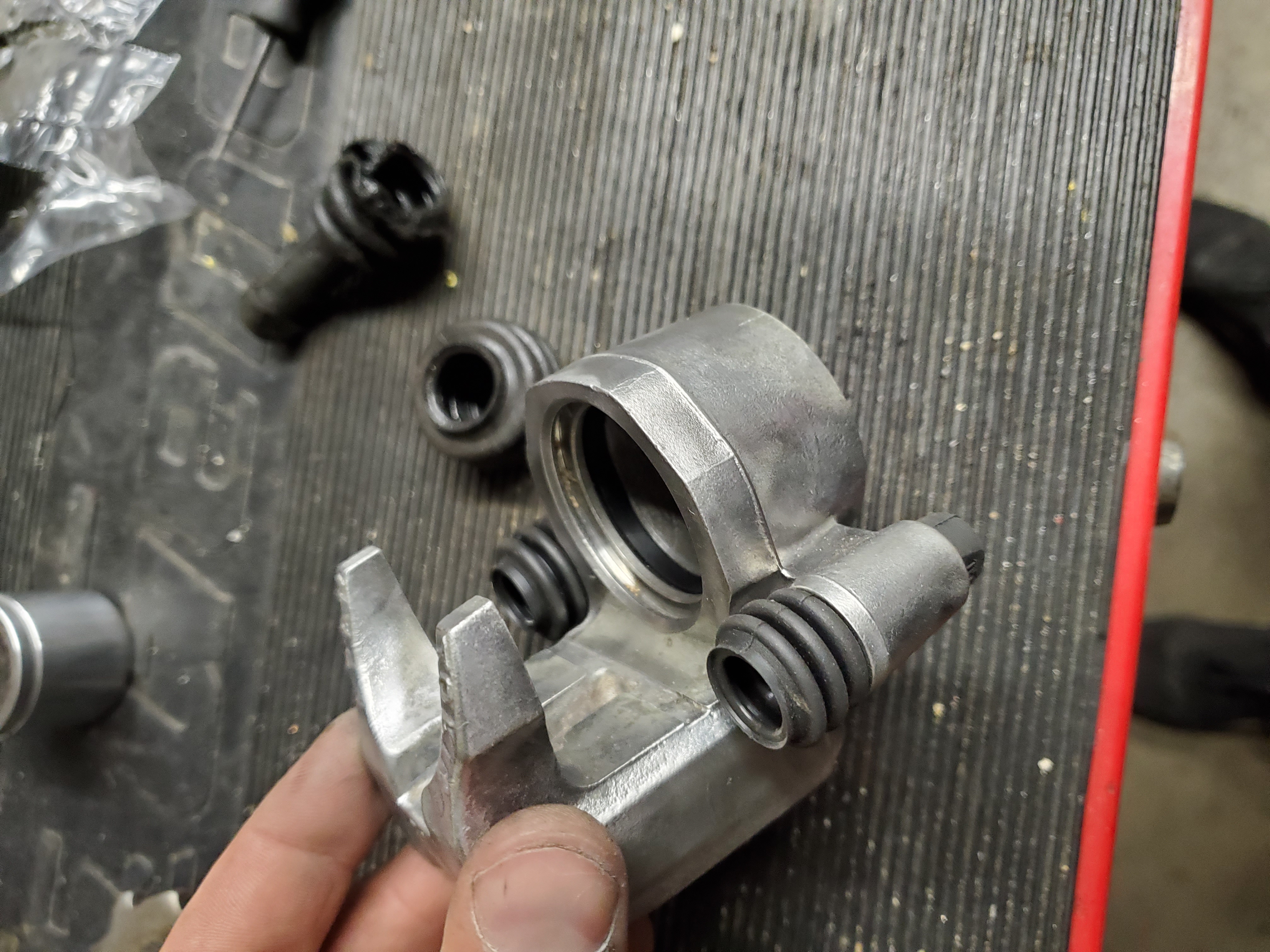

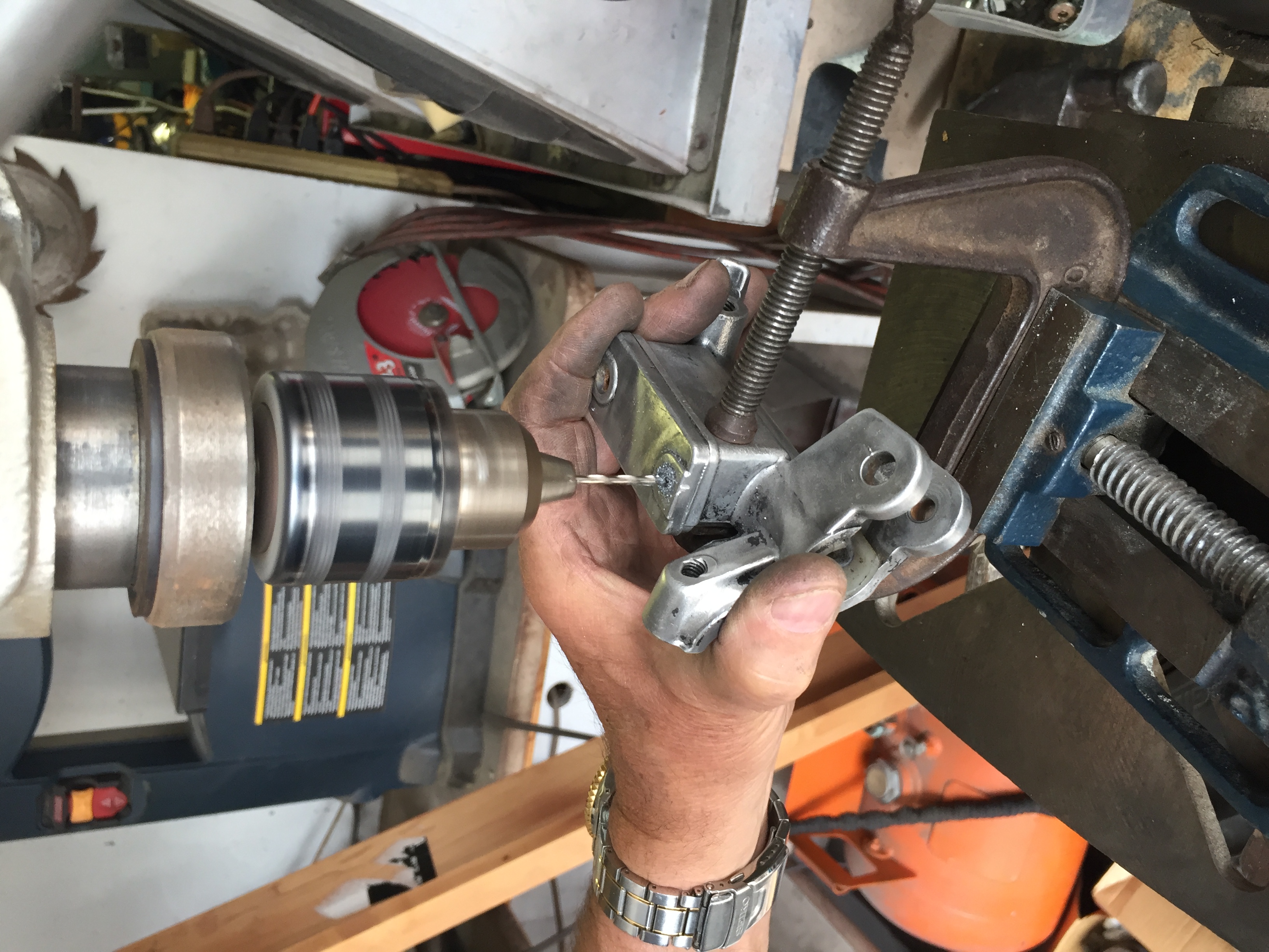

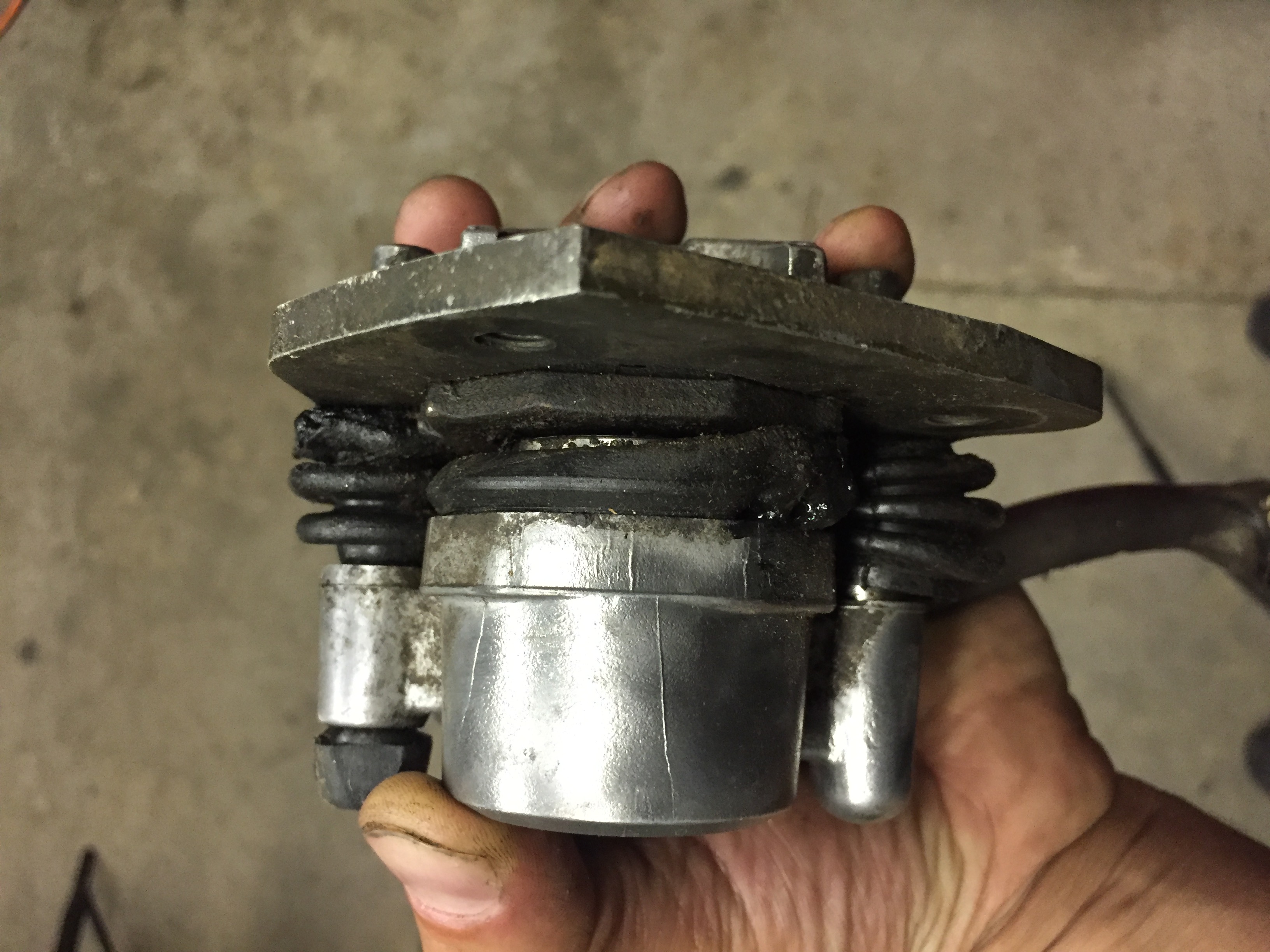

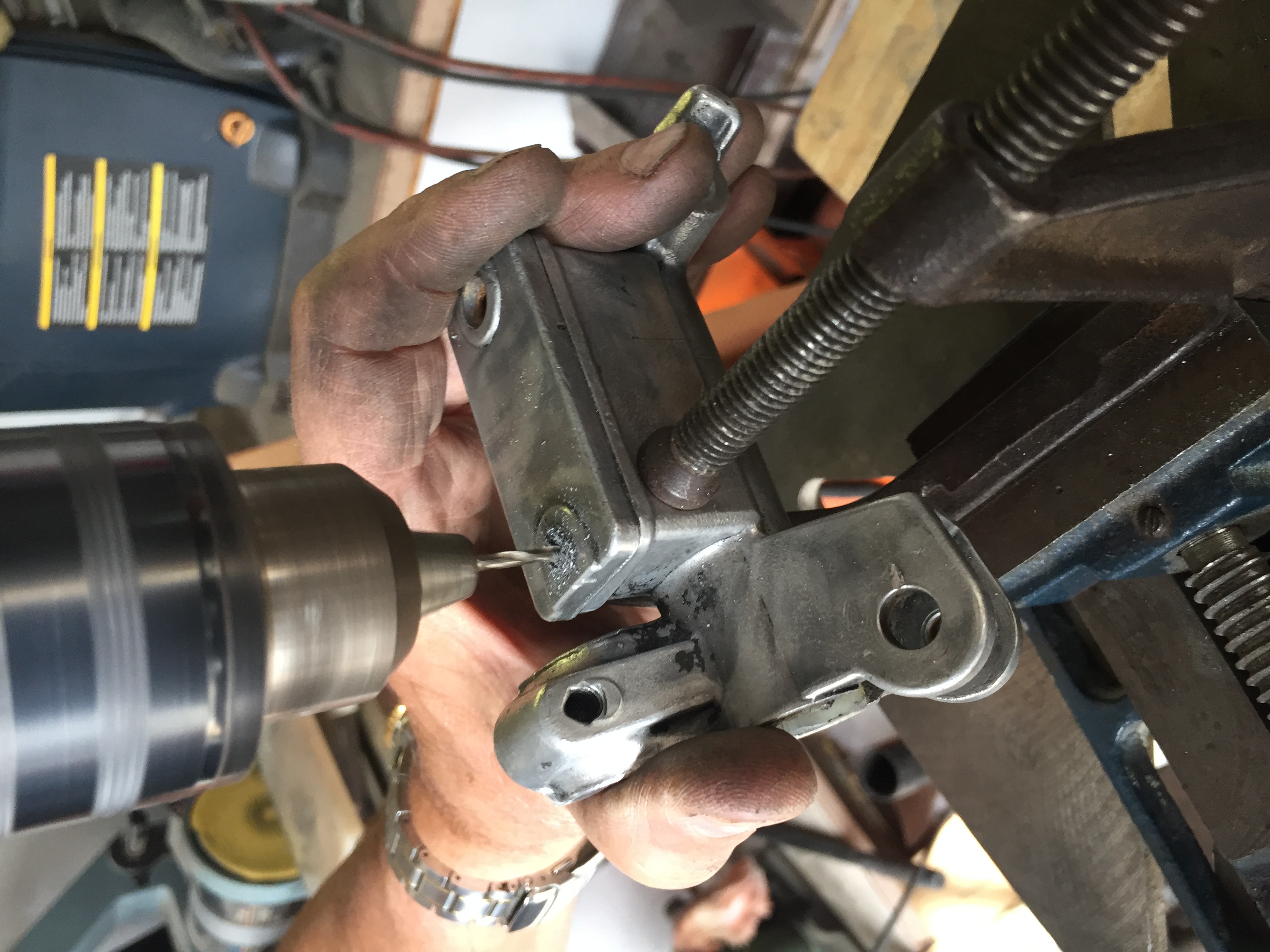

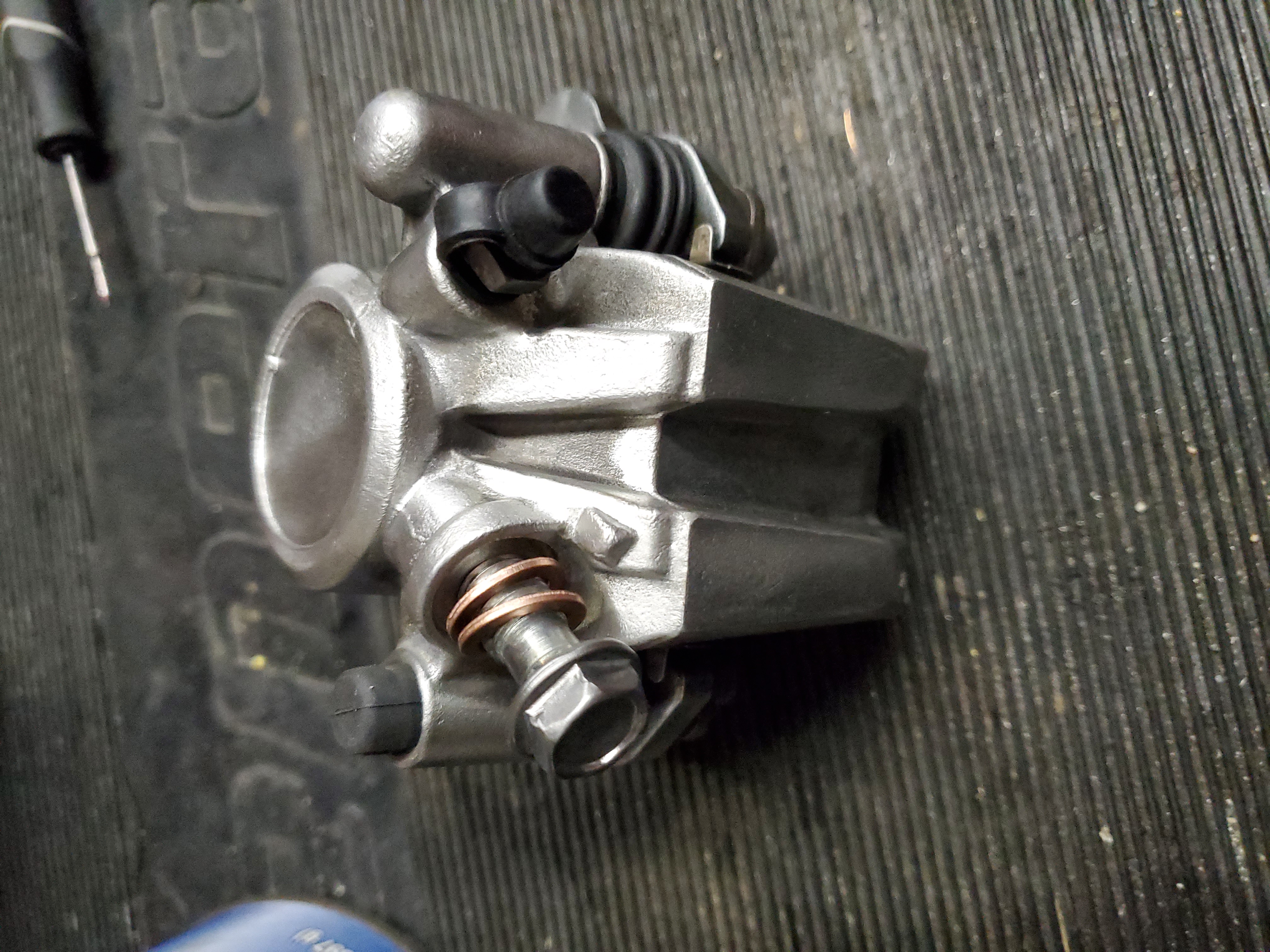

One of the gremlins I had to deal with were stripped screws on the front disc break lever assembly. Man it was a huge pain in the ass removing the screws without ruining the threads. My dad ended up figuring out a decent approach to holding the assembly in a vise without slipping in the drill press.
- IMG-5419.JPG (1.97 MiB) Viewed 8814 times
- IMG-5420.JPG (1.89 MiB) Viewed 8814 times

Nice job! I'm rebuilding an 88 right now too. Didn't come in a box, but might as well have...
I like your fixture for drilling out the master cylinder screws. I was eyeing those last night thinking they might not come out nicely.

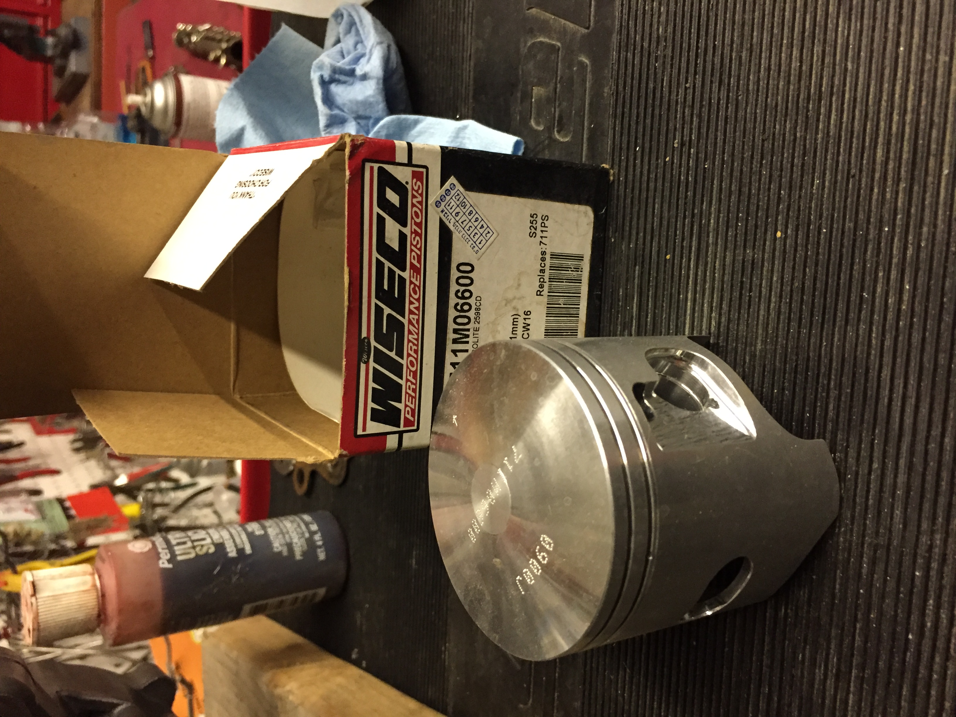

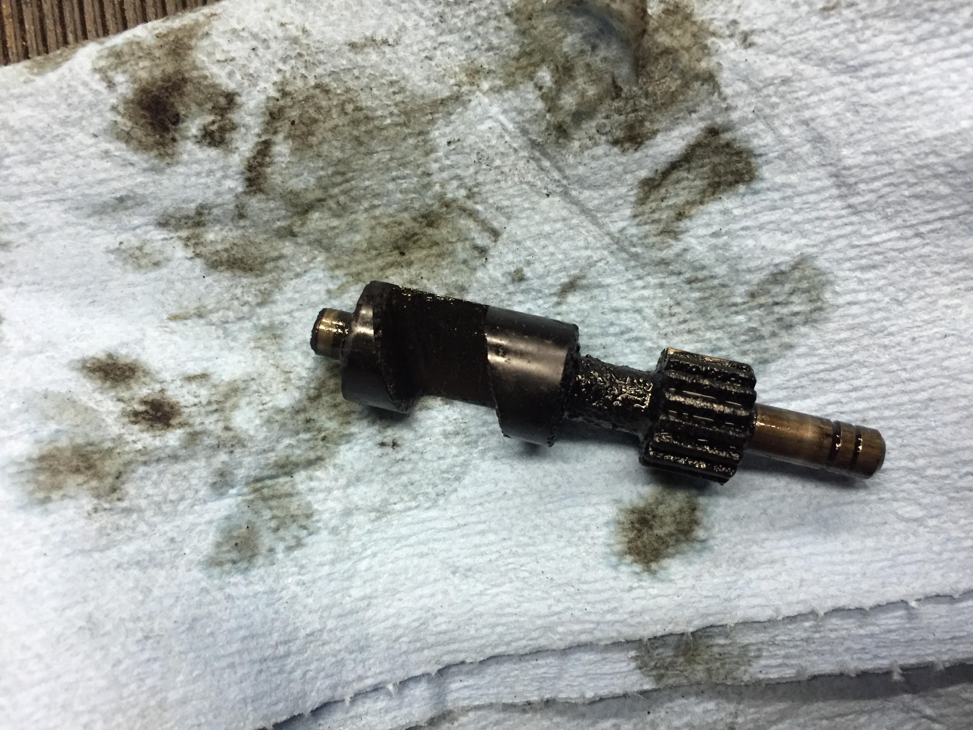

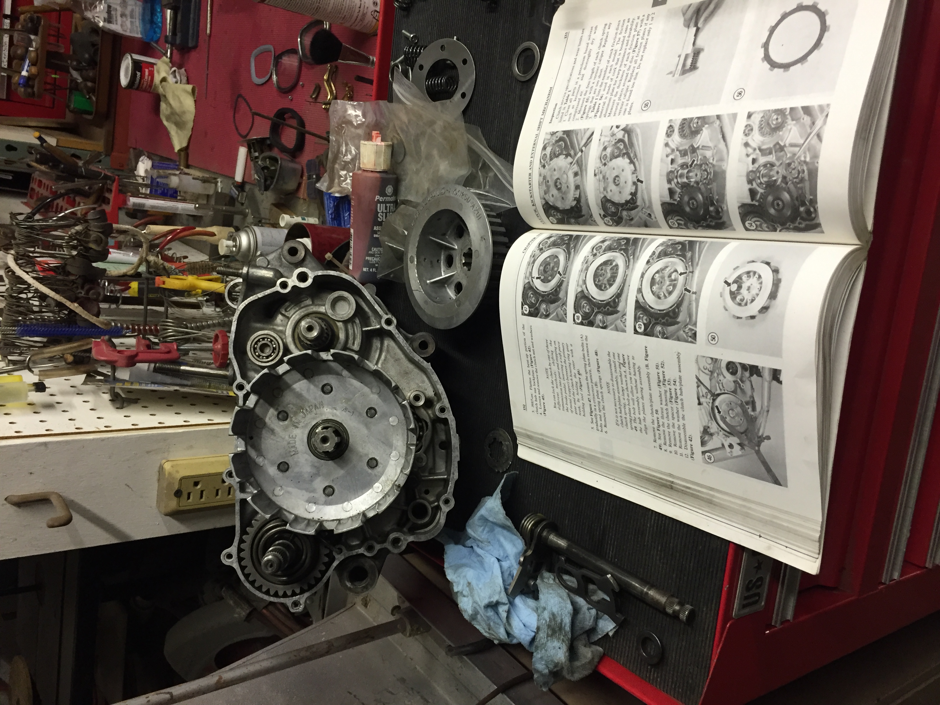

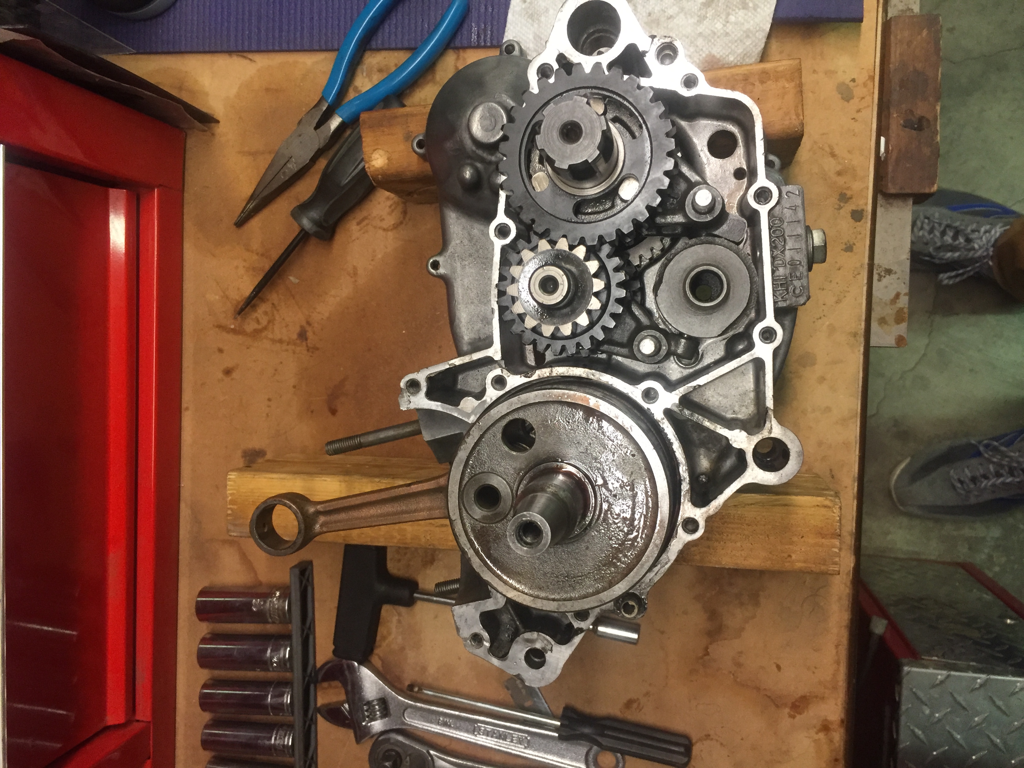

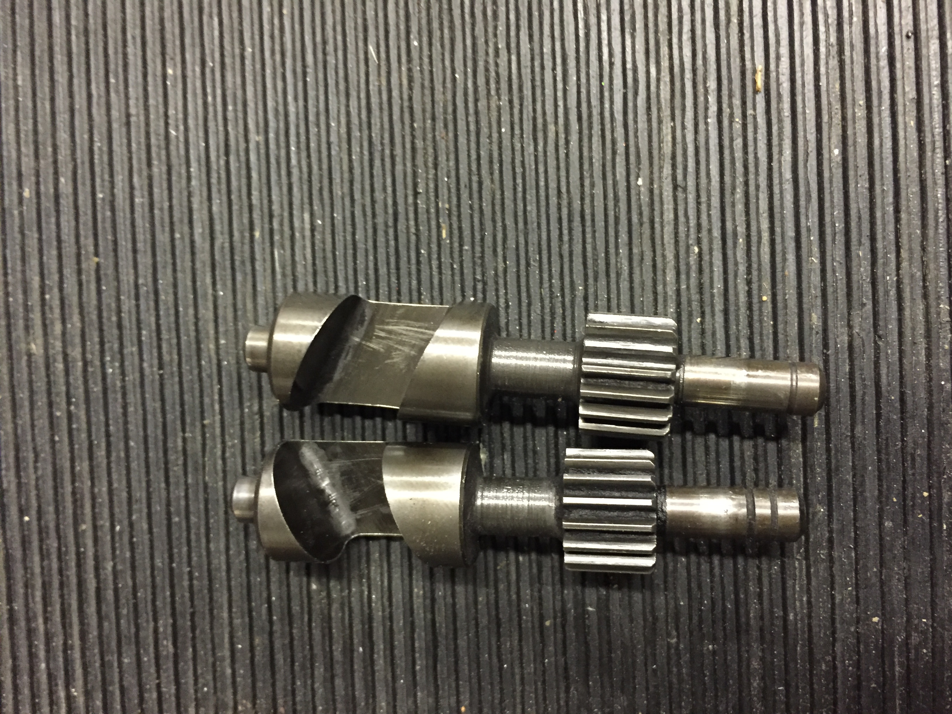

Progress has been a little slow on the KDX build due to waiting on parts on and finding extra time. I've been trying to finish up a Honda CT70 build so I can clear some shop space . I also ended up finding a honda ct110 honey hole and bought 15 of them last week so... the KDX is gonna be a little lonley until I can put back the engine.
The goal is to have the engine back together before the end of the month (pics to come) or at least have all the hardware put together. I'll tackle the paint job once all the parts are back on the bike.
I was a little concerned about how stiff my crankshaft felt after I put the cases back together so I went to my local mechanic and had a second opinion. He said it didn't feel "factory" spec and that I could split the cases and see what is wrong, or it could be a lack of lube when I was assembling and that it could loosen up a bit once there is oil in the case. He said that it will run and probably be fine, but there is a chance that the issue could shorten the life of the motor over time. I'll probably give it a shot and see how the bike runs and if it is a noticeable issue then I'll get back to disassembling the thing. Considering I put all new bearing and seals I'm kind of scratching my head on what the issue could be

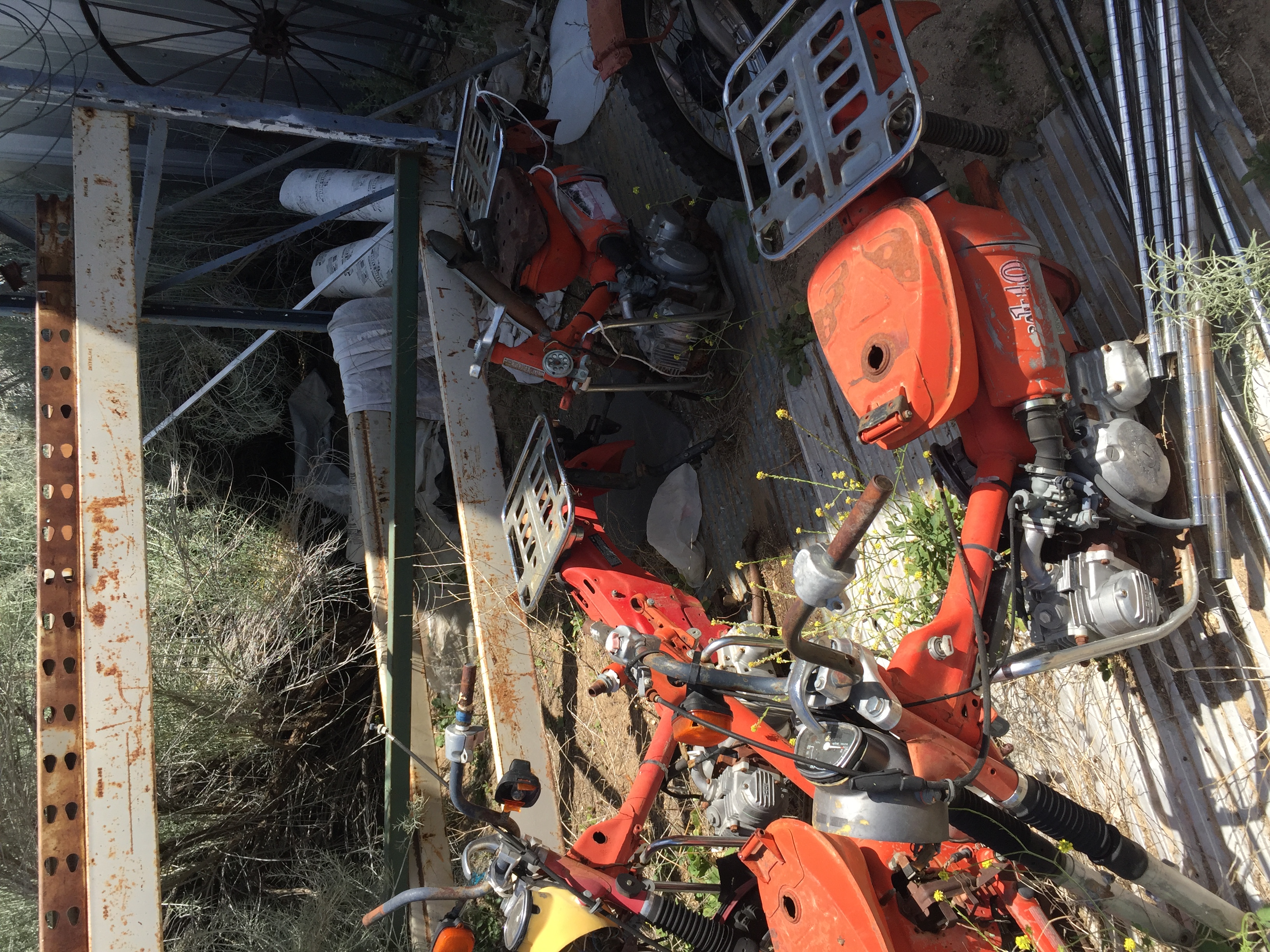

Re: 1988 KDX200 build thread : The gift that keeps on giving (me headaches)
MAN! That guy (now you) had a ton of the same bikes!
Congrats from a lime green hoarder!

Everything with the crank seems to be within factory (Clymer Manual ) spec and I'll double check the centering of the crank within the cylinder. My only guess for the issue is that the bearing might be at fault . When I placed the new bearing in the casing and installed it the bearing seemed to turn only with a considerable level of force compared to the other bearings. I was told that this was standard and wouldn't be an issue.
We shall see....
I'm going to put some time on assembly this week and update with actual build threads instead of pics of other bikes haha
We shall see....

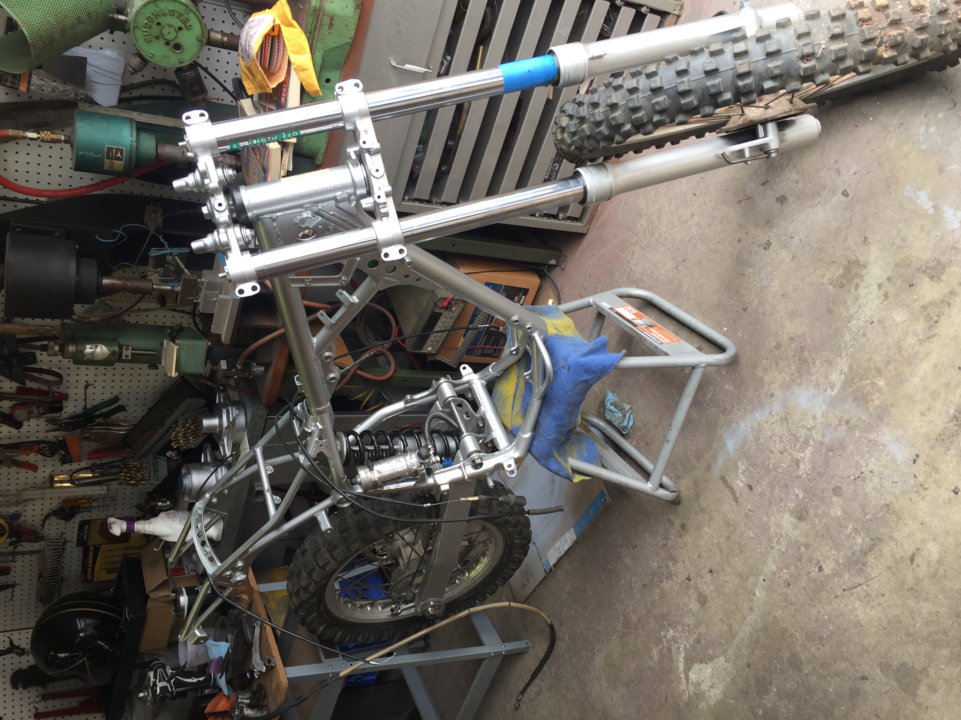

Progress has been a bit slow lately on the bike but I have gradually been putting back the engine together and getting parts delivered. Upgraded the piston to a standard diameter Wiseco and decided to put in a new ECB clutch plate set . The front brake caliper boots look shot so I ordered a kit from powerhouse sports . I bought a new rim from ebay and am ordering new tires . Once I get the new tires I'll have the rims and engine bead blasted . I might paint the engine but I kind of like the idea of a raw looking engine and might just throw engine clear over the aluminum.
One of the questions I have is about upgrading the magneto & wiring to handle a better headlight down the line. Is there any particular thread on here that goes into the pro / cons of this process ?
Hopefully I'll have the engine completely assembled by the end of the week and start putting things back on the bike !
Painting plastics will be the last thing I do on the bike. I'm going to give the rattle can process a shot and see how that pans out. Worst case scenario is I'll redo it , but I plan on going with a SEM plastic paint kit and try and do it right the first go around

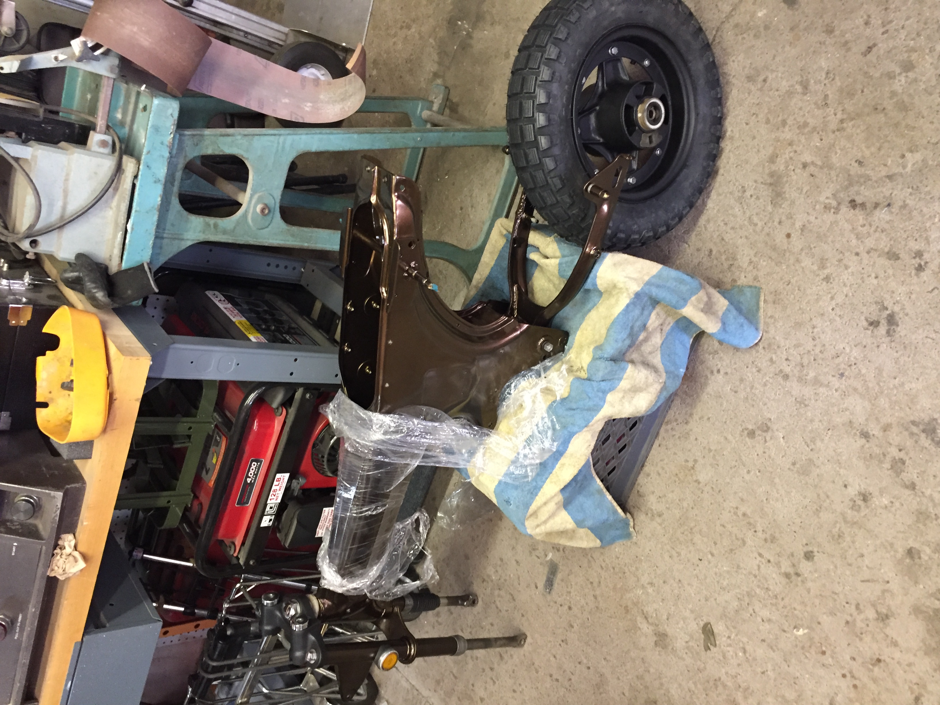

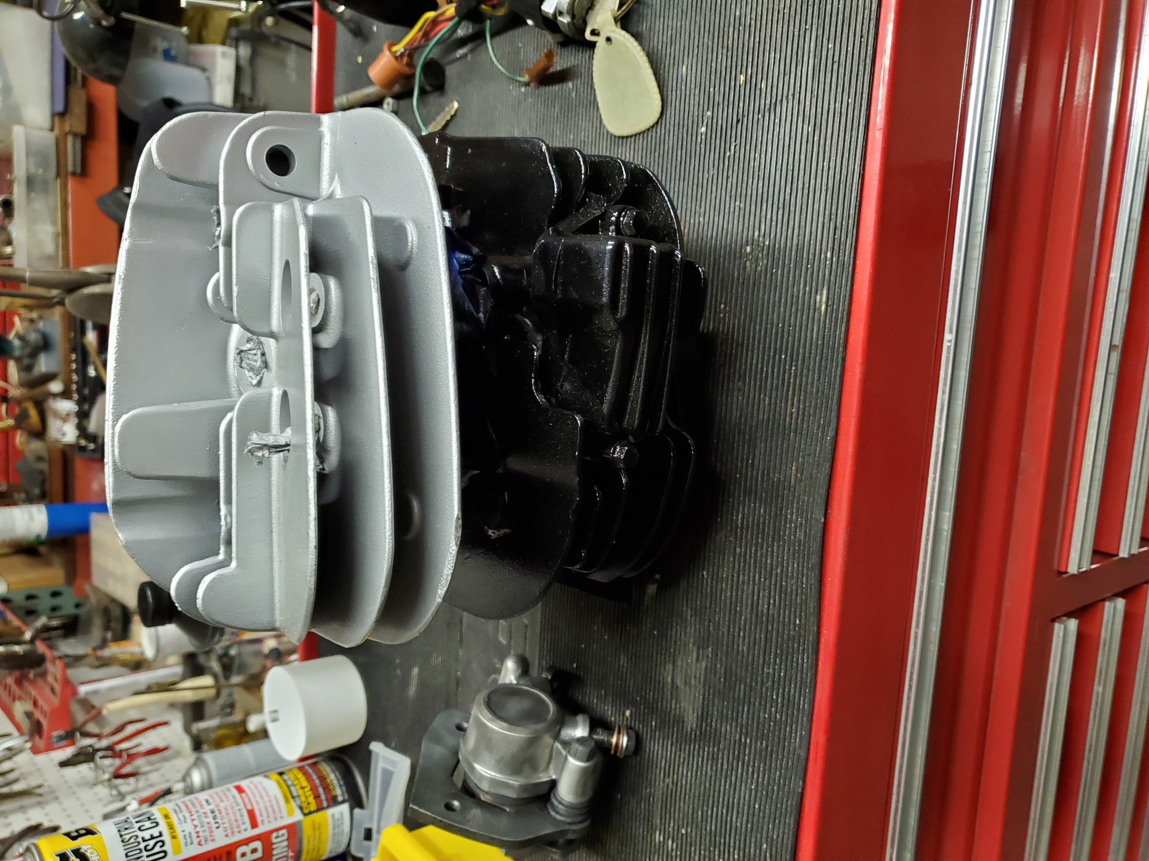

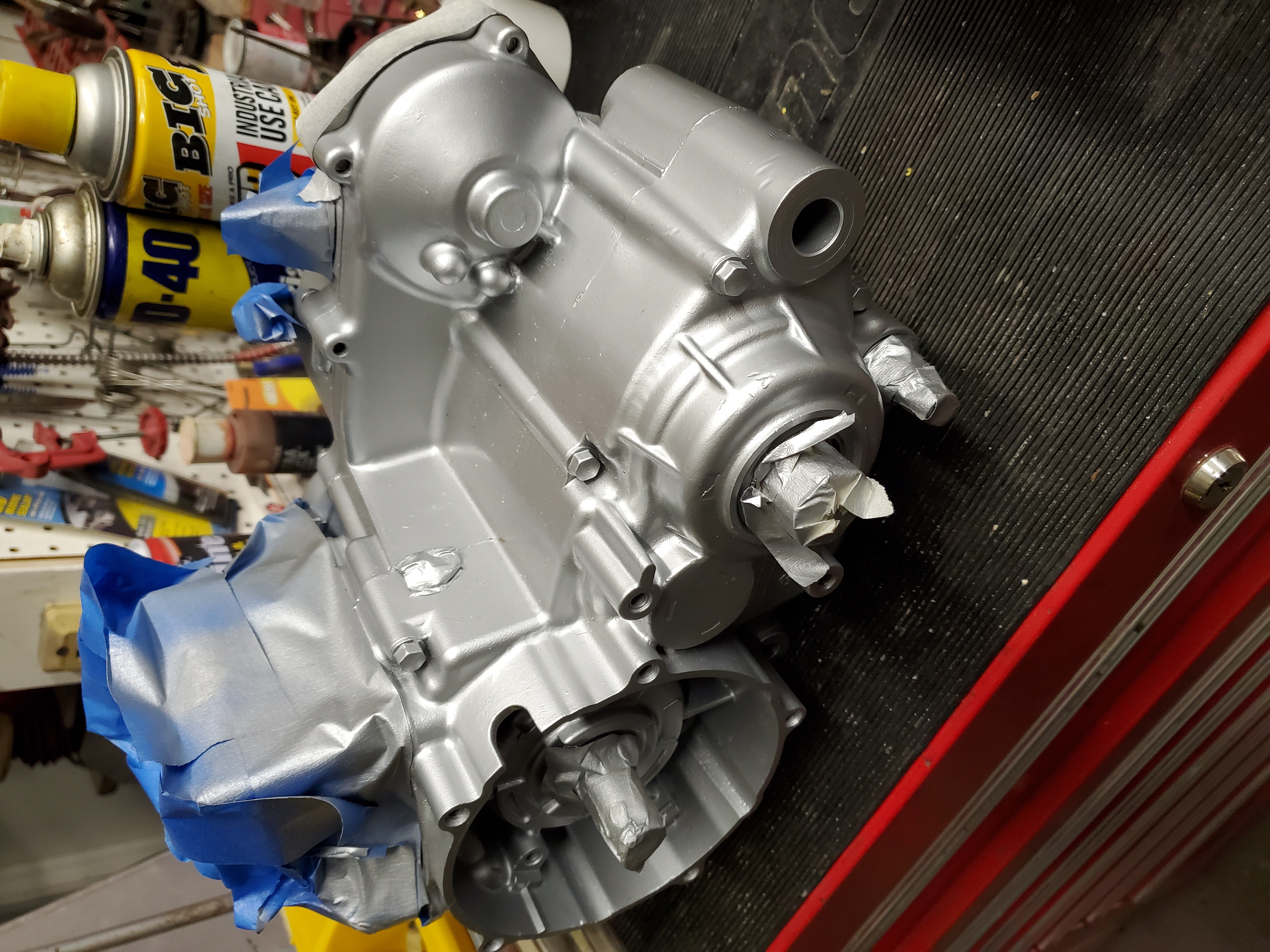

Managed to get a little bit of progress done on the KDX . I had painted the the engine case and upper portion back in July and then got tied up with other stuff. I bought a decent front caliper rebuild kit off ebay (expensive at $25 but it fit decent and seemingly has nice components). So I stripped down the brake calipers and threw it in an ultrasonic cleaner and then put it under the wire brush . Seems it came out ok. I'm going to try and reassemble the engine and put it on the frame this weekend and might attempt to re spoke my rims .... Havent decided how much torture I want to endure in one weekend.
I was also just thinking of having the rims sandblasted and being done with it for now... but with this much time and money already into this bike is it really going to make much of a difference .
Any suggestions on spoke kits for the bike? I've read up on different options on the forum and was just wondering if there are kits out there under $70 ?

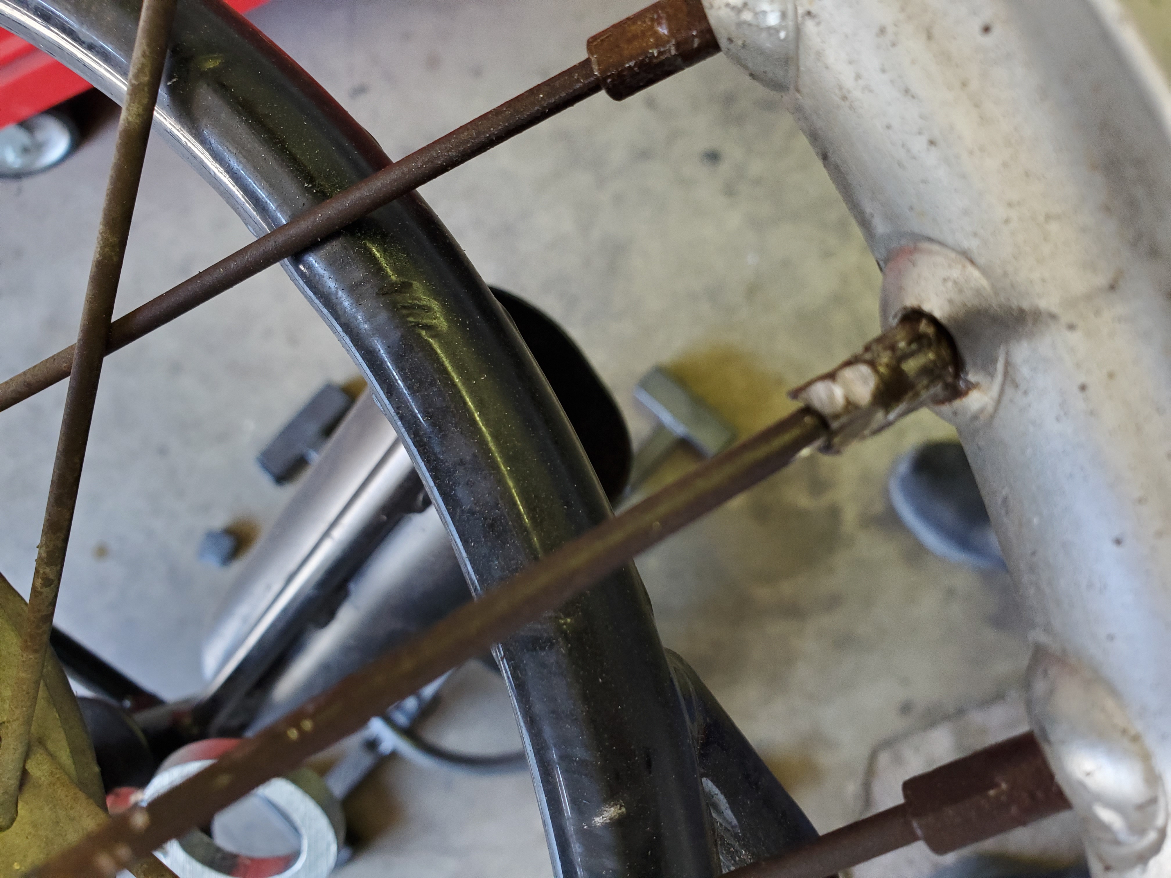

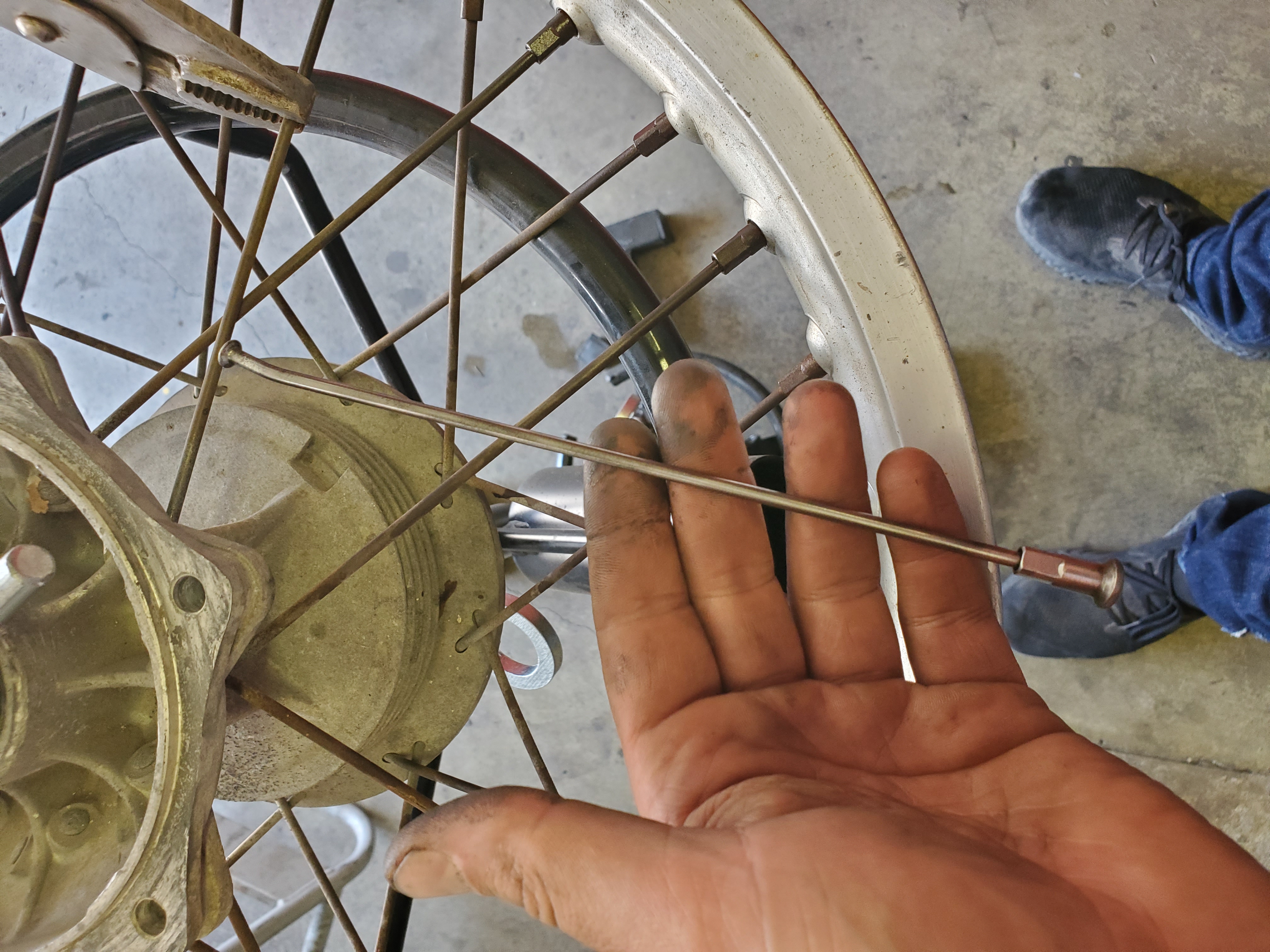

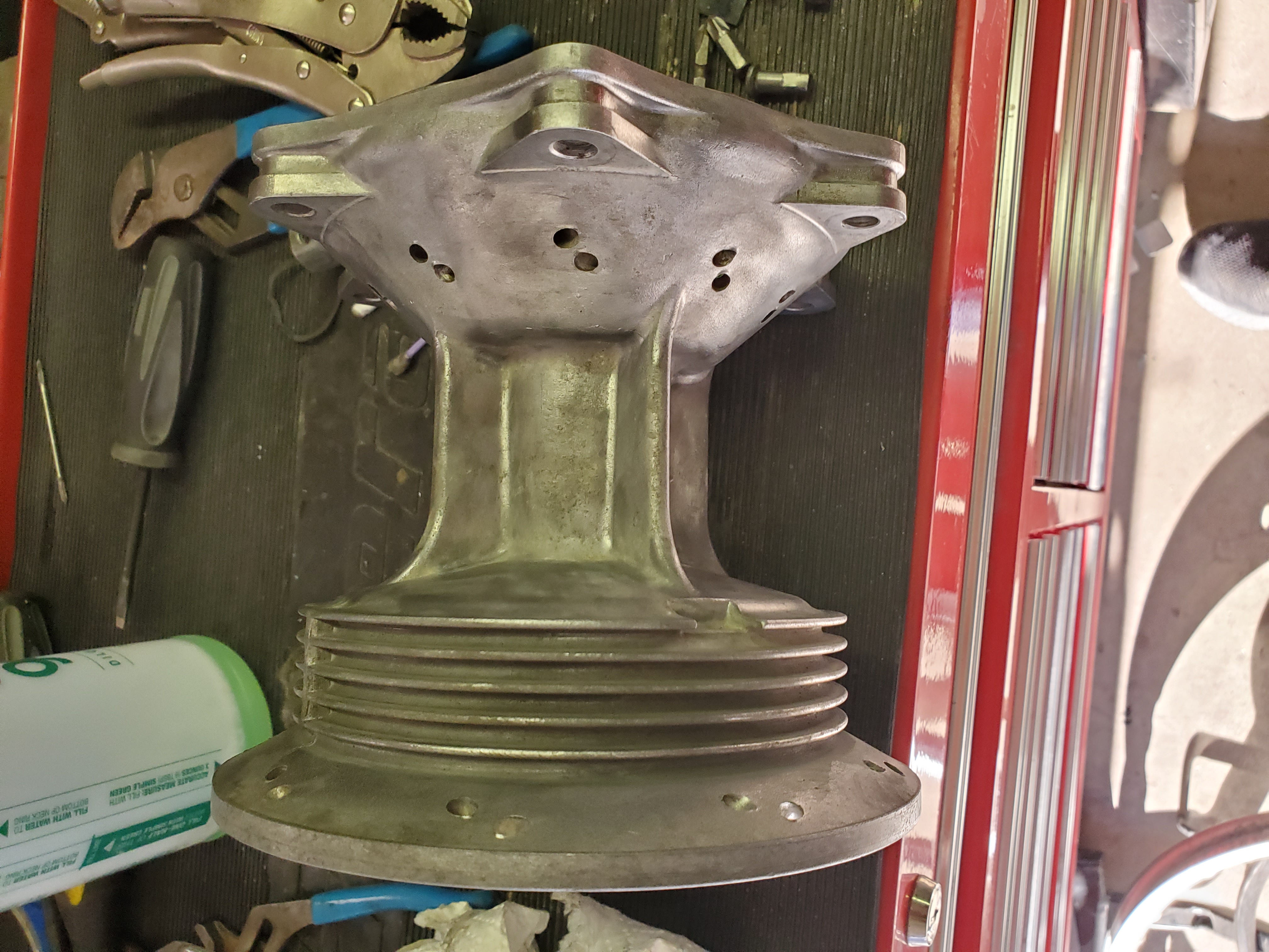

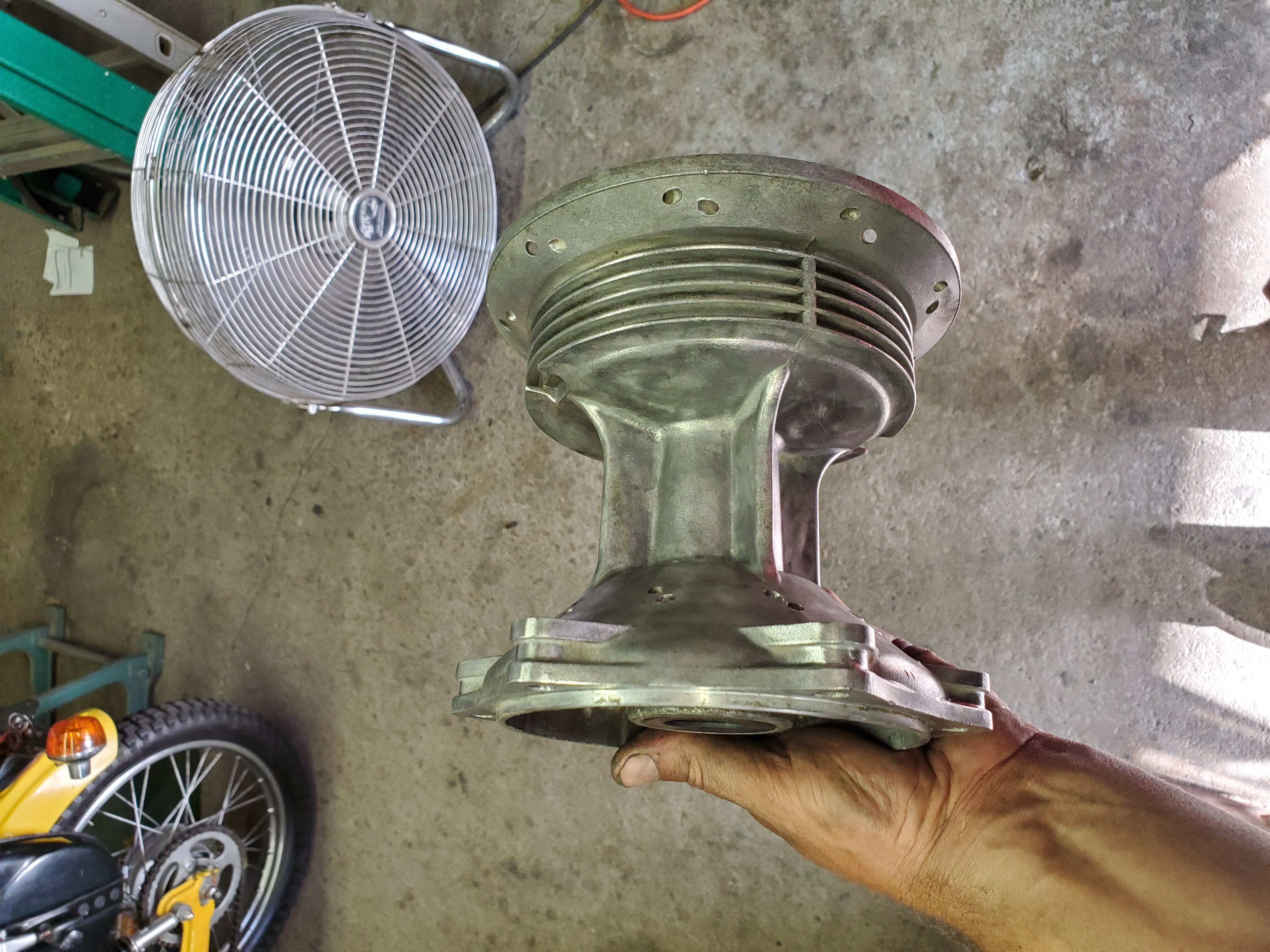

Well the spokes and rims were much further gone than a soap and scrub solution could fix. I ended up seeing which spokes I could salvage and how many I would need to order and replace. Turns out it was an absolute huge pain in the ass. Easiest way would be to order a new complete set and just saw the old ones off and start fresh.
I wired wheeled what I could and will end up ordering more spokes. The rear hub will get some love and I'm debating doing rattle can job or maybe seeing what powdercoat coloring I can do with the hub. Considering a black hub.
Luckily for me the front wheel I bought off ebay is in better condition and cleaning that rim and spokes should be a little less of a headache
Soda blast the hub.
Buy replacement OEM spokes and nipples as needed.
