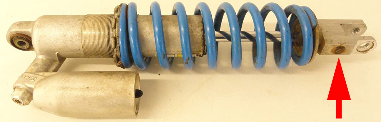

My 94 rear shock has one "clicker" that I can find anyway.....
At the top side of the resevoir.....
Is this compression or rebound? I guess this model only has one and not the other or am I just not seeing the other one?
Thanks
1994 kdx200, 1981 yz465, 1981 xt500, 1975 kx400, 1972 F9 350, 1972 S2 350, 1995 MZ skorpion, 1987 kd80, Baja mini
Posts: 6057
Re: rear shock clicker on 94
The clicker at the reservoir is compression. The rebound clicker is located on the lower clevis.
kdx shock.jpg (160.25 KiB) Viewed 1883 times
Post by 2stroke1971 »
awesome!!!!! Thanks!
