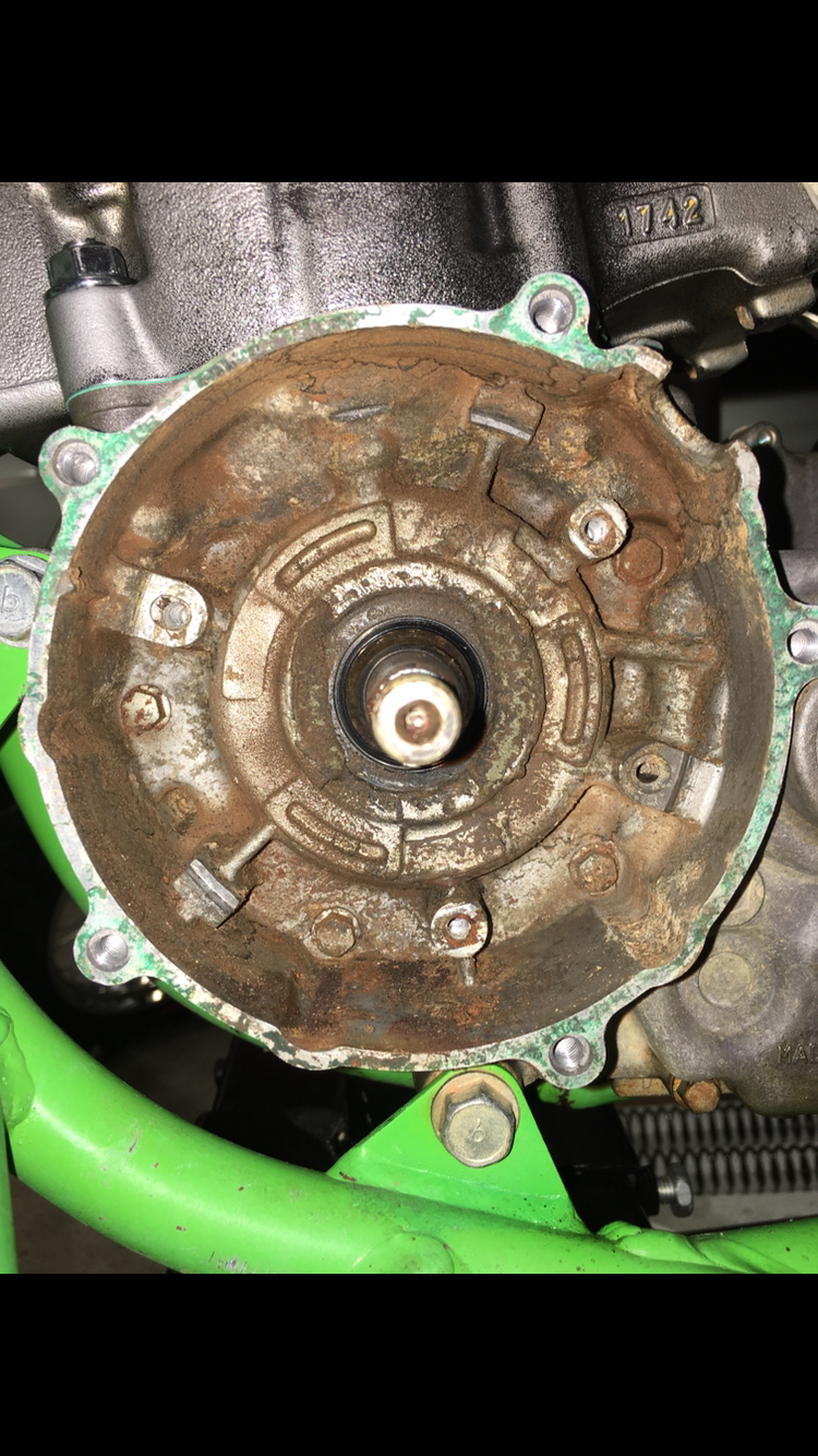

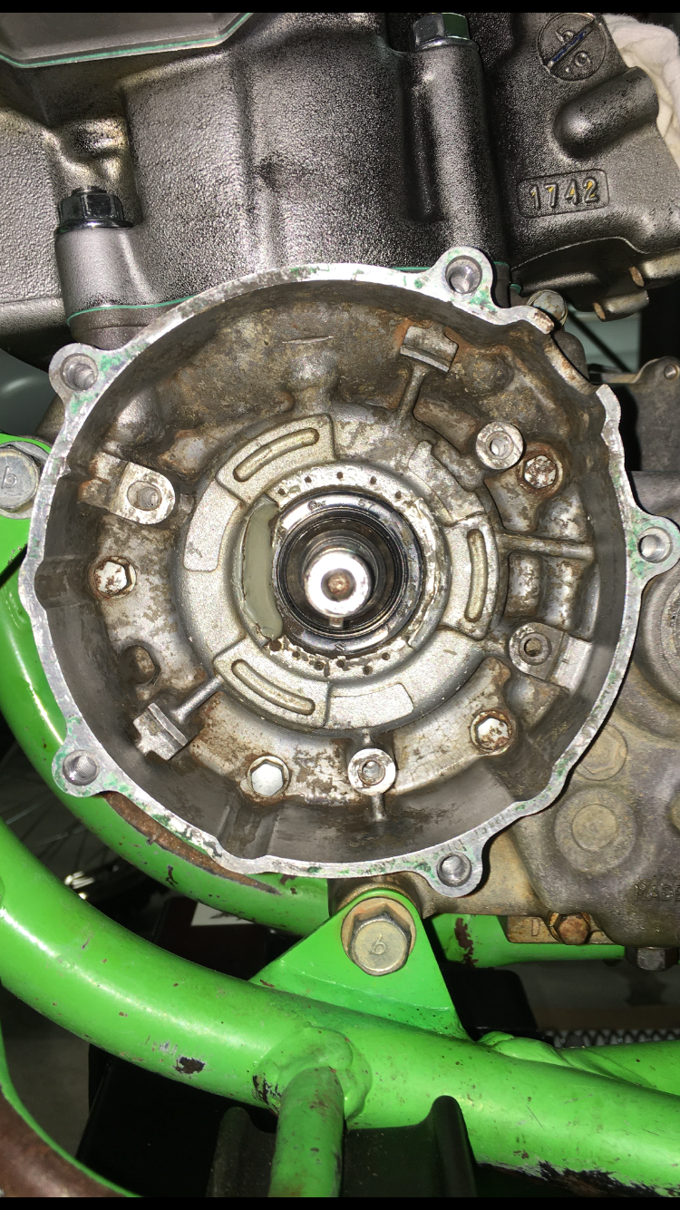

First of all, hello. I'm new to the site. I picked up a 2001 KDX200 about two months ago. I've been going through the bike as it was fairly neglected in the past. At any rate, when I removed the flywheel and stator, I noticed a hard almost gasket type material to the left and right sides of the shaft. I didn't notice it initially as it was so dirty inside; only after I had cleaned it. Does anyone know if it came like this from the factory? If so, what's the purpose? If not, why would someone have put it there? While cleaning the area out, the right side practically fell off; so I took it off. Just looking, these do not appear to be providing any purpose. The shaft and seal seem fine, but it is bugging me before I put it back together. The bike was running fine with no noticeable problems before I started working on it. See links to pics below. Thanks for any help you can provide.

Welcome to kdxrider.net. I regret to inform you that someone has removed the seal retaining portion of the left crankcase half. Someone chose to not do the job properly with the correct tools. That seal is designed to be retained by the design of the crankcase half. See the picture below from an eBay seller. The crankcase halves are supposed to be split, then the seal removed from behind. I assume the dots on there are punch marks to intend to push the metal in to help keep the seal from becoming loose. Hopefully, the caulk glob was not to seal a leak, if they ground away too much aluminum alloy.

Wow. Never good when someone starts off with "I regret to inform you...". I really do appreciate your explanation and the picture so now I see what it 'should' look like, bad news as it is for me. Given what I have here, what do you suggest that I do (if anything)?

You might want to clean it up and inspect it. The globs used may be J-B Weld. I would do one of the following:
1. clean it up, rough it up, reapply J-B Weld, ride it and hope for the best.
2. disassemble, buy a pair of used crankcase halves, new bearings, seals, bushings, etc.
Either way, please let the next owner know the situation. For example:
viewtopic.php?f=86&t=23643&p=208035&hilit=leave#p208035

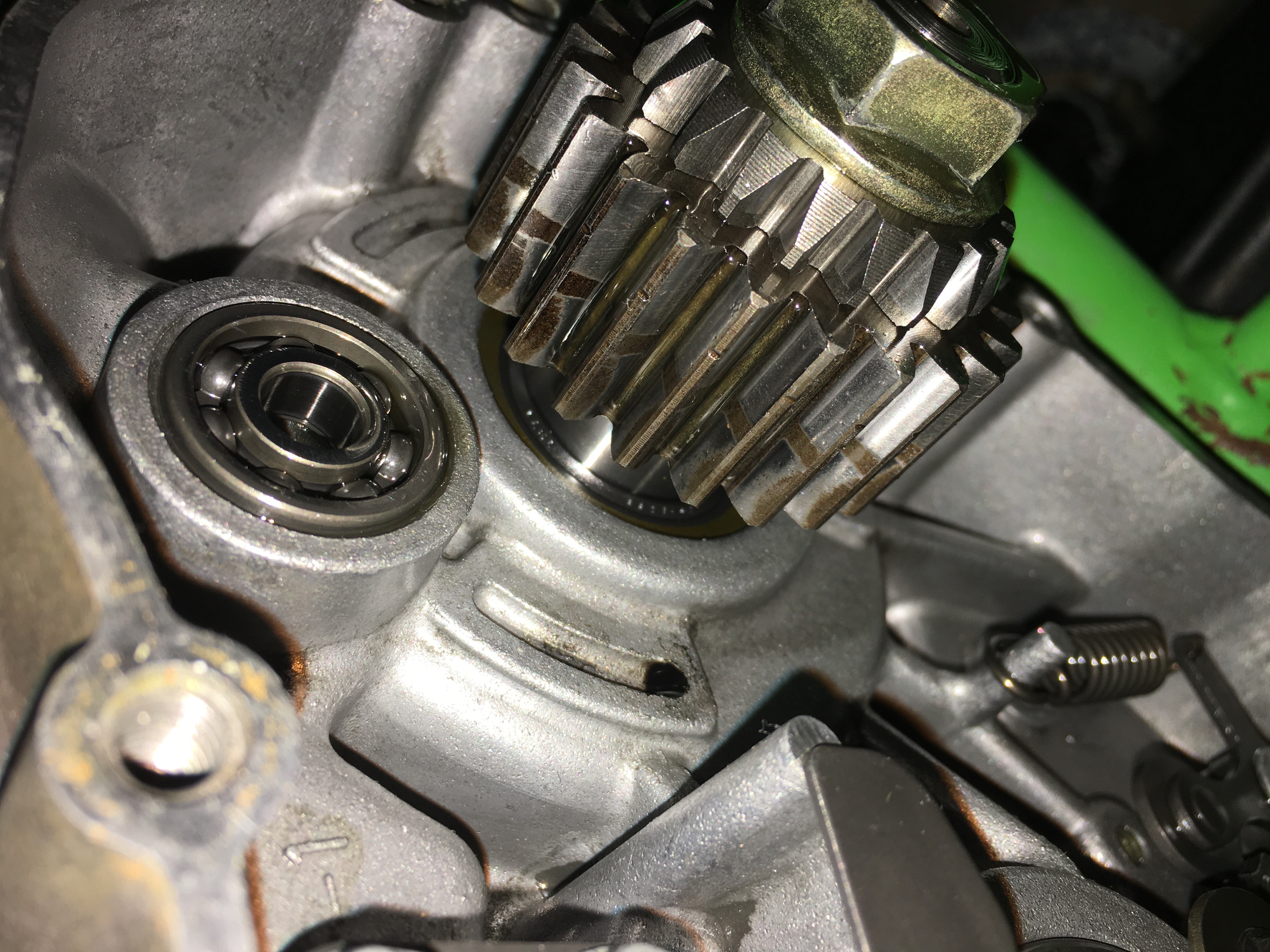

Looks like the clutch side has not been messed with. See pics below.JimmyB wrote: 03:17 pm May 14 2020 Never a good thing finding other peoples handiwork, looks like they used a genuine Suzuki seal too. Did they do the right side like this too?

Re: KDX200 Flywheel Shaft - What is this?
WHEW! Good!

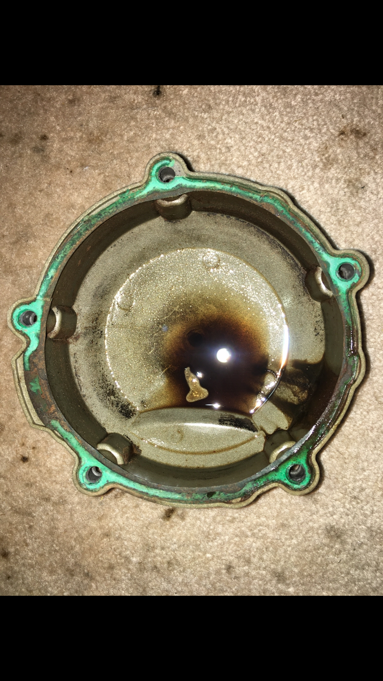

While going back through some pictures I'd taken while working on the bike (I take lots of pictures), I noticed a pic that I didn't remember that shows oil inside the stator cover. I looked at that today and thought, that shouldn't have oil in it. I know this would have been obvious to most if not all of you. It's no excuse but it was more dirty than oily when I took it off and looked. Wasn't focused on the inside of the cover at the time. Go ahead and say it, I'm a (insert whatever you like). At any rate, I wanted to confirm that's the only place this oil could have come from before I go any further. This is a huge setback for me as I now have put everything back together and now I'm looking at taking the whole motor apart to replace the left case. That means more time, education, tools, $$$, etc. I felt pretty good about what I'd already done (new piston/rings, disassembled power valve assembly, cleaned, and put back together, new clutch plates, new kickstart assembly, new flywheel (old one was badly corroded).

Oil there comes through the left side crank seal, it needs to be replaced. Good news is you can now pull it without opening the motor...

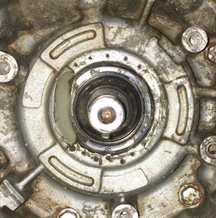

Would be nice to do that, but after chiseling off the 'seal lip holders' or whatever they are called, someone used a punch around the seal; you can see the punch marks in the last pic (I'm assuming to keep the seal in) but in the process they distorted the shape of the hole. So I don't know that I can remove the old seal and replace it in the shape it's in?bufftester wrote: 08:35 pm Jun 29 2020 Oil there comes through the left side crank seal, it needs to be replaced. Good news is you can now pull it without opening the motor...![]()
And that's a Suzuki seal they used (looks to be rubber only), not the OEM with the metal outer portion. Not even sure what it was from so have no idea what I would replace it with.
Yeah, the proper way to fix it would be to find a new set of case halves and move everything over, not cheap or quick tho.
Can I not just replace the left side case? I got to get a set?bufftester wrote: 09:27 pm Jun 29 2020 Yeah, the proper way to fix it would be to find a new set of case halves and move everything over, not cheap or quick tho.
