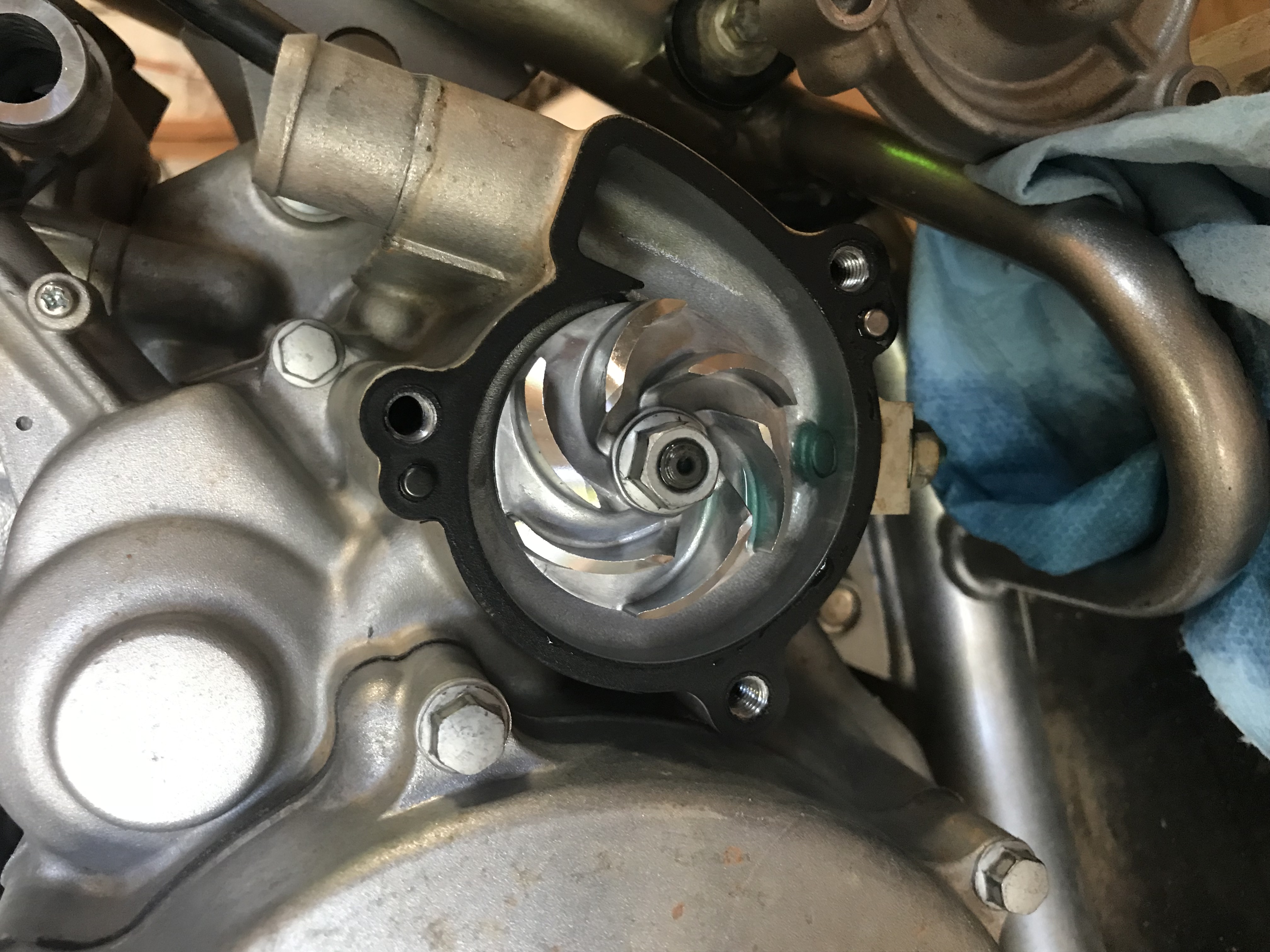

Drained the coolant and oil. All is clean and well. No water intrusion. Found no blockages, signs of corrosion or broken water pump vanes. Everything looked great. Thinking the Rekluse caused the heat problem at this point (no mud riding, sand, etc. as it has just been normal rides) so I swapped back to the OE stock clutch last night. I will tear into the top end hopefully this weekend. The saga continues...

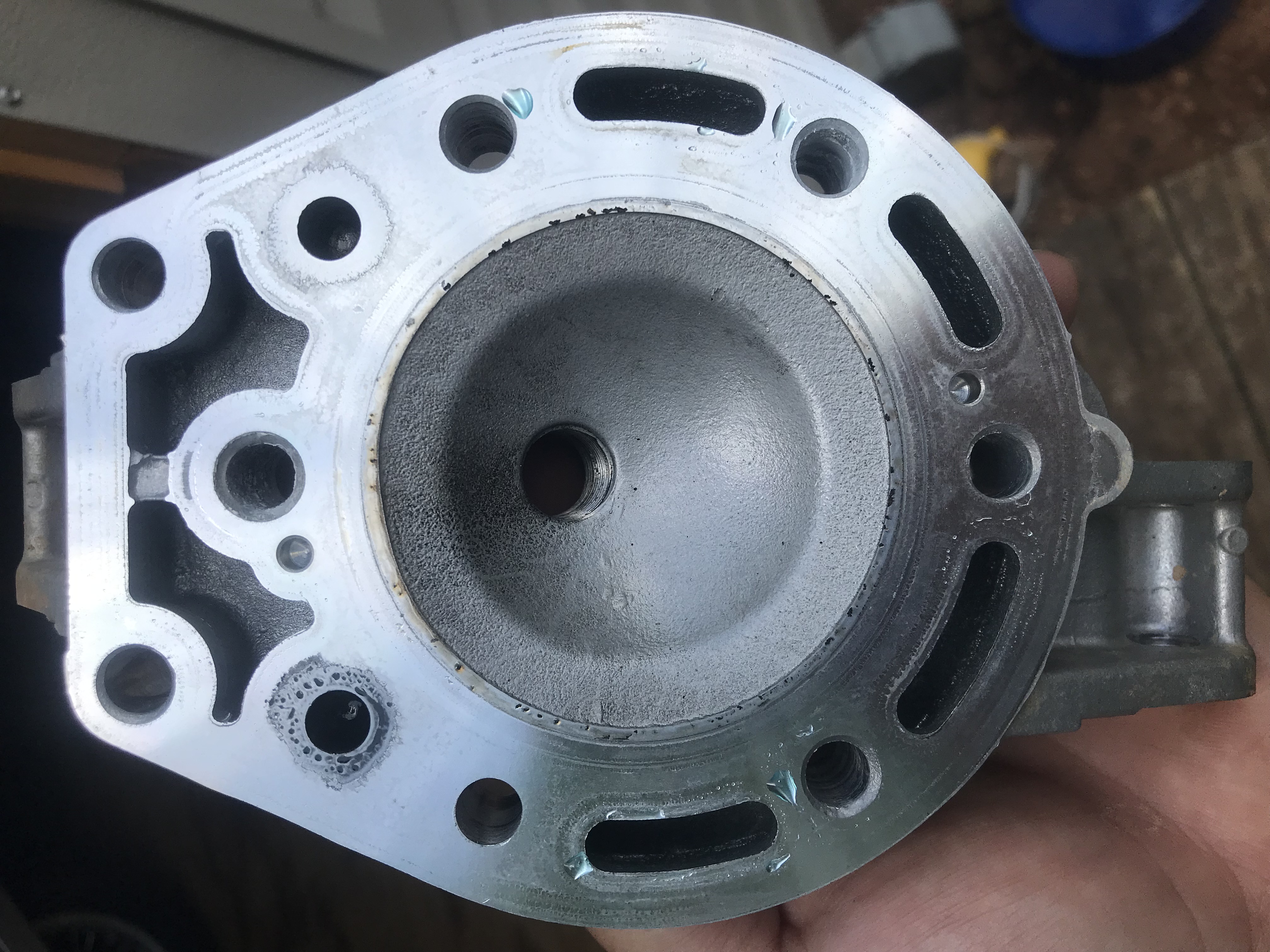

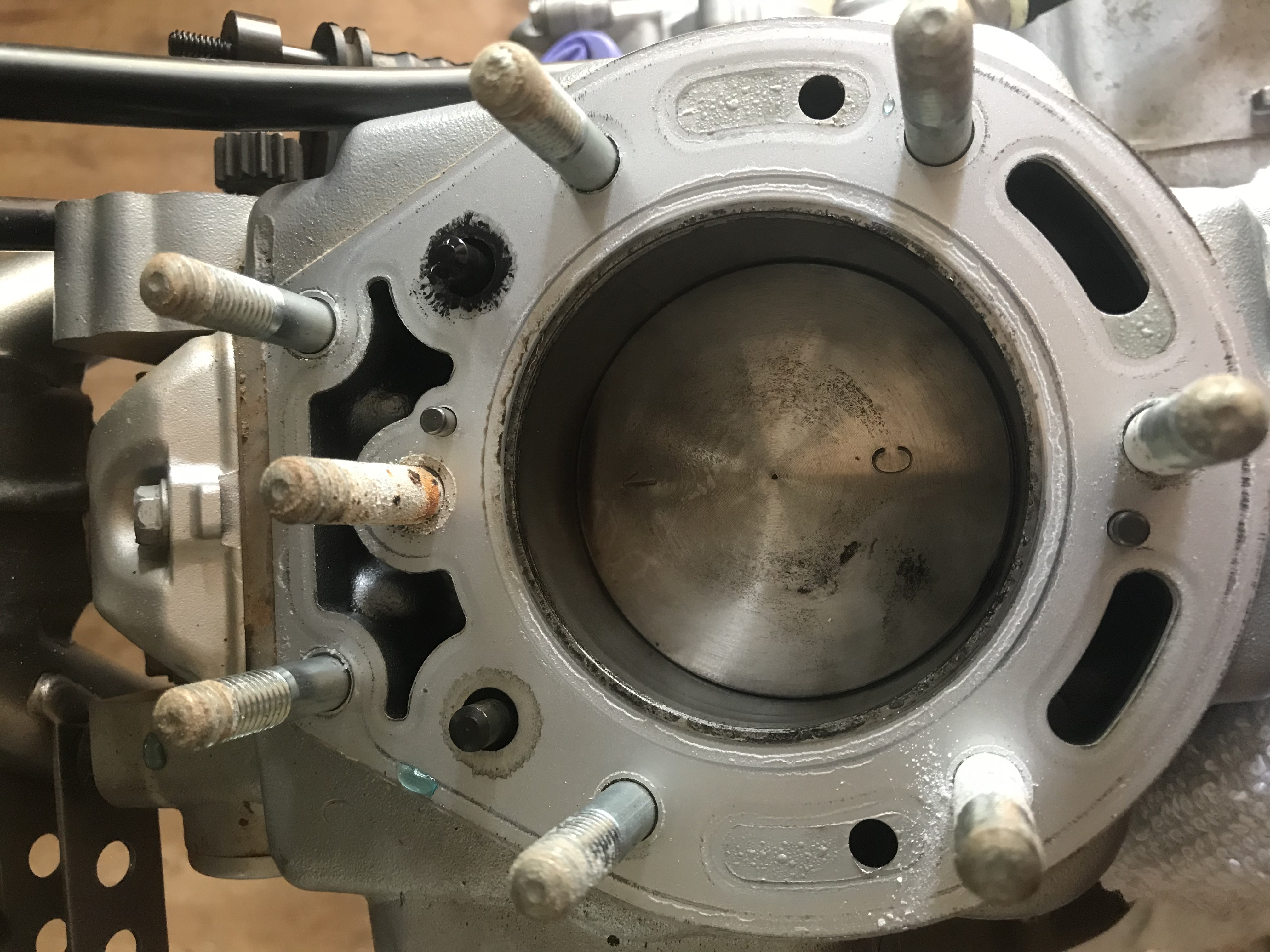

Finally got a little time to do some more work. Got the top end off and found a cylinder with no scratches and a very clean head and piston. In my opinion, they are too clean like they have been steam cleaned by coolant. Didn't find any noticeable gasket issues but I don't really know what I'm looking at there. KIPS was all good but dirty. Going to take the cylinder and piston to a machine shop and see if I can get a good measurement on it all. Here is a couple pics of the head and top of the head gasket at time of removal. What do you'll think from the pics?

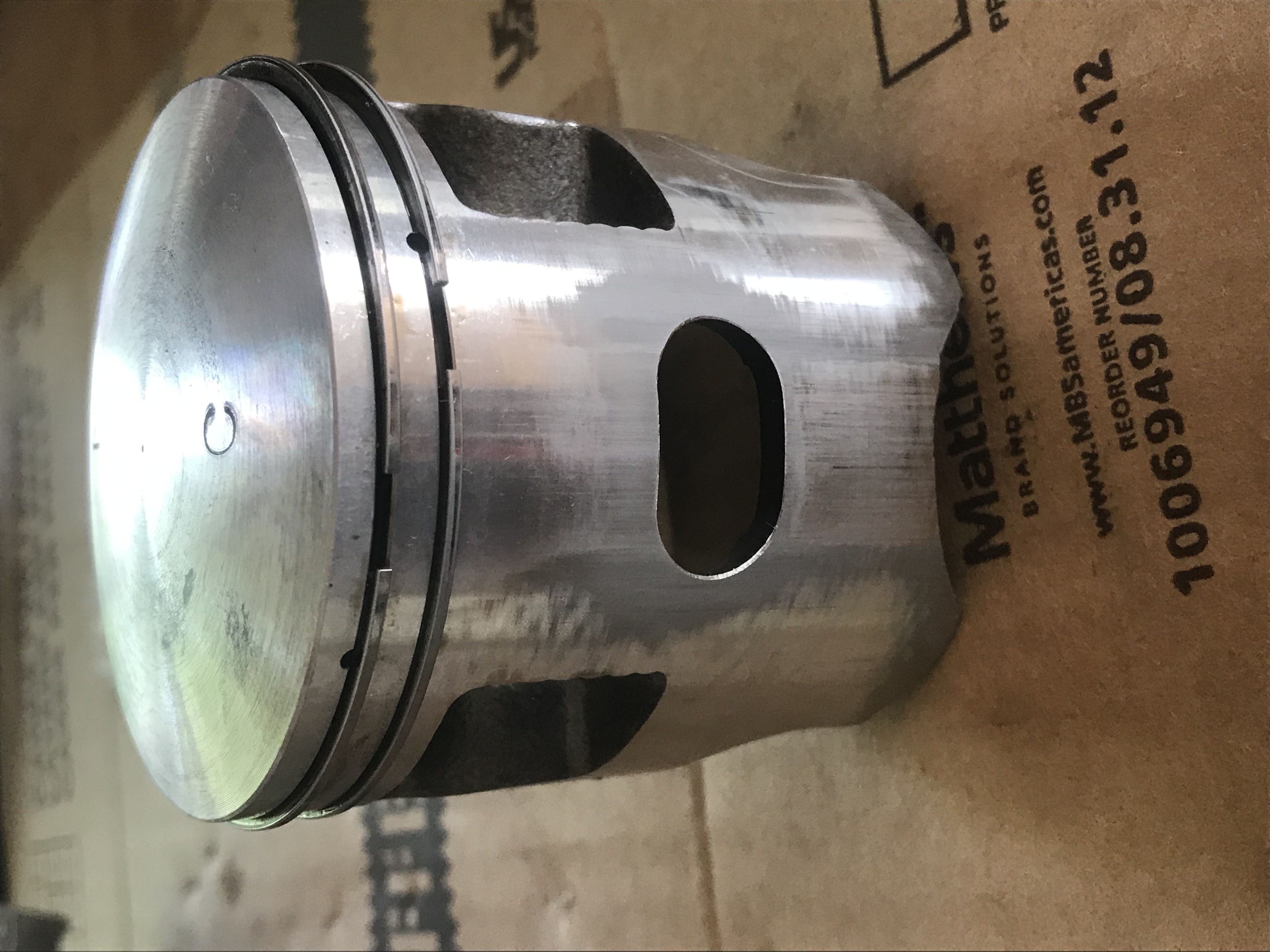

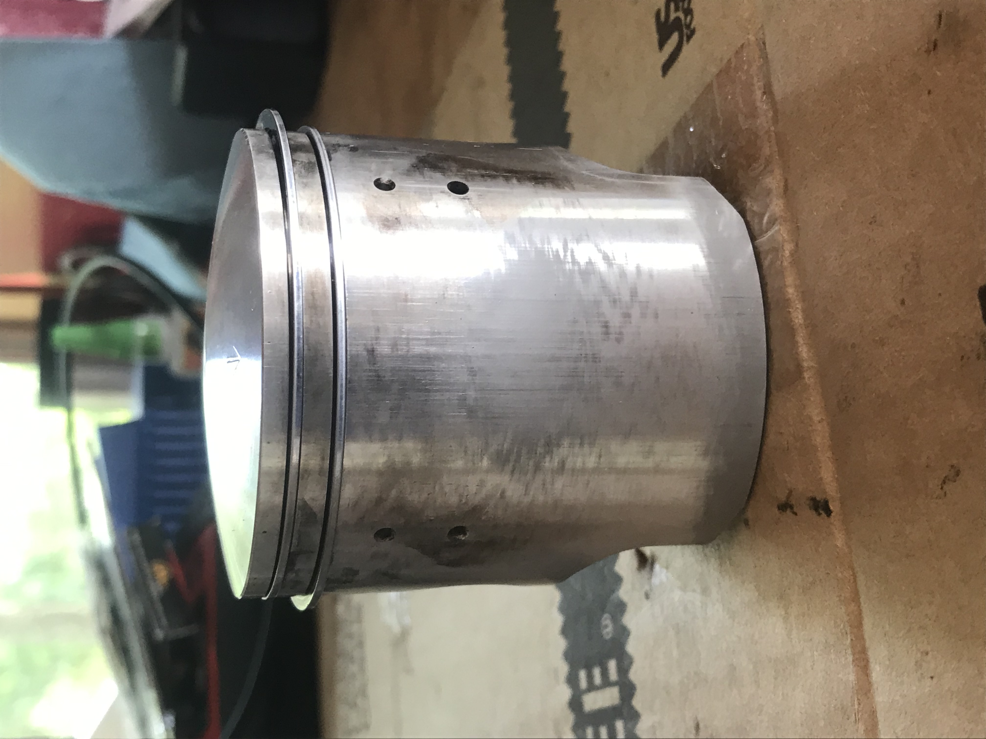

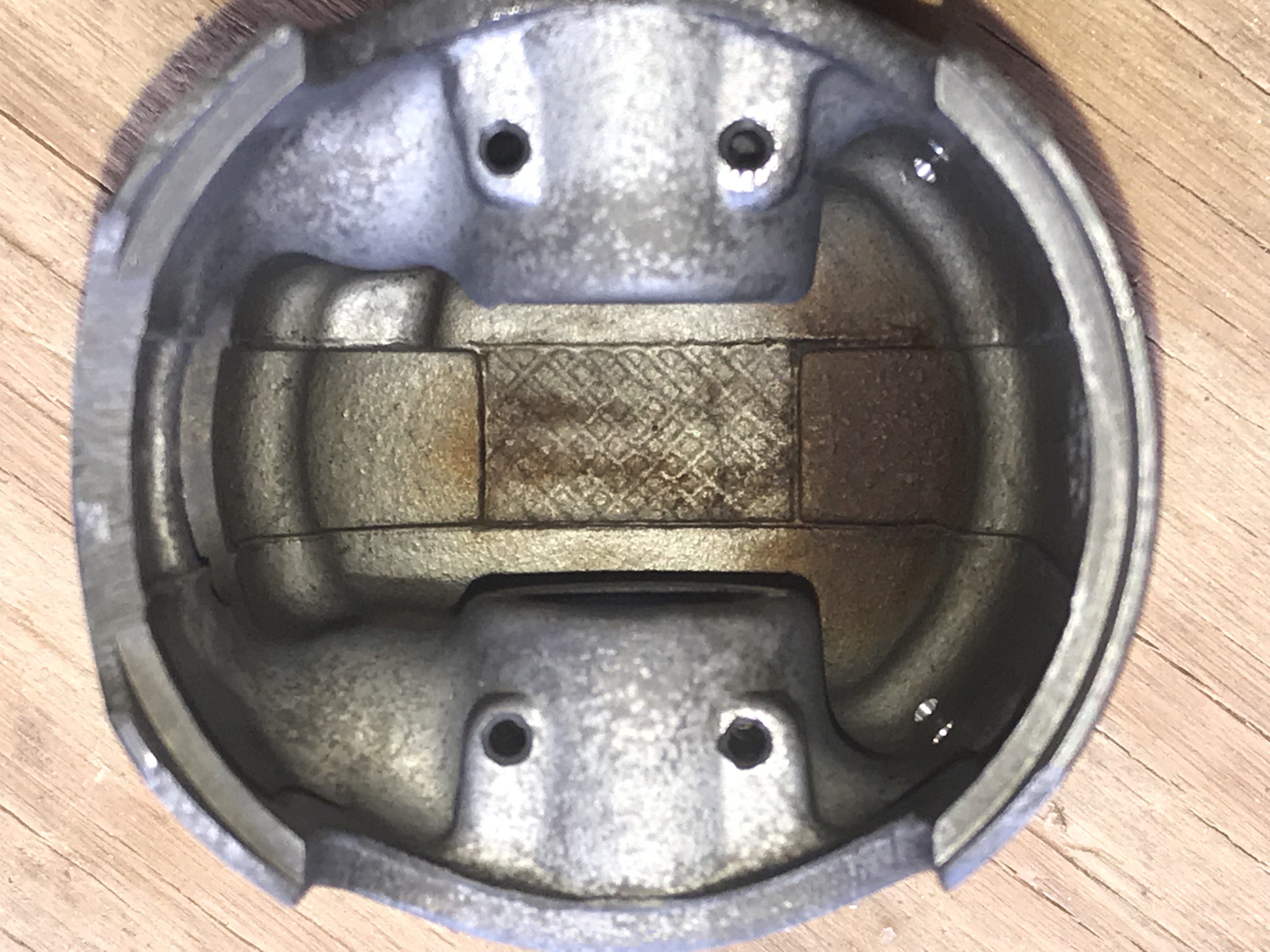

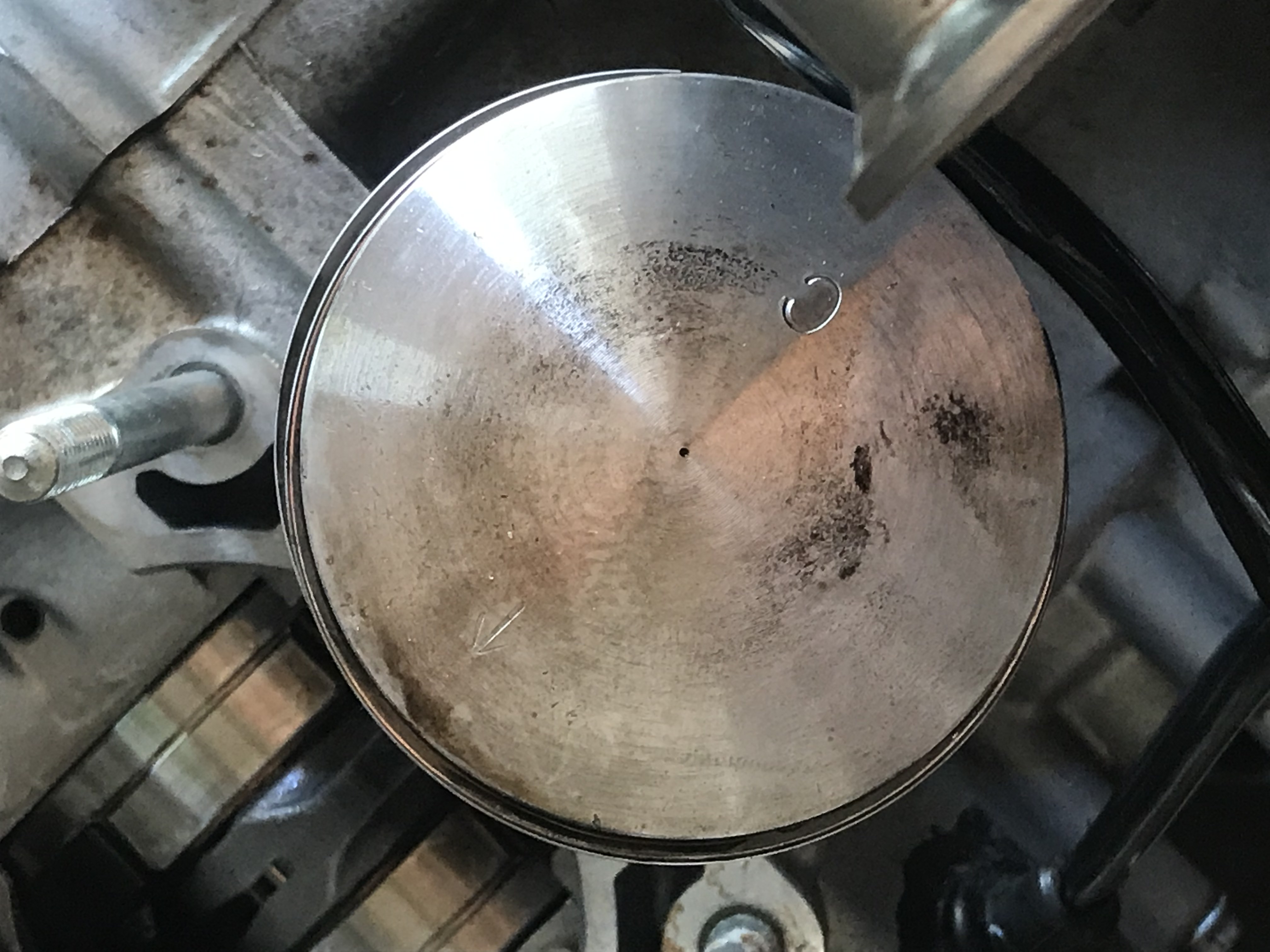

Here's a few pics of the piston. From the bottom pic it doesn't look like the piston was ran too hot or too lean. Ideas?

- Posts: 739
- Location: North Cackalack
Re: Engine Diagnosis Question
The top rim of the cylinder - around 3 o clock looks chipped? Like detonation damage? And I see little pin marks on the edge head, and the dome doesn’t look smooth. Not sure if that roughness is normal. Maybe someone else knows/can tell for sure.
That is actually wet, oily spots. Not any kind of pitting or damage was discovered. It does look suspect in the pics though as those were taken as is before being wiped down.kdxsully wrote: 06:14 pm May 17 2020 The top rim of the cylinder - around 3 o clock looks chipped? Like detonation damage? And I see little pin marks on the edge head, and the dome doesn’t look smooth.

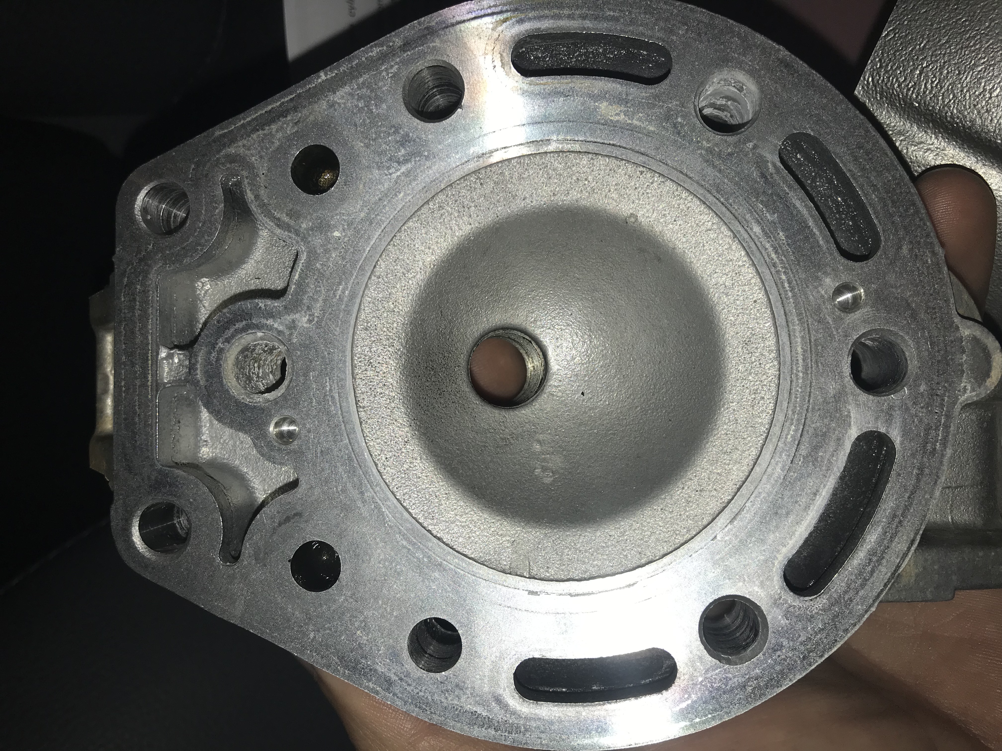

Pic of the head after being wiped clean...
What's the last thing you changed?
"One idea I have is these are the first real rides I've had since getting the Rekluse clutch installed."
Which brand head gasket is that? Why does it have circles instead of slots for the coolant passage in two areas?
I see you have a "C" piston. Do you have a "C" cylinder?
