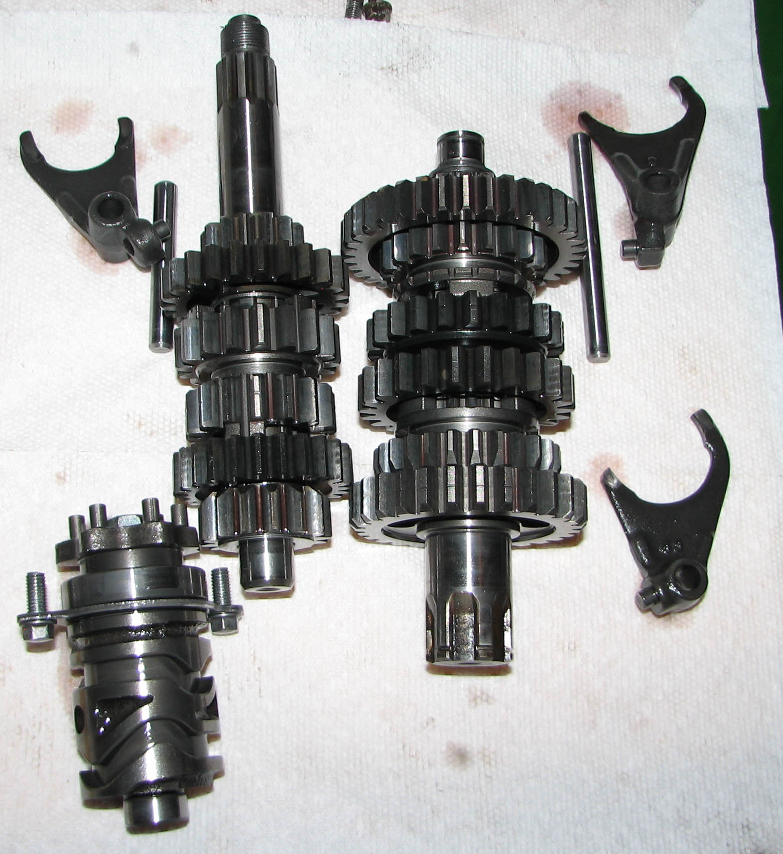

Note the Thrust washer is not installed in the photo above, this was the trashed tranny for a better photo.

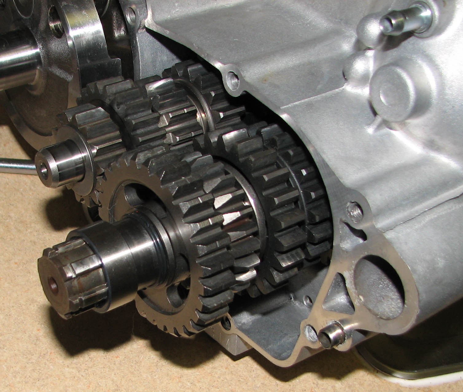

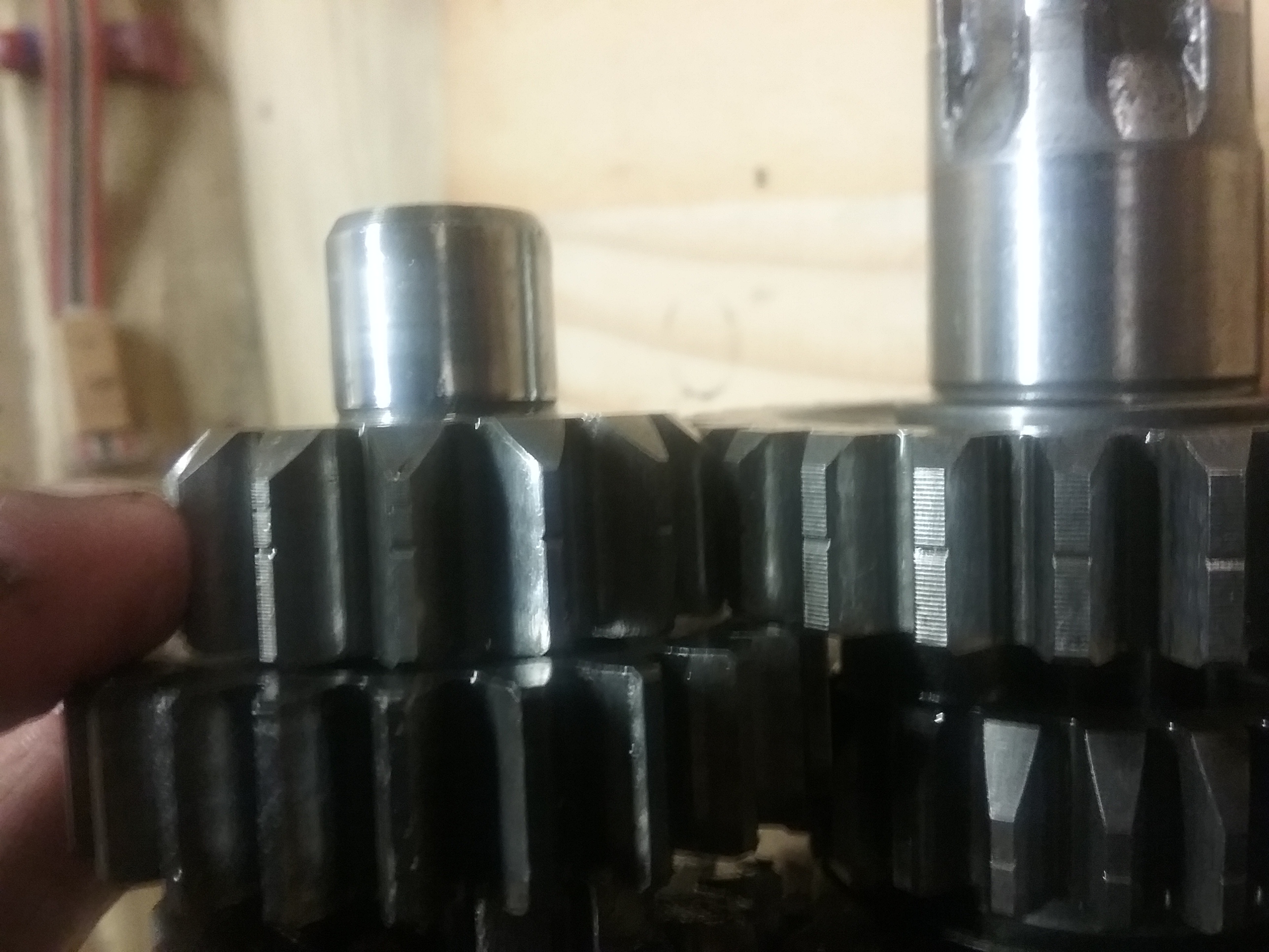

Going through some old pics I show the bevel goes in.
IMG_4251 cropped.jpg (267.39 KiB) Viewed 1919 times
IMG_4466 cropped.jpg (206.3 KiB) Viewed 1919 times

With the bevel out, the gear is binding on the gear next to it, that bevel is to allow that gear to ride in next to the one beside it with out contacting. This is one of those cases where the manual is right.
