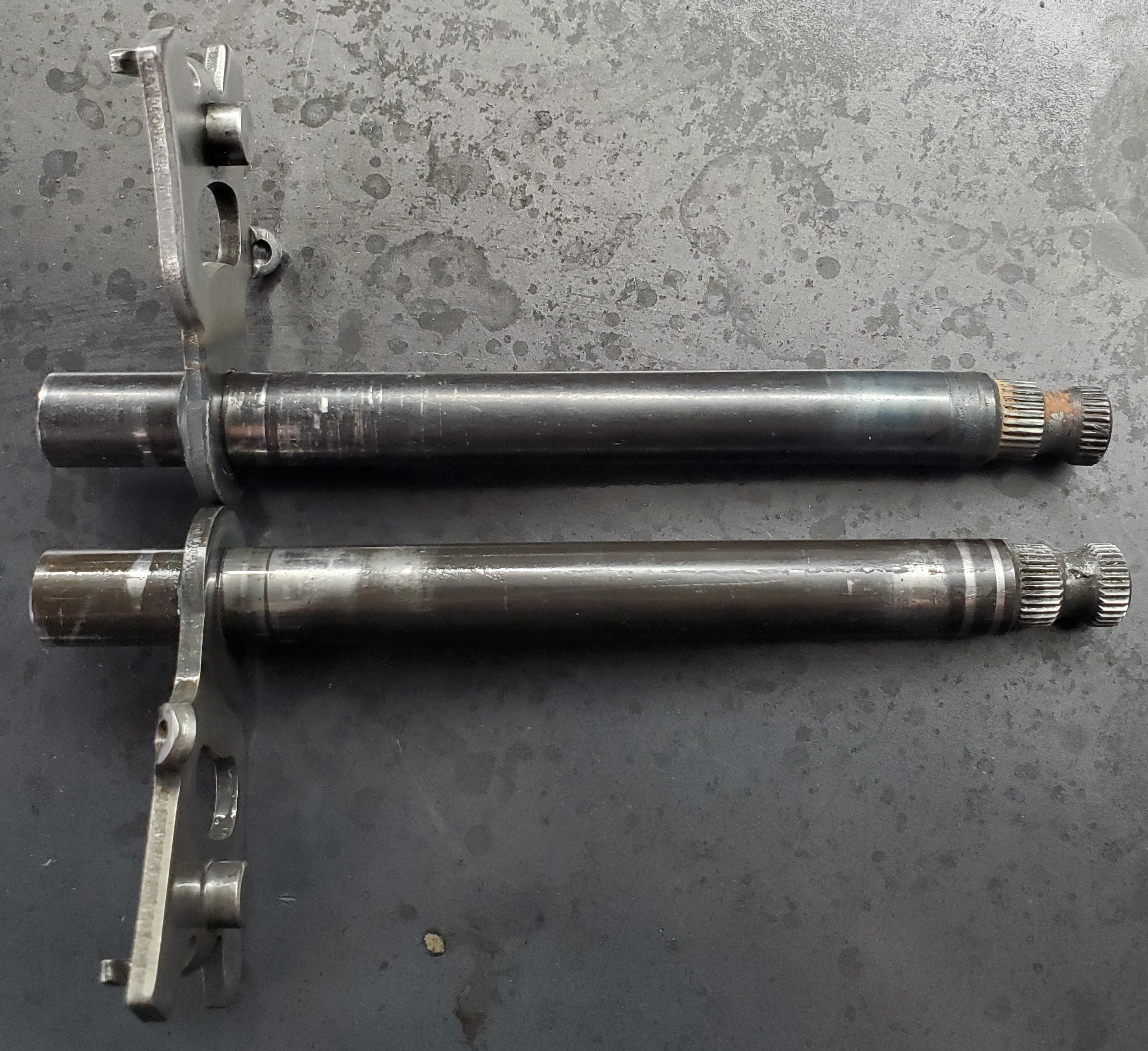

Ok, trying out a resize app.

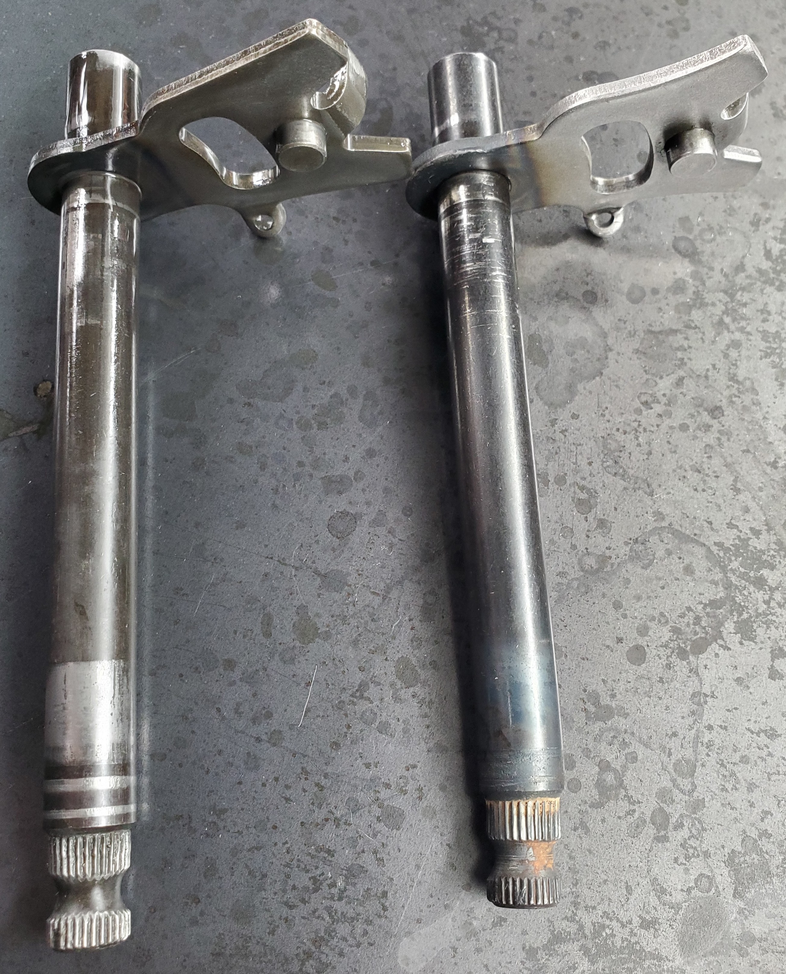

Pictures comparing the KX250 and KDX250 shift shafts, got it installed and seems to shift OK on the bench.

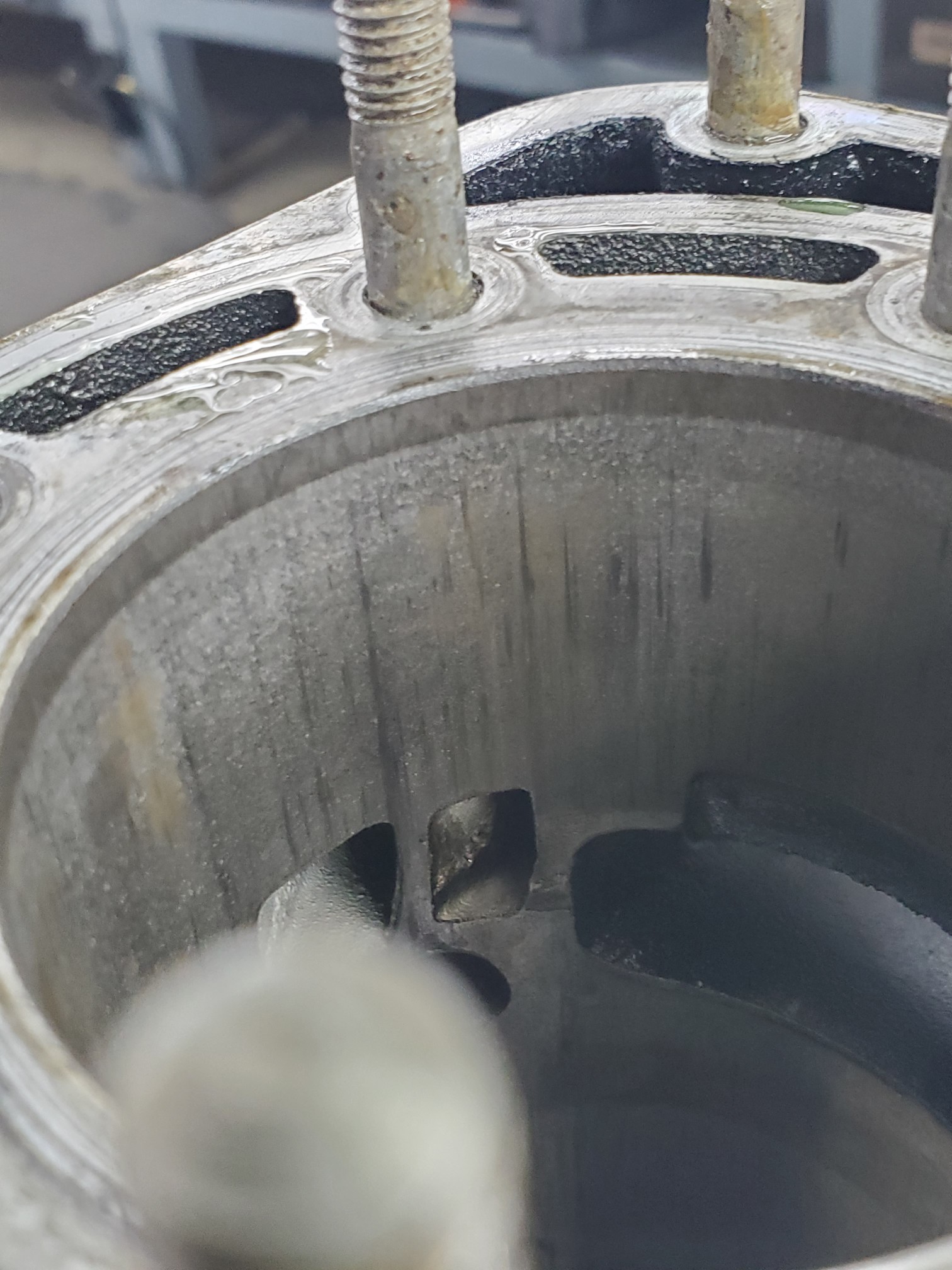

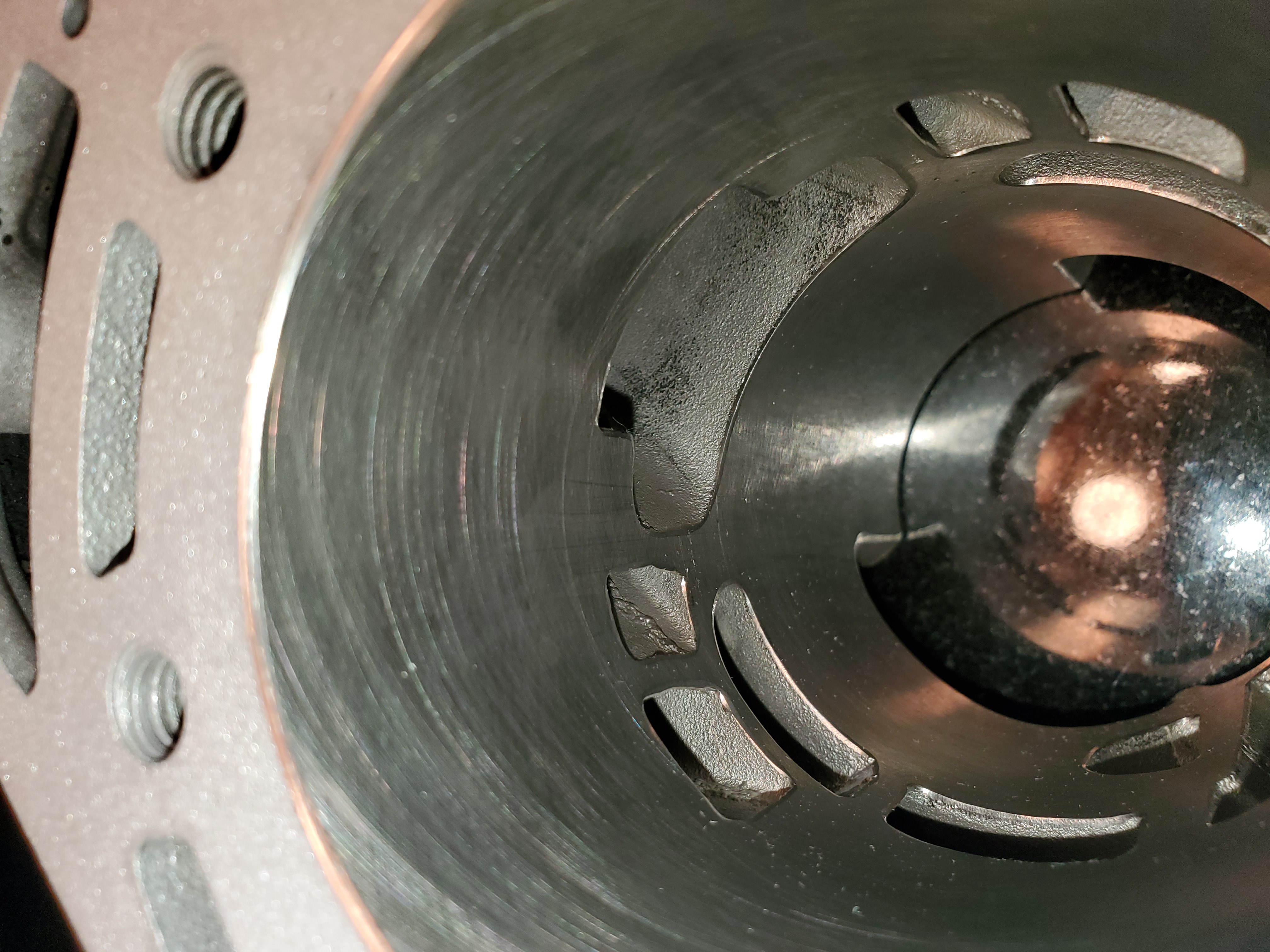

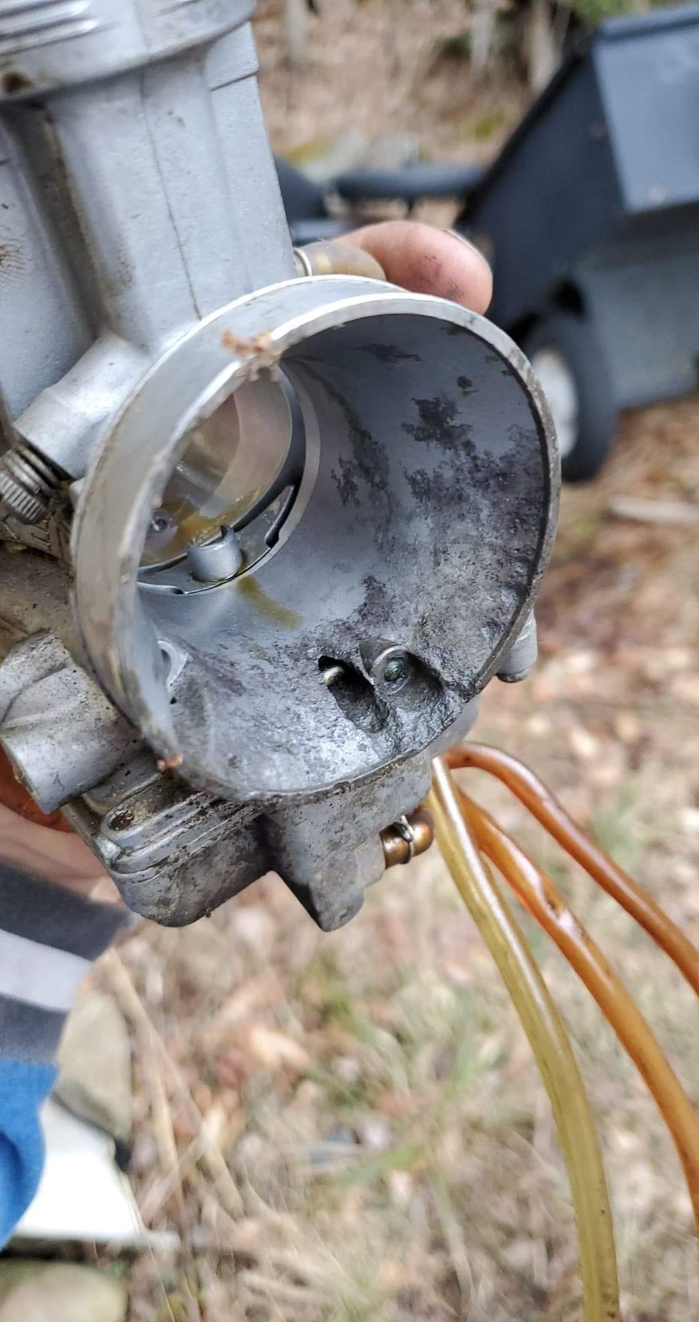

Cyl didn't look horrible imo except for this spot that looks like the plating chipped off? I was worried that it may be a crack that would need to be welded. I sent it to millennium for inspection and replate.

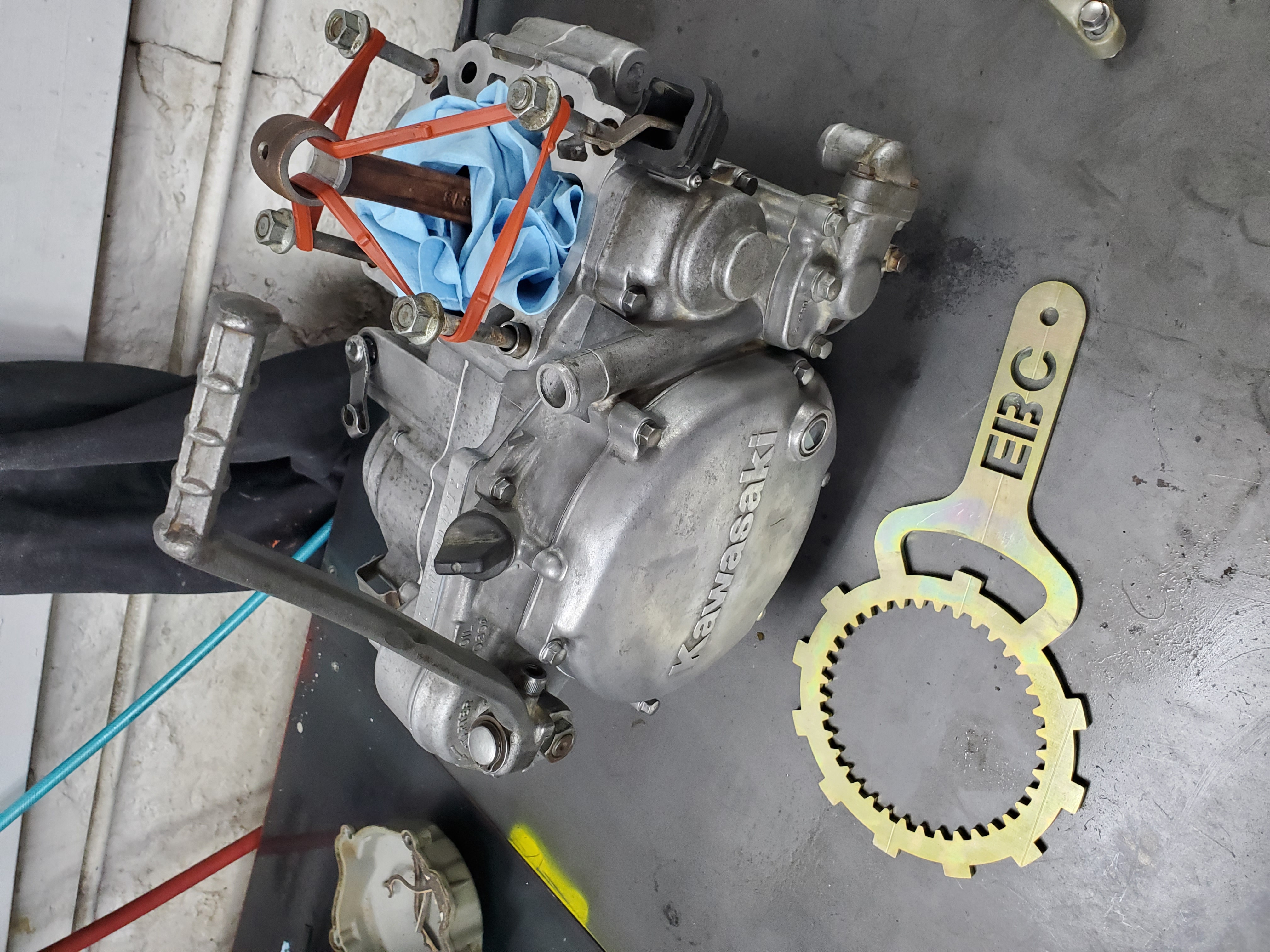

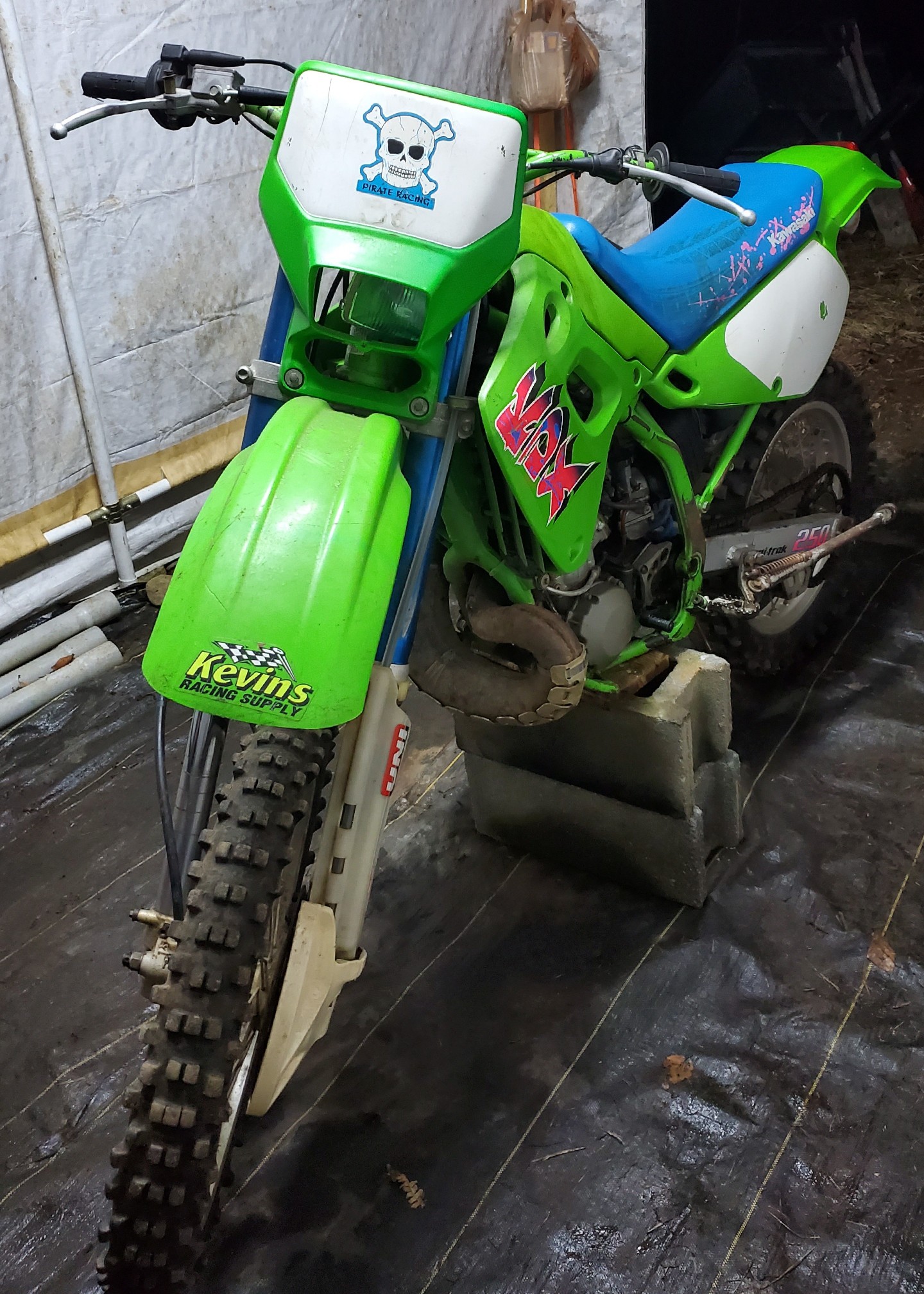

Here's my beauty not exactly a glamor shot but.....
Got the purchase info dug up, we bought it in 1996 for $1999 +tax
Hopefully i can dig up some photos from when we got it.

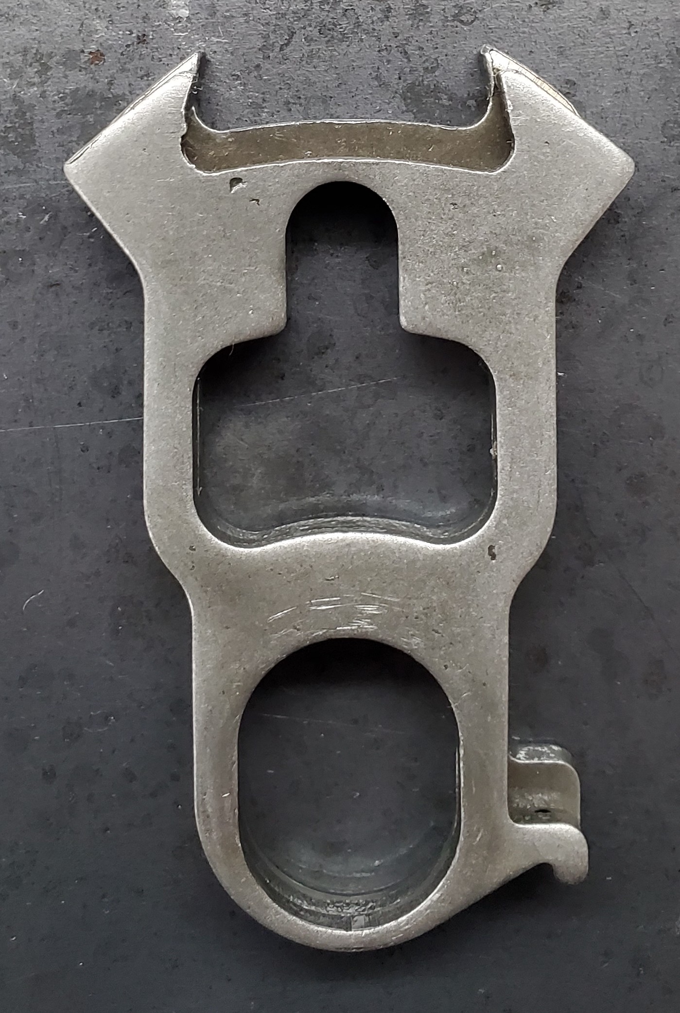

Oh, and this....

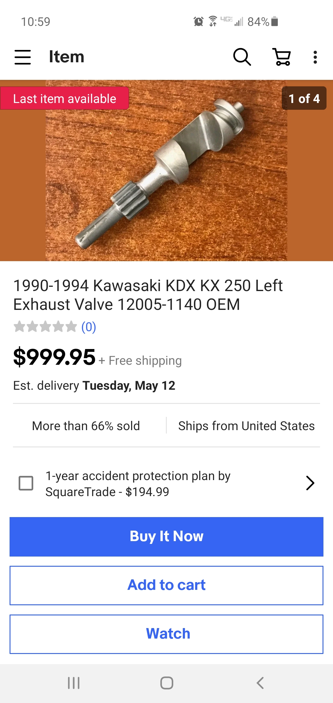

I was able to find one used one unbroken.
Also found sellers selling one nos valve for $500... gouge much? Ugh.
Sadly, i found two sets on ebay, both had the same right side top pin broken, and neither description mentioned it. Both said sets were in good condition.

Re: Here goes nothing!
WOW!
See if papouch from Poland?? sells them on eBay.
I think that plating may have flaked off.
"Kevin's Racing Supply"... I remember buying some fork springs from there 15?? years ago.

I do see someone from the czech republic selling cnc ones for a reasonable price. I saved it in case i need any in the future.'92 KDX250 OG Ride

Yeah, some NOS sellers are asking for a fortune.
I think the guy I was talking about is indeed from the Czech Republic, "papouch" or something like that. He has been at it for a few years now.

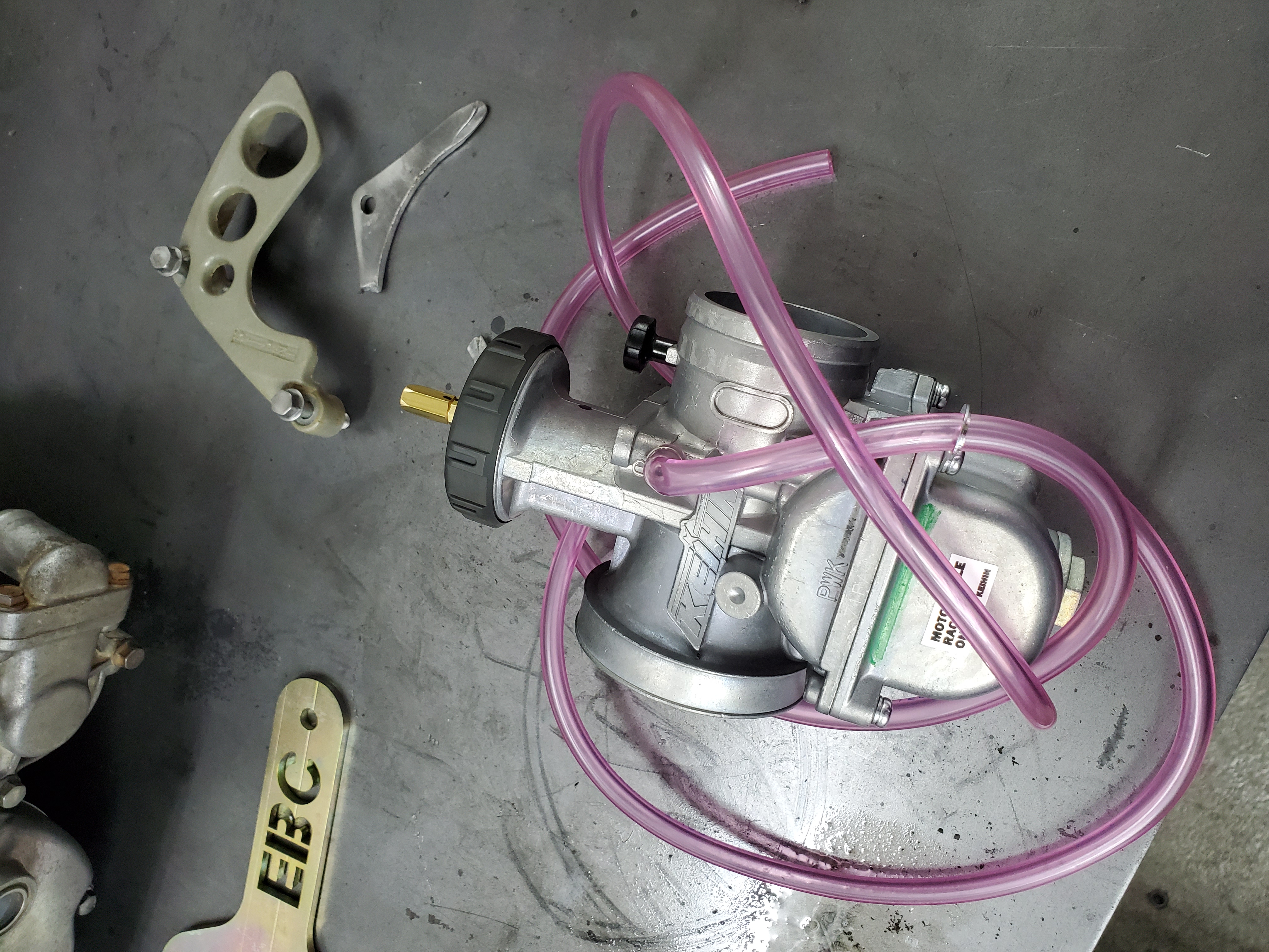

Little update, haven't had a lot of time to work on the project, usually about four hours a week. Got an email from millennium last week saying that my cylinder failed final qc and had to go through the process again. Boo, but it's definitely not what's holding me up so.... as it stands, I've got the the tires mounted and bottom end back together. New carb came this week YAY decided to go with a pwk, #6 slide, CEL needle, 38 pilot and 158 main jet to start with, also got the reed block trimmed up to fit the v force reed cage.
And my other exciting find Biggest hurdle now is getting the motivation to tackle the forks, and get my reading done to see if i can even come up with the tools needed to do it. Other than that, i have to figure out if i can braze a couple broken aluminum bits, and start putting things back in order.....

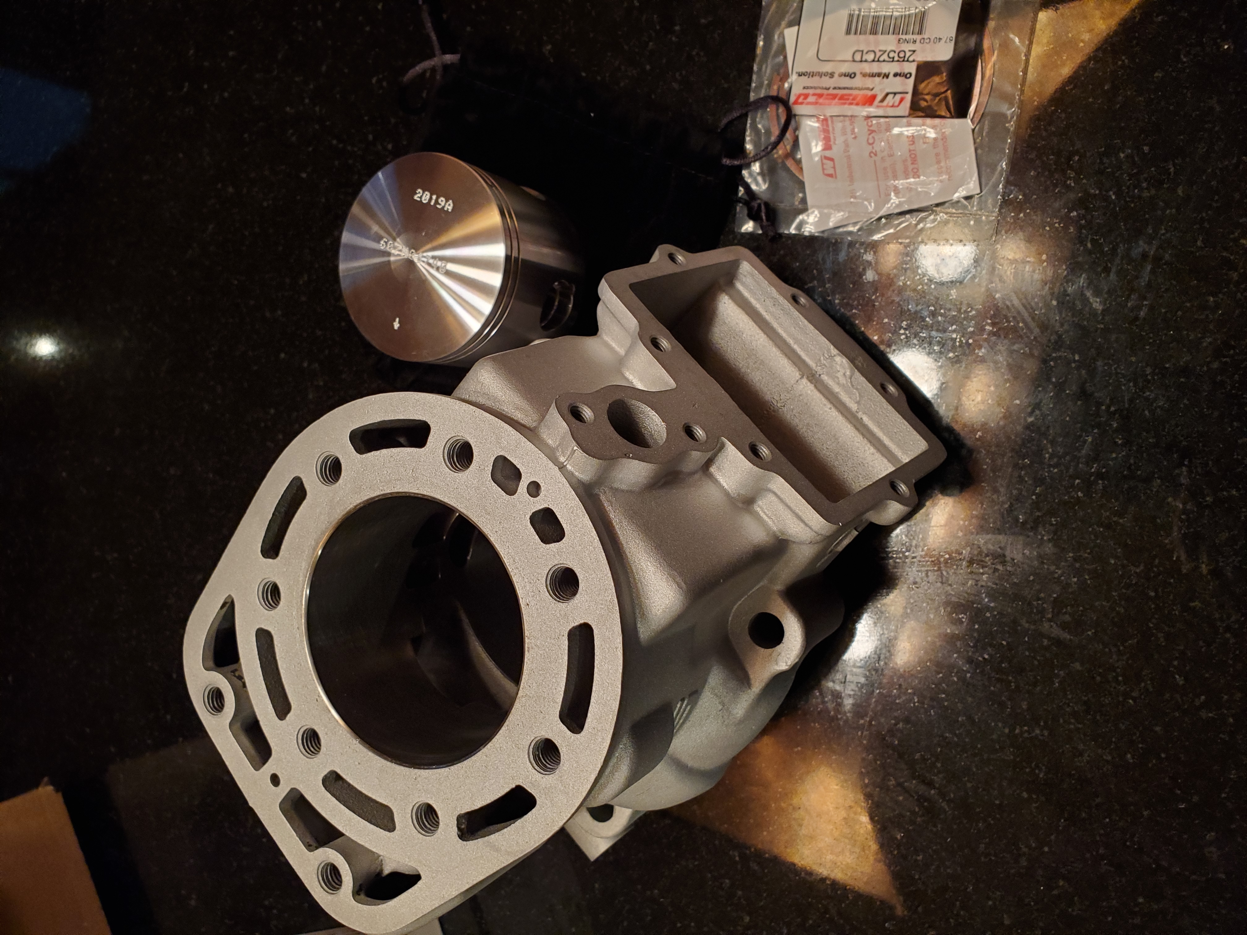

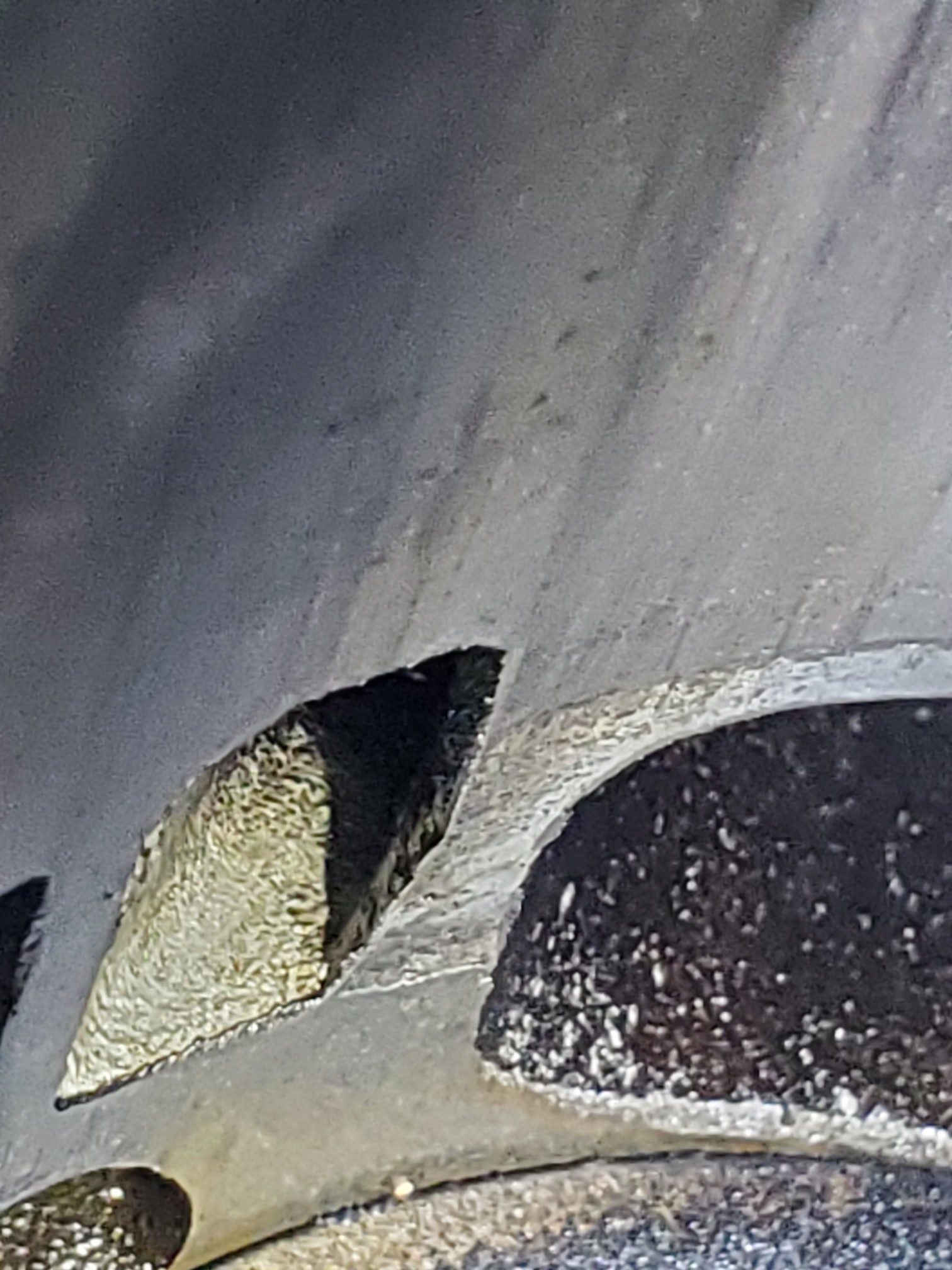

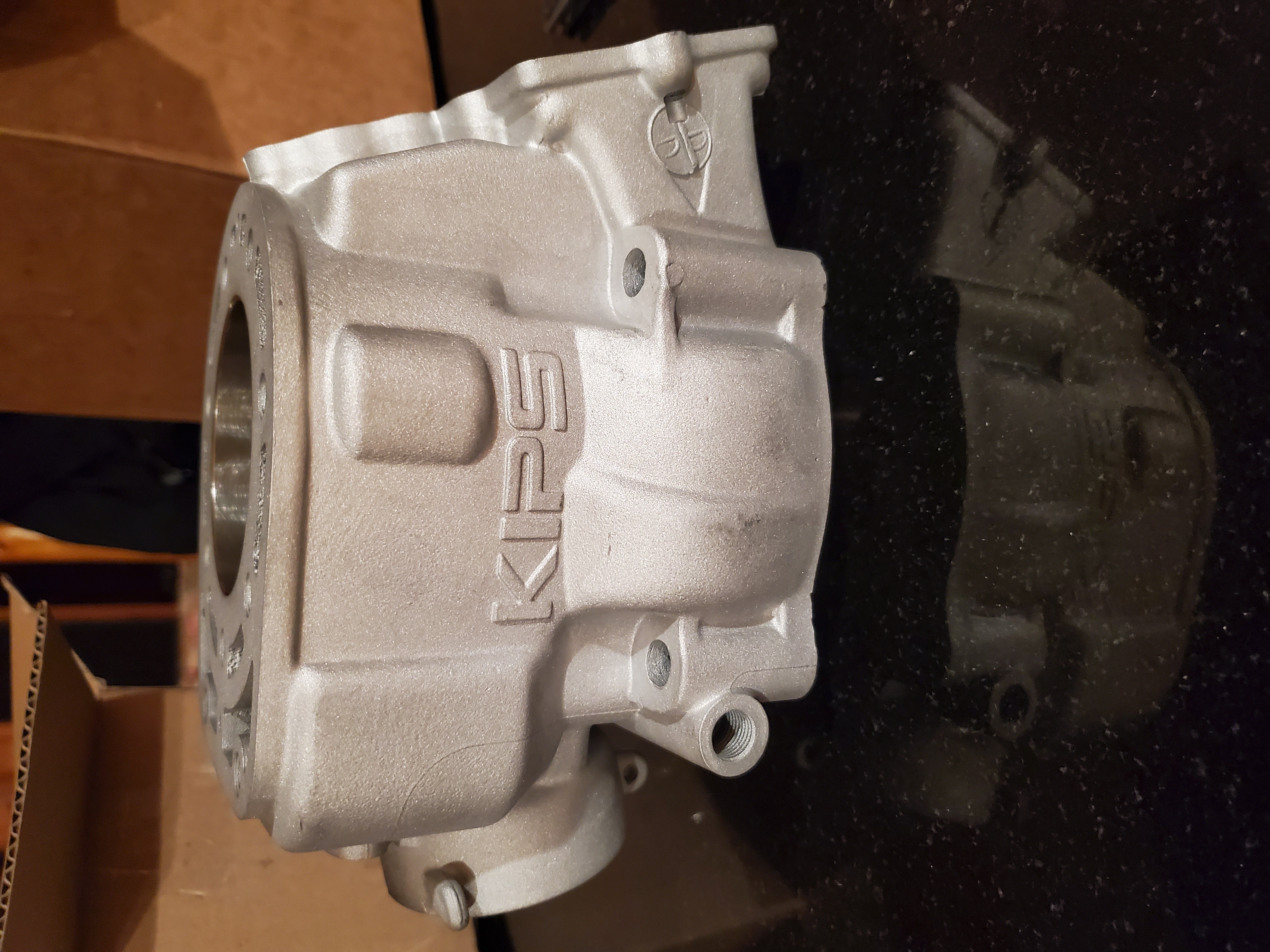

So, it looks like they bead blasted the whole thing, (I'm not a big fan of bead blasting machined gasket surfaces but what's done is done, ) i feel like i need to clear coat or paint the outside now?

- Posts: 3539
Also not a fan of blasting sealing surfaces. Some clear coat will help it stay clean looking quite a while.
