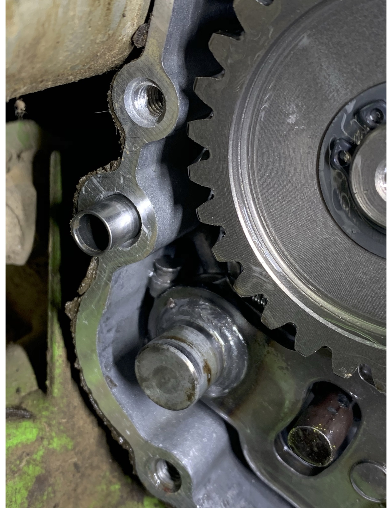

KIPS PIN.jpg (455.35 KiB) Viewed 2978 times
I recently picked up an 01' 220 for about $850 and got it home and had some trouble shifting. It wouldn't shift into anything higher than second and moving it between first and second was a hassle. So my dad an I began to take off the clutch cover case and saw that the shift prawl wasn't engaging the turret properly. We decide to take off the inner clutch case and what do we see. The KIPS pin broke and landed right where the back of the shift prawl pivots and wasn't allowing for range of motion (If i could post a picture I would but I can't :/). We pulled the pin out and freed the KIPS shift in the clutch case there and this thing was shifting like a dream.
But my question is, when looking at the KIPS system in jug, there are reservoir chambers for the exhaust at low RPM's. Do these chambers need to open simultaneously? When we first looked at the KIPS system, one reservoir chamber would open and one would close. Should I expect these to open at the same time, or is it correct that they one opened and one closed when i turned the KIPS slug?

Re: Look at where this KIPS pin landed!
Welcome to kdxrider.net.
Look in my signature for pic posting instructions.
Good explanation of what was going on.
Posts: 6054
KIPS valves should open at the same time. Somebody installed them incorrectly.
Posts: 3540
Sounds like the KIPS was assembled incorrectly, both subvalves should open and close together. Service manual should be your first purchase. The KIPS actuator is left hand threaded if you haven't tried to disassemble it yet.

thanks lads, i picked up a service manual and will follow it to a T.

ebulic19, I am not sure if it is the angle of the photo but it looks like not all the broken pin is there, if you could post a photo of the pin or measure the length, should be just over 3/4" long. If broken you might have to go fishing for the rest of it, flush out the tranny until it appears..

JimmyB wrote: 04:19 pm Apr 21 2020 ebulic19, I am not sure if it is the angle of the photo but it looks like not all the broken pin is there, if you could post a photo of the pin or measure the length, should be just over 3/4" long. If broken you might have to go fishing for the rest of it, flush out the tranny until it appears..
I measured it and it is 3/4" long and it we did a flush of the tranny to make sure we didn't miss anything.

Did you buy a new lever / pin?

KDXGarage wrote: 07:20 pm Apr 21 2020 Did you buy a new lever / pin?
I bought a new lever assembly it was like 8 bucks on partzilla.
