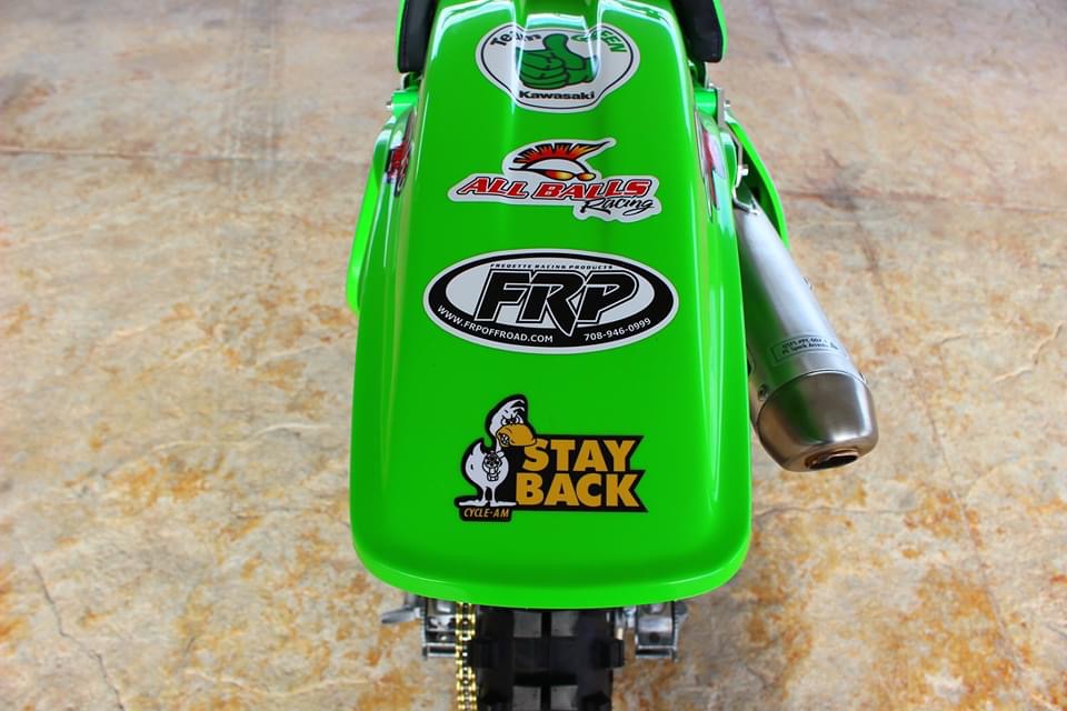

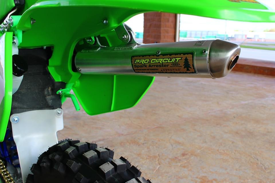

So in making that fender work which i did do and am SUPER happy with the look and feel... you will need to cut some material from where the kdx exhaust runs through on the right side. squeeze the thing like a taco to make it fit between the frame rails and make little straps to reach from the front mounts behind the air box and the fender. I used a Quick clamp to squeeze the fender to slip in between the frame rails and shoved the bolts through. I then made some real quick little aluminum straps to reach forward to mount the front of the fender. I think they are made of 1"x1/8" strap picked up from the local Homeless Deathspot. All together this is an awesome upgrade and the integrated handles on the fender are SOOOOOO much nicer than my MX fender on my 02 220 that I'm thinking of trying to adapt a new fender to that bike. The first ride out with the new fender met a lot of time hitting the ground as the bike was intended for new riders and it held solid. I COMPLETELY RECOMMEND THIS UPGRADE!!!!!!!!!!!!

I used this same fender on my 93. I trimmed the front of the fender at the airbox until the pre-drilled rear holes matched up with the subframe. After they lined up, I just had to oval the front two holes slightly to get the front section bolted up. All in all, it's a very easy modification to the fender to make it fit like factory.
