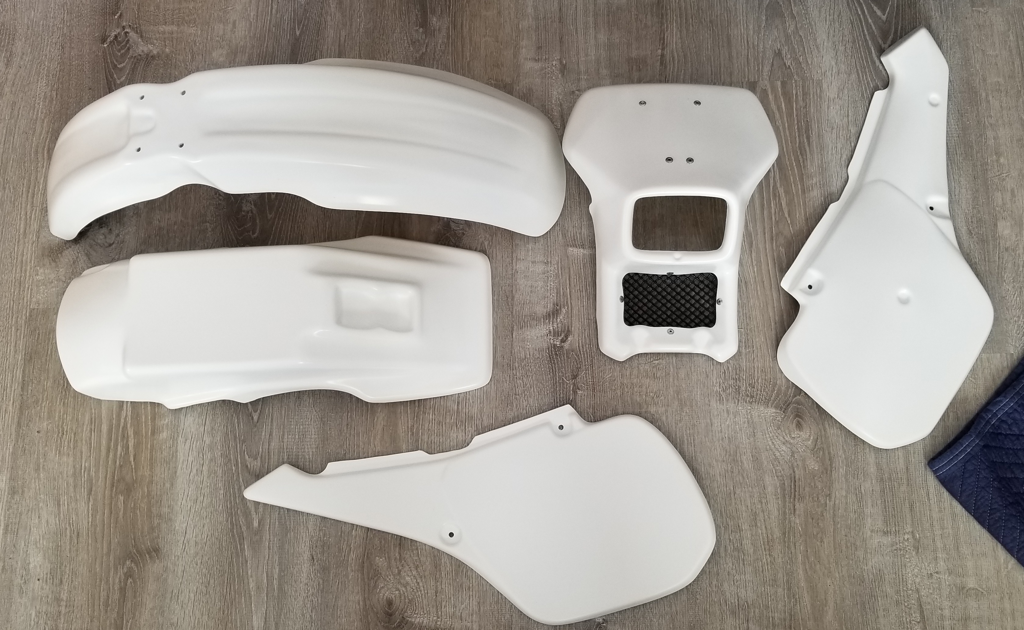

I really wanted a set of plastics for my 88, and was not willing to settle and make it green, so I reached out to Tom at DC plastics. They make a vacuum formed reproduction set for the 88 in green. I asked him to make some white for me and he said no problem. This has been my experience with them.

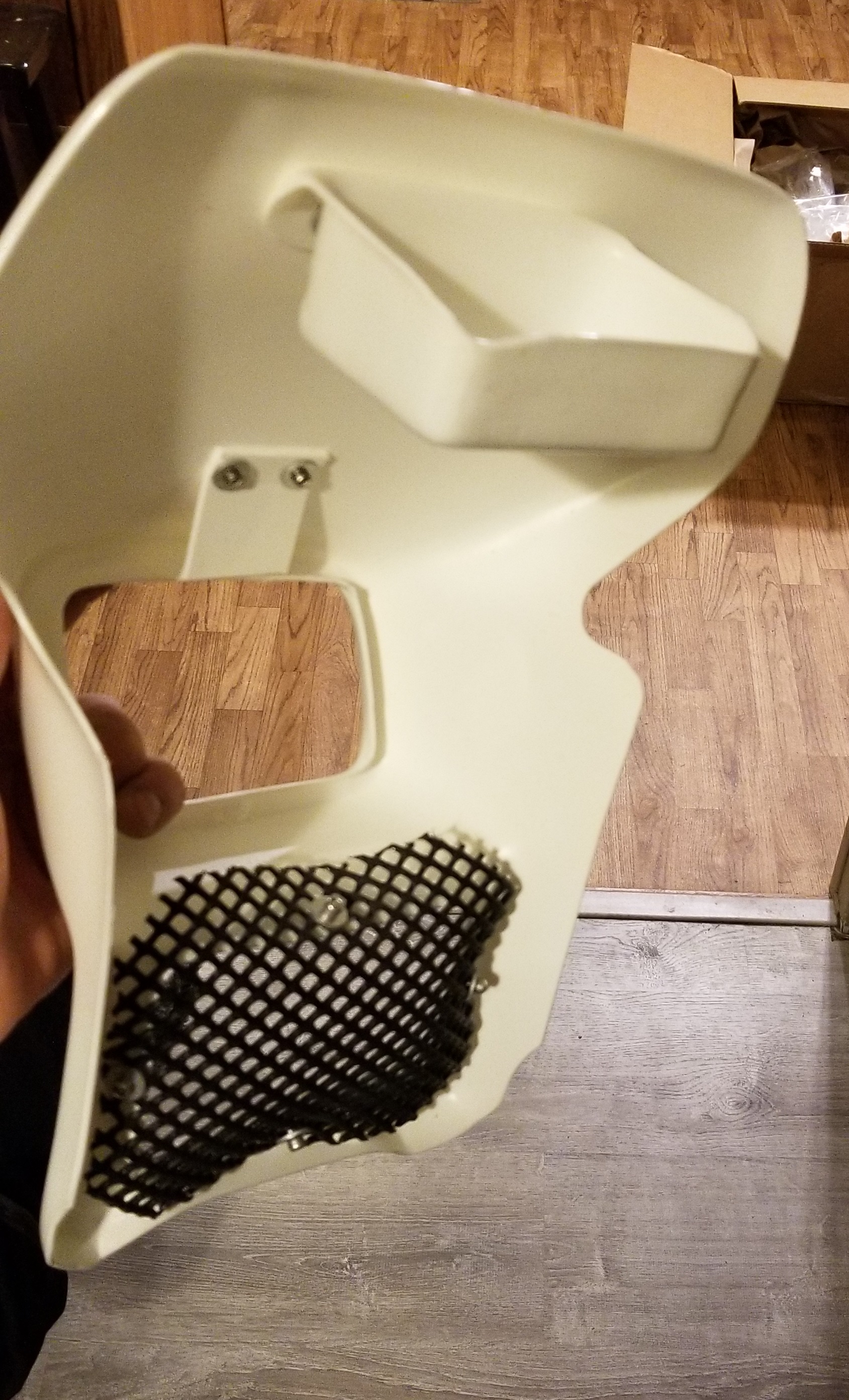

There are no brackets on the back, I have not figured out how I am putting a headlight in yet because I do not have the original one to play with, but you can see they riveted this tub-like rectangle on the back of it. I found a creative way to secure it to the handle bar clamps with simple L brackets that feels pretty solid. I replaced the plastic garden mesh that came with it for some aluminum diamond mesh I powder coated black, looks pretty sharp I'll have to post some pics.

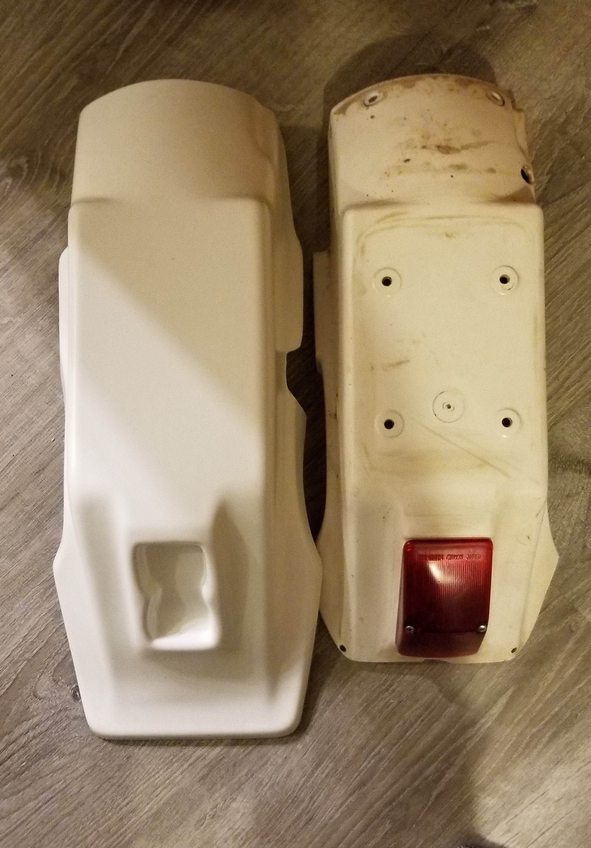

The rear fender comes with no holes pre-drilled. This was a good thing for me because the rear frame is slightly tweaked, and by off setting the holes just a little I have it looking very straight. The part where the tail light mounts is not flat and it going to take more creative energy to make fit.
Everything fit with little modification with the exception of the tail light. The two side panels need 10mm spacers for the lower mounting holes, they are 10mm shallower than their injection molded counterparts. This was not a big deal I spun some out of aluminum and it's not much hassle to put them in place when bolting everything up.
These panels are much more flexible than OEM. The instructions say heat with a heat gun and bend as needed to make fit. The rear panels were somewhat flat, and I had a tough time getting the memory out of them completely. You can see they almost flare out, but not quite, as opposed to curving in. I am ok with that at this point. They do look really nice.

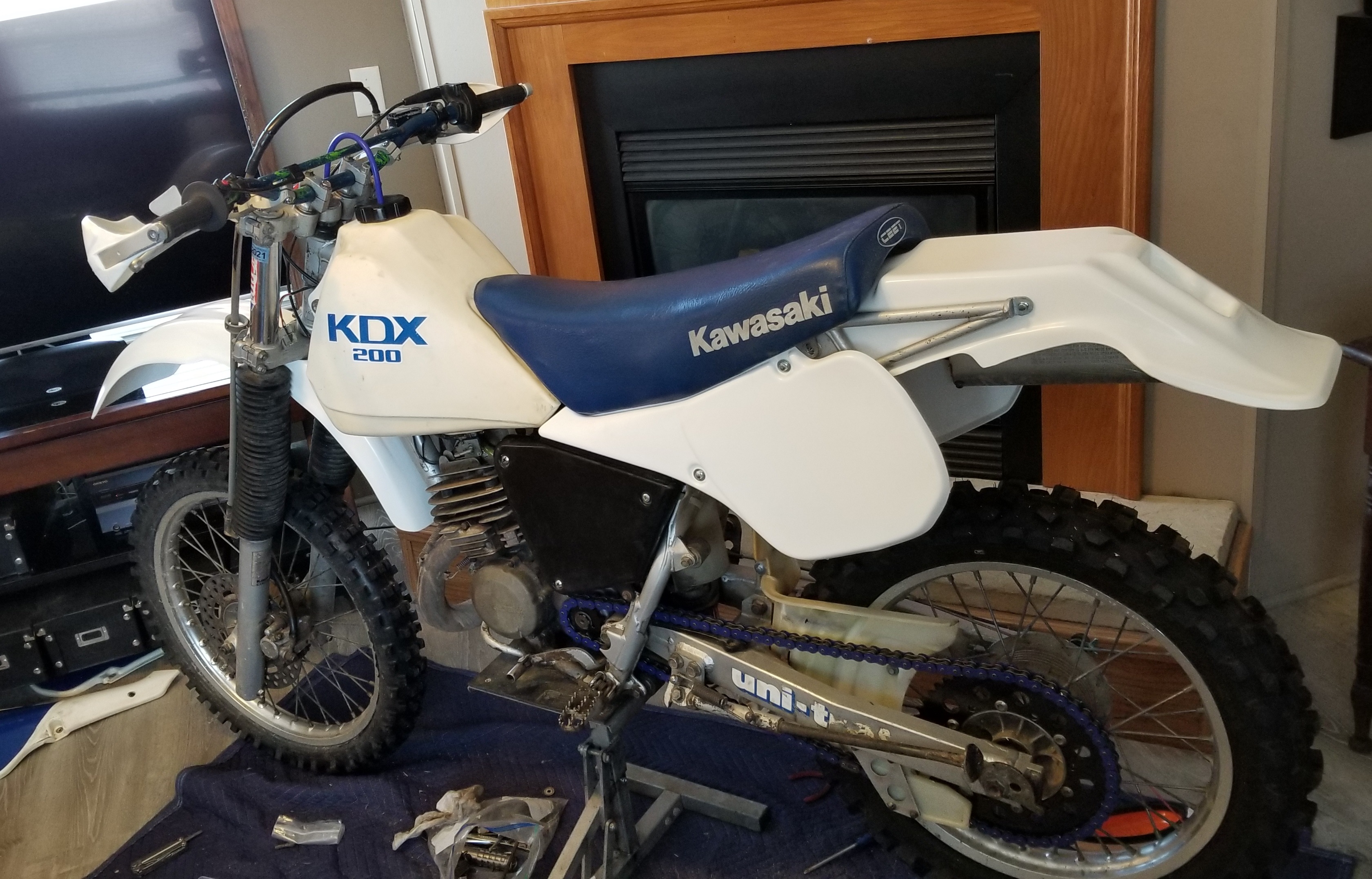

Check that chain tension!
PolarWhiteC
Posts: 25
Joined: 09:21 am Jan 13 2020
Location: WI
Re: White plastics for 88
Post by PolarWhiteC »
Thanks guys. Ha ha, yeah I'm definitely at the lower end of 2" slack, That chain and sprockets were brand new in that pic. Few laps around the yard to loosen it up and it is a bit better. Seems like one notch down and its too loose.
