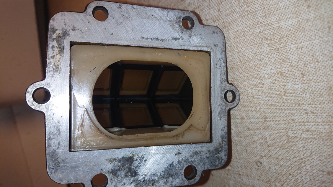

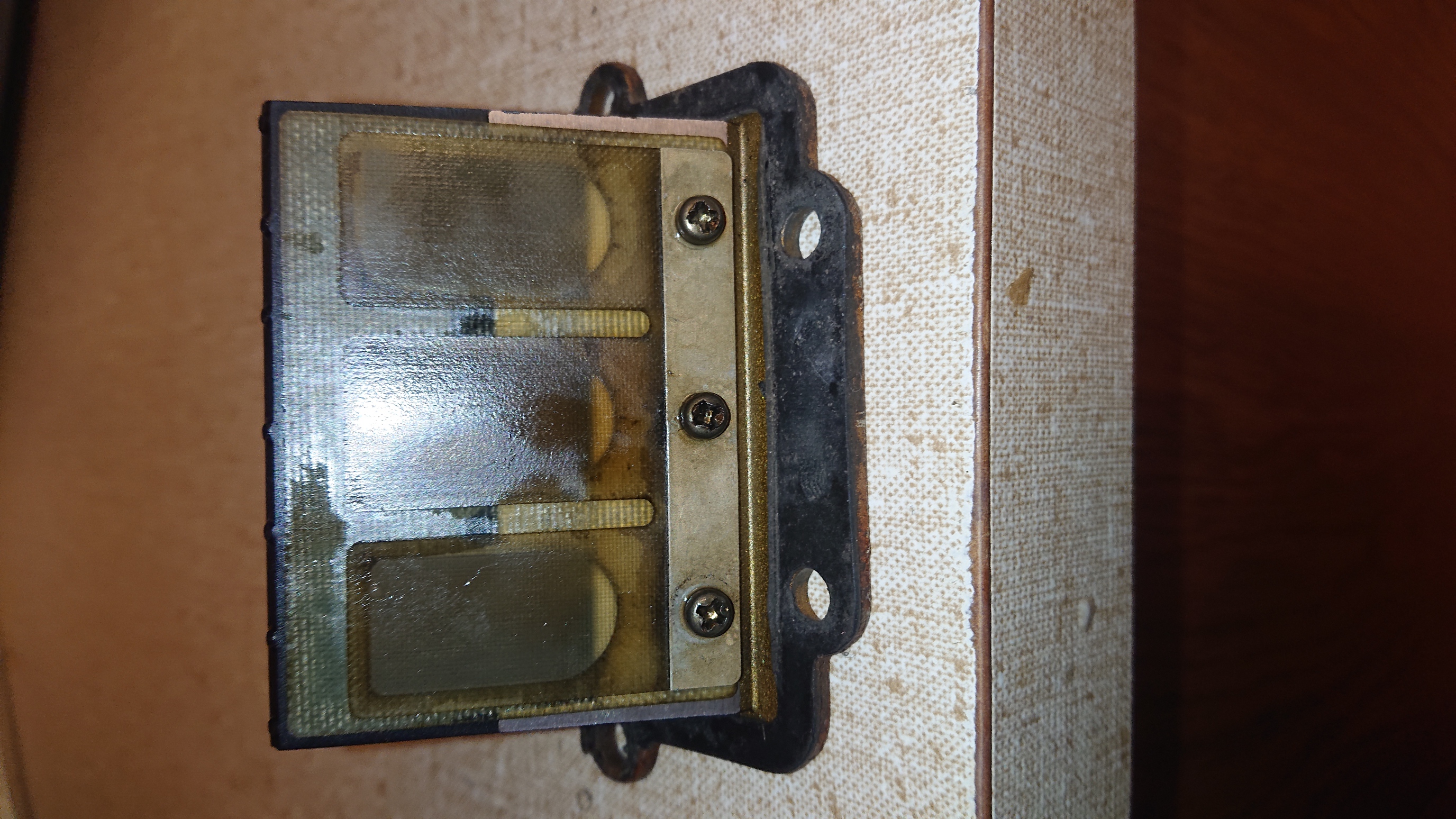

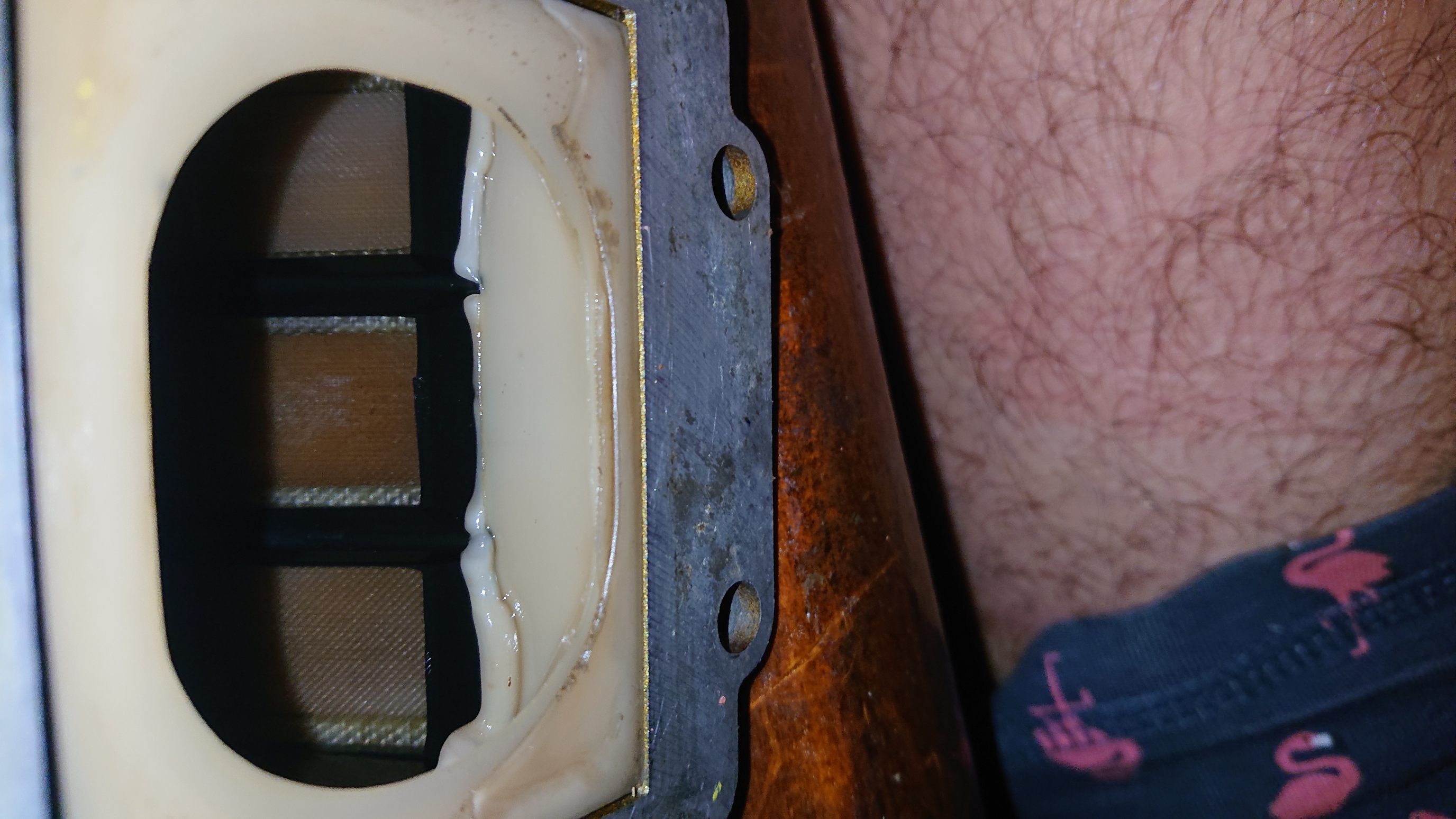

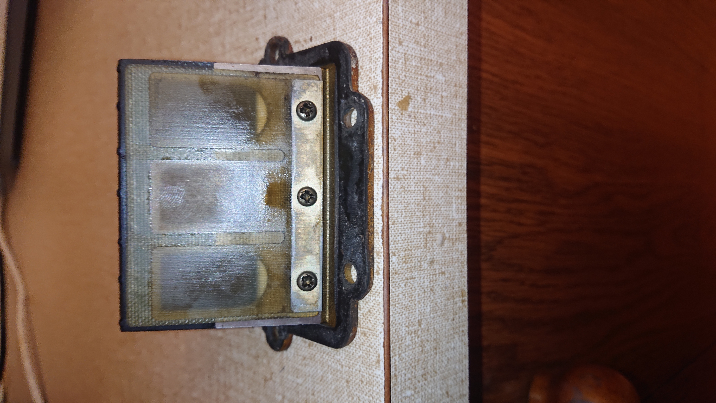

So I took my reed block out to inspect and as you can see in the pictures one side of the block has started to melt, what could cause this, bad reed petals, ive checked the petal and they are flush against the block so that check out but I'm not sure how else to tell if they are bad,
Also could this be contributing to bad performance

Almost looks like the adhesive holding the block together has softened a bit. If the reeds are seating properly and there are no air leaks in the assembly it likely isn't an issue, though certianly would warrant keeping an eye on. IF the reeds are properly seating and there are no leaks then it likely isn't the source of performance issues. Has anything else changed recently?
Re: Bad reeds/block
I don't see it as being an issue.
Odd though!

bufftester wrote: 11:21 am Apr 06 2020 Almost looks like the adhesive holding the block together has softened a bit. If the reeds are seating properly and there are no air leaks in the assembly it likely isn't an issue, though certianly would warrant keeping an eye on. IF the reeds are properly seating and there are no leaks then it likely isn't the source of performance issues. Has anything else changed recently?
Only recently got the bike, was a mess still is just not as bad, ive fixed some big air leaks in the boots, cleaned the carby, new spark plug, filter, fixed the clutch, and exhaust, I may just need start looking at a complete rebuild lol
