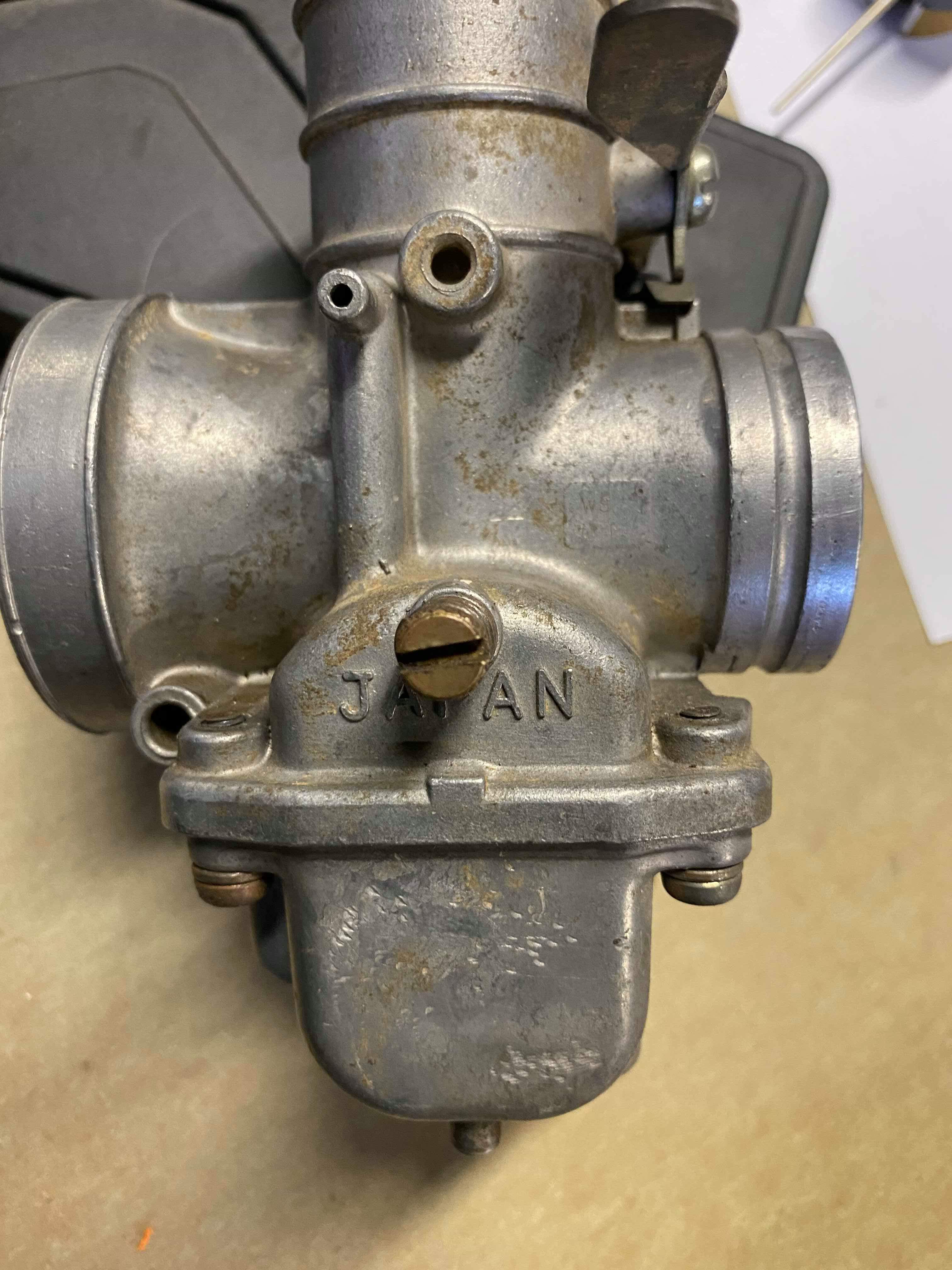

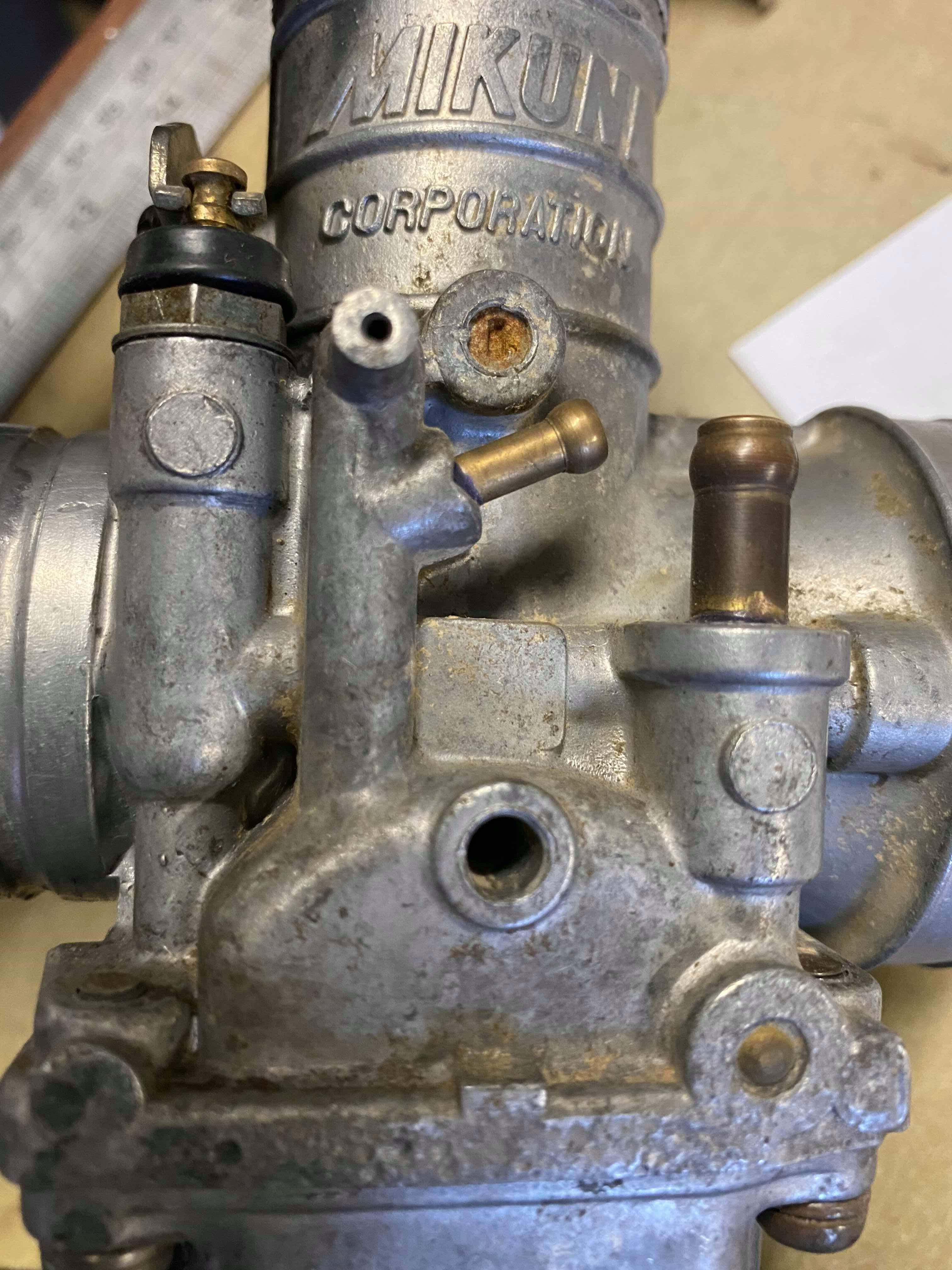

Sorry may be a silly question but what's holes are for what etc I'm unsure

WHAT THE HE**?!
Does it have an oil tank for the two-stroke oil??
top pic, upper left is a vent hose location, I suppose
MAN! That is different than the USA carb!

Oh really I'm confused now haha, now no oil tank just mix in with the fuel,

lemme look around
maybe that second brass part is just a vent connection?

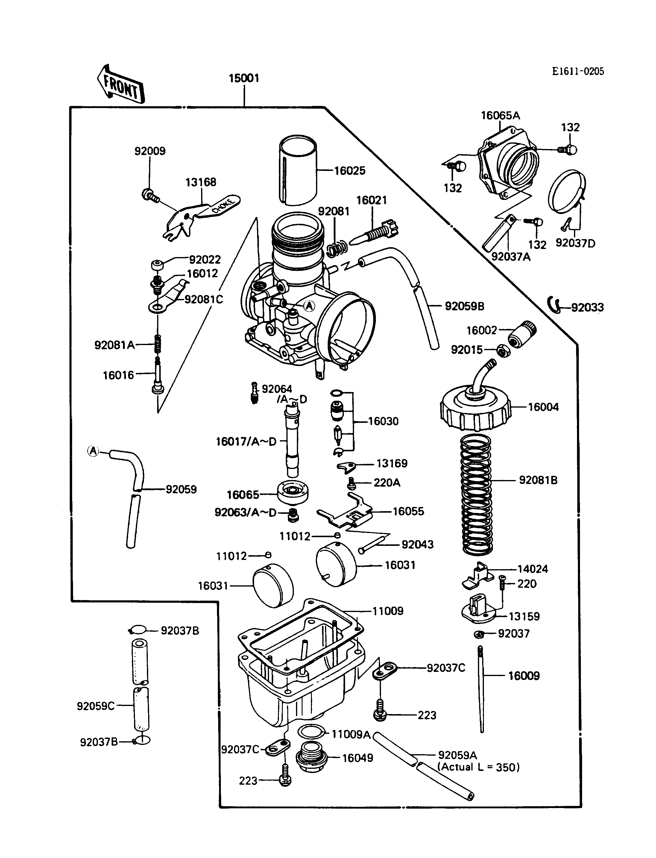

- This is from kawasaki website but still no idea

Re: Newb carb question vm34
Yeah, I think it is just a vent. One on each side, then one on the bowl (overflow).
Man. My eyes were tricking me. :-0

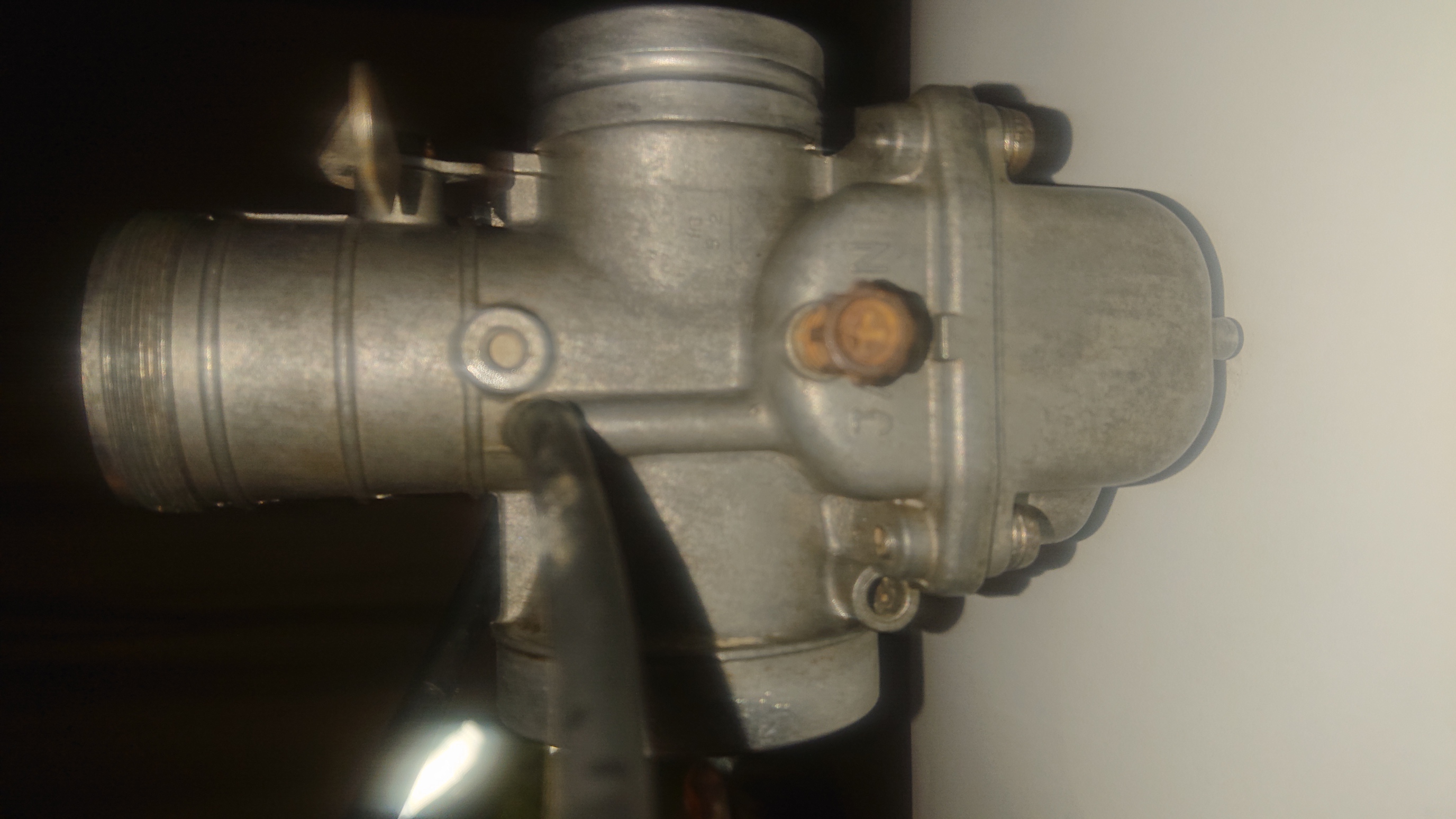

This is mine and from here they looked to be blocked of unlike the new one they are open hmmm

OK, now that one looks normal to me.

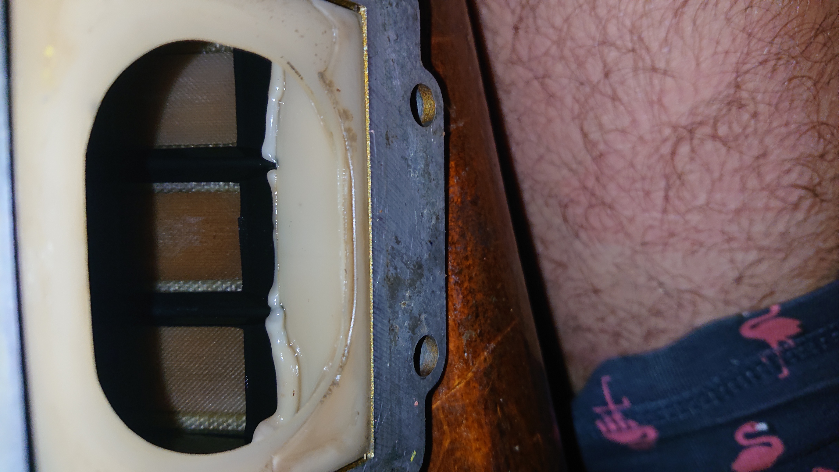

Hey thought I'd ask before I do another post so after the carb I've setteld on putting the 320 jet in which is stock I think, and put the needle on lowest clip since it longer lol, so next I check my reeds/reed block and I noticed the plastic has been melting on one side, could bad reeds cause this and be half my problem with idle/and power
Thanks
- DSC_1366_50.JPG (1.29 MiB) Viewed 6049 times
1987 KDX200-D1 (AUS)
Michael93
- Posts: 74
- Joined: 11:09 am Mar 26 2020
- Country: Australia
Edit sorry should mention the pedals they sit flushMichael93 wrote: 07:50 am Apr 06 2020Hey thought I'd ask before I do another post so after the carb I've setteld on putting the 320 jet in which is stock I think, and put the needle on lowest clip since it longer lol, so next I check my reeds/reed block and I noticed the plastic has been melting on one side, could bad reeds cause this and be half my problem with idle/and power
