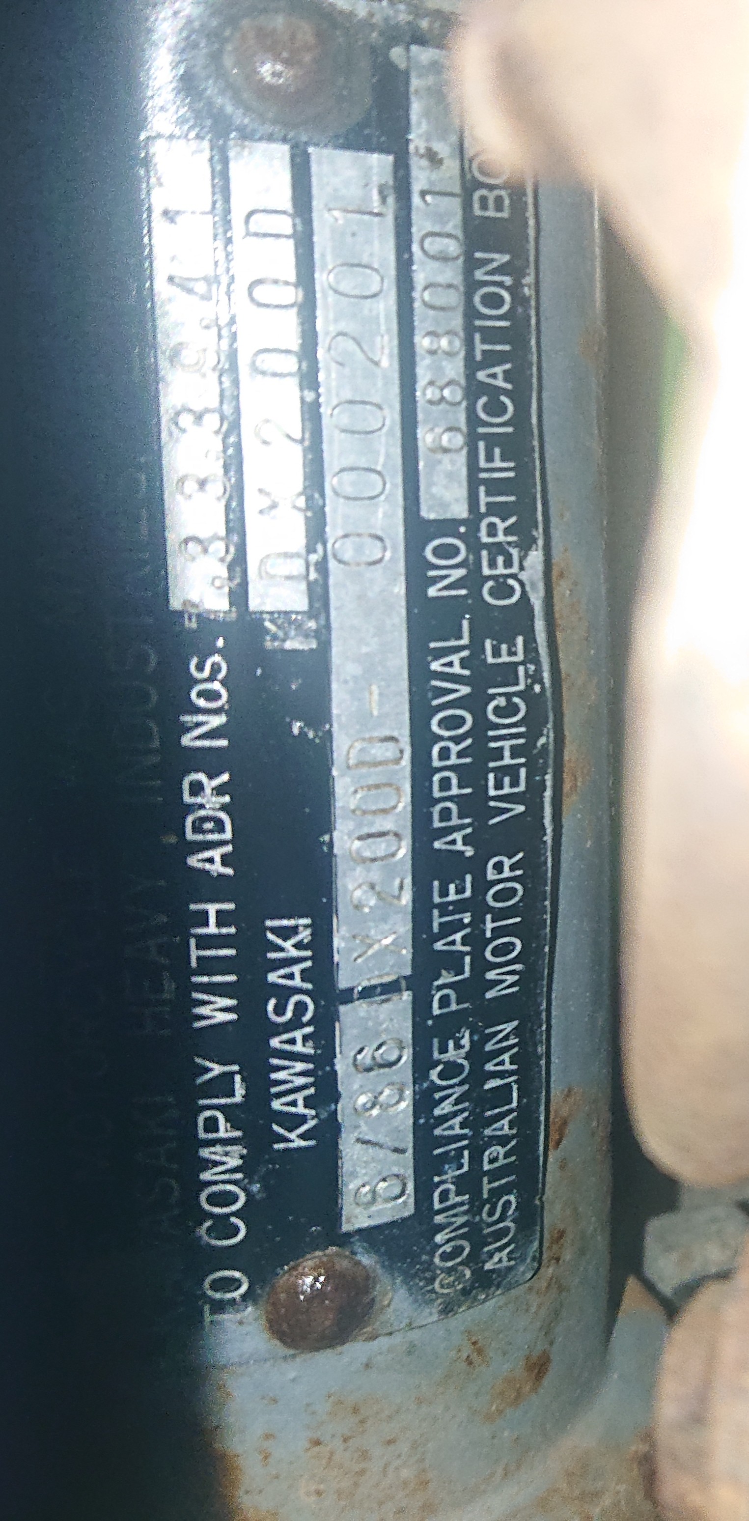

ImageSorry for lack of info well the plate says it's a 1986 kdx 200 the rear tyre is a 4.60-18 mt 344 moto cross enduro swallow and finger gap either side

Tnats the plate, I just assume 6/86 meant 1986

1987 KDX200-D1, correct? I looked it up on TT.

Oh for real I was trusting the guys words and looked at the plate an didn't question, I didn't pay a whole lot so no buggy but yeah, when I got it it had no chain guards except the plastic chain slider near the sprocket

It's all making sense now it's explains why when I did the clutch the new washers I bought for the 86 didn't fit but 88/88 did

I got a new 1987 from the dealer. It came with a plastic chain guard / splash guard. If yours does not have that, then it must be how it is running such a wide tire. Personally, I would go 100/100 - 18. That bike does not have a lot of power. Stock was 100/100-18 on even the 1989 - 1994 liquid-cooled models in the USA.
