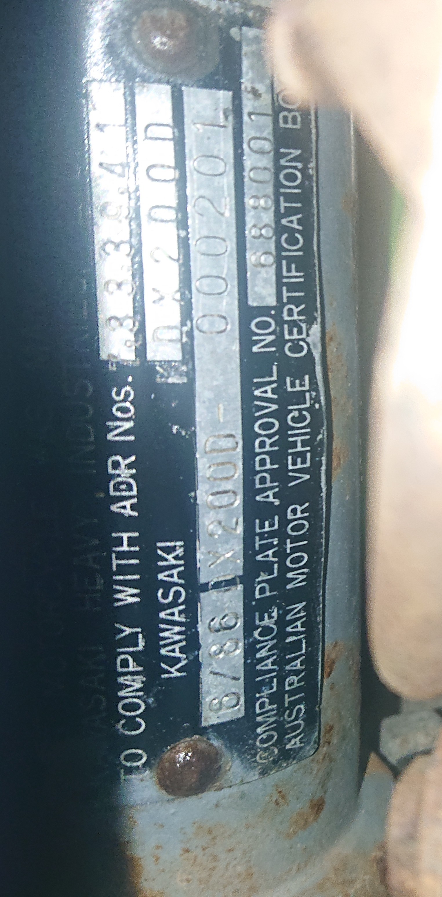

Which year KDX is it?
100/100 is 100 mm wide and 100 % of 100 mm tall. (100 mm x 100 mm)
4.6" wide is around 120 mm wide. Depending on brand, and if this is a 1986 - 1988, I am surprised it is not rubbing the insides of the swingarm. This is also assuming the stock 48 rear sprocket.

Tnats the plate, I just assume 6/86 meant 1986

1987 KDX200-D1, correct? I looked it up on TT.
Does it have the plastic chain / splash guard?

Oh for real I was trusting the guys words and looked at the plate an didn't question, I didn't pay a whole lot so no buggy but yeah, when I got it it had no chain guards except the plastic chain slider near the sprocket

It's all making sense now it's explains why when I did the clutch the new washers I bought for the 86 didn't fit but 88/88 did

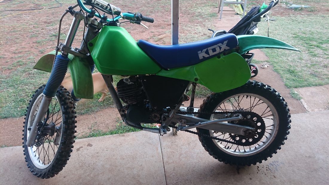

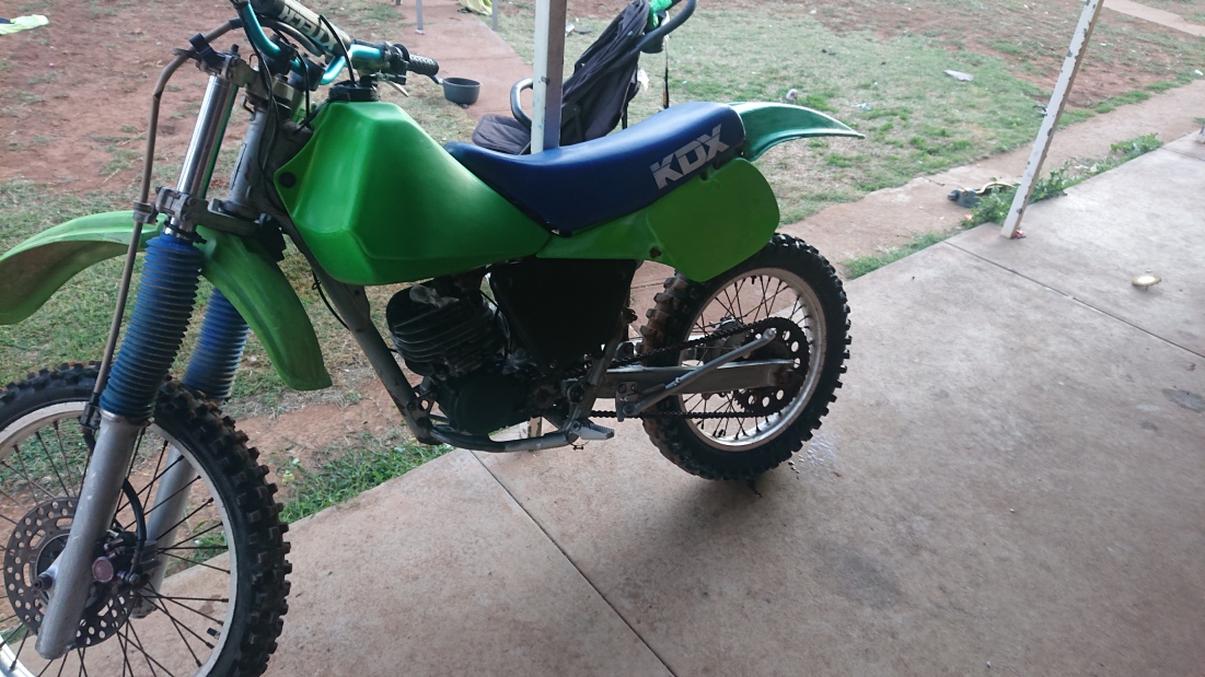

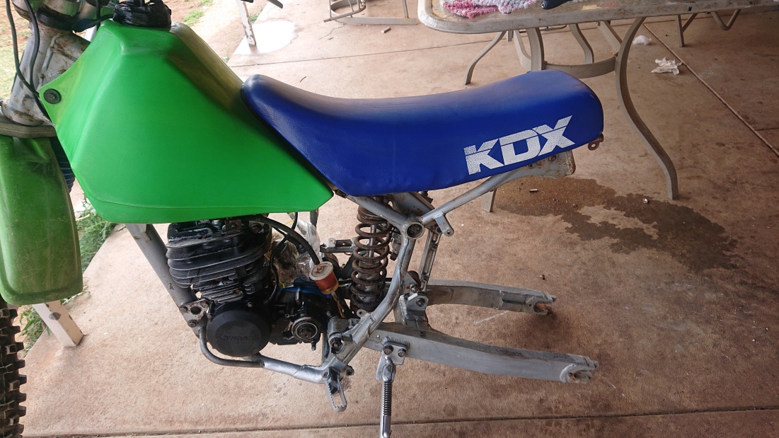

If you can, please post a few pics of your bike. I'd like to see it. Thanks.
Michael93
- Posts: 74
- Joined: 11:09 am Mar 26 2020
- Country: Australia
Re: Tyre 4.60-18 equivelent to 100-100-18 unsure
These are the only ones at the moment still heavily a working project
- DSC_1308_50_40.JPG (406.88 KiB) Viewed 6672 times
- DSC_1317_50_40.JPG (392.85 KiB) Viewed 6672 times
- DSC_1316_50_40.JPG (444.76 KiB) Viewed 6672 times
1987 KDX200-D1 (AUS)
- Posts: 14676
- Has thanked: 67 times
- Been thanked: 20 times
Looks good to me!
