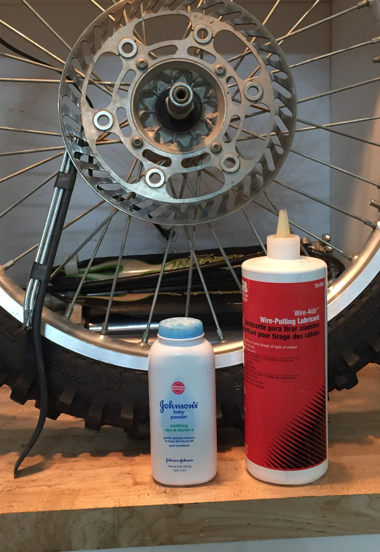

Since I didn’t have the right stuff... I found wire pulling lube worked great as tire lube.

Re: Tubliss - install w/ new tire?
You didn't have dish detergent?
I prefer Dawn but have even used Simple Green in a pinch. (pun intended)

I have used soap in past. I mostly just wanted to try it since it seems intended for similar job. It has consistency of GOOP hand cleaner cream. So rubs in/on pretty well.
IMO - Seemed better than soap.
HA HA!!doakley wrote: 02:02 pm Apr 03 2020 I prefer Dawn but have even used Simple Green in a pinch. (pun intended)
I use Dawn. It sure is easy to take off tire that way. I use it undiluted an glob it on!

Wow. I just saw that you have some fancy tire powder.
You are ALMOST as bad as my friend who was sent to the grocery store to buy baby powder for our 1987 KDX200 tire change. He came back with J&J lavender and chamomile.
This was 2003. I still have the bottle. I will die before I part with that bottle.
