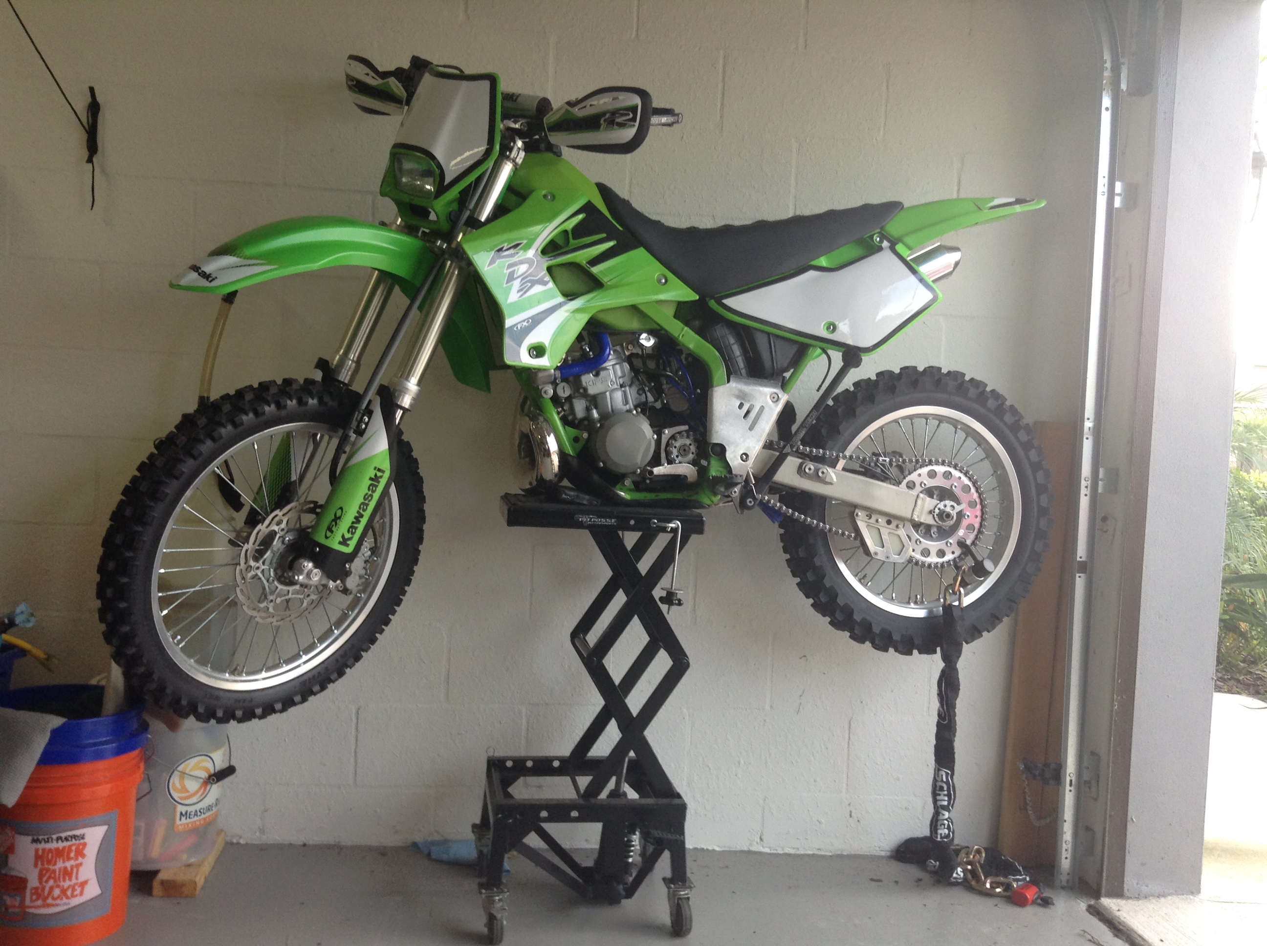

I just lifted it all the way. It puts the top of the footpeg at 38" and the left grip at 65". I love having it! I picked it up,as a used floor model in a dealership. Ive had it a few years.

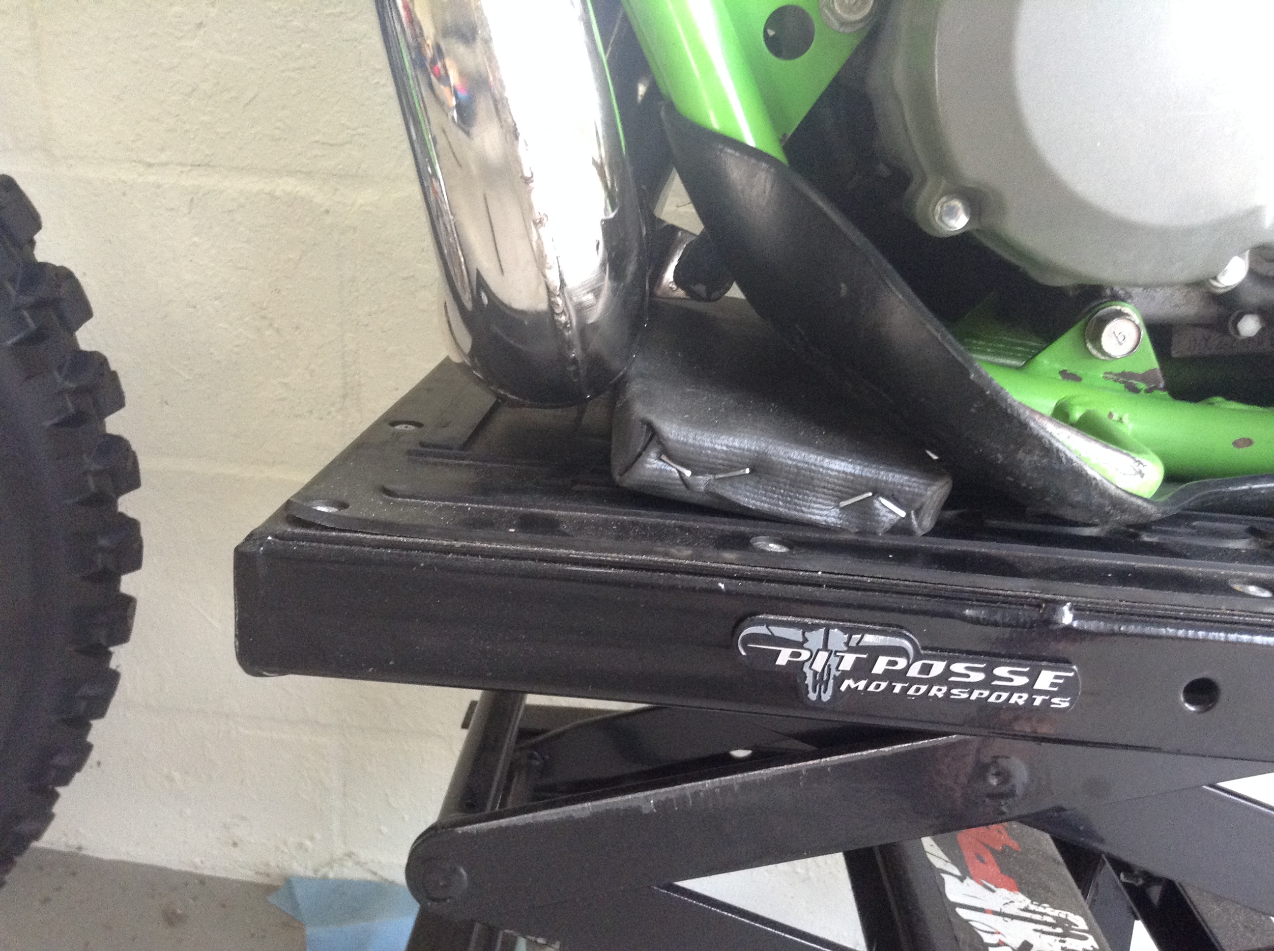

I forgot to mention an important and annoying thing. The way the KDX frame is it lifts the rear way higher than the front. I wrapped a 1x4 block of wood in shelf liner (non slip) and use it to level the bike up. This picture is a terrible example because the stand is way too far forward and the block is pressing up against the pipe. Usually I have it where the pipe is clear of the stand and the block stays put while wrenching on it. A wedge shaped piece would be better.

That's what I thought too at first. It has clamps that hook onto your footpegs and lock it in. They're hanging there in the picture but not clamped on. Typically I only raise it half that high to work on it. It's steady unless you attempt to roll the bike when it's up high. I tried that...once! Didn't knock it over but it all it would take is a pebble on the floor.
