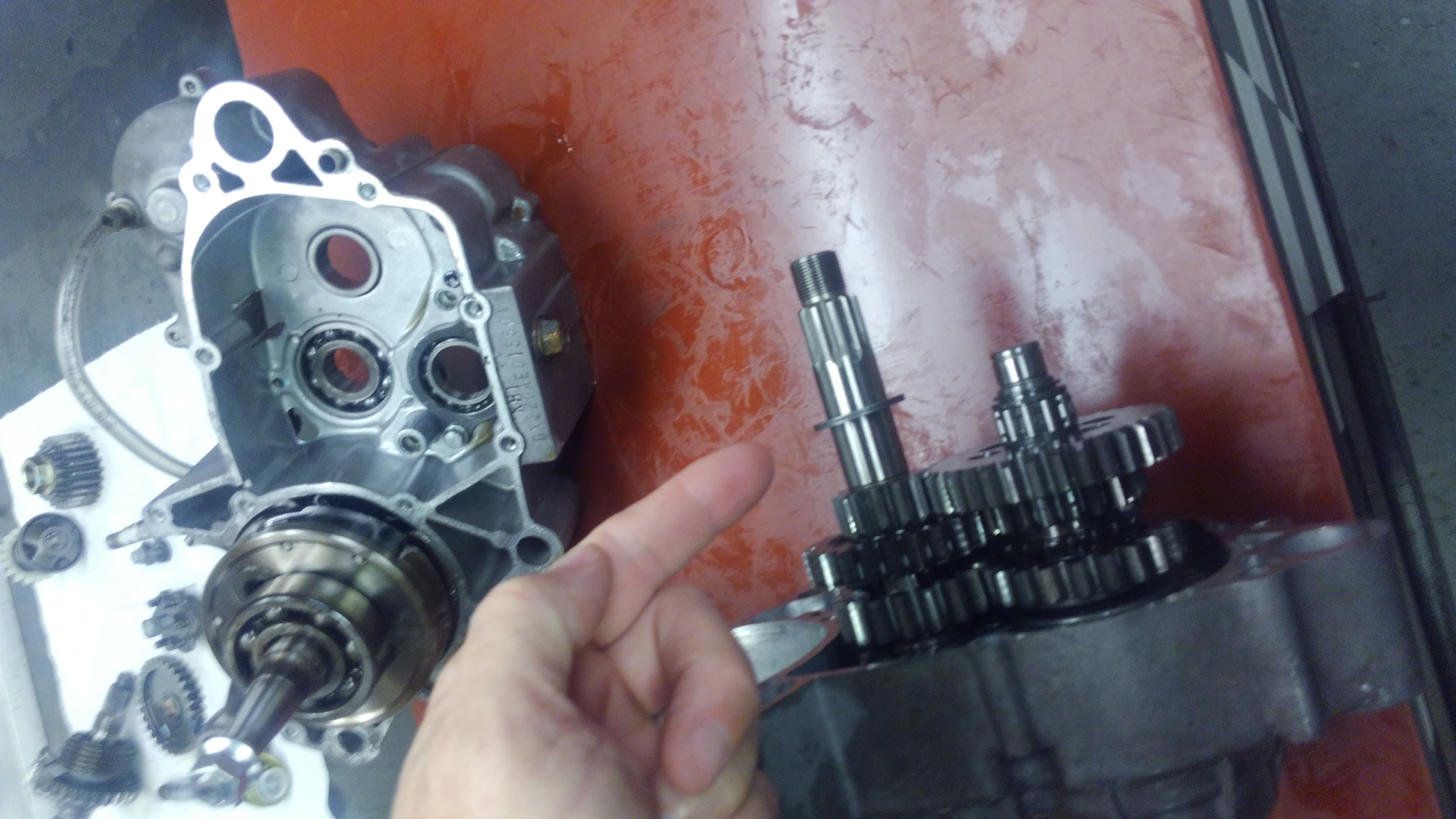

I just split the case on my 05 220 because the Piston skirt broke then cracking the left case. After splitting the case a washer dropped out. I checked the manual and exploded transmission view but can't seem to locate it. It only fits the input shaft where it enters the bearing the right case. Here is a picture where it may go. Is this correct? Also, should I buy just the left case or find a matching set? Thanks for your time!

Found it...I guess it was stuck behind clutch basket and I missed it. Bumping the case with a rubber mallet while splitting the case must have caused it to fall off.
